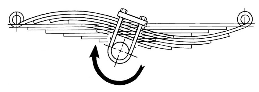

    Sounds like you may have "axle wrap", which is typical of older Tacoma leaf springs. This image shows the energy braking and acceleration transmit to the springs.
    While you are replacing the shocks, I suggest new leaf packs. Upgrade to 4-leaf for stock ride height or 5-leaf for lifts.
