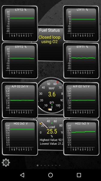

    If you don't have it already get yourself an OBD adapter that can hookup to a computer or phone. Look at the Coolant temp, MAF readings, O2 readings, Fuel Trims, Exhaust temps, etc. A lot of these codes can be caused from other problems. Ex: Invalid MAF readings and coolant temps can cause Rich/Lean conditions, Lean conditions can cause misfires, which can send the crankshaft position sensor haywire, etc..

    The Bluetooth ELM327 adapter comes to mind, let's you see a lot more diagnostic info, and also can read/clear codes.
