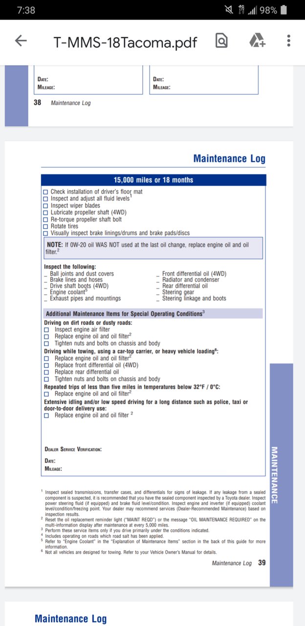

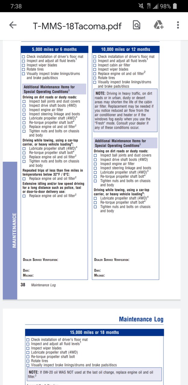

    In case you haven't found your book yet
