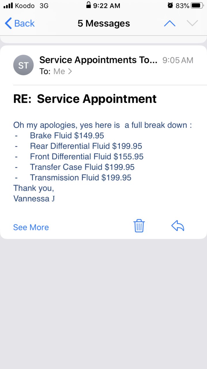

    Hi Everyone,
    So I’m taking my 2015 in for it’s 6 month service, to get my winter tires swapped out on the 31st. I was also told they need to check out all the differential fluids and what not. Total will be about 800$ Canadian, I was told I didn’t need to do everything all at once since I don’t currently have $800 to drop at the moment. Just wondering what you all suggest I should get done first if it needs to be done.
    Thanks!

    I would recommend the Transmission Fluid first.
    That is if, it has 60,000 miles or more on it.
    Next would be Differential Fluids (Rear 1st if I had to choose one)
    Then the Transfer Case
    Then Brake Fluid.
    Most all of your list can be found in DIYs here

    OP- I didn't do anything but oil changes (& a set of tires at 60k) until 90k. My taco is a 2013 with over 360k miles currently
    I would suggest only doing the rear diff fluid ATM...do the tranny next when you cross 60k
    along with the transfer case & front/rear diff
    Brake fluid should be swapped out every 2 years, so do that soon & then every two years
    Also swap power steering fluid every 2 years
    Change your engine air filter every 15k miles
    & sparks every 30k & serp belt every 75k
    Dont forget to lube zerks for ujoints on prop shafts if you have em
    You probably got the best year of the gen 2 build cycle, & will likely have many miles/years of worry free driving
