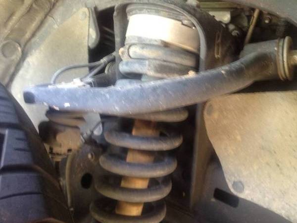

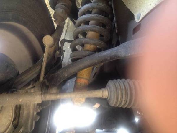

    Here are the photos of front lift, and the rear is just two AAL

    It's a spacer lift. My real advice to you is read, read, read, and then do a little bit of reading. RESEARCH the options available, narrow it down to a couple, and THEN ask for input.
