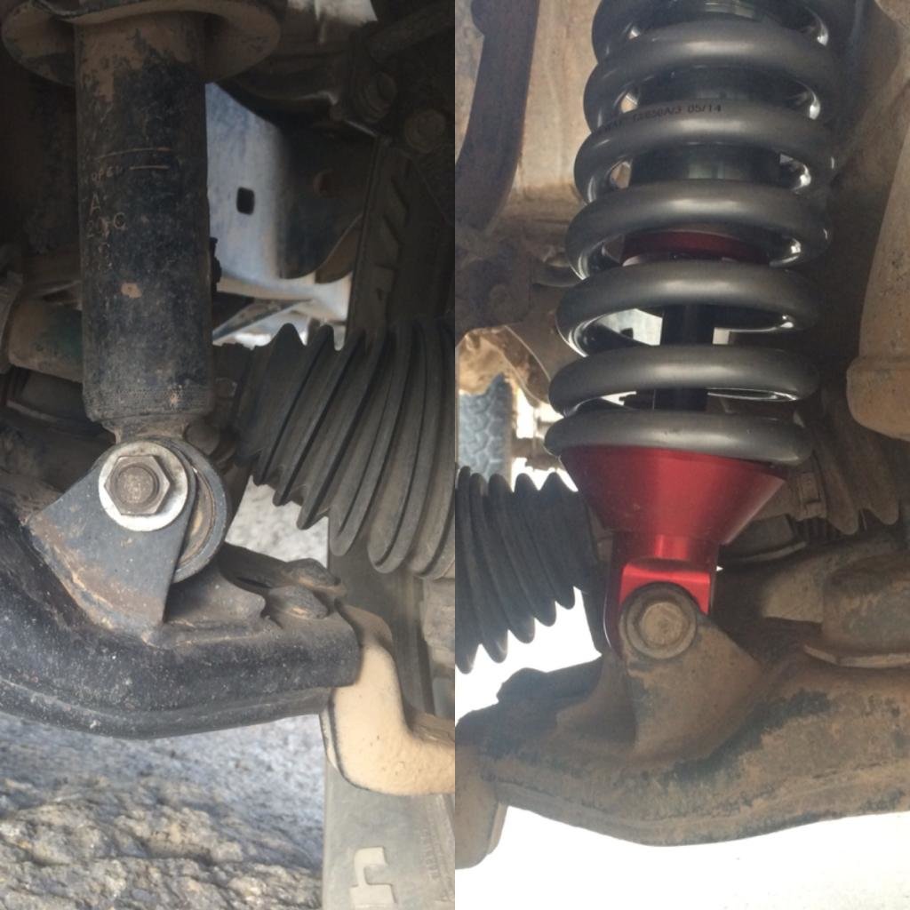

    - KYB Monomax shocks + 2.5"

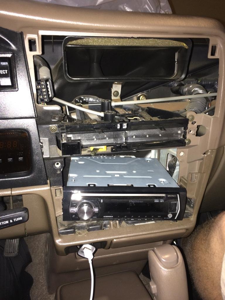

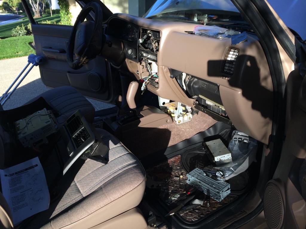

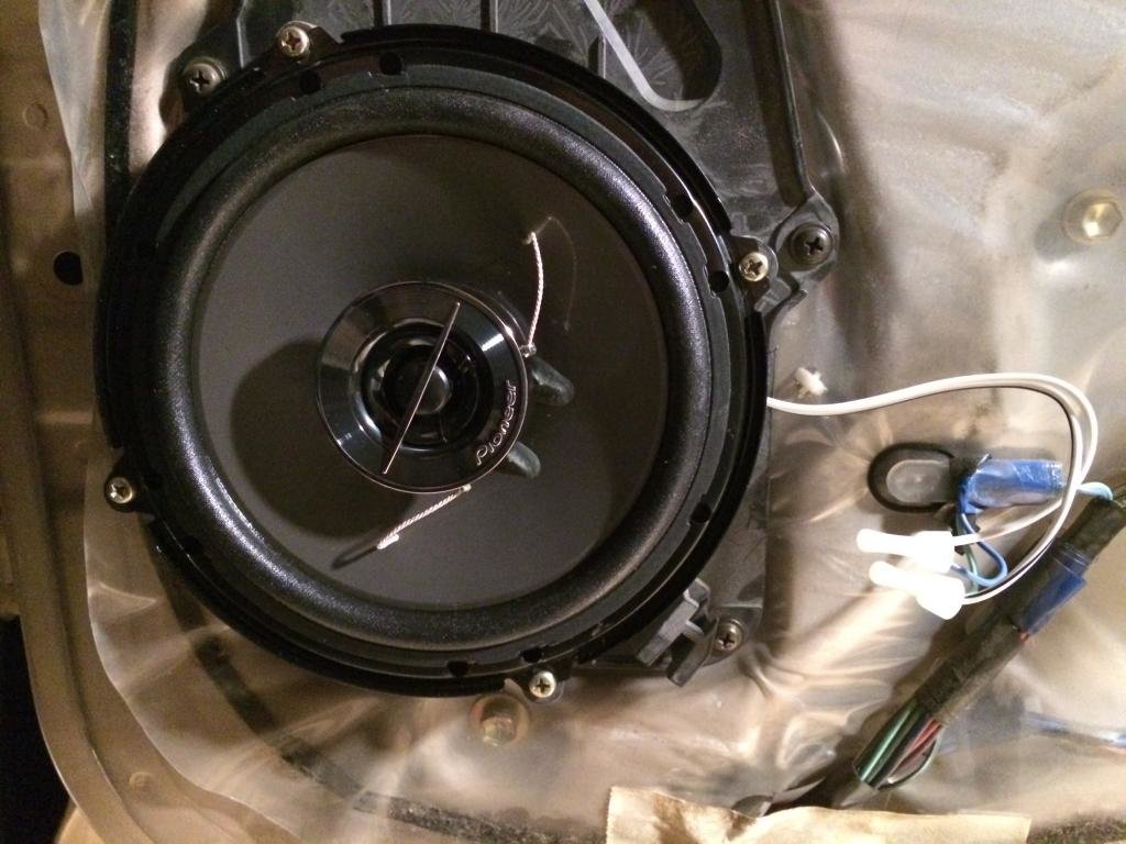

    Pioneer Deck/door speakers
    I had this deck in my Ford Ranger so I moved it to the taco. The stock speakers were garbage so I picked up some pioneers from best buy. I installed the speakers when I redid the doors. (Read below)

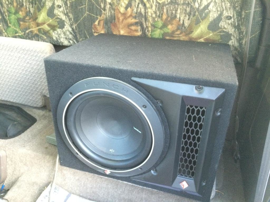

    Replaced my double 8" subs with a 10" Rockford P1
    27B9A0D1-4E9B-433D-8266-FD15D7D3623F_zps_725aef1589a92761b60d984edce3f6d39700e027.jpg

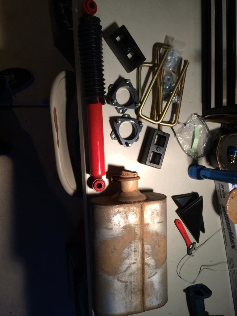

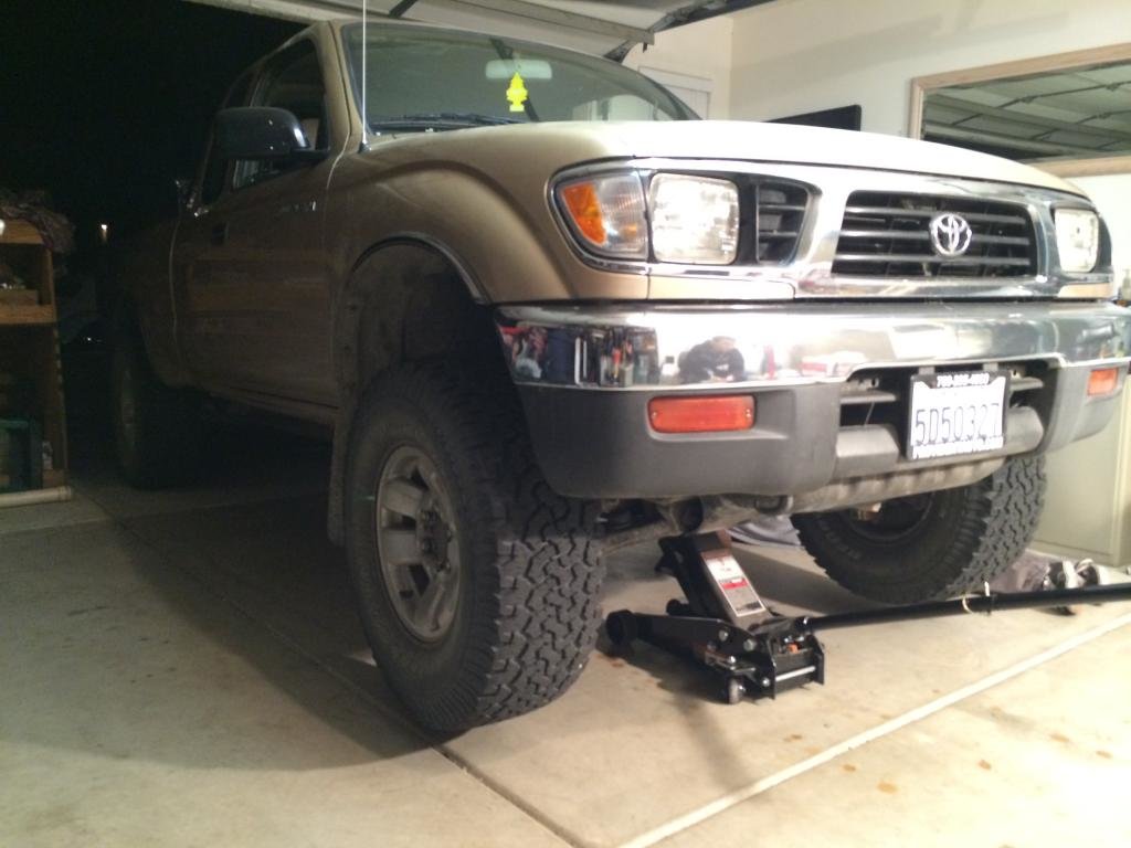

    First Lift

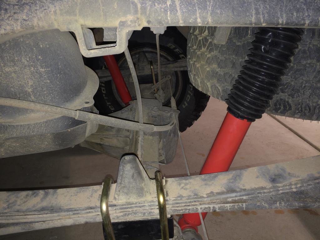

    Added new rear shocks and put on 2" blocks in the back with longer U bolts. To level the front I used 3" front spacers from ebay. The spacers were just temporary until I found the money for coilovers.
    KYB Monomax Rear Shocks
    Seperating the UCA from the ball joint proved to be quite difficult. I ended up replacing the stock ball joints because the ball joint seperator "pickle bar" mangled the rubber.
    Before:
    After:

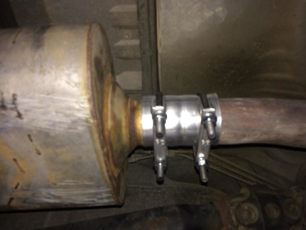

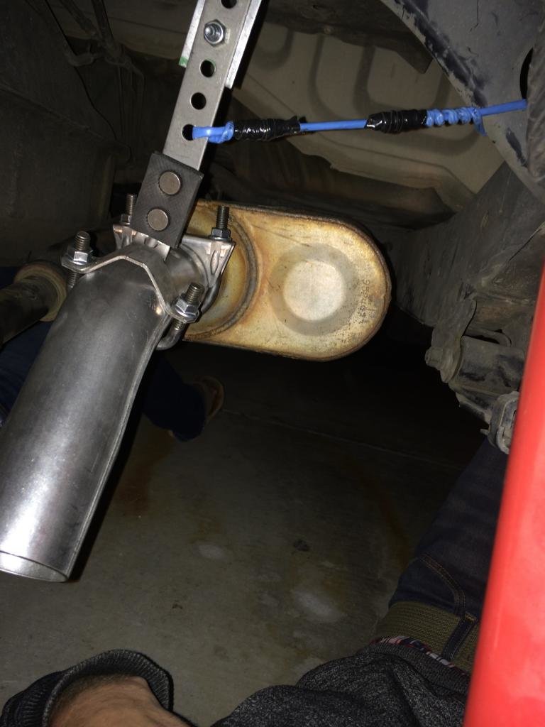

    Flowmaster
    My buddy gave me his old flowmaster muffler off of his rock crawler jeep cherokee! It had some rock scrapes and dings but nothing that affects performance. I decided to add a turn down just before the rear axel to maximize clearance and sound. Haven't had a chance to weld it on yet, so it's just clamped for now.

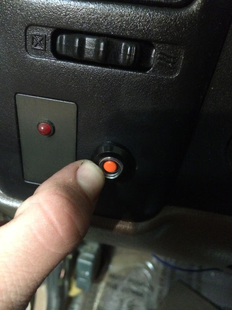

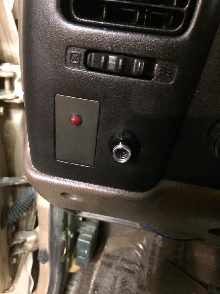

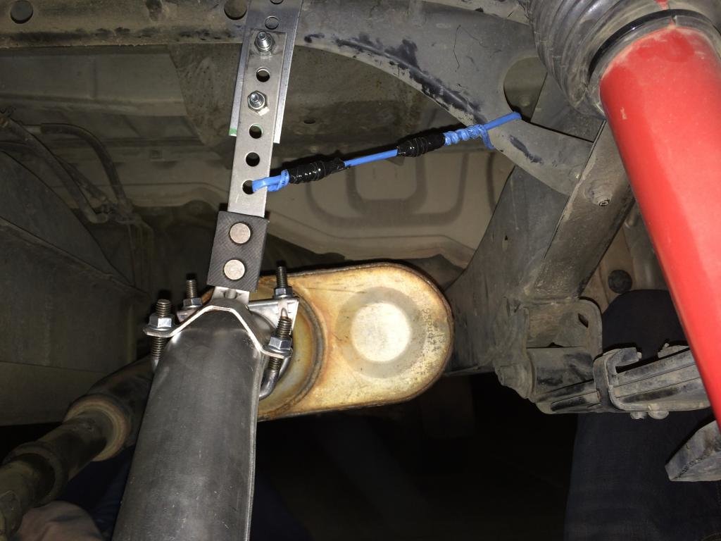

    Just for fun, Trent (tdoling12) and I installed a police siren under the truck. The button came out looking very nice and the siren itself is very hidden under the truck.

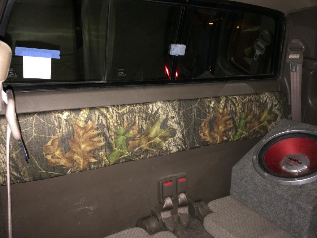

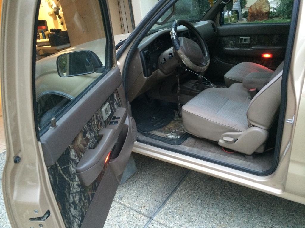

    Camo Interior
    If you have done this or want to, check out my custom interior thread!

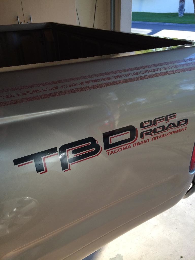

    Tacoma Beast Development Stickers
    Picked up some TBD stickers from http://tacomabeast.com/
    AE618CD2-499A-4761-ADAD-AAB348E54116_zps_31de5dc29ea655cd298fd2db3fdbc30514422e7e.jpg
    5B9BA8E2-B976-41AA-8314-454A1C78AEA4_zps_f8e0716cec04d949049425f2f40a6d9014bdcbfc.jpg

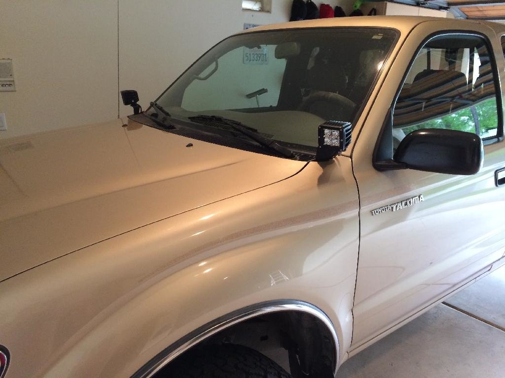

    CBI Ditch Light Brackets + Rigid Dually Floods
    I decided to go with the CBI brackets because they kept the dually’s out of my immediate vision. I did have to cut the plastic cowling to make them fit but they turned out pretty nice. Wiring them up was very easy.

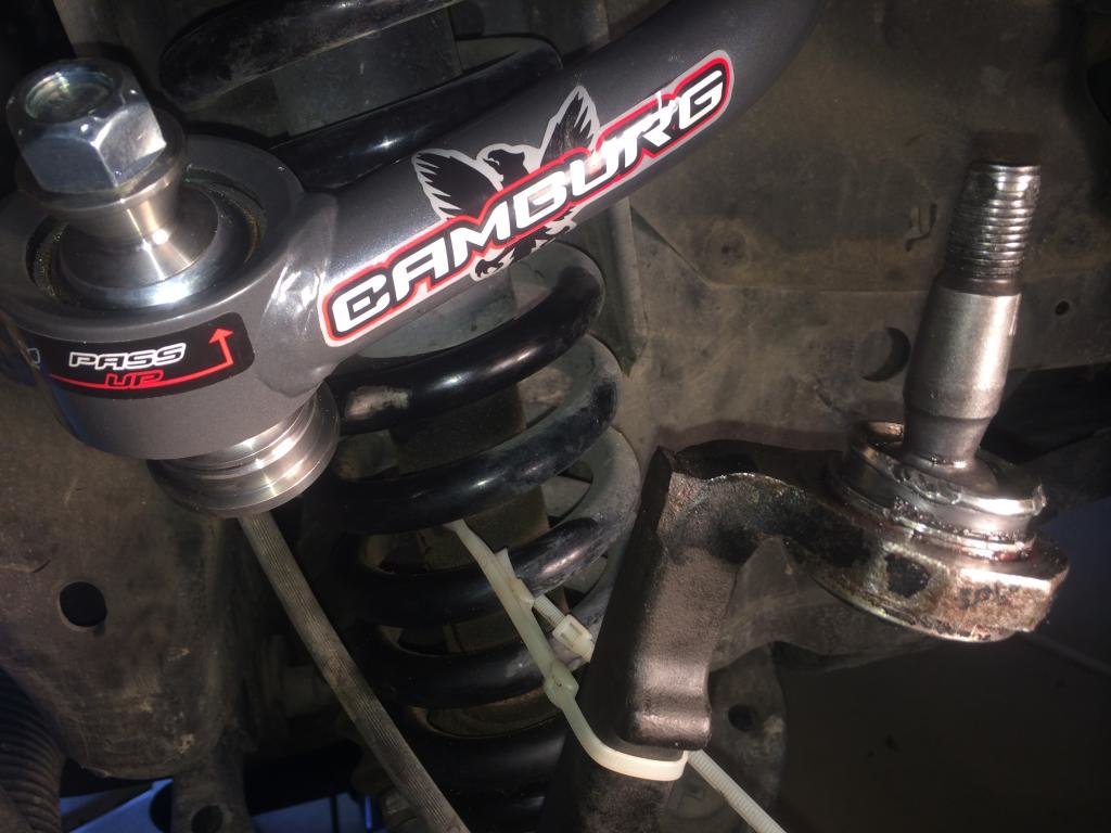

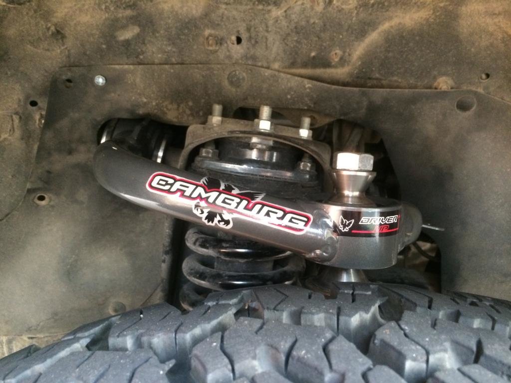

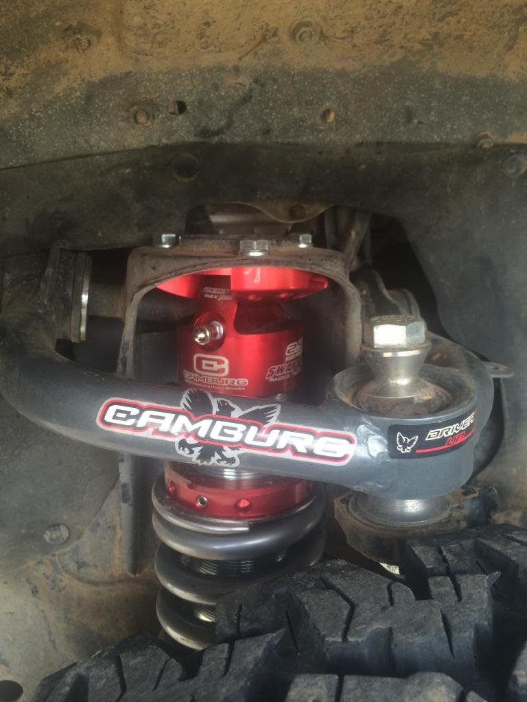

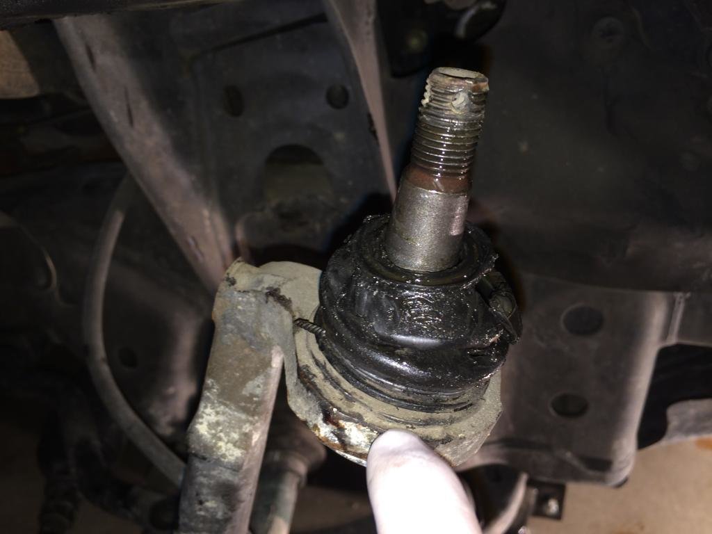

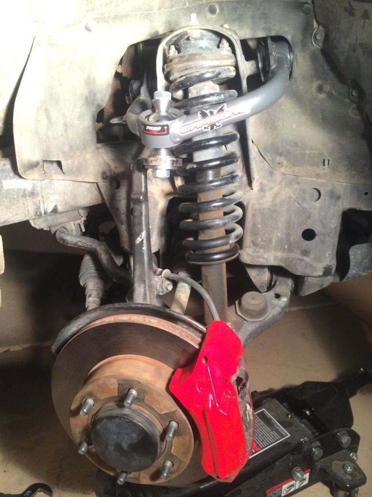

    Camburg Upper Control Arms
    I had a pretty bad alignment issue that I thought I could correct by getting new UCA’s. I went with Camburg Uniballs that I would suggest to anyone just because of how amazing it is to never have to mess with ball joints again!
    Goodbye balljoints. I hate you. :brianr:
    IMG_4571_zpsf94050ea_d27696367b8288749e58b9e3e4355bcdeac0649b.jpgIMG_4705_zpsef3213df_16695dee335ee65e560d61c5d5e41a7350858818.jpg

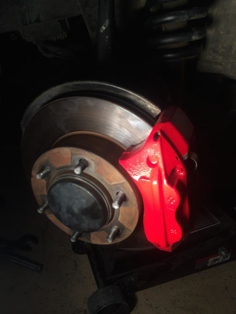

    Red Brake Calipers

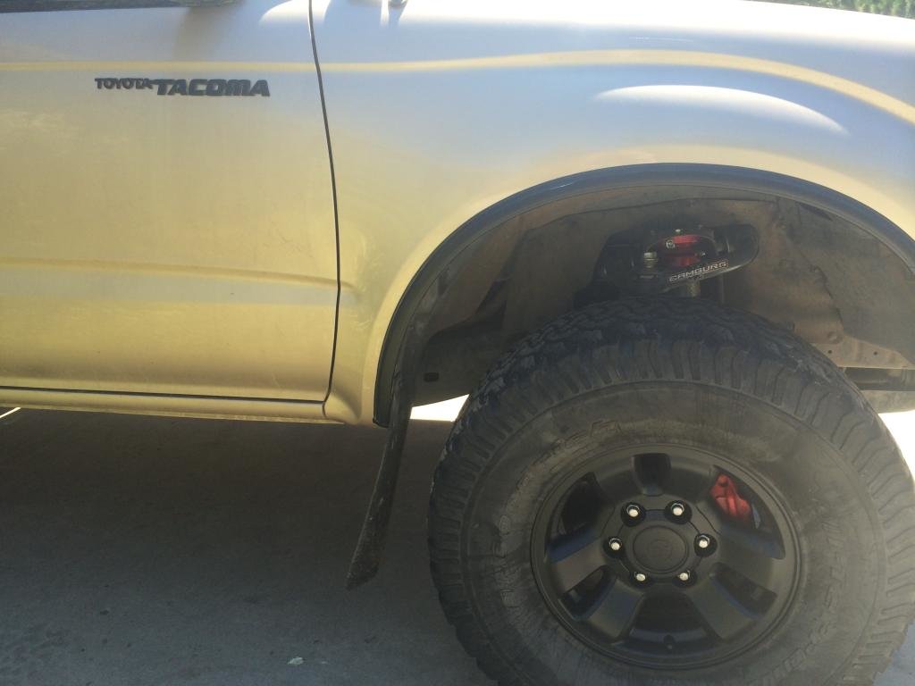

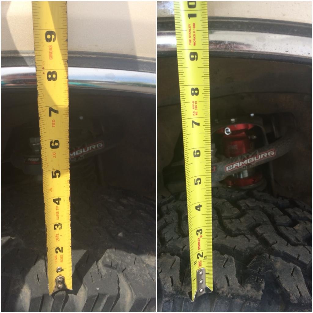

    Camburg Sway away Coilovers
    I wanted to stick with Camburg because I like the company and matching is always good! ☺ They are set to 3” and are no comparison to stock. They also gave me another 1.5” of front lift!
    ^The stock bushing was completely shot.
    ^Went from 7.5" to 9" of tire to fender clearance.

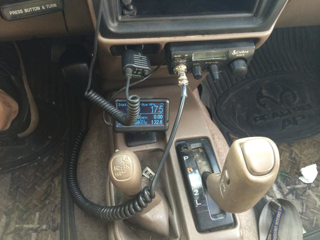

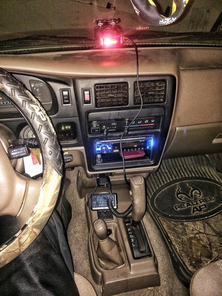

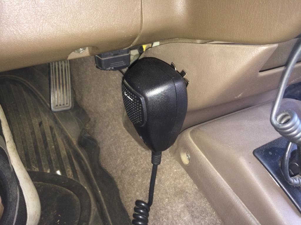

    CB Radio + Firestik
    I installed the cobra 19 in the common ashtray spot and mounted a 3’ firestik to the side of my toolbox. I also put a PA speaker under my hood and I use that more than I probably should. ;)
    714AABBC-8CF7-4D1E-8F6F-F0FA3AA43FFC_zps_055a04a481e3b39dbb8dad22e0449763a2f94978.jpg
    67A5FC87-8CC6-4236-9986-2E85F89C381C_zps_5fc16090374e64c52251140815a10b6bc5857213.jpg

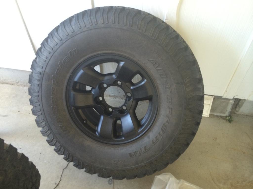

    Plastidip Errrything!
    I started with my emblems when I got the truck, then the wheels when I got the truck to Oregon. But then all the chrome looked out of place so I did my fender flares, front and rear bumpers, and my grille. It gave the truck a completely new look!

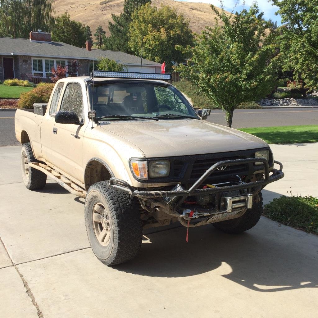

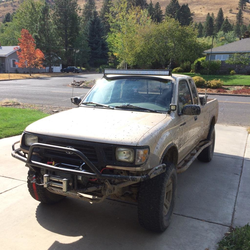

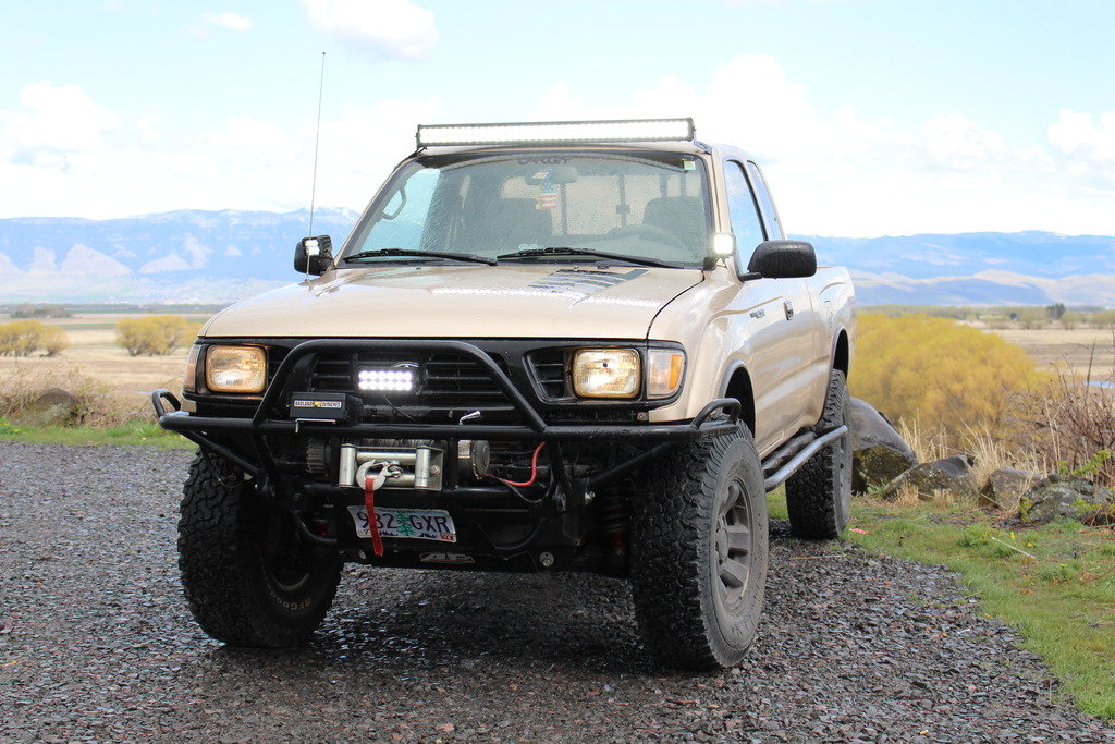

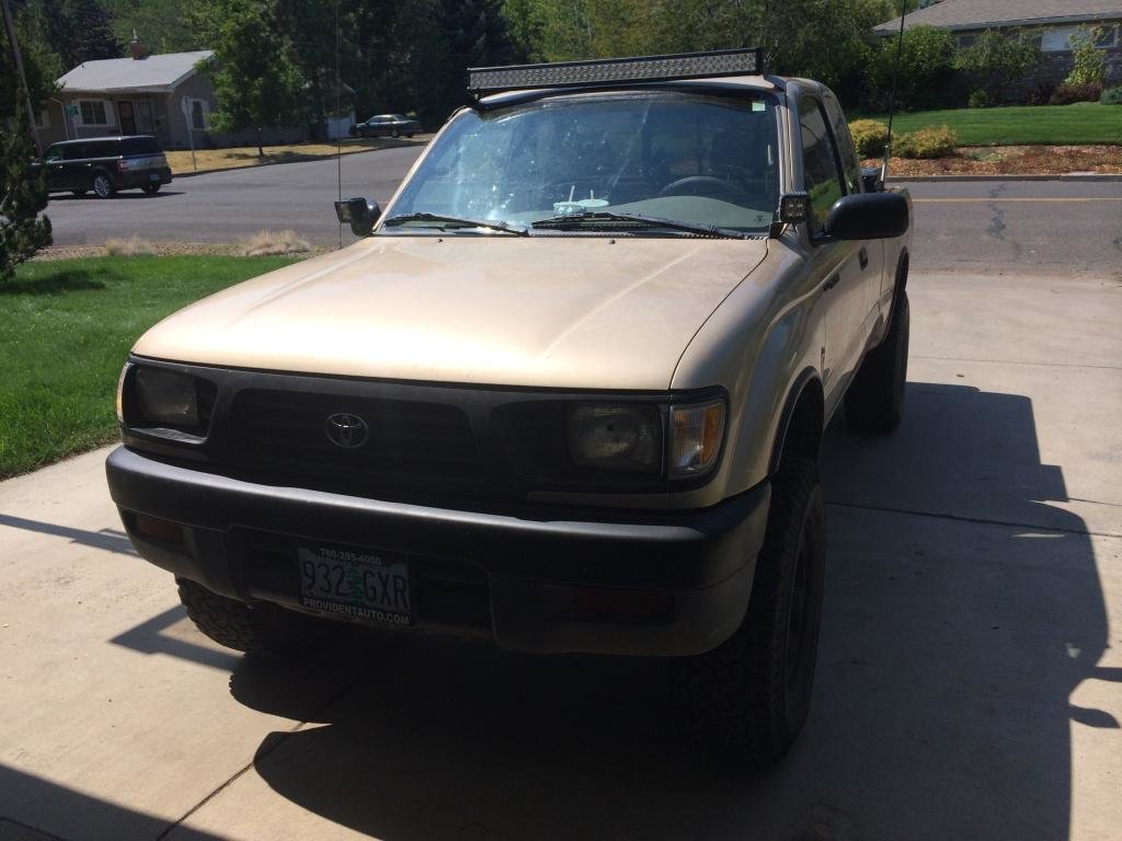

    42” Lightbar
    I decided to go cheap and get a lightbar from ebay because when comparing the output and rating to lightbars that were hundreds of $$$ more, I found they were usually the same if not a even little better (Obviously not better than Rigids or bars of that quality) I paid $130 for the lightbar and picked up brackets from All Four OffRoad in SoCal.

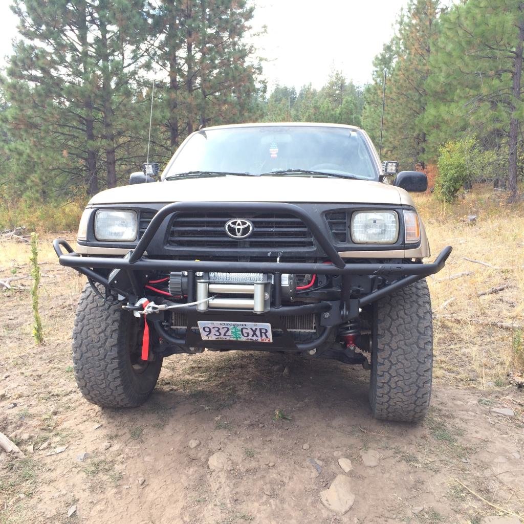

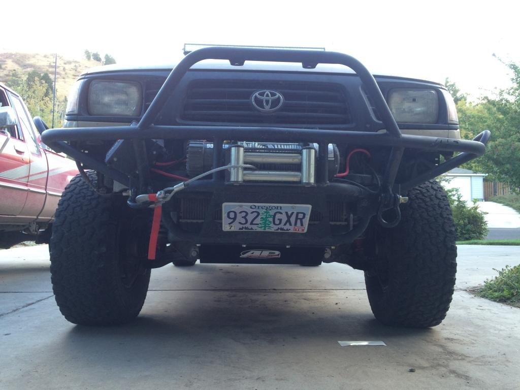

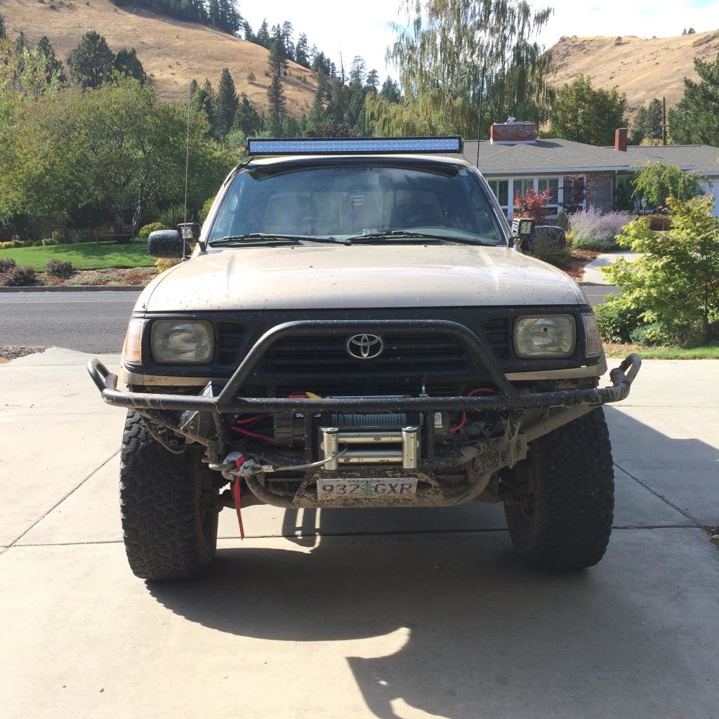

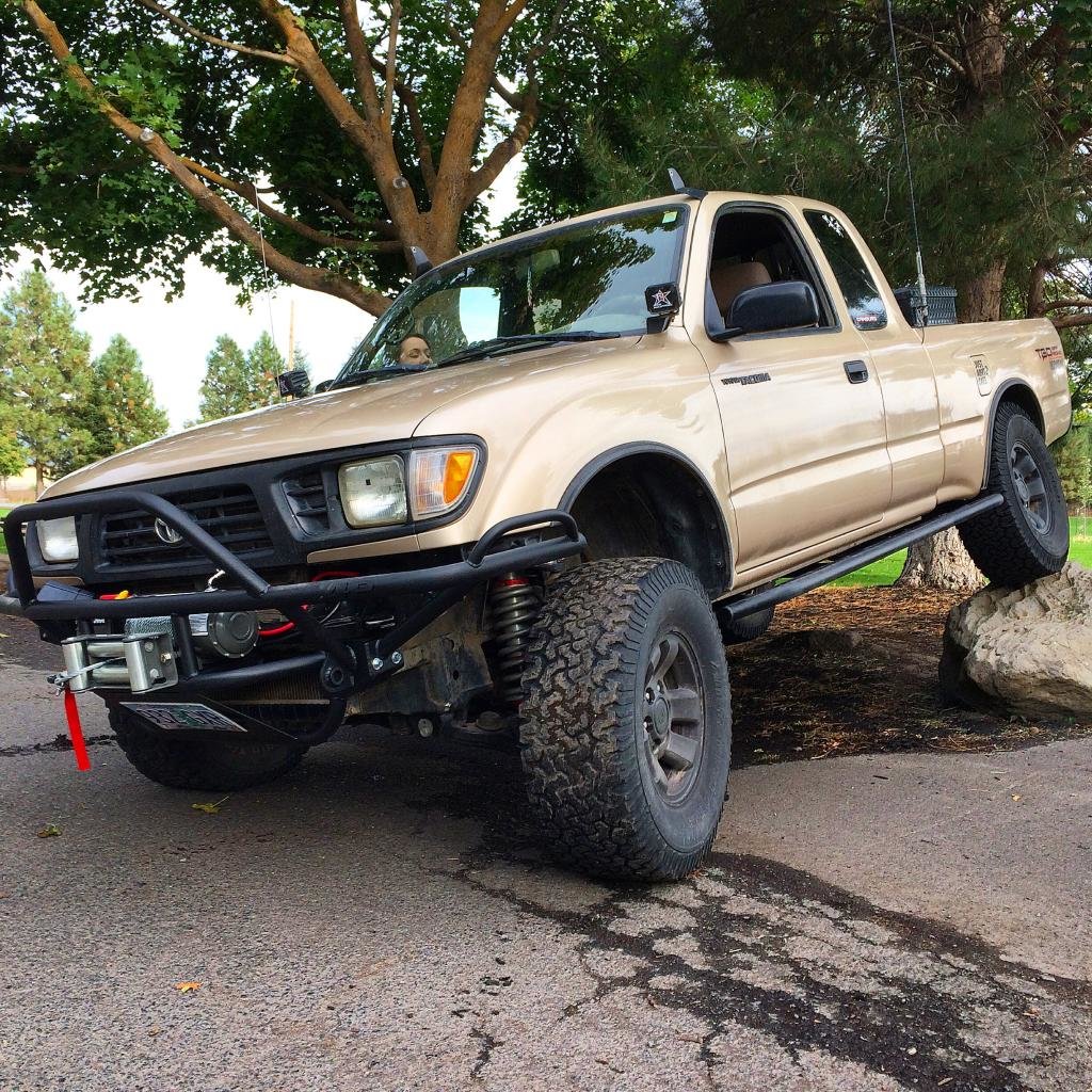

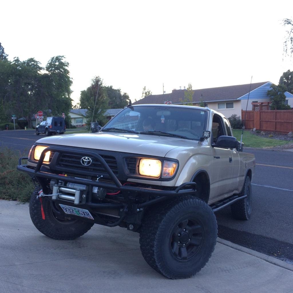

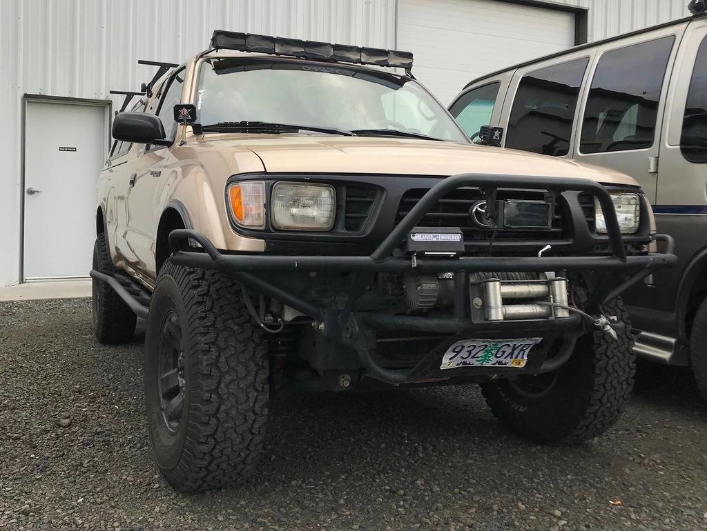

    All Pro Front Tube Bumper
    I finally decided it was time for a new bumper. I originally liked the look of the Apex bumper from all pro but the tube bumper has grown on me a lot.
    8C0E3D73-D222-4DF9-A11E-1DC4D6C4841E_zps_849a2233374270b750998b73f8ba1f4ebdff8bd7.jpg

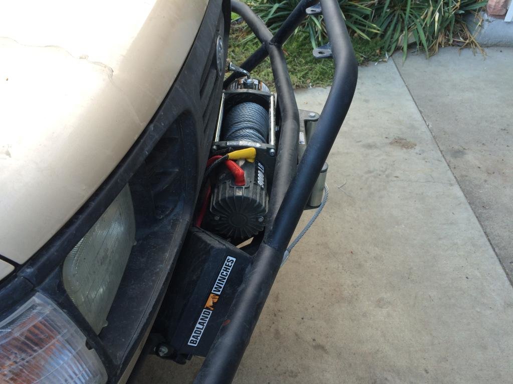

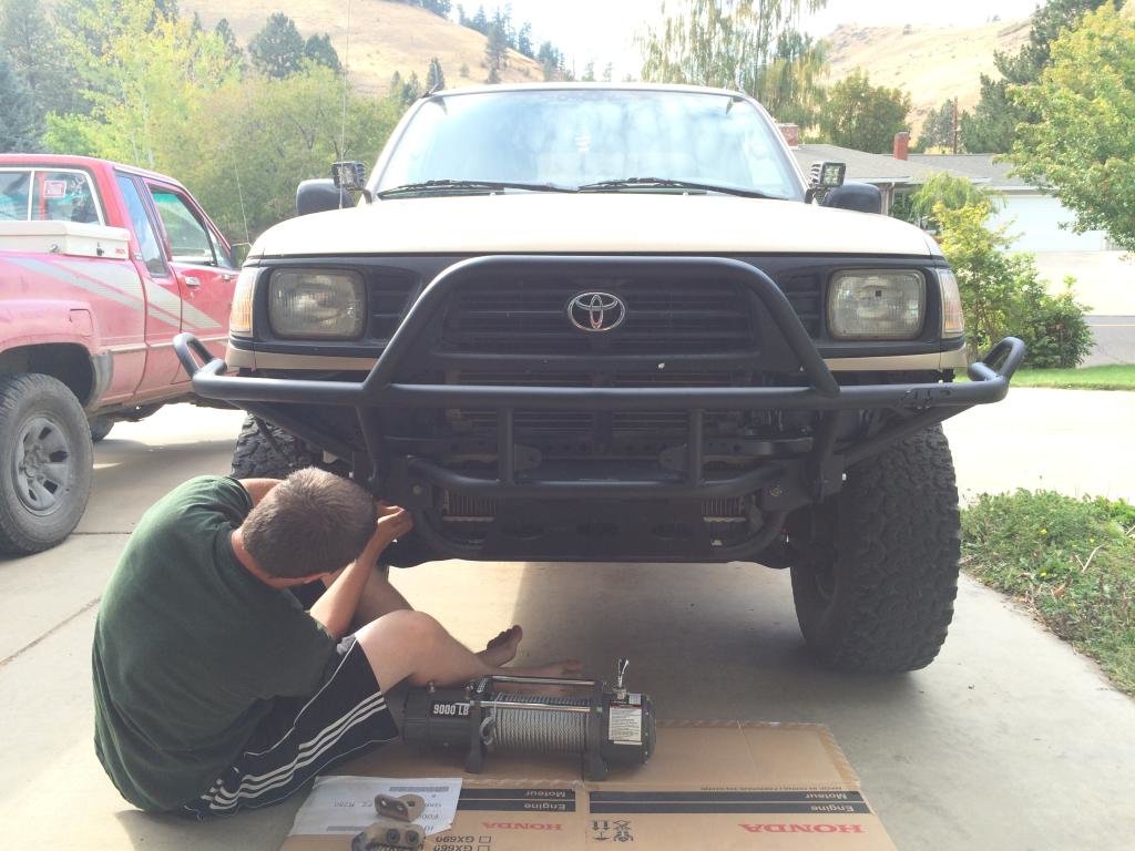

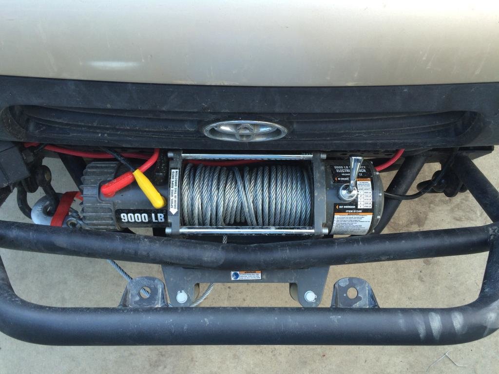

    9,000 lb. Winch
    Yes, I went with a cheap winch, but so far so good. #brokecollegekidprobz
    8338A35B-5846-48EF-9F68-2B83A5DC9FCA_zps_82f1990263ed2786c4fdf5485dcca654c47ac04a.jpg
    9B4B6821-0A39-48E4-9151-873DF42C6963_zps_137ef8222b3eec44b6906fd655cabec56f8504ee.jpg

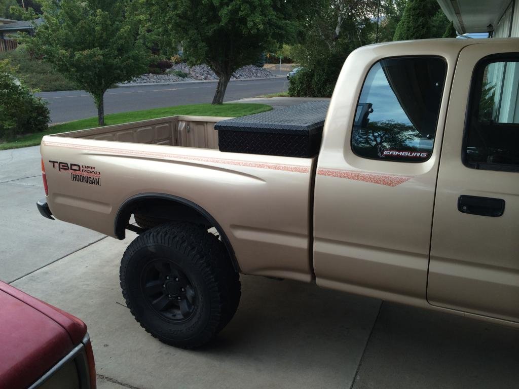

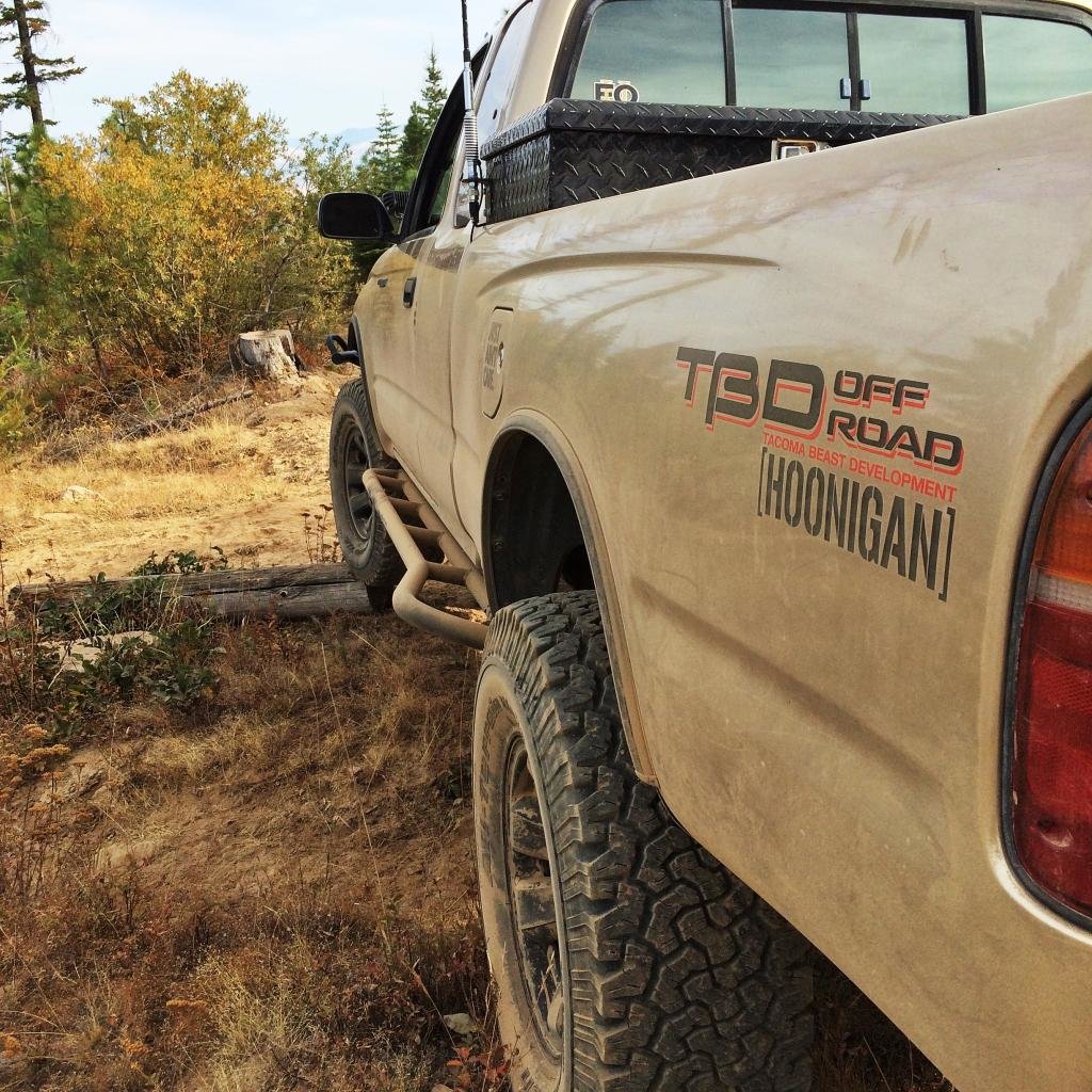

    I added a few Hoonigan [Ken BLock/ Bj Baldwin] stickers to boost HP and figured it was time to get rid of the stripe. After I put on the "Hooningan" and "Just Aint Care" stickers on, the stripe made it look too cluttered.
    Before:
    BCF3CD73-D624-4E37-9E5D-AAA4A173F8BC_zps_e15e11cf686d00871dac16f9b742699b5f063df1.jpg
    DED19D53-8213-437B-A4EF-EC80BC89FB19_zps_83b9d7b8bfba8c8faa395b70fe8a99264d9e534f.jpg
    After:
    7D5A4C7C-07C0-42D1-BE6E-253CBCBCDED0_zps_123d406e0499a0e368ef7a49eb489c42325407a9.jpg

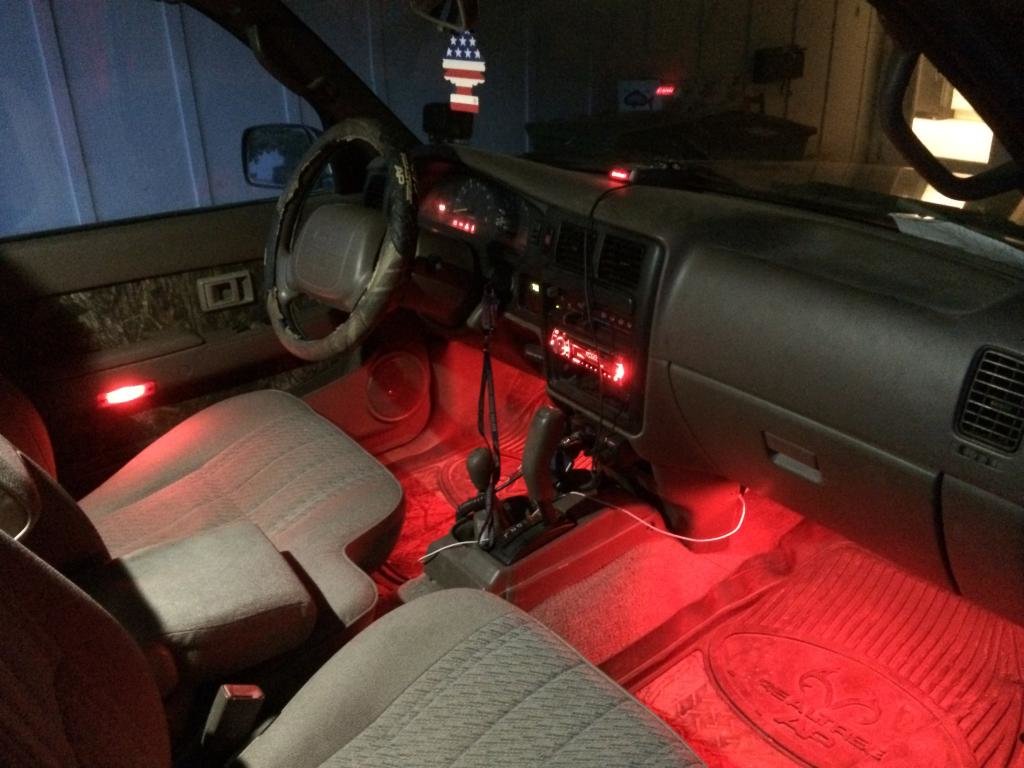

    The truck needed a little bit of rice so I put some red leds in the footspaces.
    B8E1EB5C-AC97-4E34-9E6F-406355C9F7AA_zps_9d8ec554b15baea6ce88e918f40ec42b82d20dcc.jpg

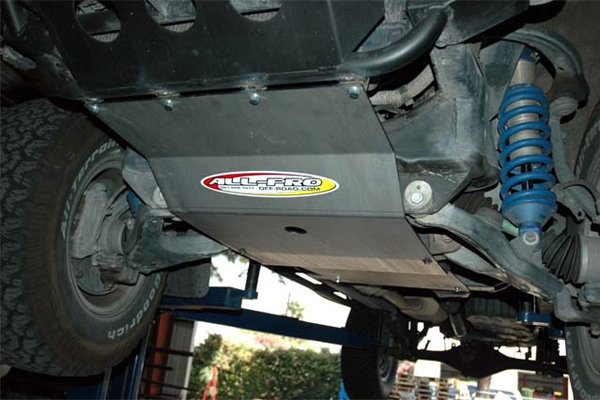

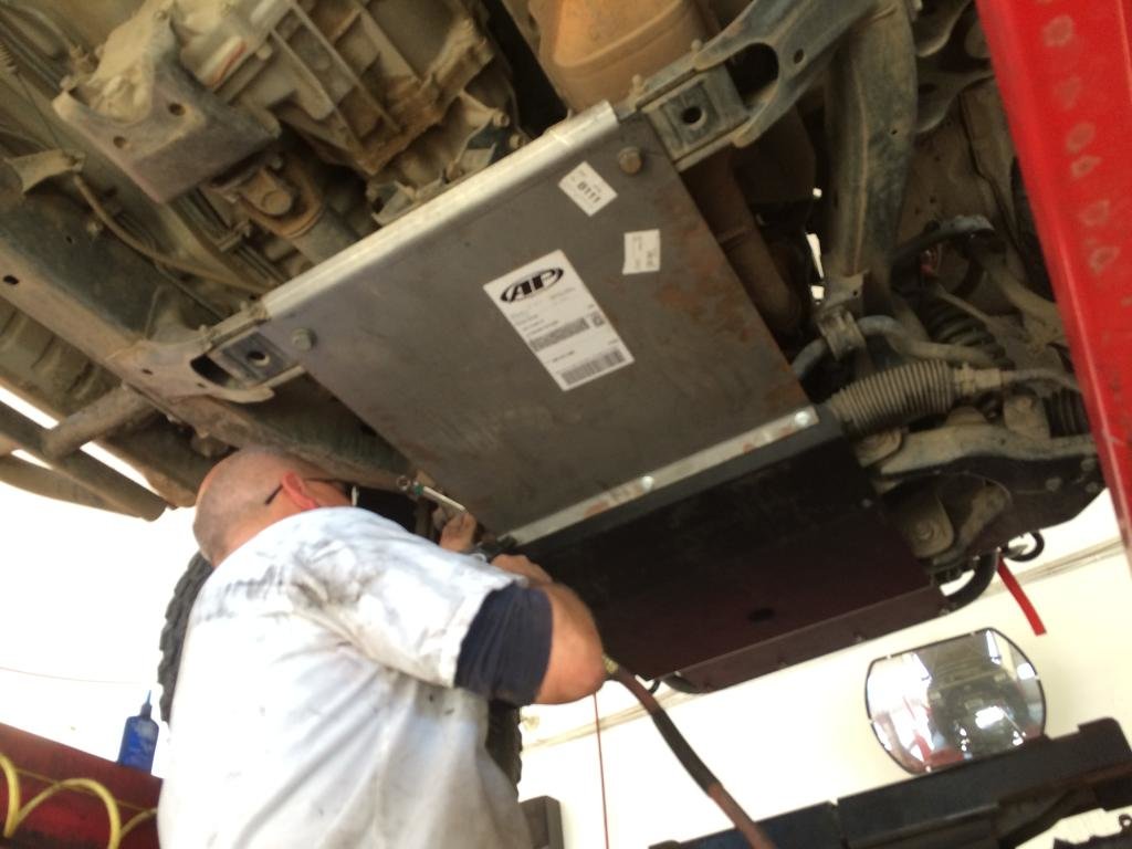

    Just realized that the stock skid plate will not fit with the All Pro bumper so I ordered the All Pro Skid plate combo as well.

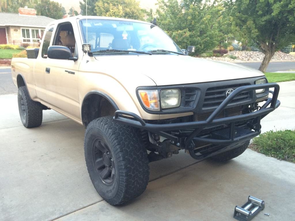

    I had a local shop powdercoat the bumper and sliders, and we got them all bolted on.
    8C521D61-370E-45D6-B8E1-4E1159B2F484_zps_27d75d37156454f55fb863179da9d4bbb928b7f6.jpg
    F2729DAE-FCE4-4D9C-944D-CB9FAB6A4F5E_zps_e49e1cb879c6afc6916d7ca7328bf9e53737a1e8.jpg

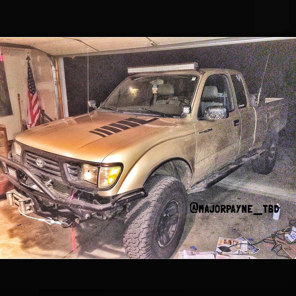

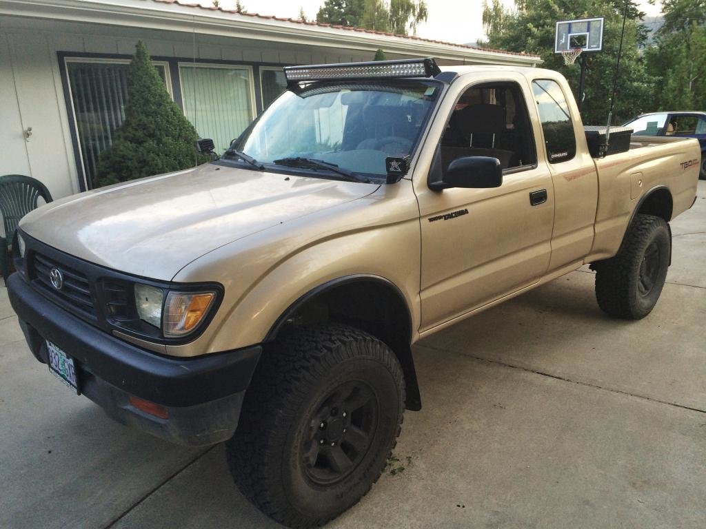

    The 1st lightbar I got, had 3 leds out so i sent it back and the new one finally arrived.
    7450ADF1-9E2D-48BE-848B-B45C77EAF91D_zps_9cb2769a37064ae4eb734379749d76aa758a6cab.jpg
    BE07C3BD-4796-4E11-AEE8-B407845687AE_zps_7ba2b57be1fa23607b9e211dd6364a06752a53e7.jpg

    Build is looking good dude! I'm liking the light bar up top.

    Skid plate combo from All Pro
    AE29E97B-C80E-4431-8C5C-B571308133D0_zps_2401b7271a32990fe52d60097dea3baf1042ad67.jpg
    0F20ED66-5949-4F36-B405-C50E0254E73E_zps_4bae4451ba1bd93efe1d9e13efbc1db709687439.jpg
    414023CE-46F5-49A0-B24F-73C6C83F6608_zps_f06b9c7f3e576f5e3f17b577638980a5822e34ec.jpg
