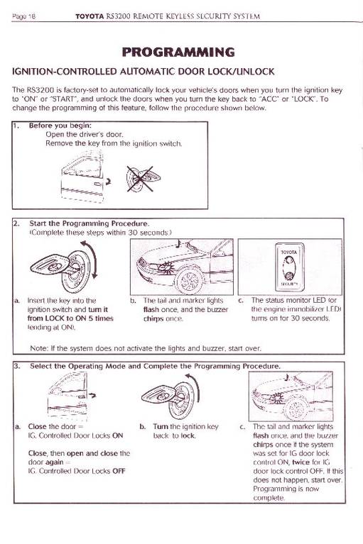

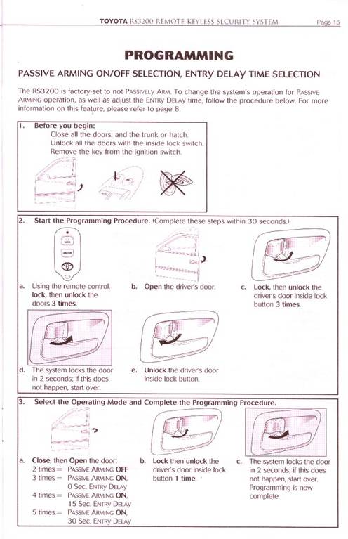

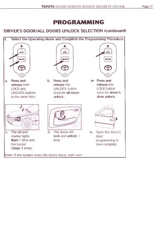

    I have the VIP RS Series (I believe).

    well 007 i apreciate the info but my alarm isnt the same. i would like for it to chirp and all and i tried the methods u posted.....no success tho. i guess the next thing 4 me is to contact the dealer and see what they say. u wouldnt by any chance know of any other methods for other alarms would you?
