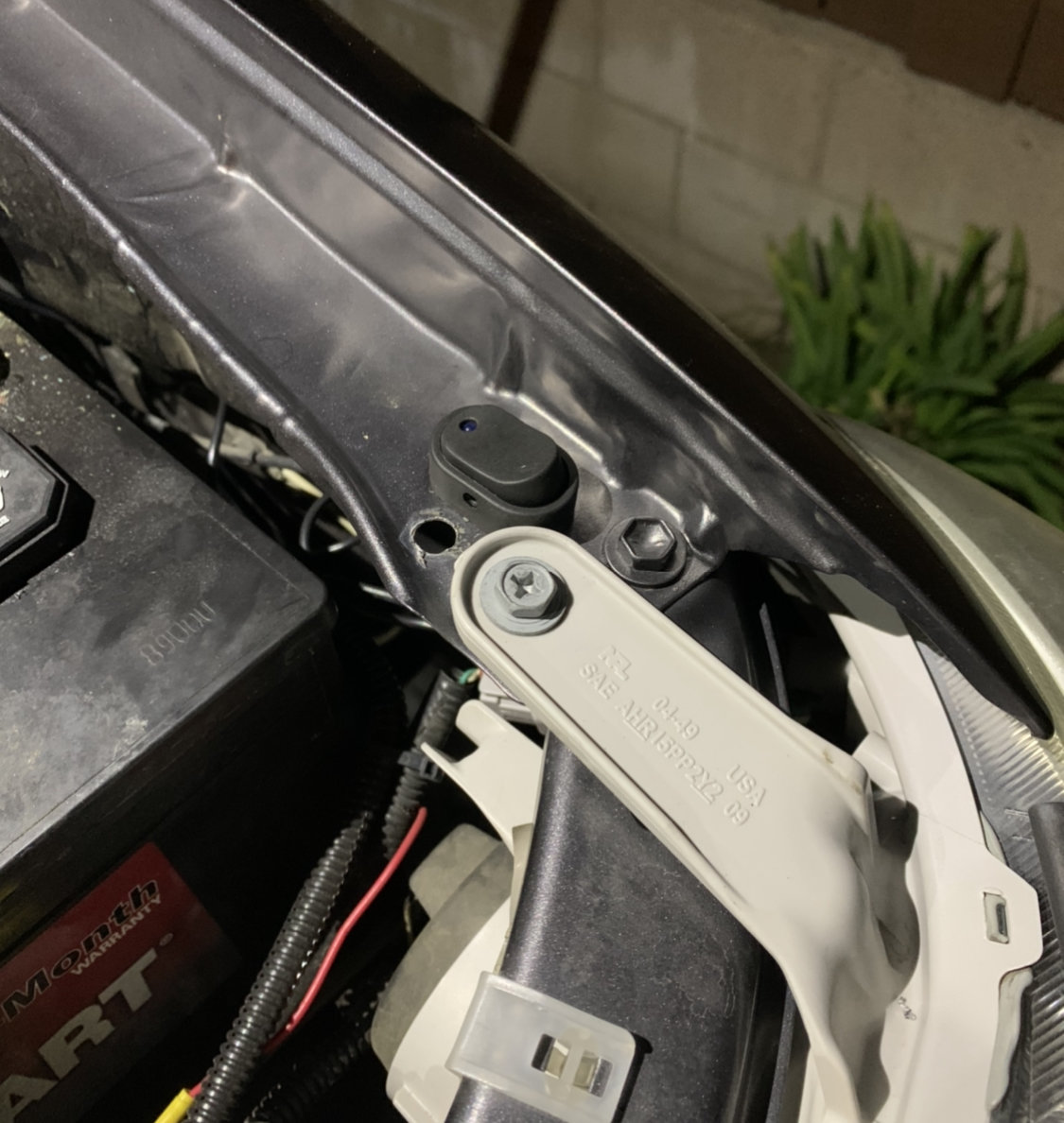

    Ditched the pressure release switch for a standard switch today. The contacts on the pressure one get dirty too easily, then it interrupts your ground.
