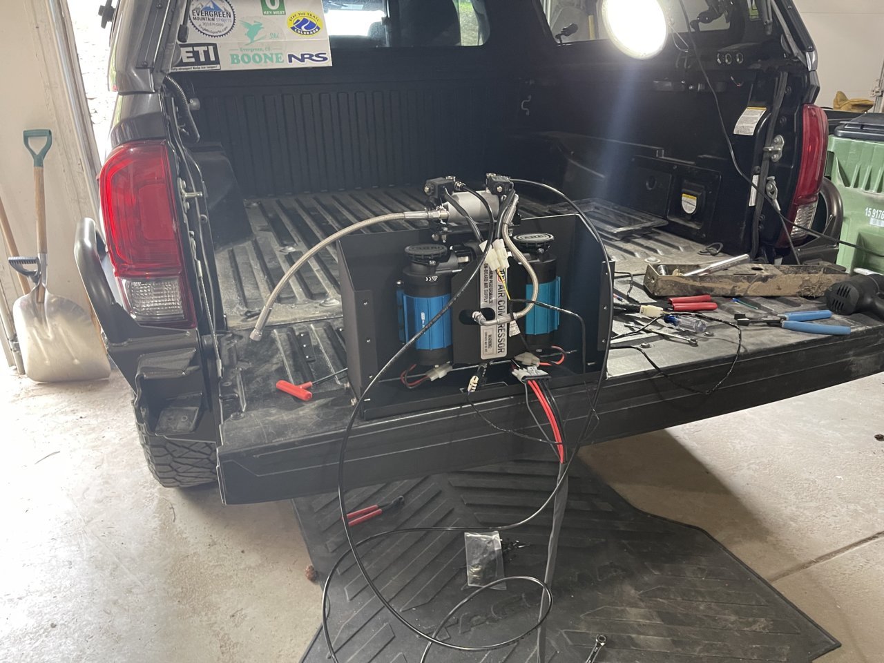

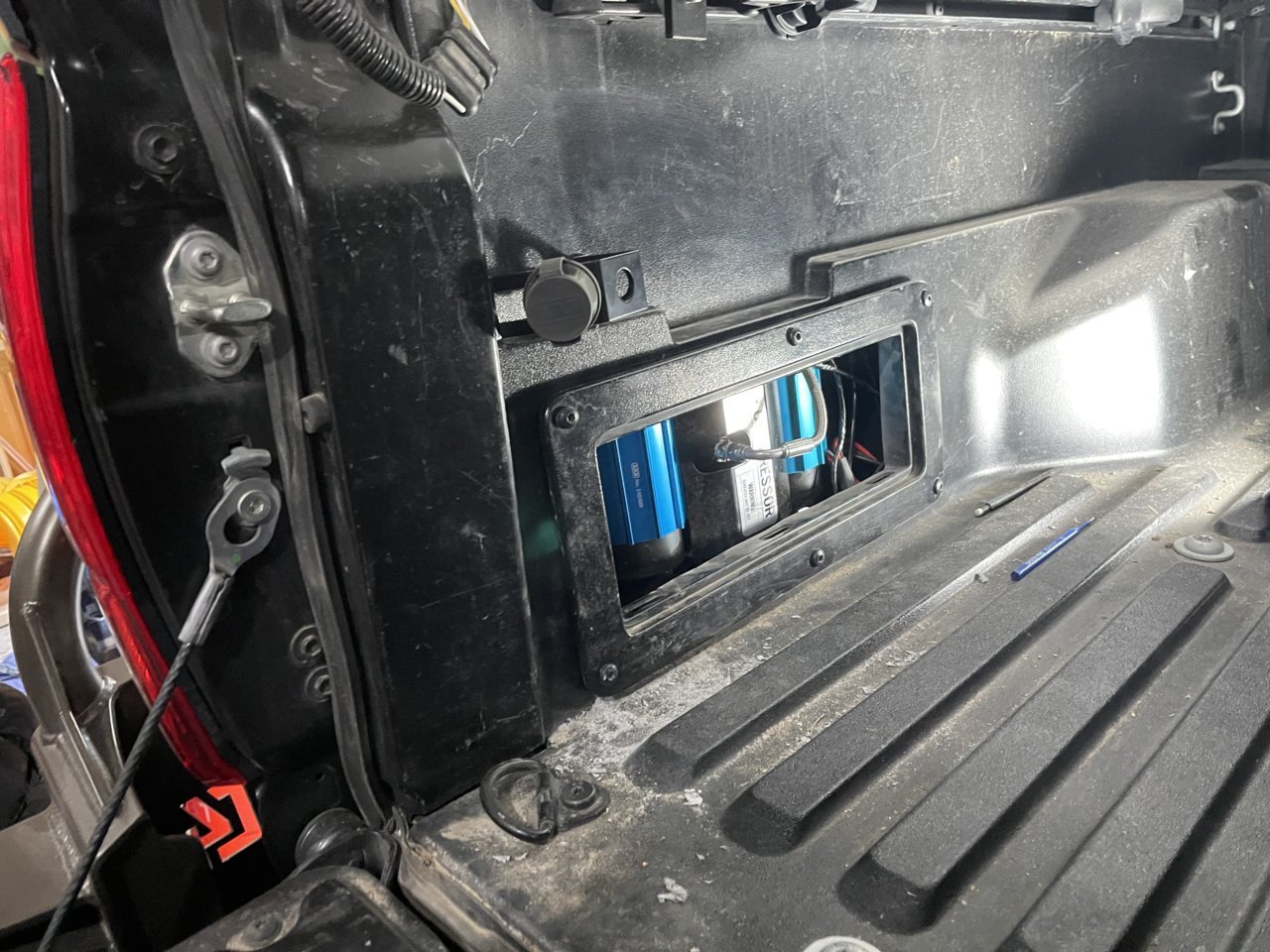

    If you have the bed storage you could install one of these. Just have to run power to the back.
    https://expeditionessentials.com/products/toyota-tacoma-bedside-compressor-mount
    Interbeing likes this.

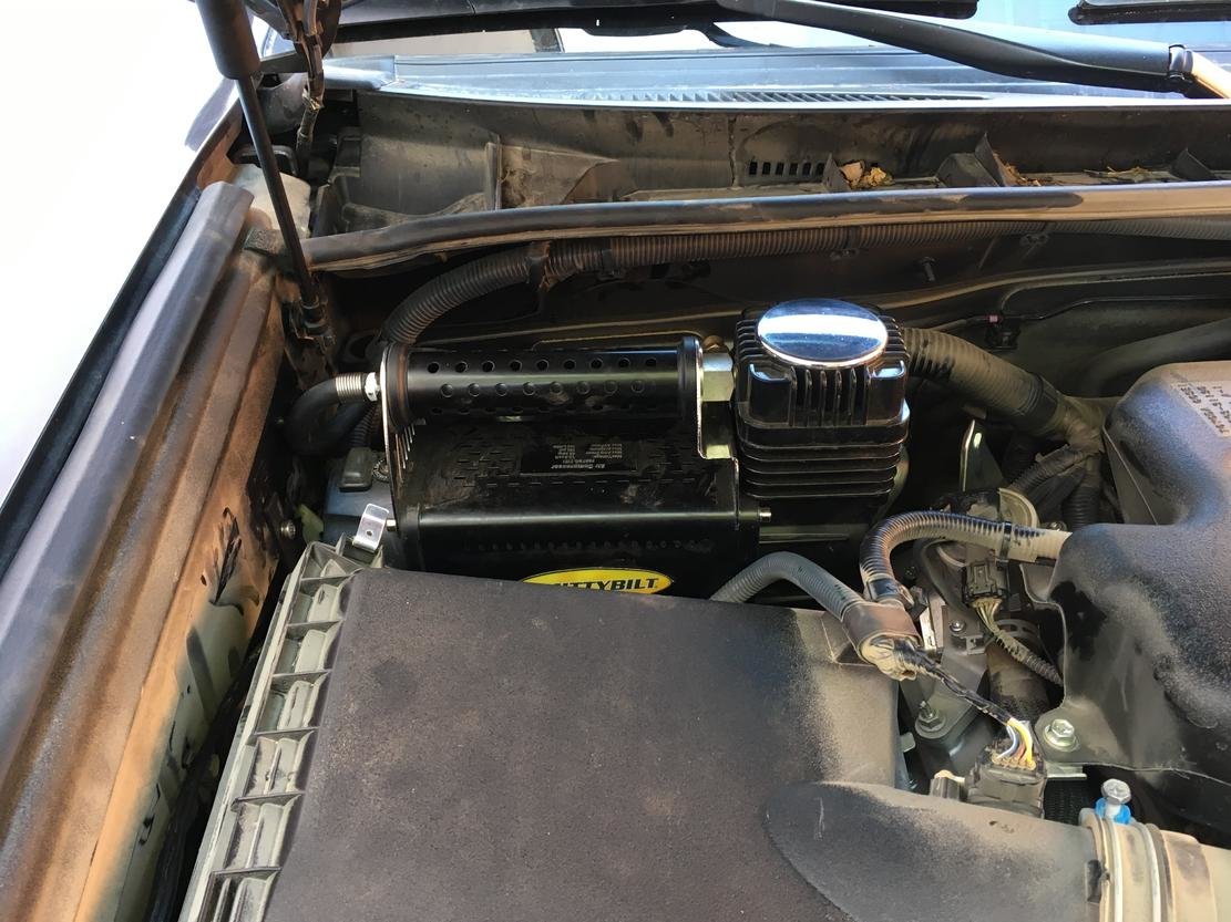

    just do some googling. Looks like you could mount it to any onboard air bracket and put it by the air filter housing.

    I don't have any links. Just did a Google search for "smittybilt air compressor in tacoma engine bay" and that's what's popped up, ha. More than likely you'll have to just grab a bracket and see if it will work or just modify one so it will. A lot of those brackets should work for multiple compressors.

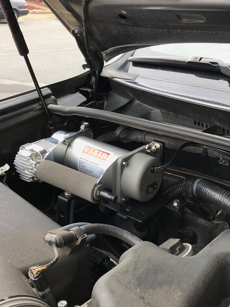

    I have my Viair in that location, but I made my own bracket. I’m no fabricator but it was easy, cut and bend with no welding. There are several unused threaded inserts and studs to tie into.
