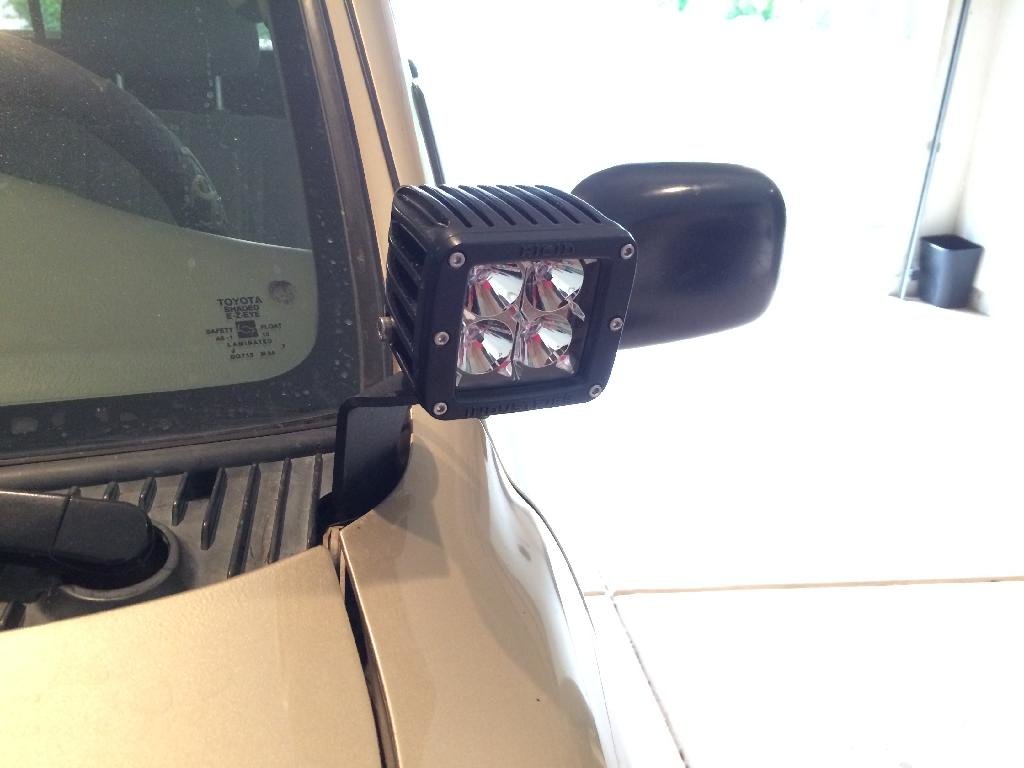

    Just the first mock up. Simple arm bent to fit around the hood. Mounts to the hood bolts. Will paint it and make it look nice. But what do you think? See any issues doing it this way?

    Some more mock ups

    Great idea, just concerned about how tall they stand and I feel like there might be visual issue looking out the windshield.

    I have the same concern. Might try cutting the bracket down another inch or two. Not sure if will help though.

    Finished. Just got to touch up the paint. Total cost was about six bucks a bracket.

    Looks ok. For not much more you could buy really nice brackets that, in my opinion, would make it looks more clean.

    Sometimes you have more pride when you actually build something instead of letting someone else.
    This is cheap, easy, and got the job done.

    How do you have the bracket mounted to the truck? Can you post of pic w/ the hood open? Thanks

    The hood opens all the way or does it push the light into the windshield? Most mounts I see offset to driver mirror more.
