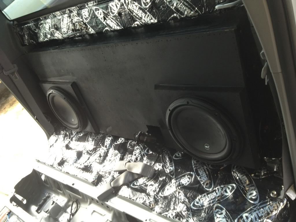

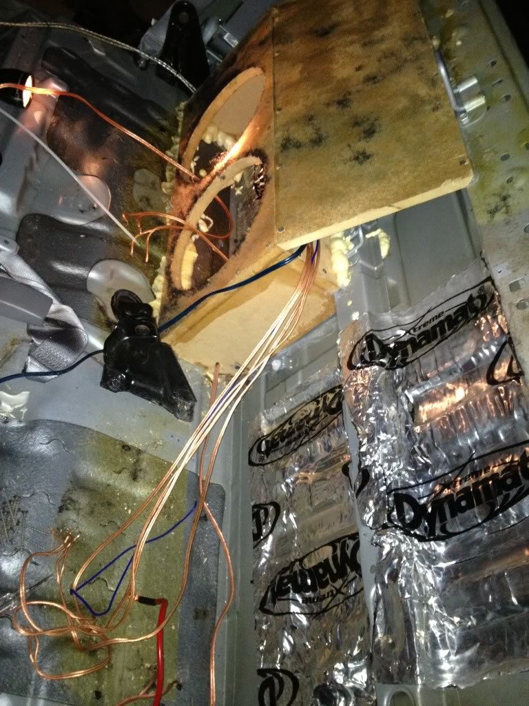

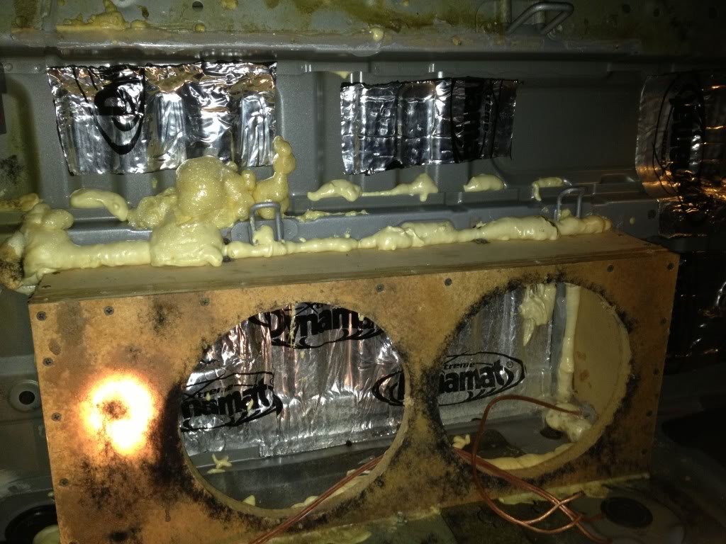

    Here's the "box they built me with the back "fully dynamated" like I asked.
    I had to redo the door speaker mount as they incorrectly made one. One of the screws wasn't even in the wood. I'm so pissed I let them do anything to my truck.
    A close up of the box
    Here's a quick one with the box installed, actually fully dynamated. It's a rough mount.

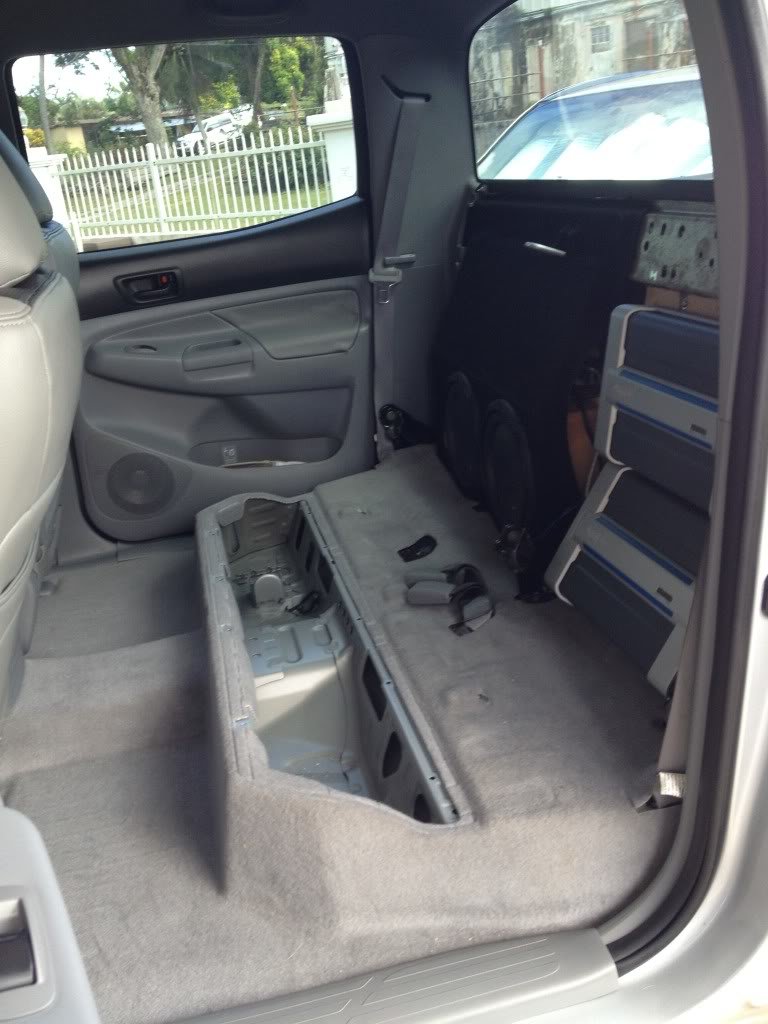

    I have the plastic cutout to go around the box installed and started making the amp rack for under the seat I'll get pictures of that when I can. I had to start fabricating so much that I ran out of time this weekend. About 6 runs to home depot to get new bolts, more wire, and random parts that I needed now that I'm remaking and fabricating new parts to make my truck quality once and for all.

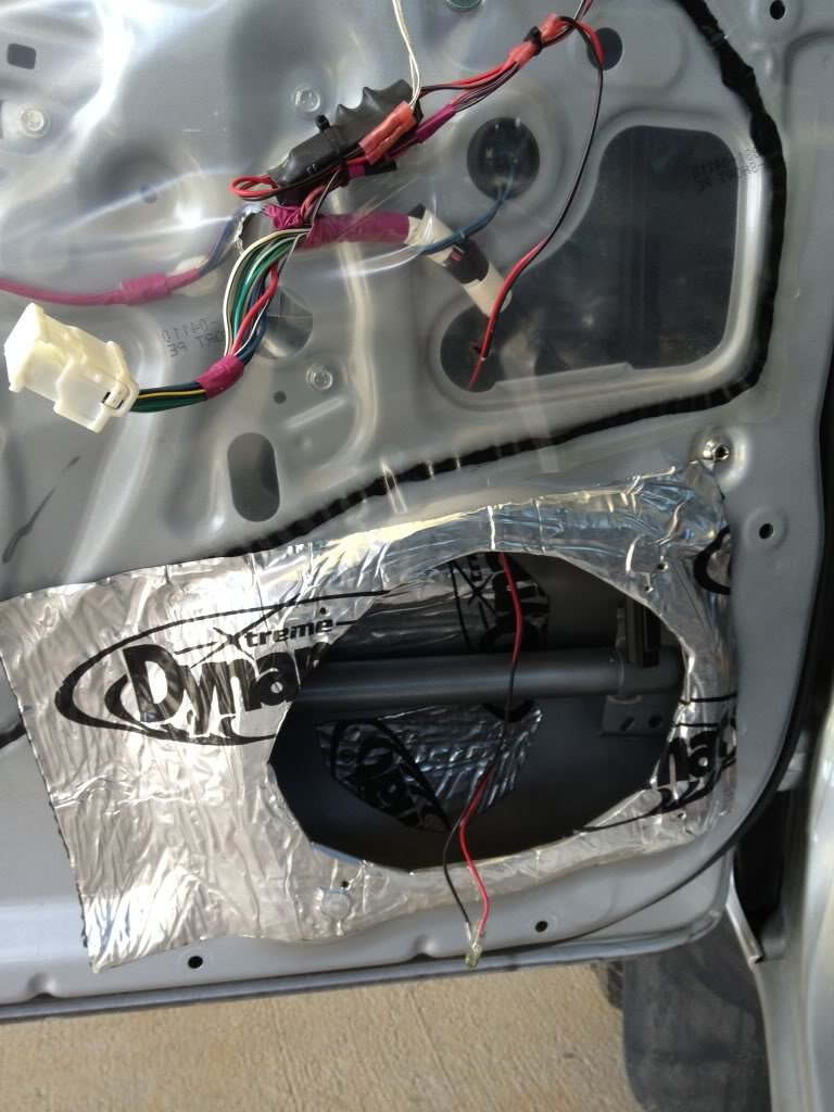

    I got a question for ya'll. So when I pulled apart the door I found that the speakers they installed are the infinity reference 9633cf 3 way speaker as well as a tweeter. does anyone know if this added tweeter actually helps out or if I should just ixnay it?

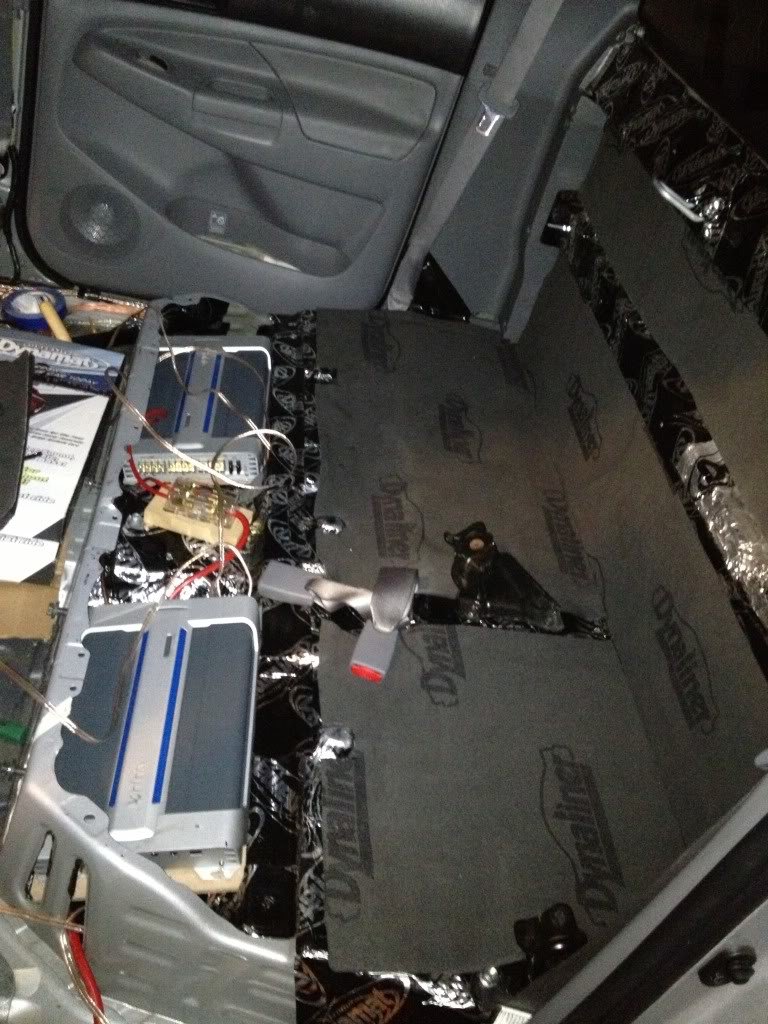

    It's a crappy picture but I got the dynaliner installed for under and behind the sub box, as well as the basic placement/mounting location for the power spliter, each amp, and the grounding location and bolt placed. Loooooong slow process. I'm taking my time and doing it right so I don't screw up something I can't fix.

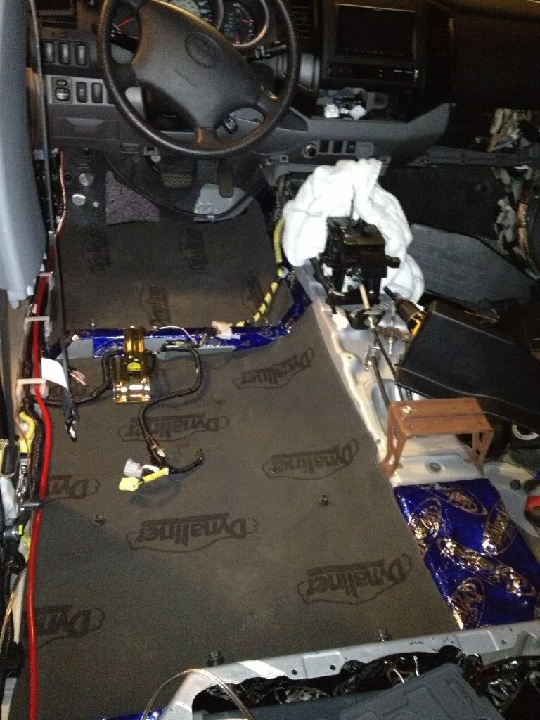

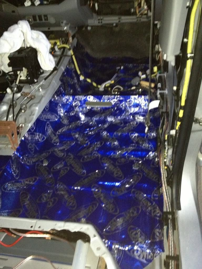

    Tonight's task you ask?
    Use these to make this beautiful
    And then dynamat the driver side and lay a layer of 1/4" dynaliner over it.
    One tip for people doing this that I've found. Leave the bolts in place and when you lay the dynaliner down you'll know where they are and make an cut with an exacto atop the bolt. The dynaliner slides nicely over the bolt in perfect form!
    That's all for tonight. Tomorrow is the other side.

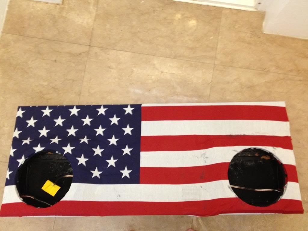

    Get your thoughts on this idea though. I'm thinking of using an American flag instead of carpet over my box. What do you all think?

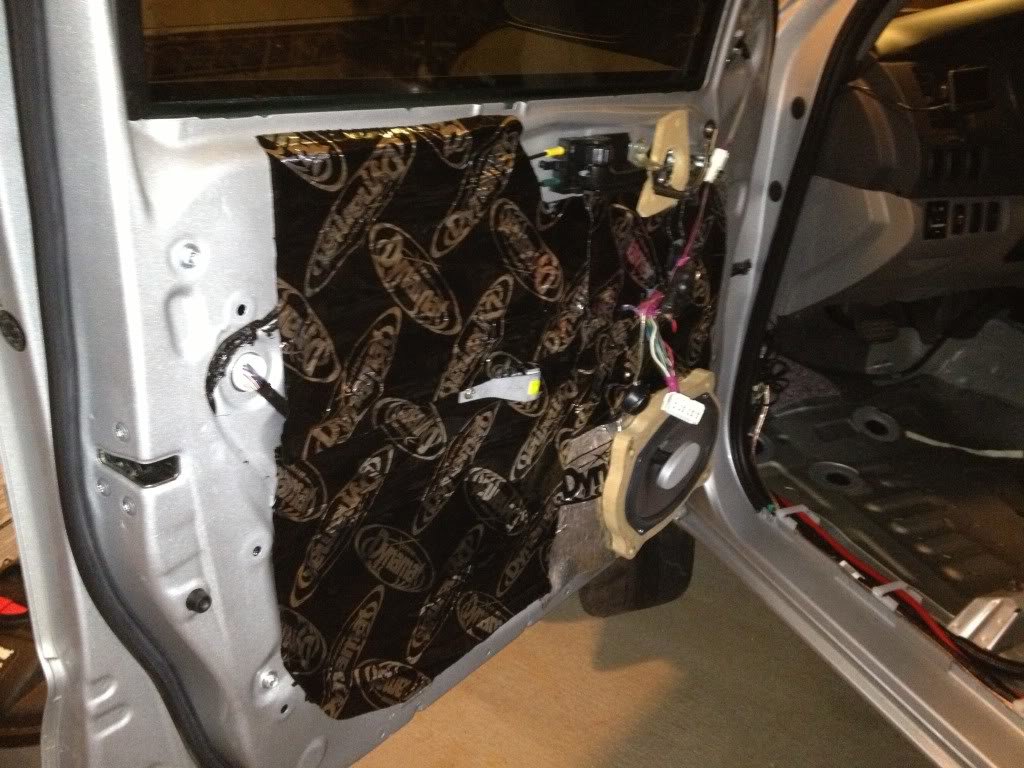

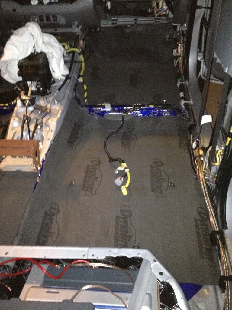

    and tonight's task was the passenger side

    Well, one thing leads to another. I paid for getting two awesome helicopter jumps at 10k feet with being sick so my truck is still on hold. One thing I did do is wrap the box. Hooyah America!!!
    It's my first wrap job so it's obviously not the prettiest, but I think it came out decent. I've got one more touch to add to the box and it'll be completely done and mounted.

    And boom. Done

    I put the truck back together and it sounds SO much better. The bass is cleaner, hits harder, and rumbles like I always dreamed it should. I wish I had just sucked it up before and done it on my own. Like they say, if you want it done right, research the crap out of it, listen to people whove been there, and then do it yourself. Check. I still am waiting on some more dynamat to finish the last three doors, but that should be this week and no biggie. I finally got my bezel in too, so here's a picture of that.
