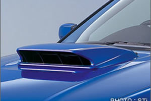

  19. Jan 7, 2021 at 8:19 AM
    #19
    Key-Rei
    Key-Rei Well-Known Member
    Jun 20, 2017
    #221942
    7,863
    Key
    Florida
    2010 TRD Off-Road 6Spd 4x4 209BSM
    Locker anytime Fog Lights anytime Full LED light conversion TRD cat back Rear cat delete Exaust Y reroute away from actuator Alloy Clutch master 2000 4Runner "Dog Leg" shift leaver Marlin shift seats and bushing Rear seat delete Rear diff breather extension Chrome grille swap Debadge Rear seat delete Honda blower motor beefy plug and wire mod Anytime 12v and USB with volt gauge in bed Blue Sea fuse box Hella AND 70's Caddy horns Low profile recessed hex drain plug swaps Alluminum battery strap 7pin relocated Backup cam on anytime Various other creature comfort and personal taste mods.
    They are but as someone posted above they have "snorkel scoops" or the scoop is far forward on the hood where it can actually catch air.
