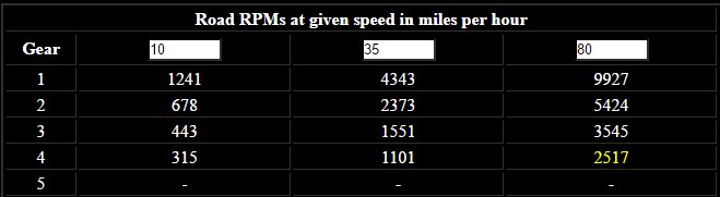

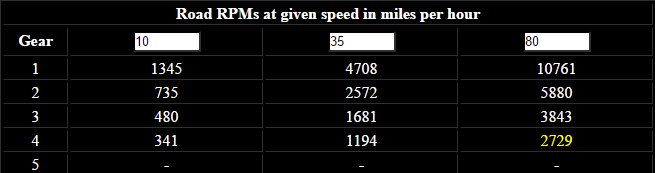

    Not really sure if I'm going to even worry about regearing after seeing this. I'll drive it first and see then decide.

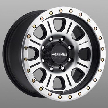

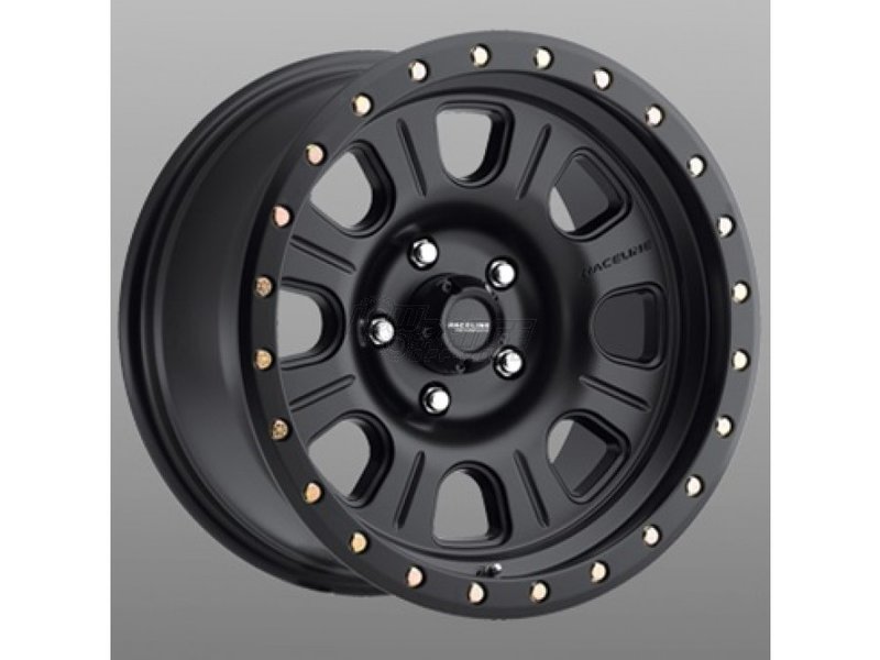

    Narrowed done what wheels I think I'm gonna get.
    Raceline Monsters. The non beadlock ones. Almost half the price of the real beadlock s so they will do for now. Have to decide on machined or black? Any opinions? I'm leaning towards the machined (silver) just to be different.
    They have two options for offset and backspacing. It's a 17x9 in wheel with either 0 offset and 5 in backspacing or -12 offset and 4.5 in backspacing. Any preference on which to get?

    Make sure you run some tape around the inner bead .. usually 2 wraps is the magic number..
    Are these wheels for the new axle or your axle?
    Neither of those options will stick out much .. What do you currently have on there?
