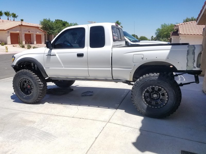

    Specs:
    2001 Toyota Tacoma Prerunner TRD
    How I got it:
    Bone Stock with 103,000 miles
    I'm the 2nd and probably final owner

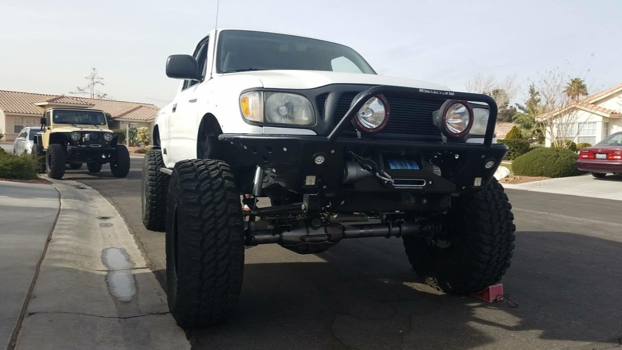

    Front:
    Current: ruffstuff 9 in with solid axle industry inner c and dodge kingpin knuckles
    Ruffstuff bronze bushings, springless high steer arms, ruffstuff calipers, Ford inner shafts and Chevy kingpin outers. Yukon chromolys with Yukon locking hubs and super joints
    3link, 2.5x14 coil over and triple bypass
    2.0x2 fox bump stop
    Old::Ruffstuff 8" diff and mini truck knuckle balls with 1990 Pickup hubs and Tacoma Calipers and Rotors
    Front Range Tacoma/4Runner Brake Adapter
    Skys High steer arms with 5th stud mod
    4.88s and Detroit Locker
    Skys Frenched leaf spring hangers
    Leaf Sprung
    Trail Gear 3" HD Springs
    Fox 2.0 Remote Resi Shocks with Adjusters
    JY Bump Stops
    Boxed Frame
    TG Tapped steering box with Skys Flat arm
    Custom Steering Shaft with Woodward coupler and Front Range Firewall Plate
    Rcv axle shafts
    Tundra brakes
    Rear:
    current: ruffstuff 9 with solid axle industry rear kit
    Yukon third with zip locker and 5.29
    2.5x12 triple bypasses
    2.0x2 bilstein bumptop
    Chevy 63 main and deaver pack
    Old::Tacoma Axle w/ 1.25" Spacers
    4.88s and E-Locker
    Trussed
    Trail Gear Diff Cover
    Chevy 63s with a Toyota Add a Leaf and Wagoneer Spring
    Frenched Front Hangers
    6" eye to eye Shackle
    Boxed frame
    Fox 2.0s with Remote Resi
    JY Bump Stops
    Bed bob and highclearenced bedsides
    Engine and Drivetrain:
    Stock Engine with 2.4l Radiator
    Inchworm Prerunner Adapter
    Trail Gear Passenger Drop 4.7 Transfer Case with 2.28 Crawl box and Twin Sticks
    Custom Front Drive Shaft with Trail Gear Slip Yoke
    Shortened Rear Drive Shaft
    Magnaflow Catalytic Converter
    FlowMaster Muffler? Out the bed side
    Psc 3.4l hydro assist and 6 in ram shortened with heatsink cooler and Psc resivor

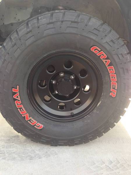

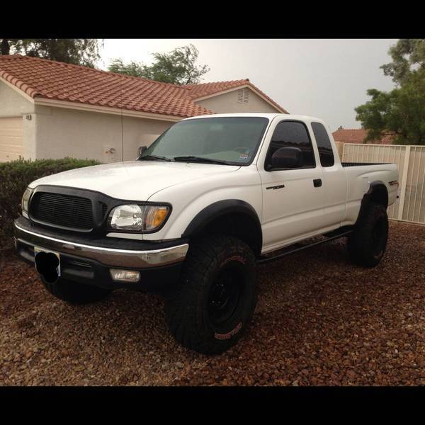

    New tires and rim (Aluminum 16 in black rims with 33 by 11.5 General Grabbers)

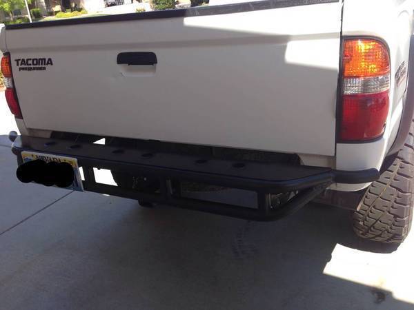

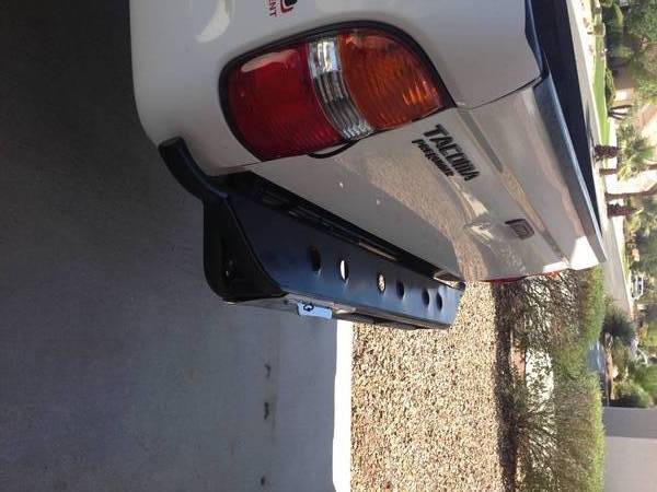

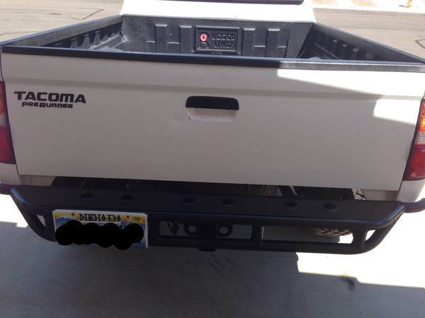

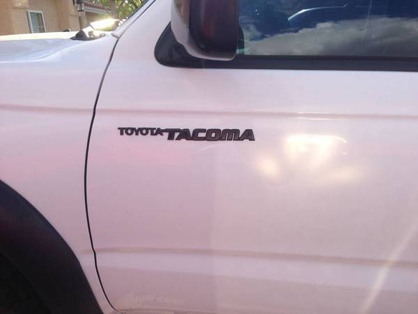

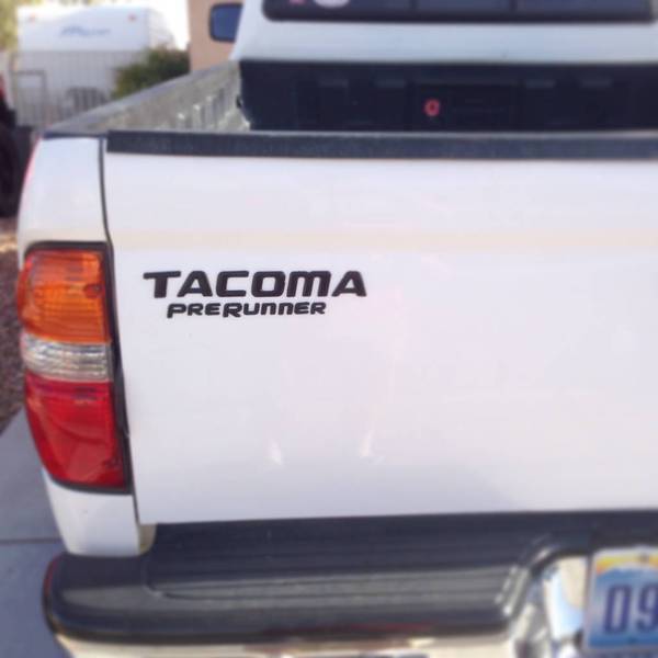

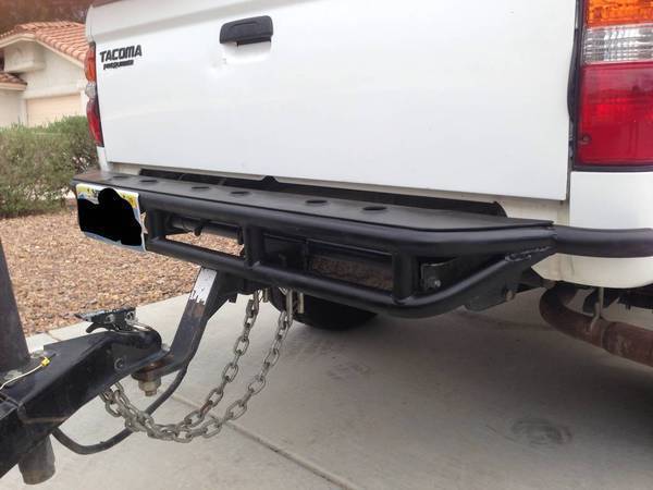

    Rear Bumper:

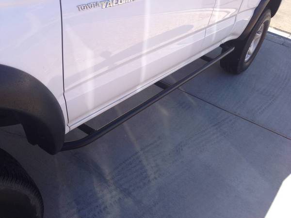

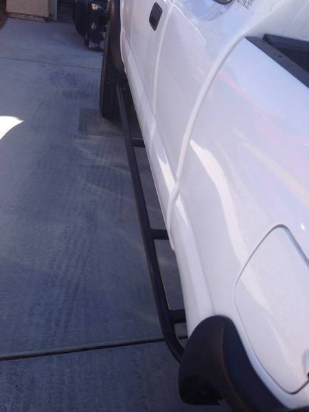

    Made some steps/sliders
    Painted the grill and surrounding
    Painted the badges

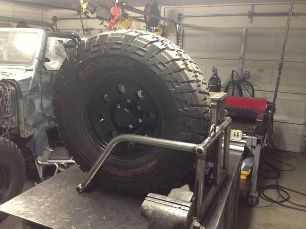

    and am currently working on a tire rack
    Im goning to finish the spare tire and start working on the front bumper.

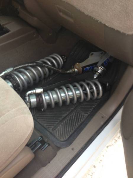

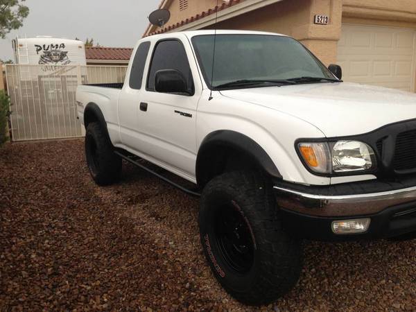

    Forgot to mention that the camburg uca's were put on along with the fox shocks and ome 2.5" leaf pack.
    What do you guys think?

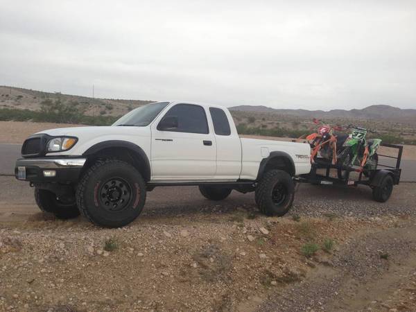

    Haven't done much off roading yet but towes a trailer with 2 bikes great! Seems to handle fine down semi ruff dirt roads.

    UCA's have been great! went in without a problem and haven't had a problem with them yet.

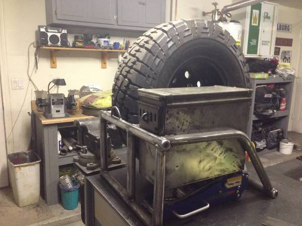

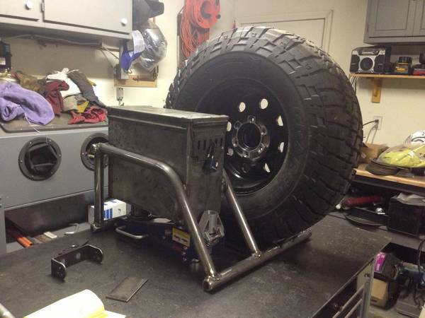

    Thanks. Just have to make the feet to mount it to the bed and then I'm going to put a few things coming off of it. Should have it done real soon.

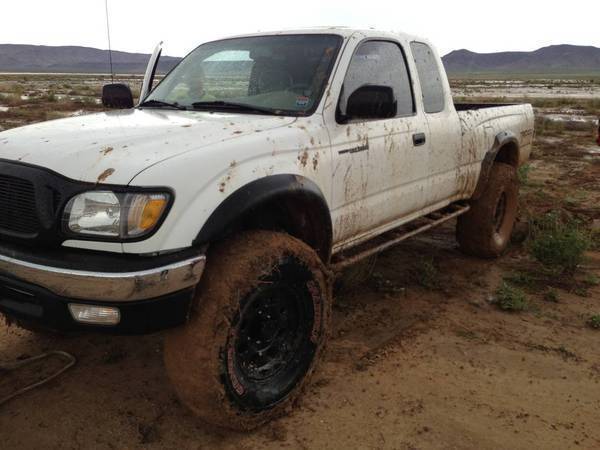

    Went out riding yesterday. Dirt was perfect and it was really nice out. snapped a few pictures of the truck and also took the trailer off and went cruising around a little.
    got her a little muddy :)

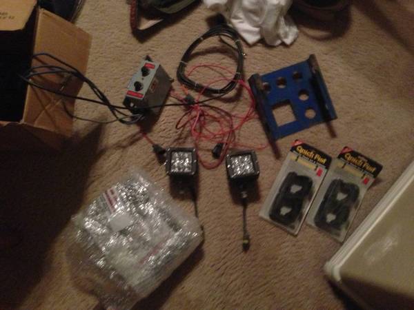

    Got some goodies yesterday. (off an old race car we used to have)
    4 lights (2 new, 1 used, 1 with no lens but going to fix it)
    Got this from a garage sale for a couple bucks
    got 3 of these with 2 mounts for 10 bucks!! Love garage sales. My dads gonna take 1 mount with two gas cans and im gonna take the water can and mount.

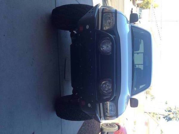

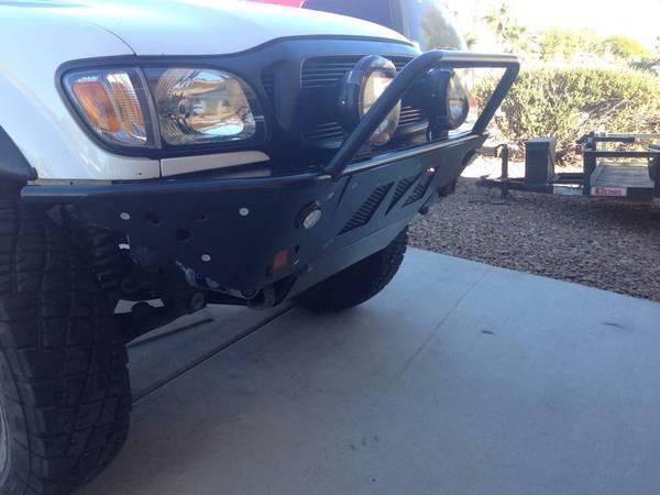

    Finished the bumper and am really happy with how it came out.
    All the lights.
    Just the pods.
    Just the hids.
