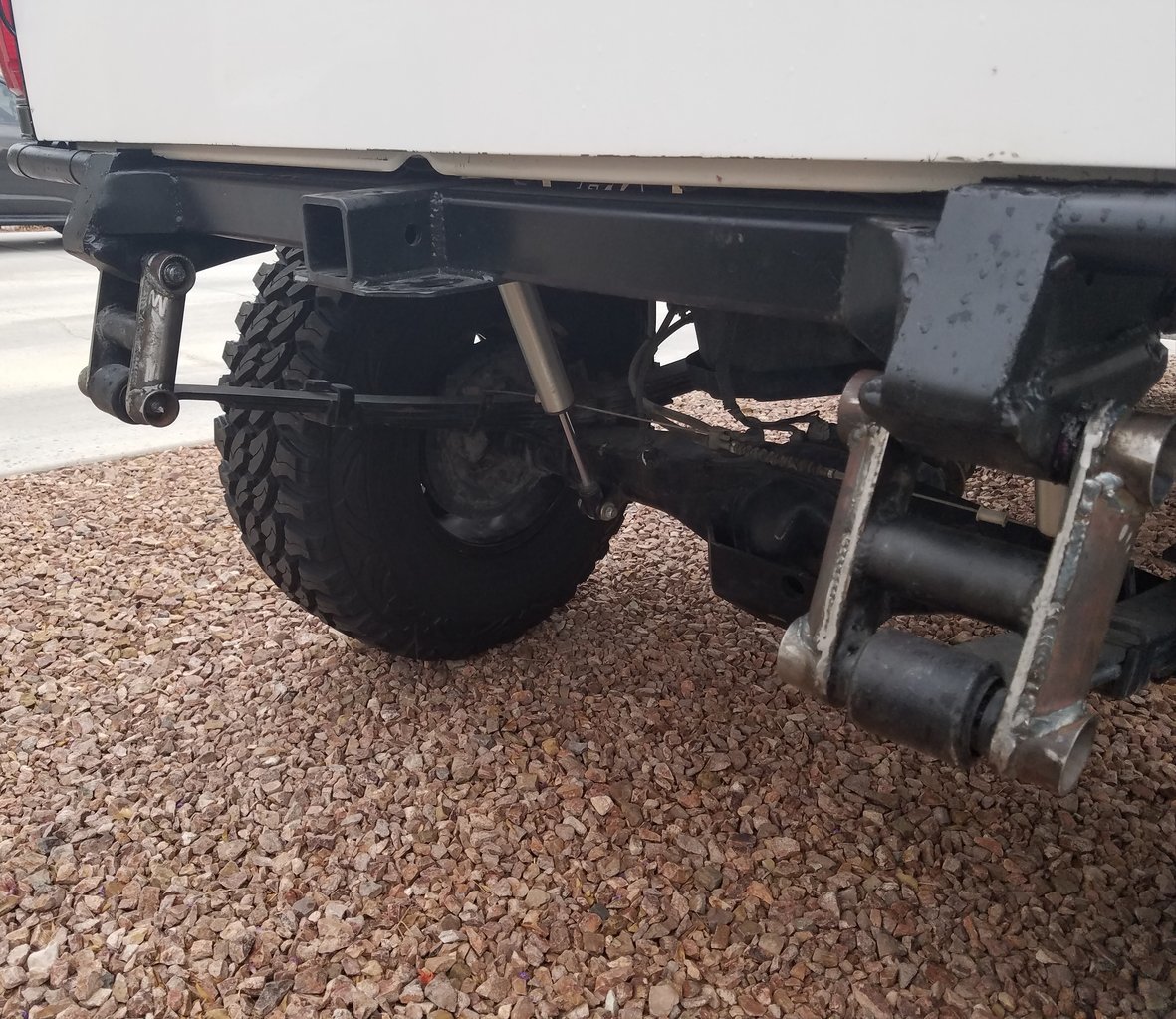

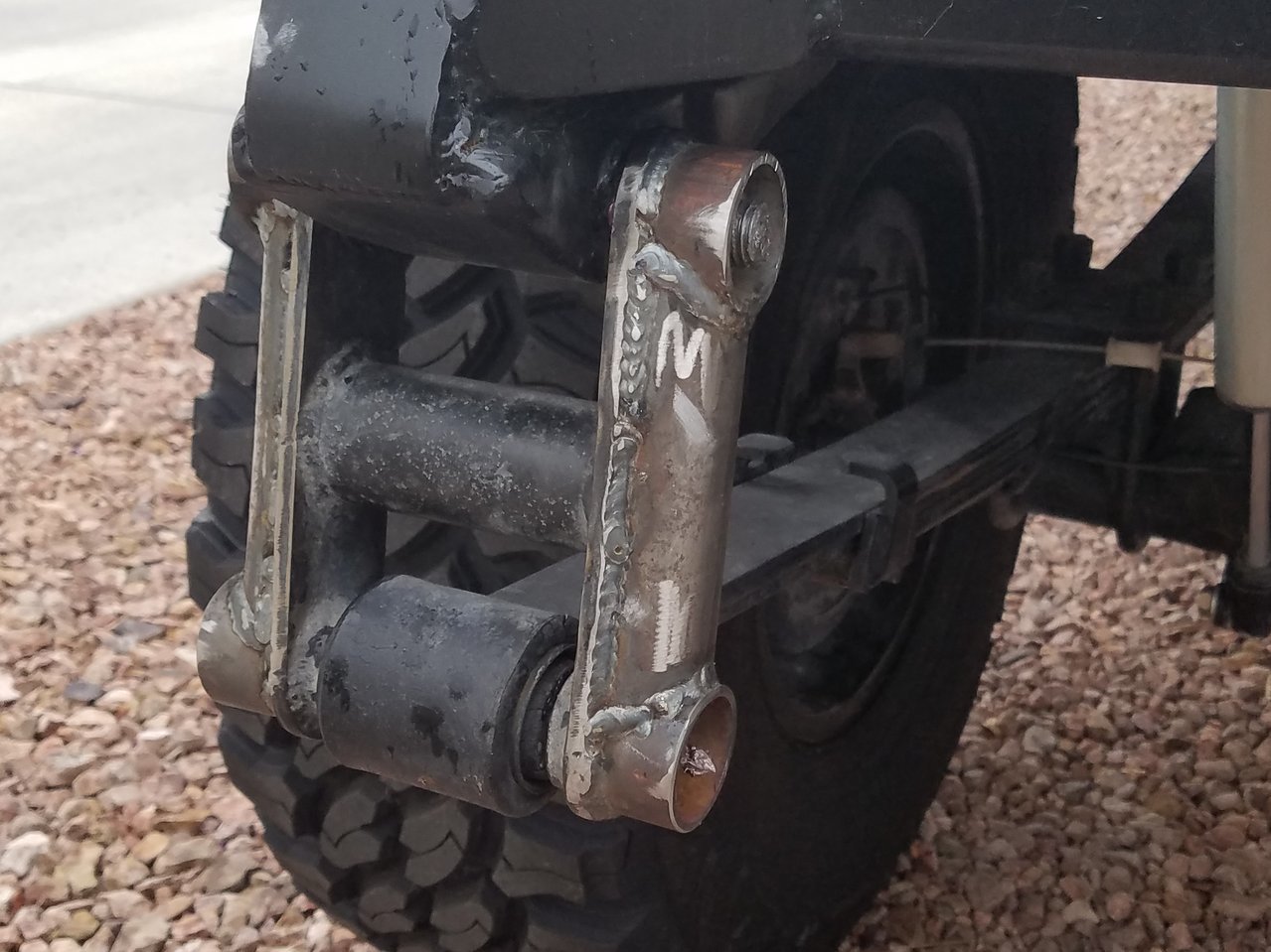

    Finally beefed up my shackles. Probably over kill but don't have to worry about them bending if I ever slam down on them. Finishing looking everything over tomorrow then it'll be ready for the trip.

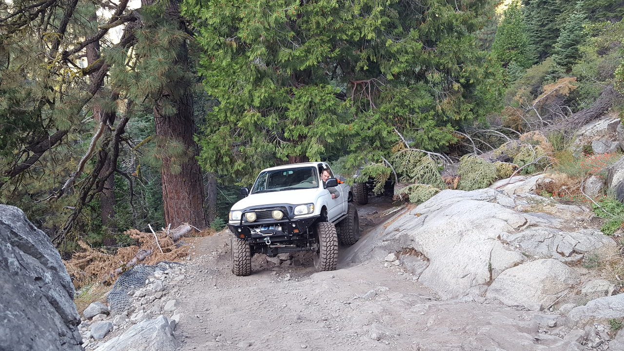

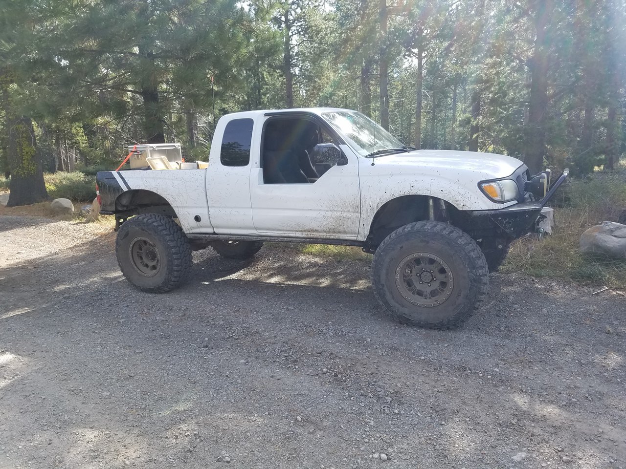

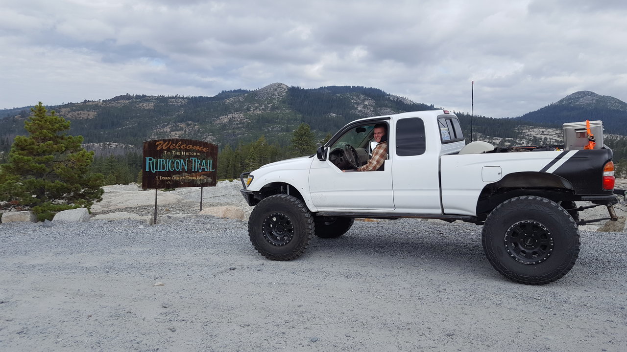

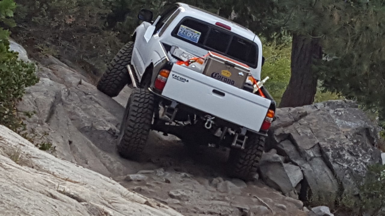

    Made it back from the Rubicon. Drove a 1000 miles and 20 hours to do the 16 or whatever mile trail. Was worth it though. Parked the tow rigs on the Tahoe side in Tahoma and drove the rigs over to Loon lake. Went from Loon Lake to the Springs the first day, sat around the 2nd day and drove out and home the 3rd day. Overall, was a 4 day tripped and didn't feel rushed at all. No broken parts or body damage this year despite some how we even ended up going down "Old Sluice" which was hard and technical. Overall a great time and a fun trip with my dad I will probably remember forever and hope to do again next year.
    [​IMG]DSC_0153 by Harrison M, on Flickr
    [​IMG]DSC_0159 by Harrison M, on Flickr
    [​IMG]DSC_0163 by Harrison M, on Flickr
    [​IMG]DSC_0170 by Harrison M, on Flickr
    I was happy to say the least to make it to this point (Observation Point) after what we went through last year.
    [​IMG]DSC_0182 by Harrison M, on Flickr
    alee891, jubei, Ritchie and 4 others like this.

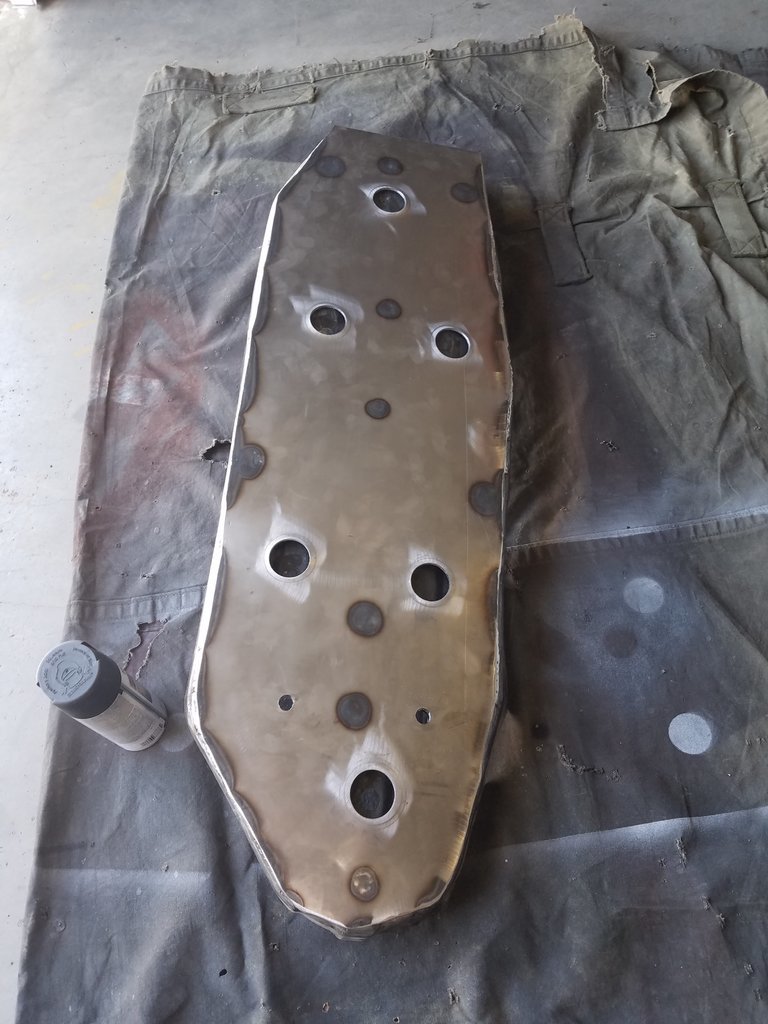

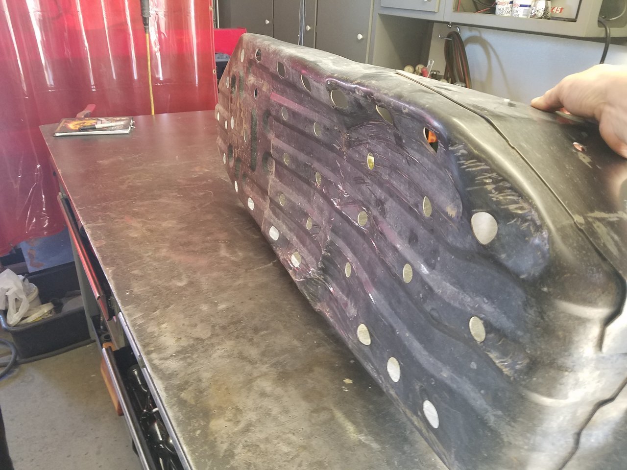

    Painted the shackles and smashed the gas tank skid back straight and welded a piece of 1/8 in to it. Super easy with the plasma just took a couple hours.
    Put some dimples in it for drainage and got a fresh coat of paint on it now
