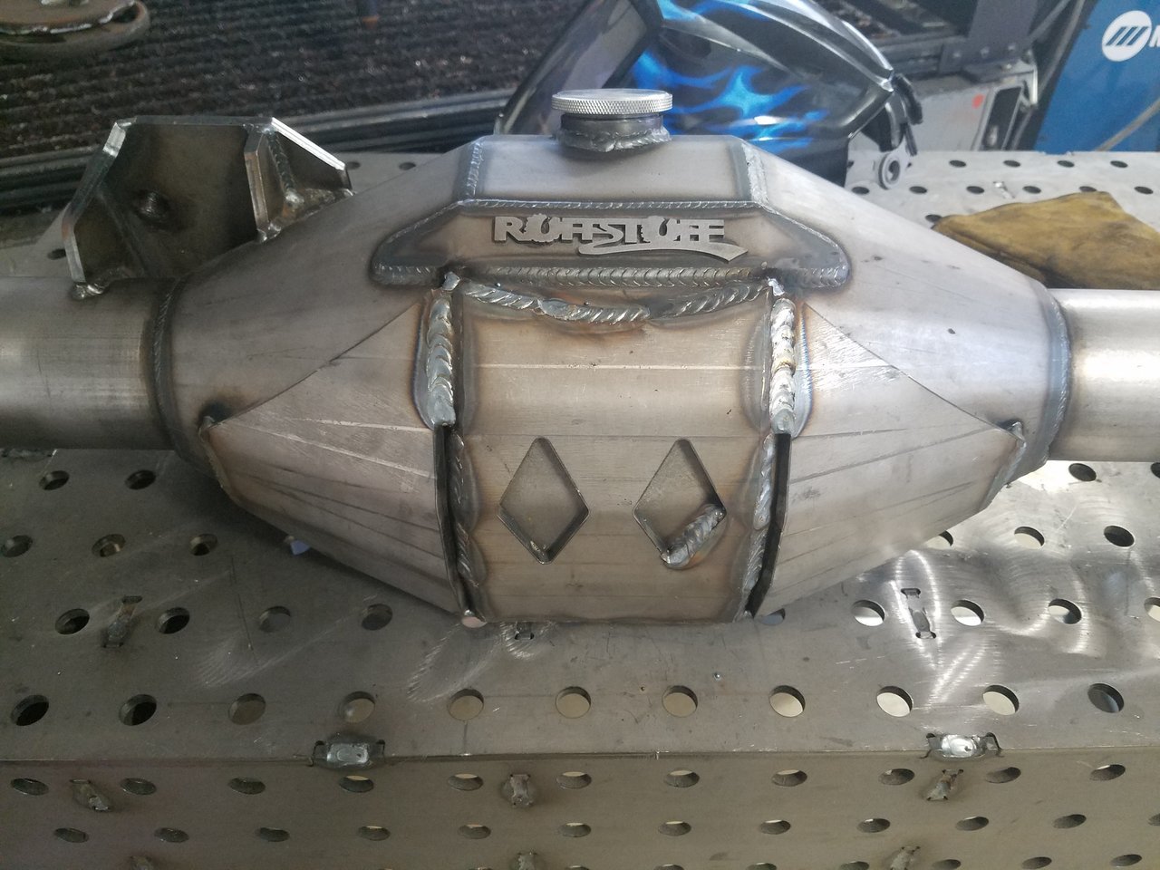

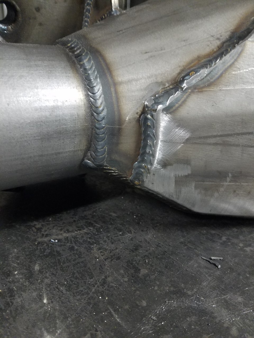

  6. Nov 16, 2017 at 5:23 PM
    #926
    malburg114
    malburg114 [OP] Well-Known Member
    Dec 26, 2012
    #93766
    3,792
    Las Vegas, NV
    2001 Toyota Tacoma TRD
    Got a lot of work done on the axle today. Should have it all welded up by tomorrow. Need to order 2 more new koyo trunion bearings and races though as the only ones I have are the cheap trail gear ones. Also cleaned a 14 bolt and Chrysler 8.25 which was a pain...
    Welds aren't as good as ruffstuff but they are definitely getting better. Just wish I had a big to weld it all at once lol

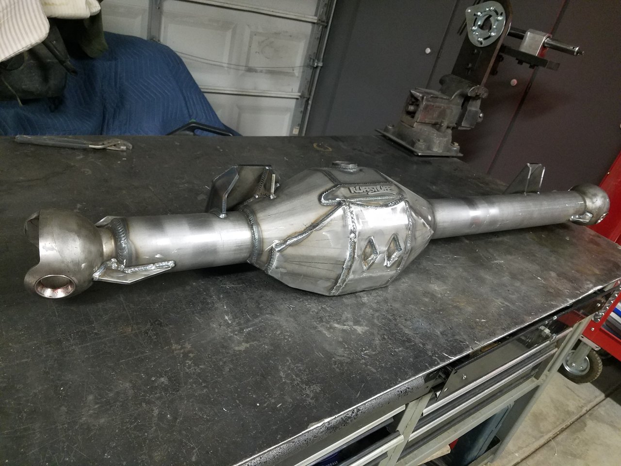

  7. Nov 17, 2017 at 11:20 PM
    #927
    malburg114
    Dec 26, 2012
    #93766
    3,792
    Las Vegas, NV
    Axles all welded besides steering stops and shock mounts. Will wait till it's full assembled to do those and finish the top knuckle ball gussets. Hopefully the new shafts come next week and I can get it all assembled the following week.
    Wish I would have beveled everything a little more but welds are definitely getting better. Not ruffstuff good though since I had to do it in sections to prevent overheating the housing.
