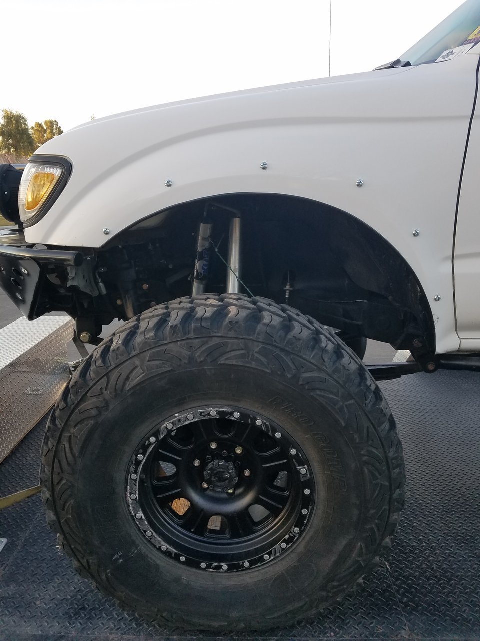

    So actually measured it today while I was outside fiddling with it. Frame height on the passenger side by the front body height was 25.5" while the driver was 24.5". Not exact and I think the springs will settle a little too.
    While under articulation I have 3.5" of uptravel to bump while both sides up and down I have close 2.5" maybe more.
    I think the width definitely makes it look lower and I trimmed the front fenders some to so I'm sure that doesn't help either. Still think it looks good though.

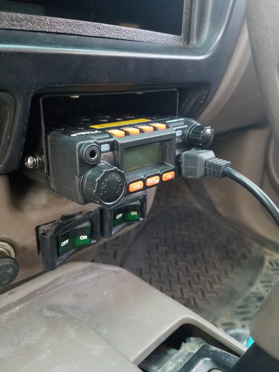

    So went out and messed with it a little today. Got a rugged radio race radio for Christmas since cbs never seem to work very well and got that put in the ashtray. Got the fender trim on the front to clean up the edge and finally put some bolts in the fender holes. Also traded some old leaf springs had for a prolink. Not sure how I like it since i think it's going to drag on steep walls but I will see. May string it out of the way like I did the hook. 20171228_155656.jpg 20171228_155721.jpg 20171228_160854.jpg
    and got it loaded up to go play tomorrow at logandale.

    That's a clean fender cut, what did you use to cut it? I tried the cut into tabs and fold technique and it isn't pretty, guessing you just cut it off. Did you do anything to treat the edge?

    I've always used an angle grinder with a cut off wheel then just went back over it with a 120 flap wheel. I got some automotive trim and put that over it to get rid of the sharp edge.

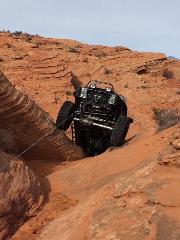

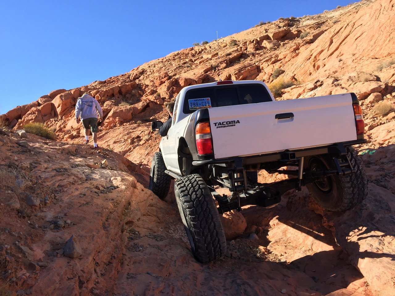

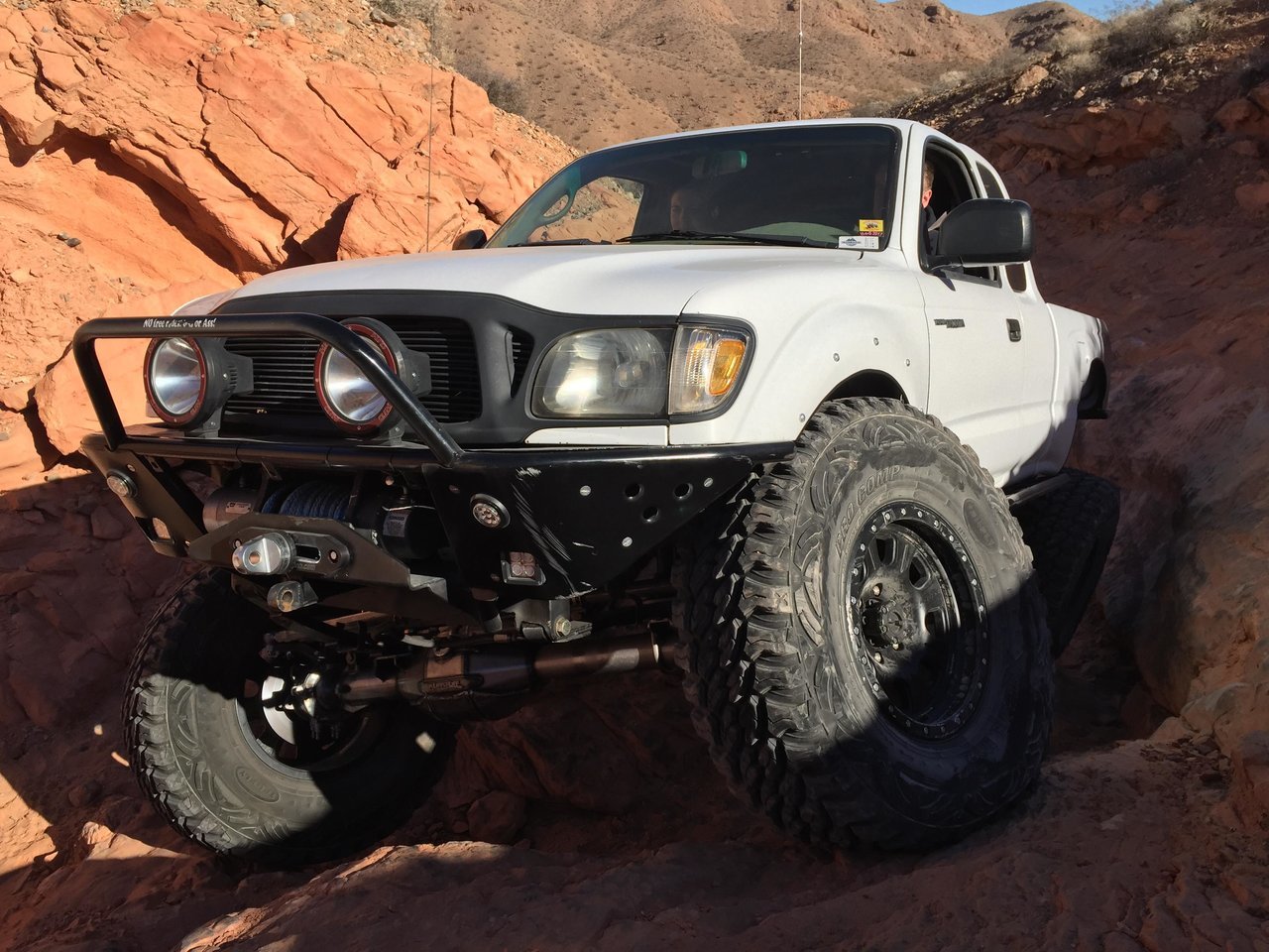

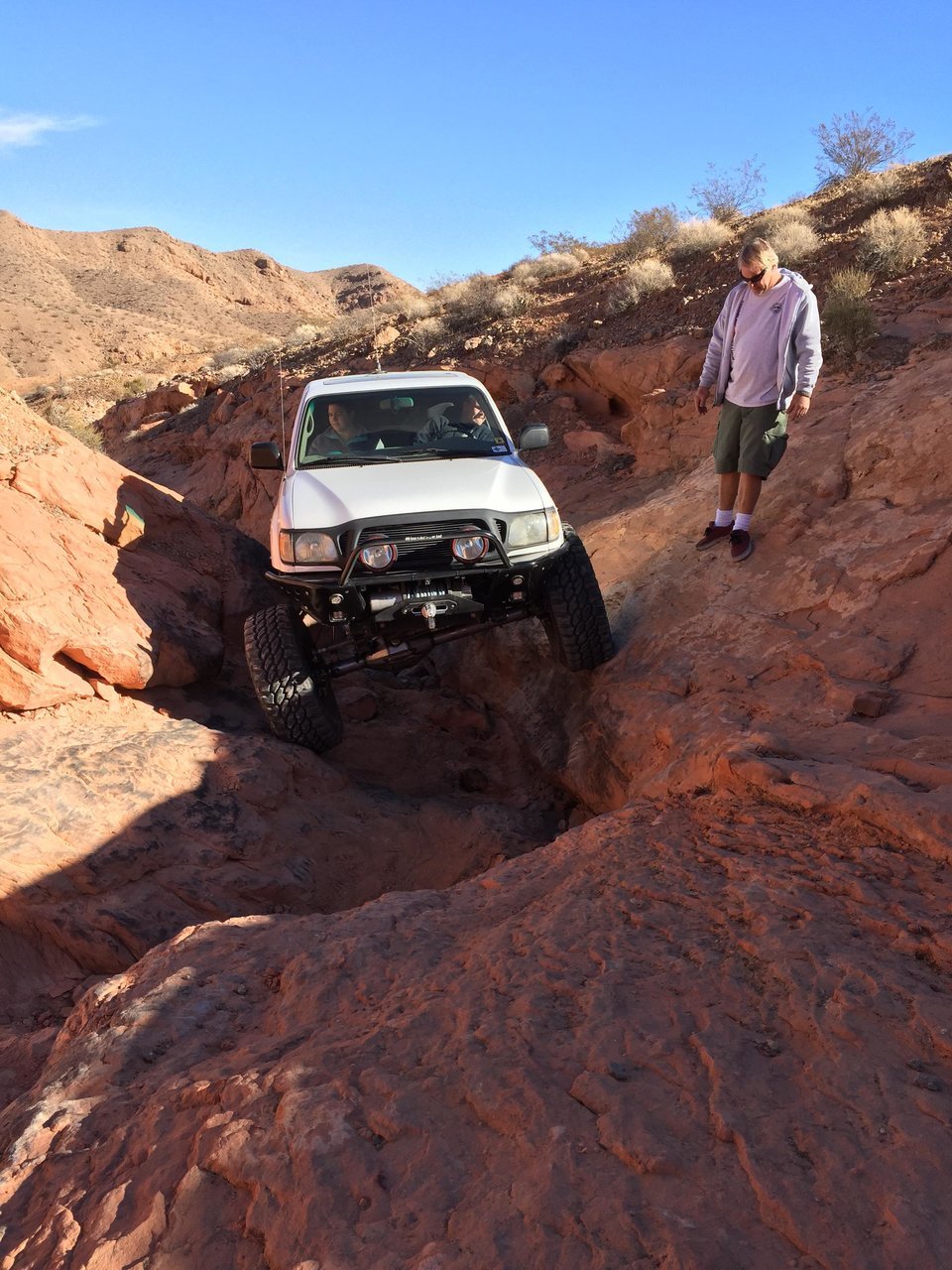

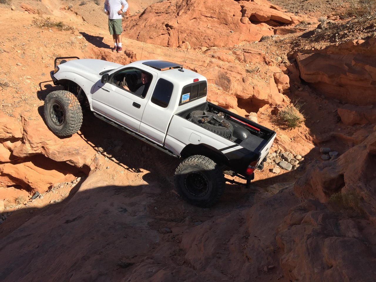

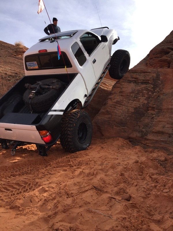

    Had fun out at logandale yesterday. Didn't do a lot of trails but did a lot of hard obstacles. Truck worked really well. Had all of the steering I could get, tires didn't rub and the wider axle made it feel real stable and a little easier to wheel. No real problems besides the ram coming loose and just rotation down. Just need to tighten it up. Do need to look for a rear axle though. The vnotches are a little hard with the narrow rear since it doesn't track anywhere near the front. But it's doable.
    received_10211934775391479.jpg received_10211934775551483.jpg received_10211934772431405.jpg received_10211934771991394.jpg received_10211934776431505.jpg received_10211934772751413.jpg
    And a buddy we went with in his 80s toyota on propane. He ended up killing a power steering pump later on. Him at the start of the V notch. Pictures do it no justice. Can almost walk under the car.

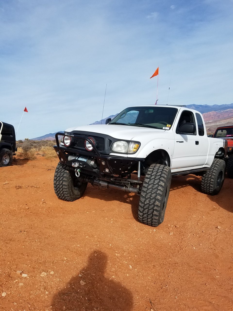

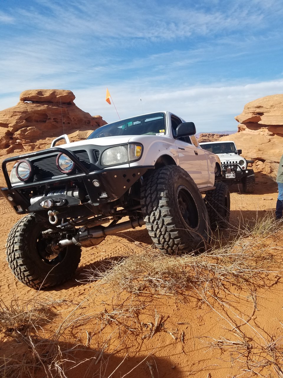

    More fun in sand hollow for winter 4x4 jamboree. Pushing the truck pretty hard and having fun.

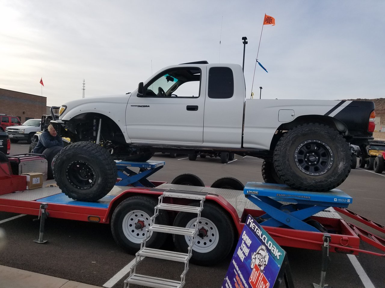

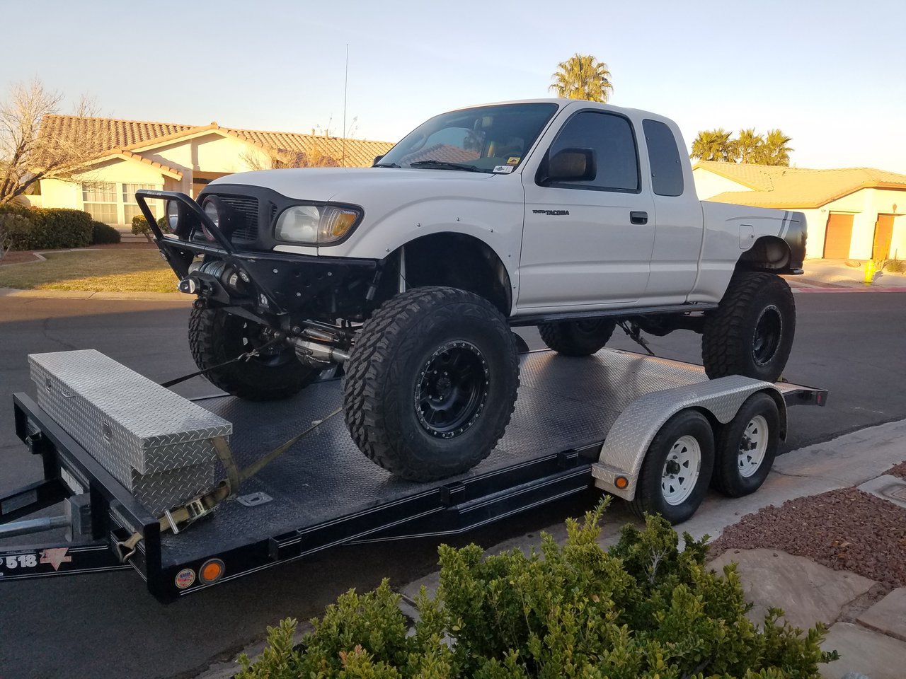

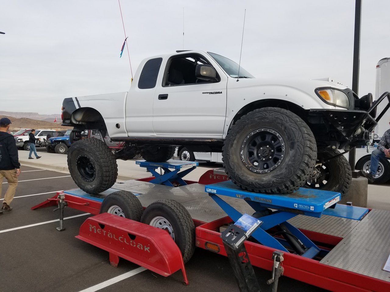

    Trying to see where my steering rubs so threw it on the metal cloak trailer. Has more travel though when doing real obstacles but was nice to check things
