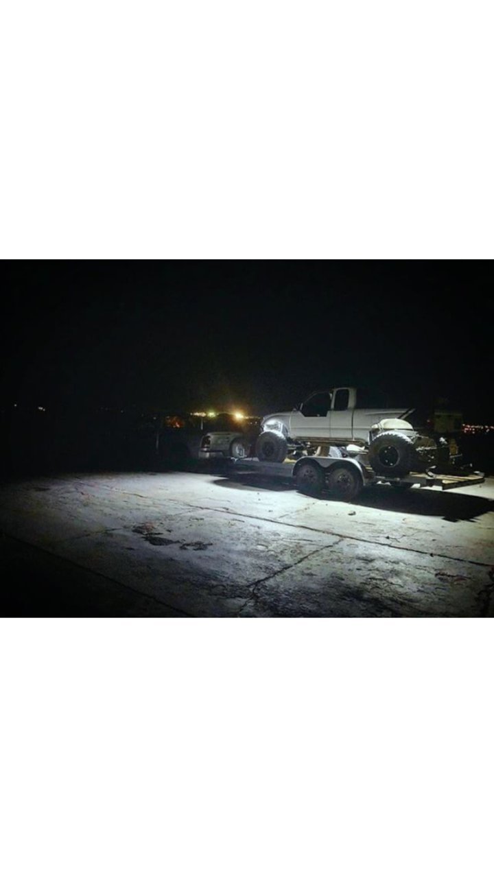

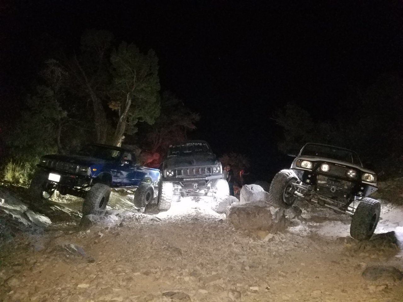

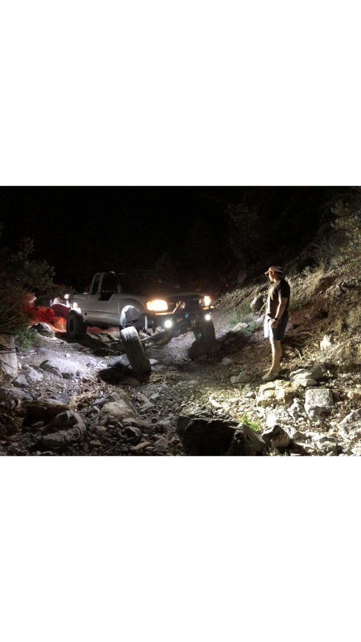

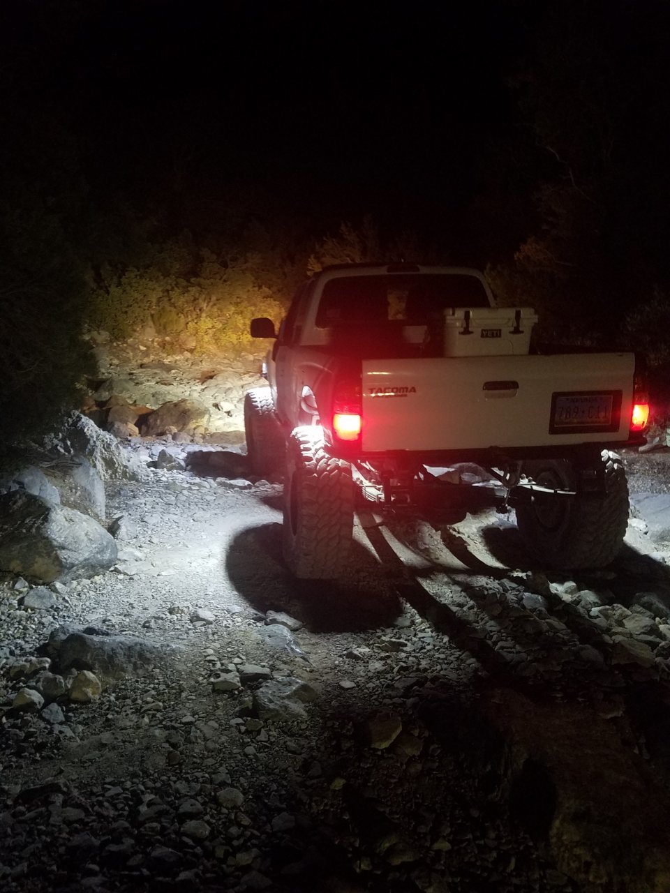

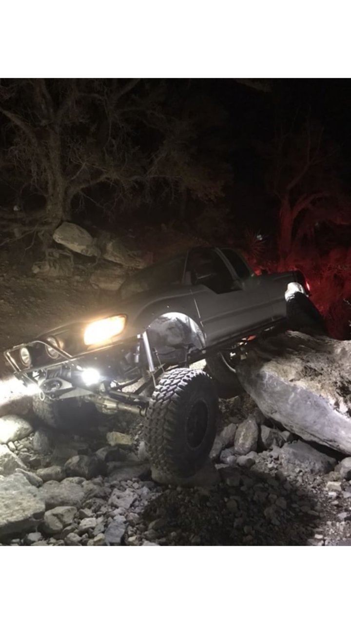

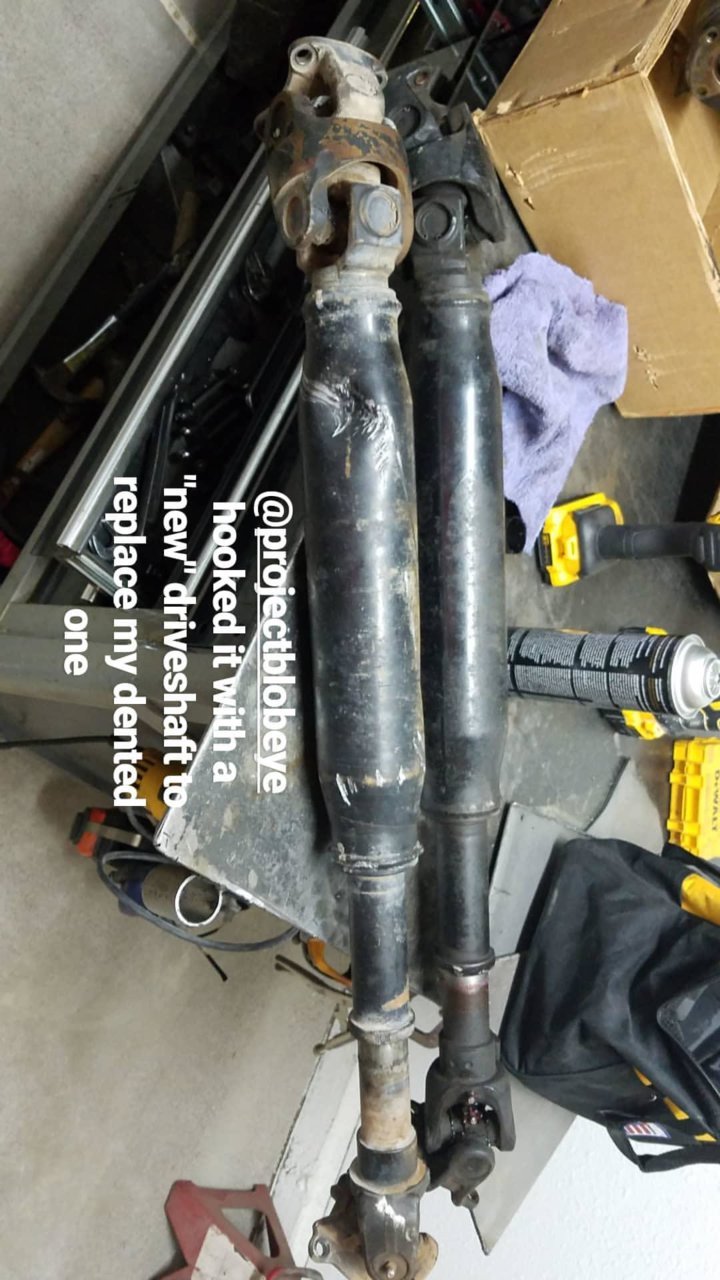

    More night wheeling with the local Toyota guys. Need to change the rear drive shaft since it's got some good dents in it. Also got some rock lights from a buddy and another spare rear driveshaft. Having fun just using it and not really working on it hahah

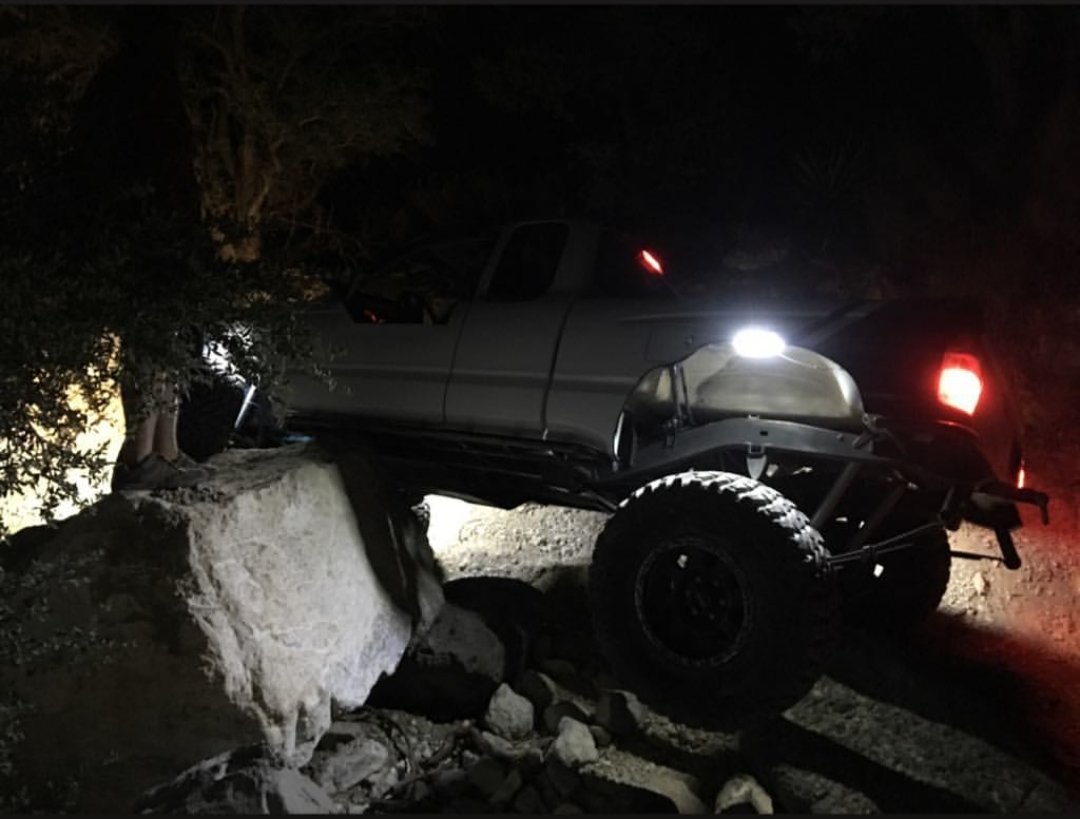

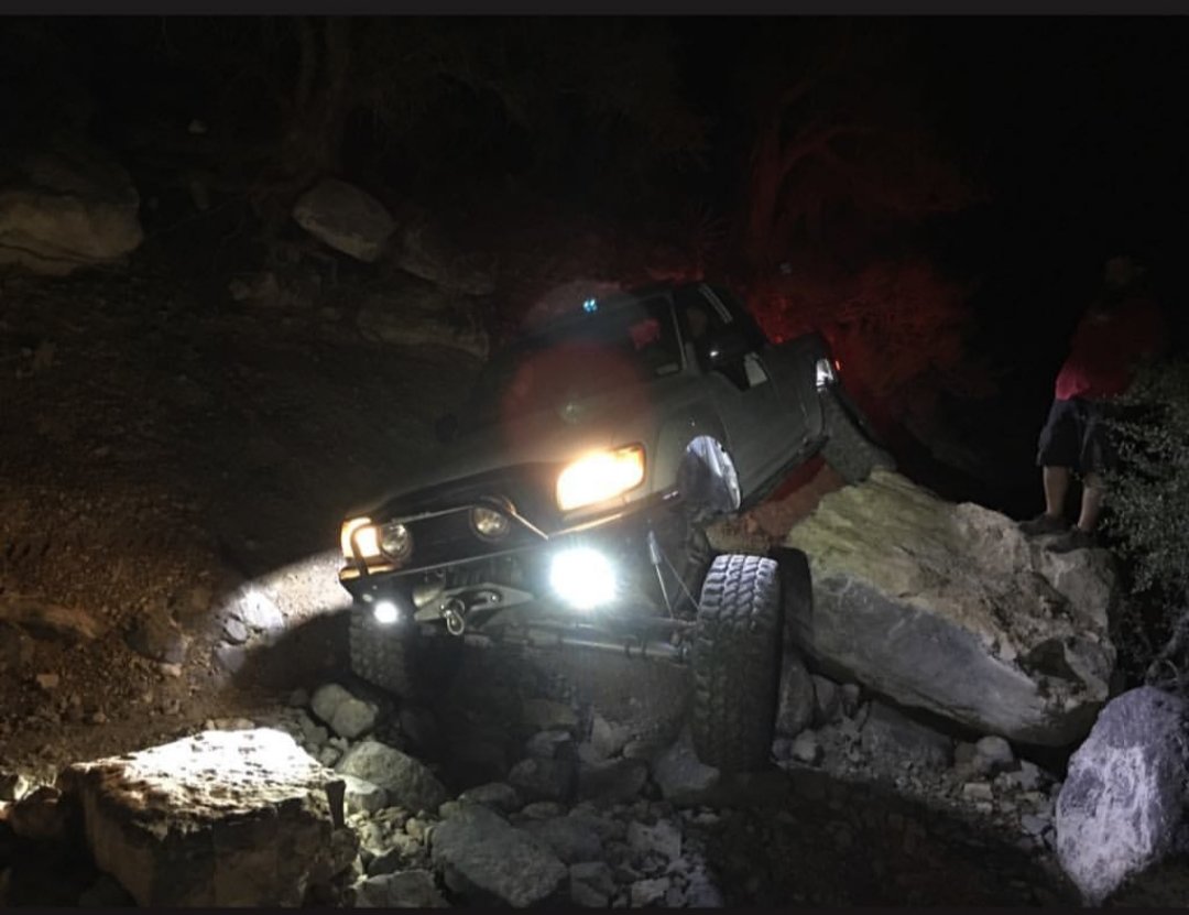

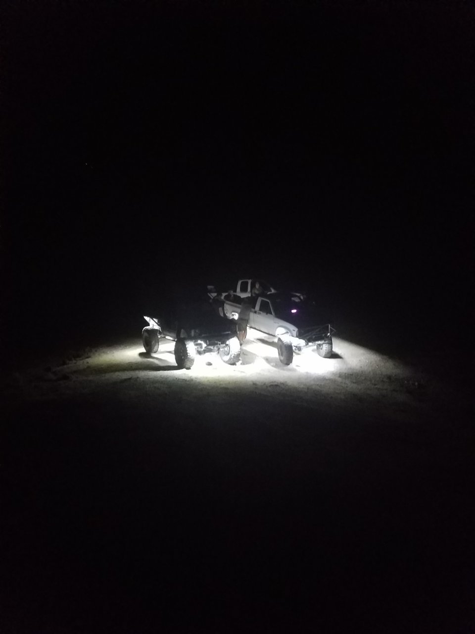

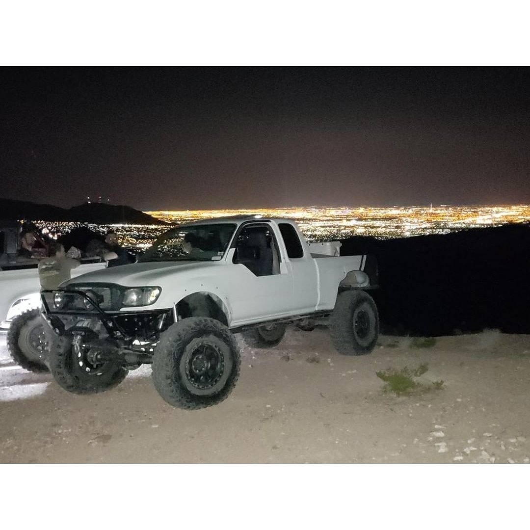

    2 night wheeling trips in 1 week lol. Quick run up rocky gap again with my dad. Got the rock lights in and new driveshaft and everything worked well. Trail is super rough right now but still fun. Just needs a good rain.

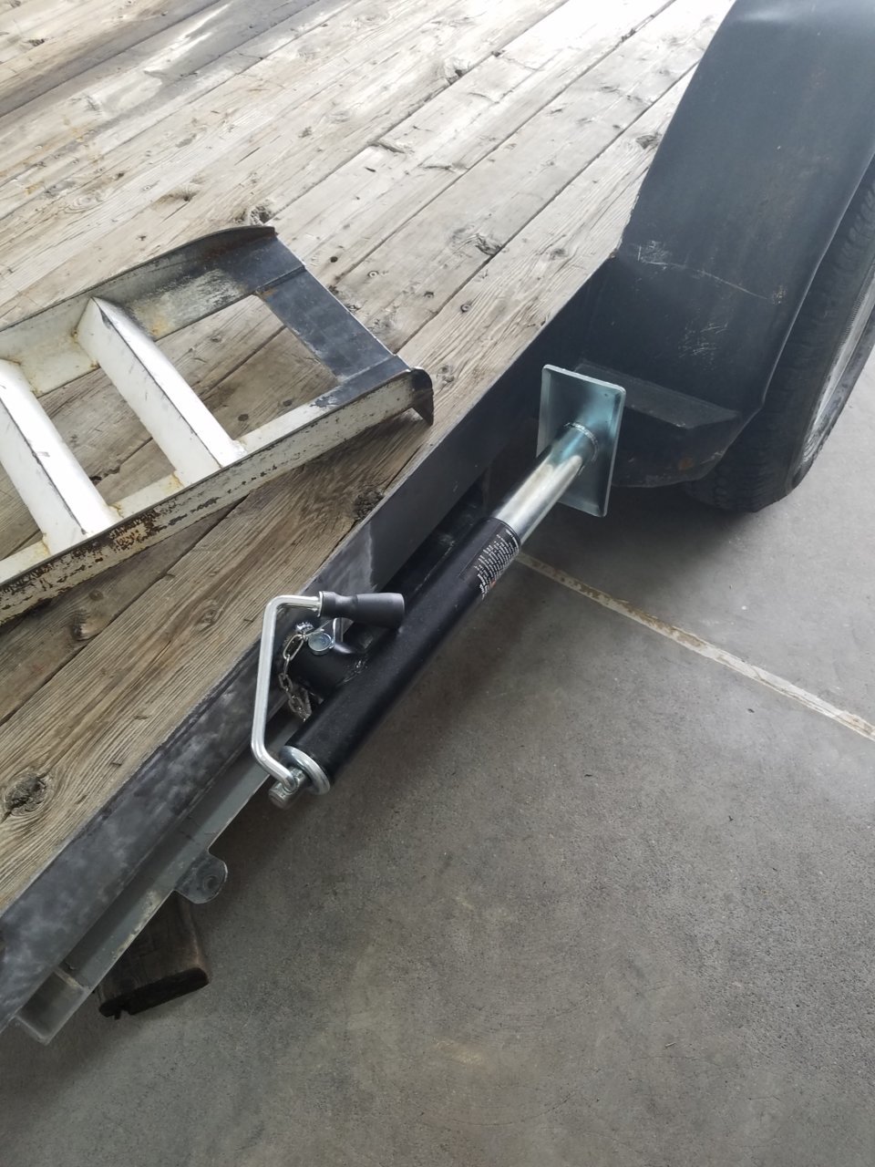

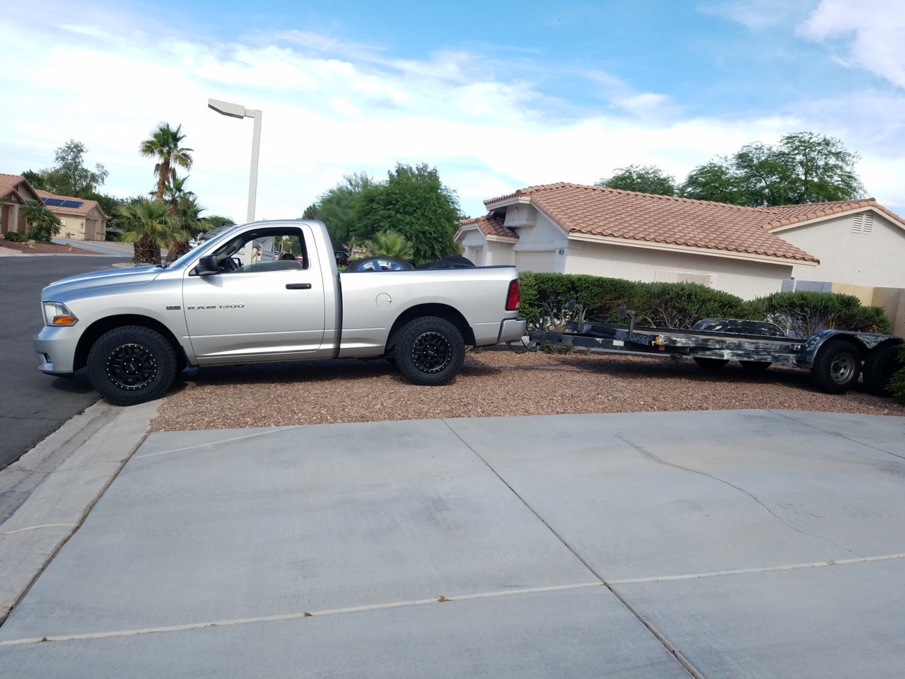

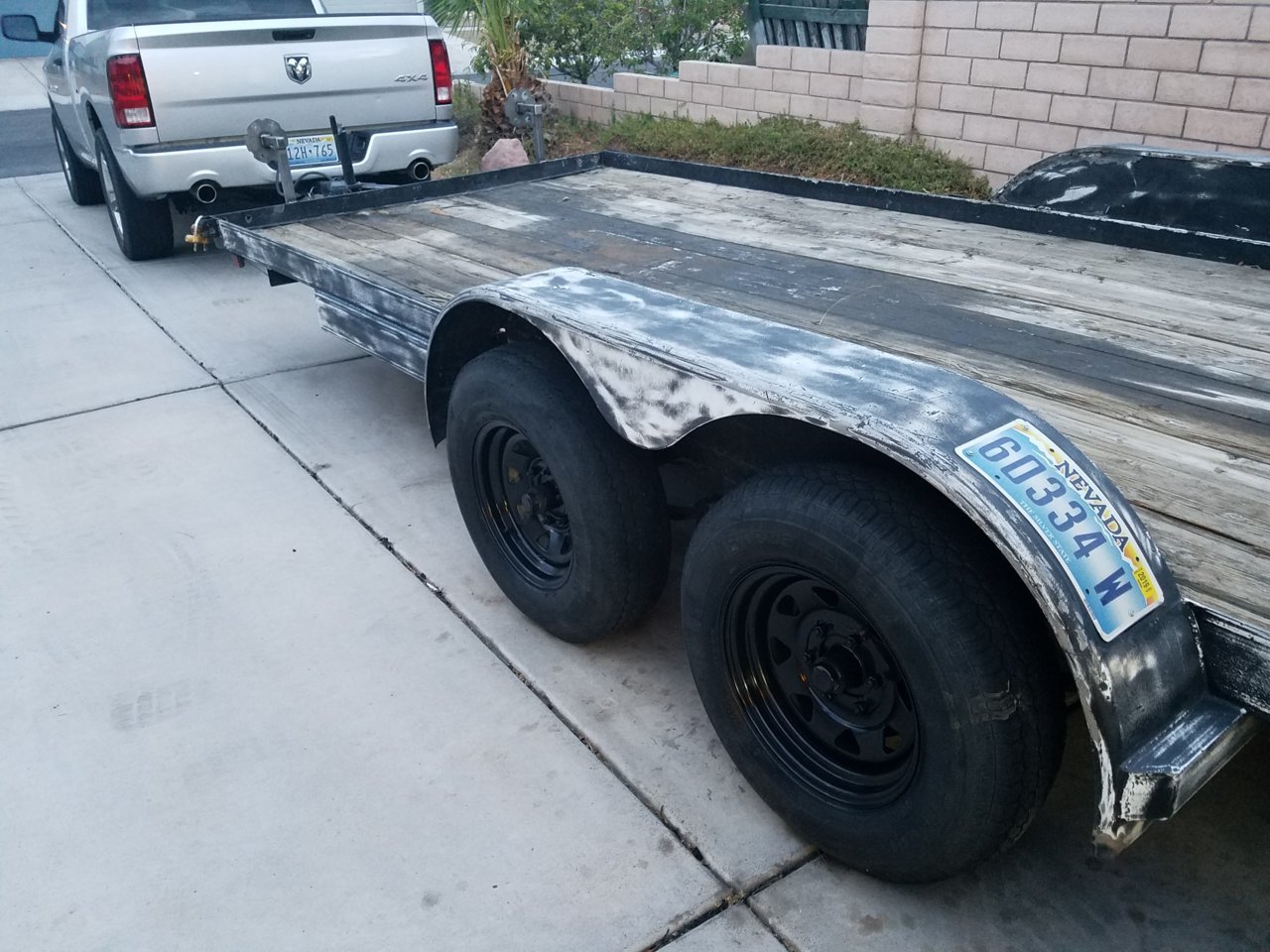

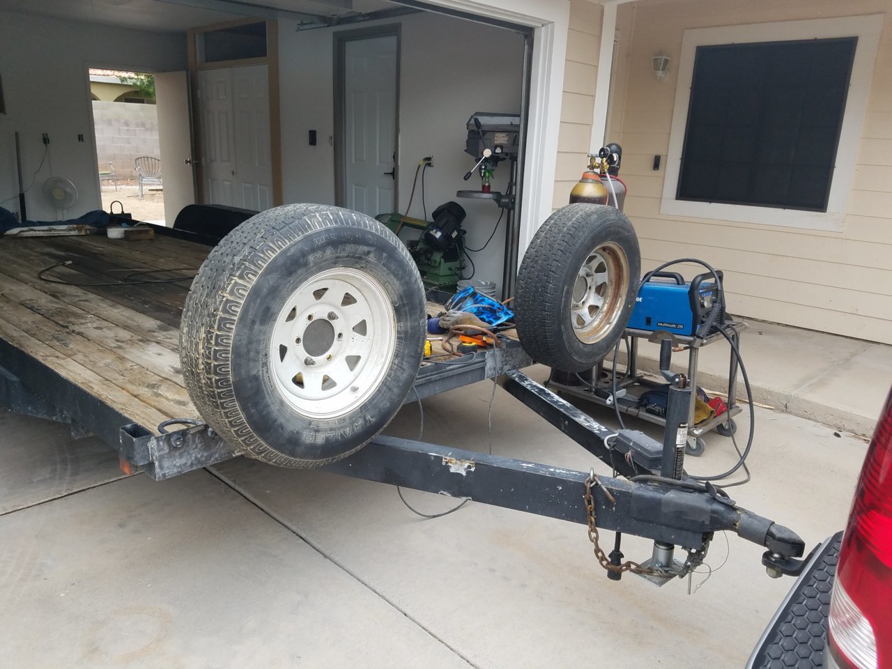

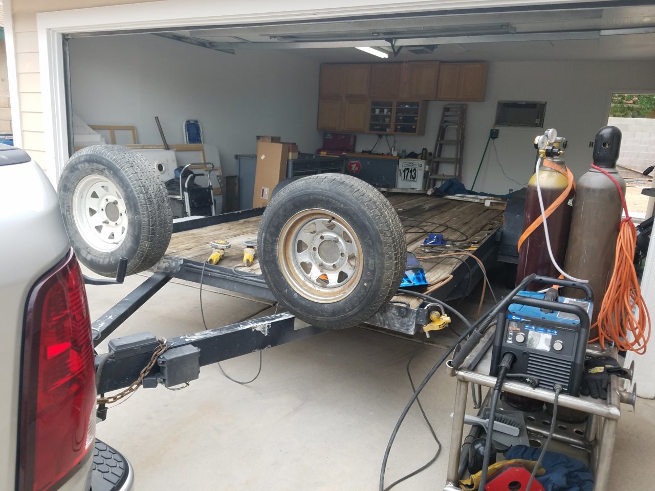

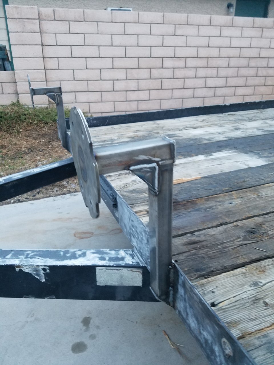

    Stuck at discount tire waiting for new tires and wheels for the daily and trailer tires. Did get a ton of work done on the trailer yesterday. Got the frame and fenders sanded. Stabilizer Jack's on the rear and the 2 spare tire mounts for the front along with the main wheels cleaned and painted. Think it's coming out pretty well. Hoping to remove the deck today and maybe paint it tonight but it's super humid here with monsoon season so we will see.
    20180712_200219.jpg 20180712_200229.jpg 20180712_154314.jpg 20180712_154258.jpg

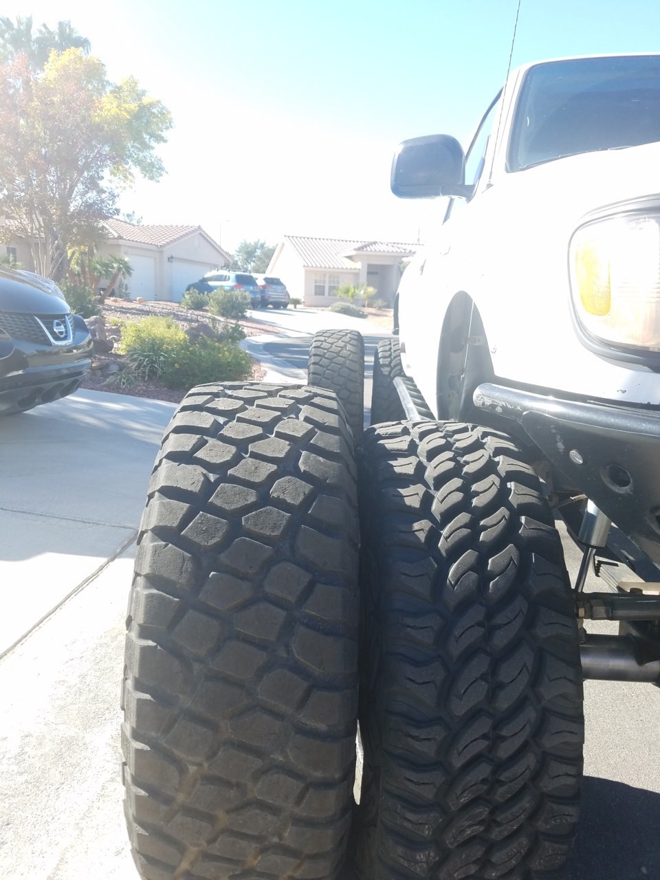

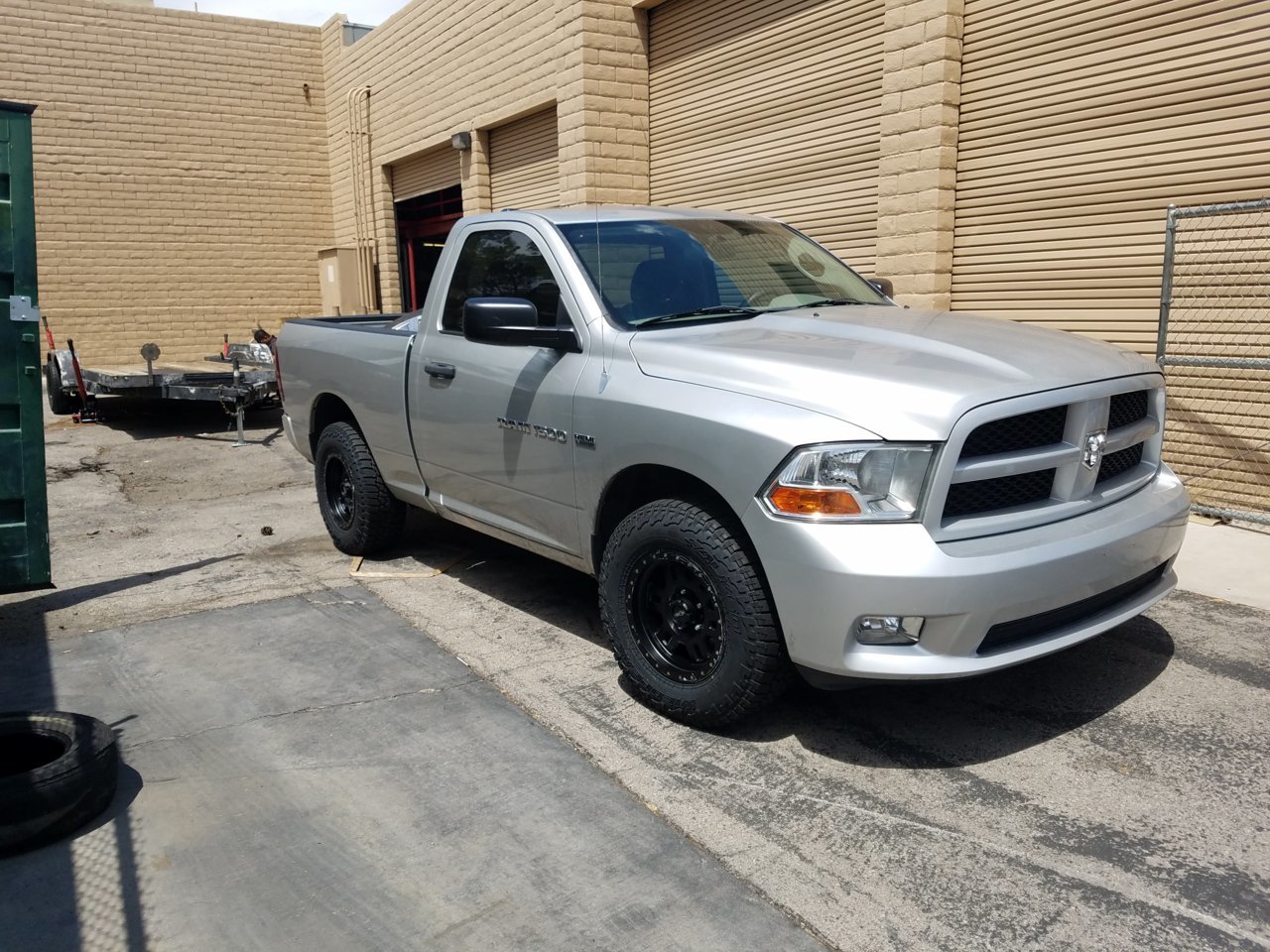

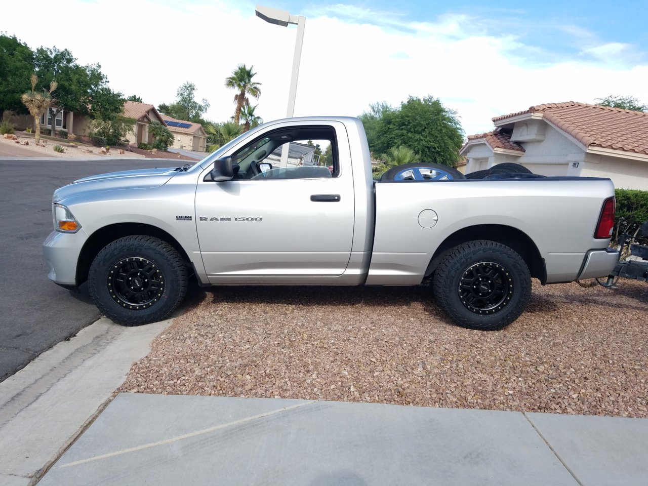

    The daily's new wheels and tires. Falken wildpeaks all terrain in 265/70r17. Went down in size but tires are pricey and it's the other stock size so hope it helps with my mpg and towing. Also 4 new tires for the trailer. Both long overdue.

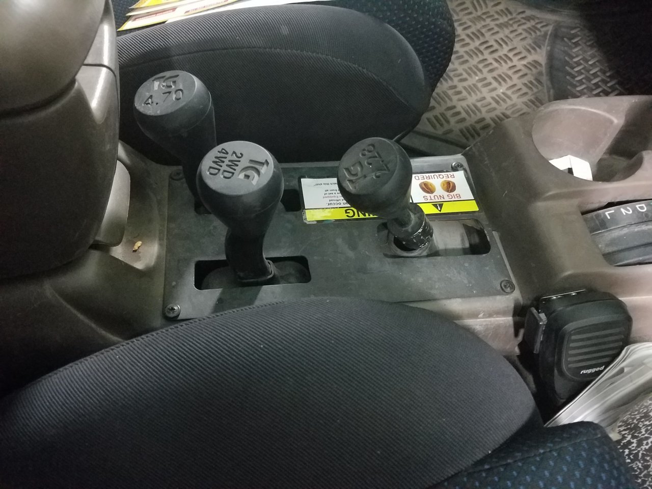

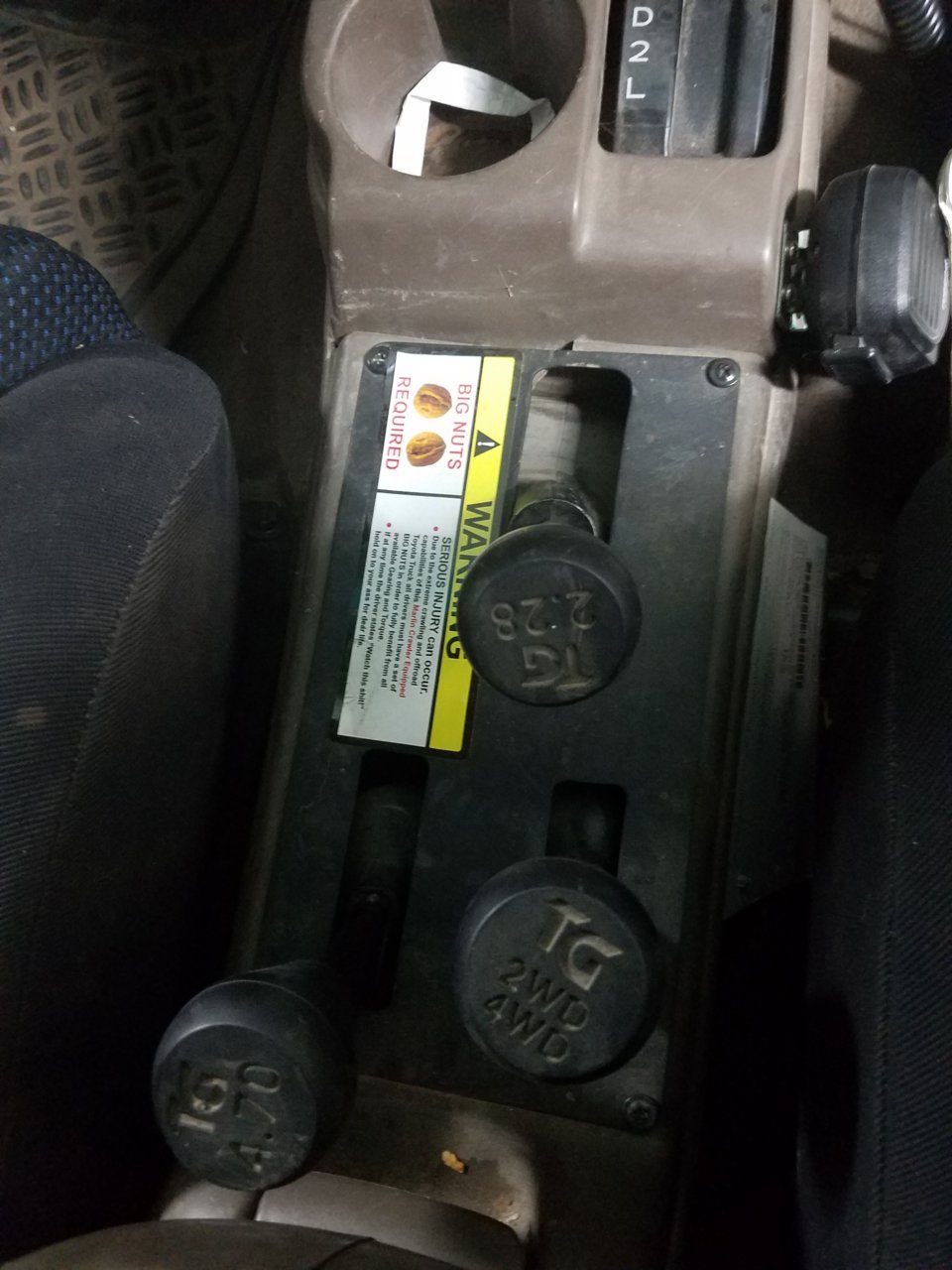

    Starting to figure out position of my shifters, did you ever do anything else to above, or is that still your same setup?

    Shifters are in the same spot but I ended up cutting out the extra plastic and making a metal plate for the top. Yours will probably end up being more foward since you dont have the prerunner adapter like I do.
    Some crappy pictures.

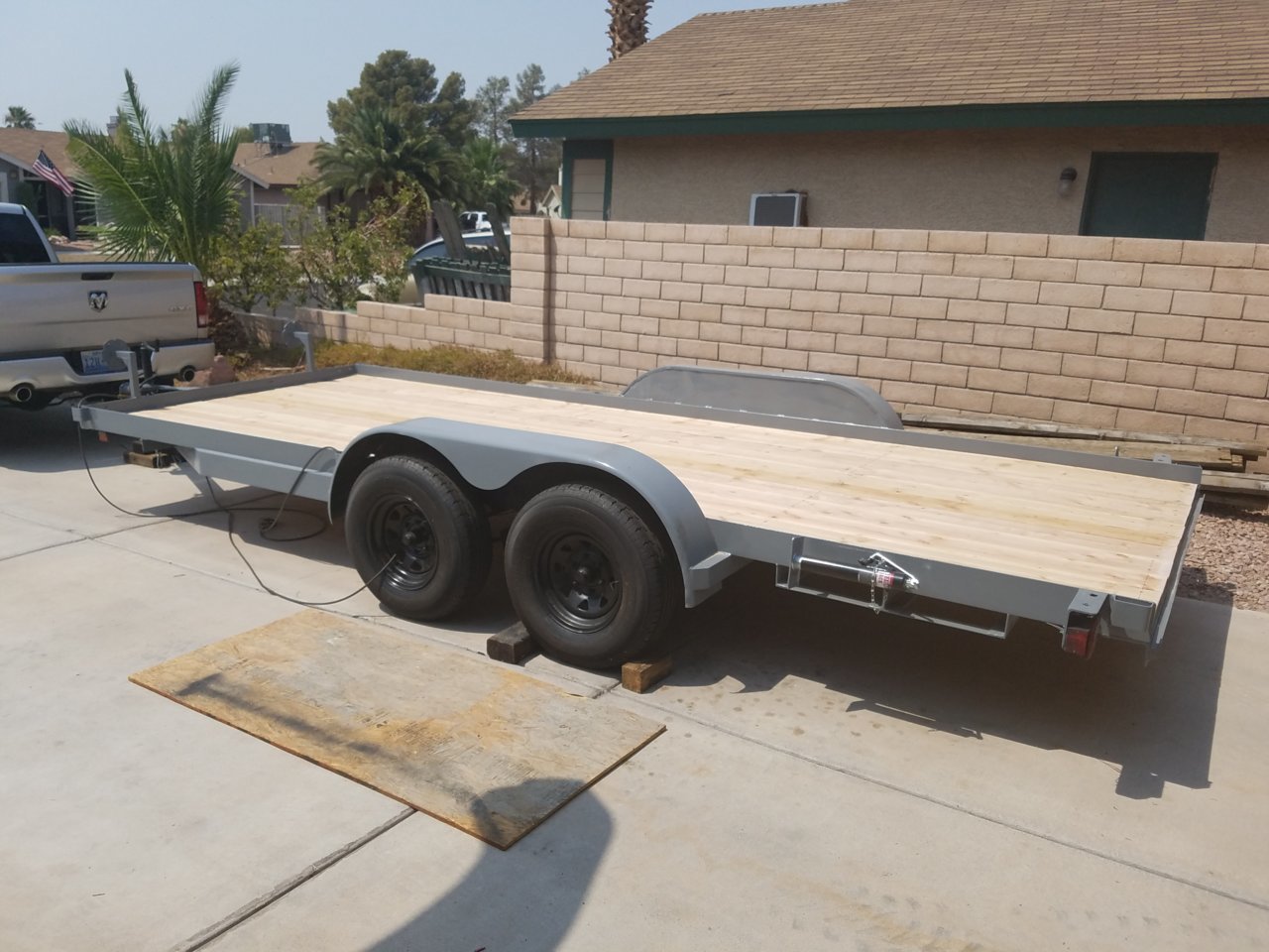

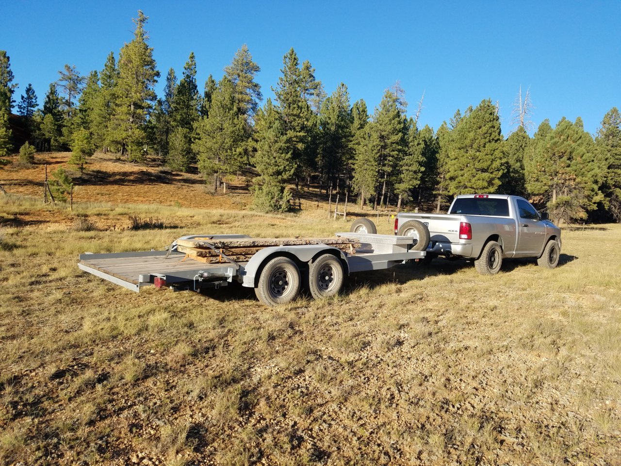

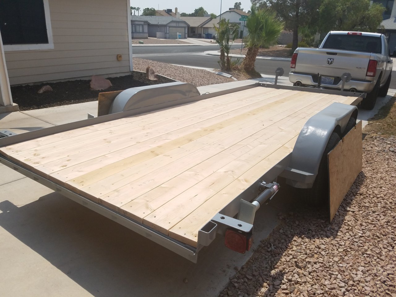

    Finished up the trailer this weekend. Think it turned out pretty good considering where it started. And all ended up costing significantly less than a new or even decent used trailer. New tires, dual spare tire mounts, new deck, rear jack stabilizers, and a little bit of paint goes a long ways. I'll put some stain on the deck to make it last and get some 1/2 weld on d rings to finish it out. Hopefully it lasts another 15 years.

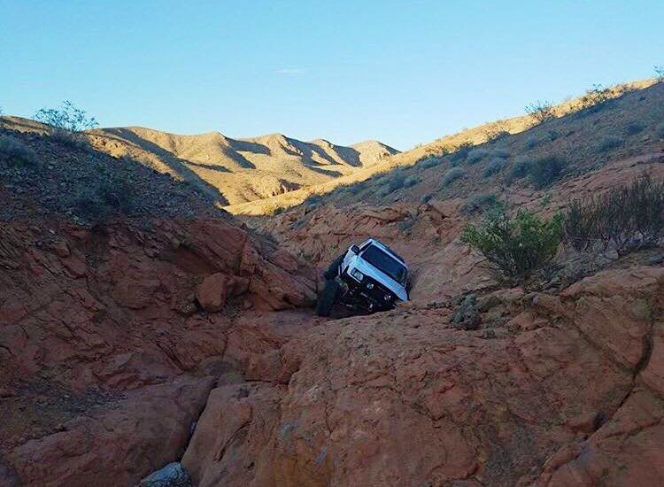

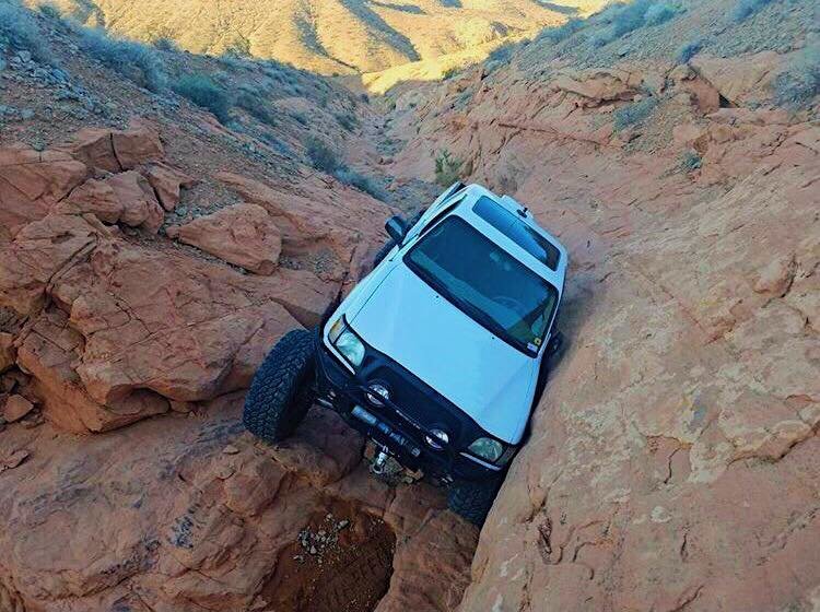

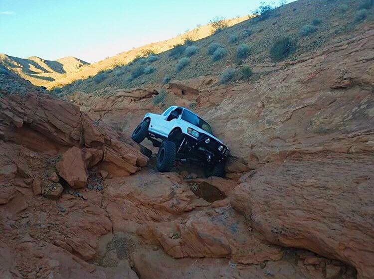

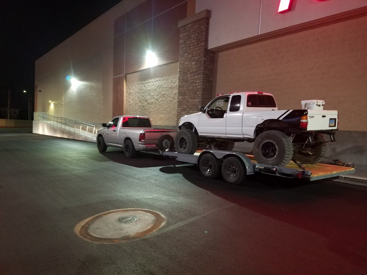

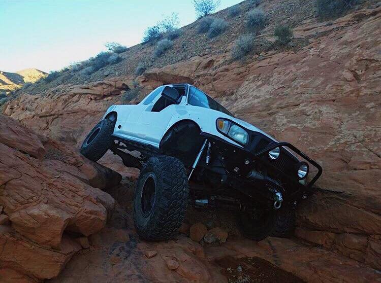

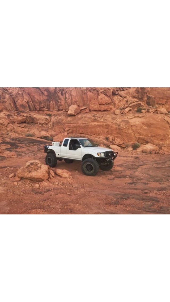

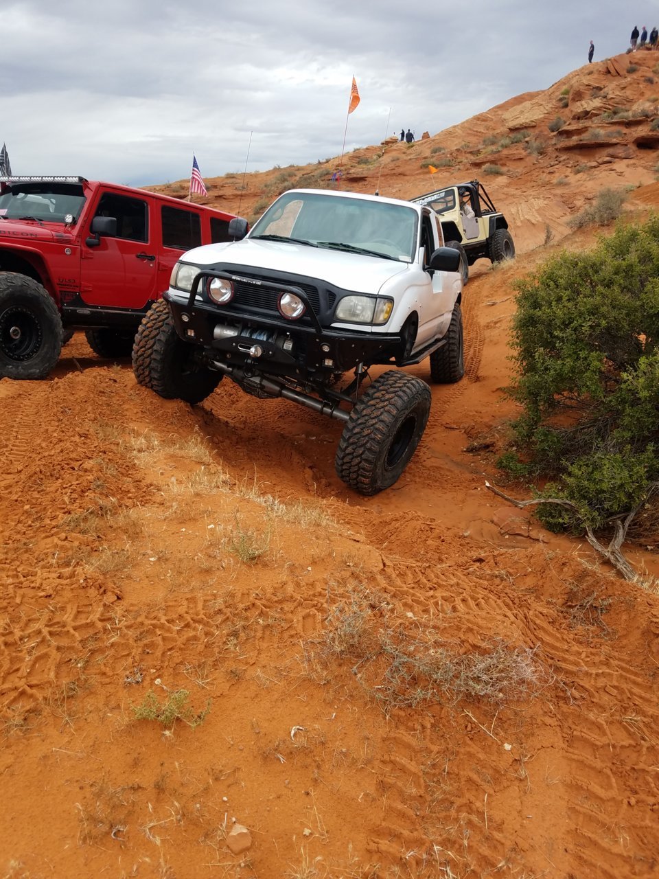

    More afternoon/night wheeling. Went to logandale this time and towed the truck with the new trailer. Worked great and super happy with the setup. Truck worked great as well but really need to get building the rear axle as the narrowness kills me sometimes.
    Did the usual big v notch I've done several times and this time didnt go to plan. Fell in right at the end. Was able to use the winch to pull the front away and walked away with no damage at all.
    Video on Instagram of me getting out of it as well as some good 3 wheel action after wards as I didnt get setup properly for the bend.

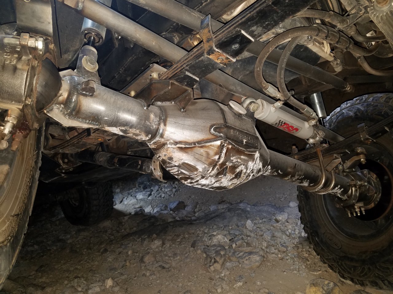

    Went wheeling In sand hollow for trail hero. Blew up a u joint at the tcase and thought it was the carrier bearing going out. Drove from the back of the dunes to the parking lot qnd pulled the shaft to drive back to the hotel and found the u joint barely holding on. Swapped in my spare and a new carrier bearing and beat the truck some more the next day.
    Only picture sadly. Sand hollow never fails to rain on us everytime we go though.
