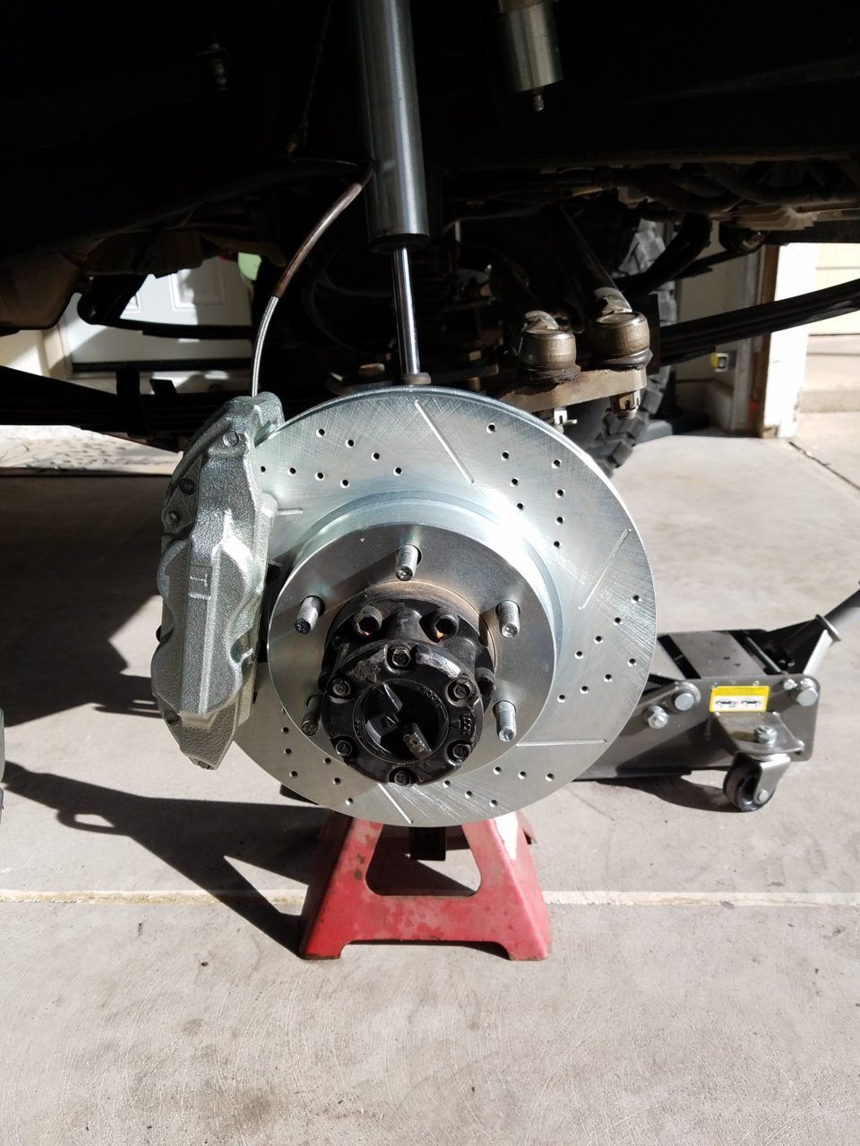

    Brakes are on. Been driving it for a few days. Pedals softer and has a little more travel but stops way better.

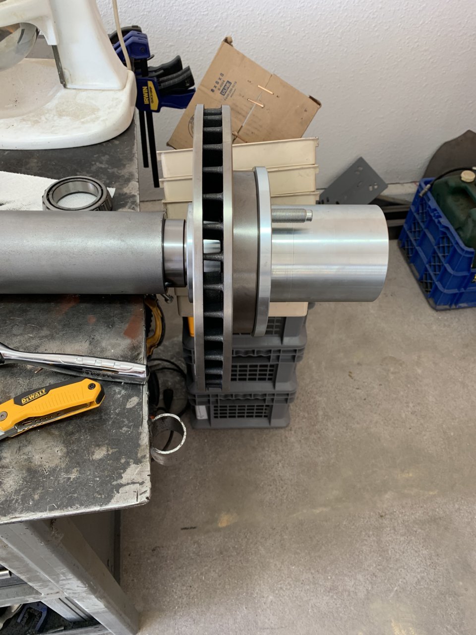

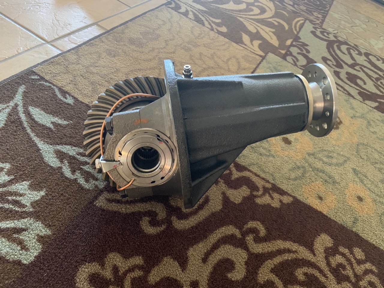

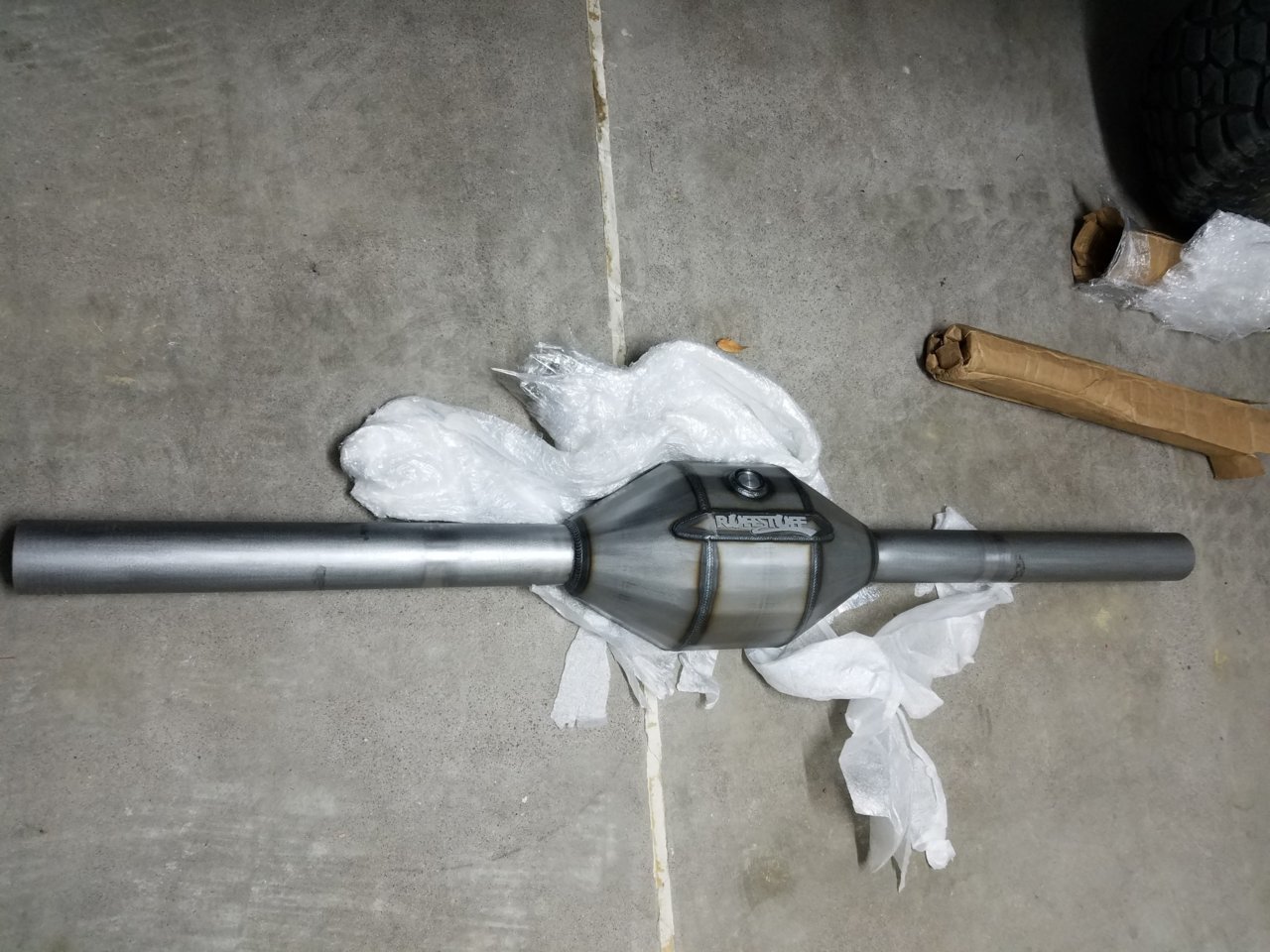

    Housing for the rear came in. Have to order some perches and the armor then measure for shafts and itll all go together.

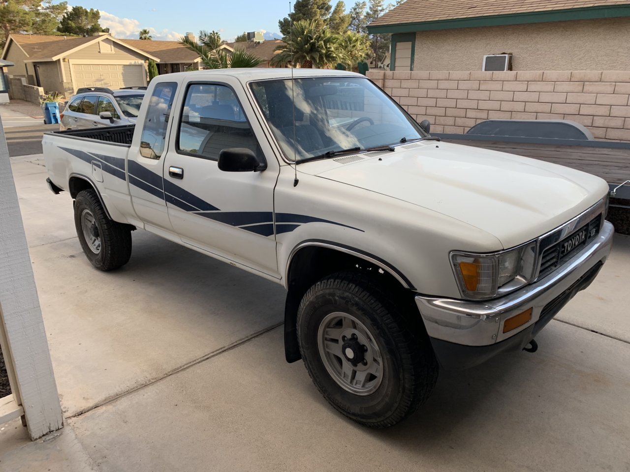

    And picked this thing up. 89 Pickup 4x4 and 3.0. Plan is to daily it. Drives well just needs the ac recharged.

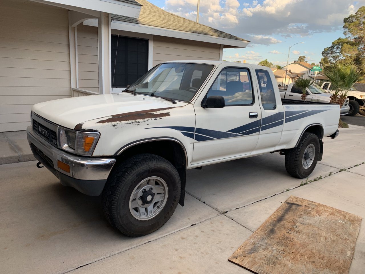

    Some better pictures of the 89. Paints a little chalky but think it looks pretty cool. Interior is mint besides the door handles.

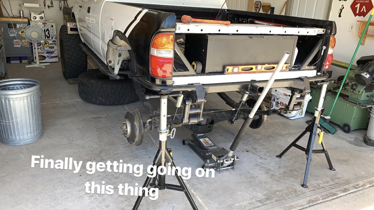

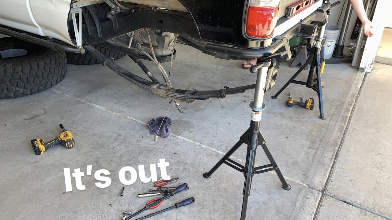

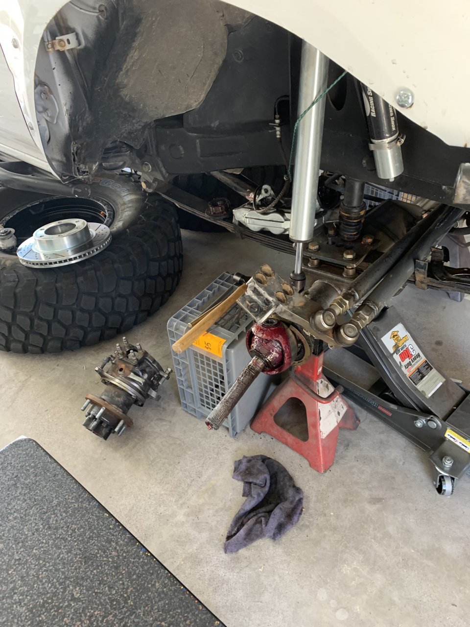

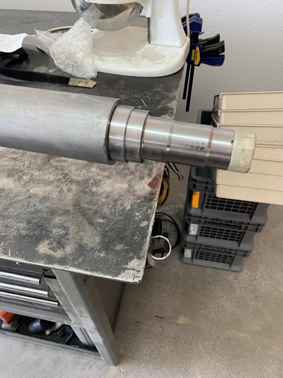

    Finally started taking apart the rear and dropped off the spindles to be machined down to fit in the housing. Redoing the leaf pack, shock mounts, adding hydro bumps, and a few other things. Should be looking good here in the next few months
    F52A6D94-C7C3-402E-A3DB-8E471C2085DE.jpg 8B1CC677-4A91-43D4-B0FB-8AD2C6A5F8ED.jpg

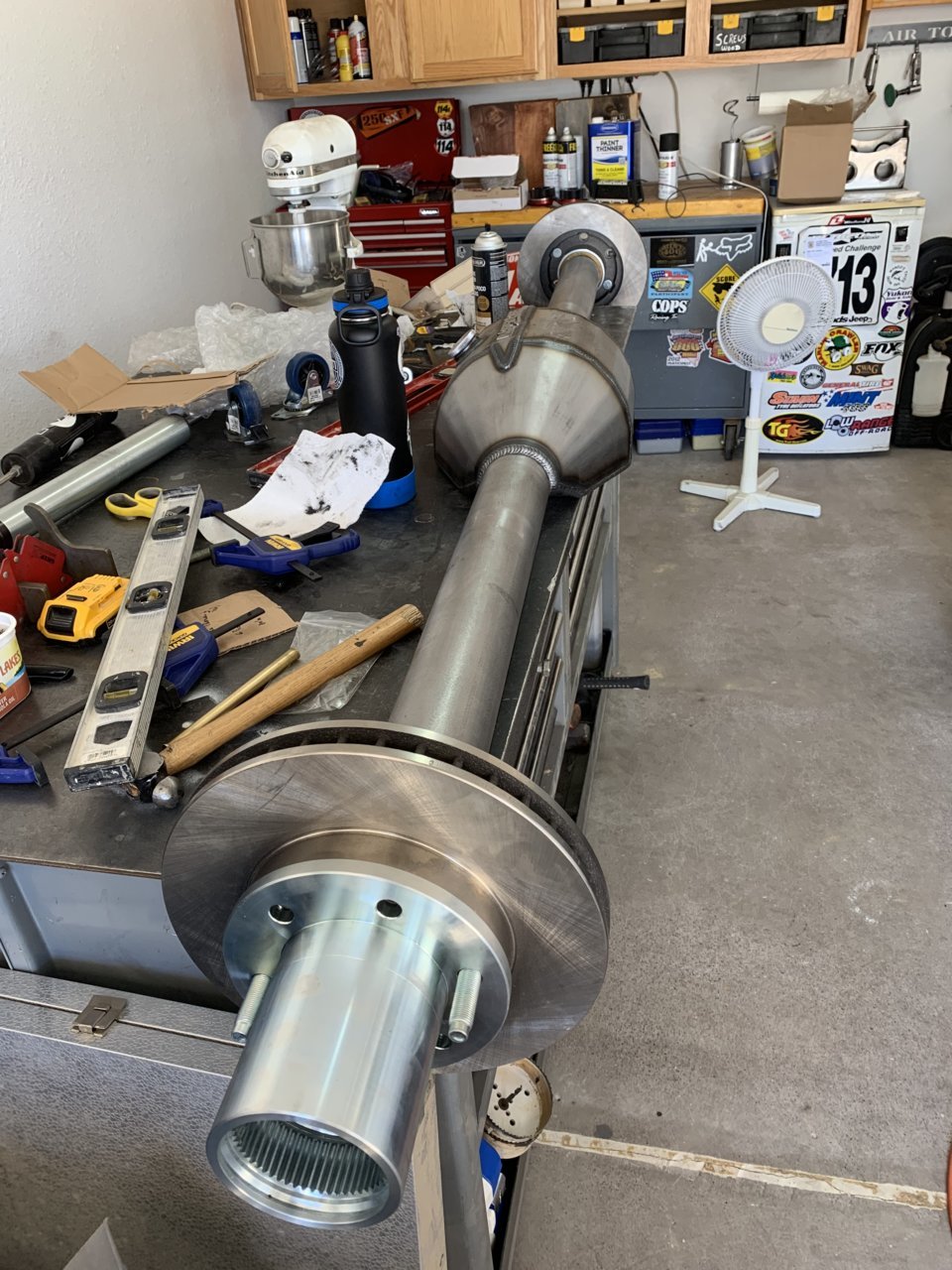

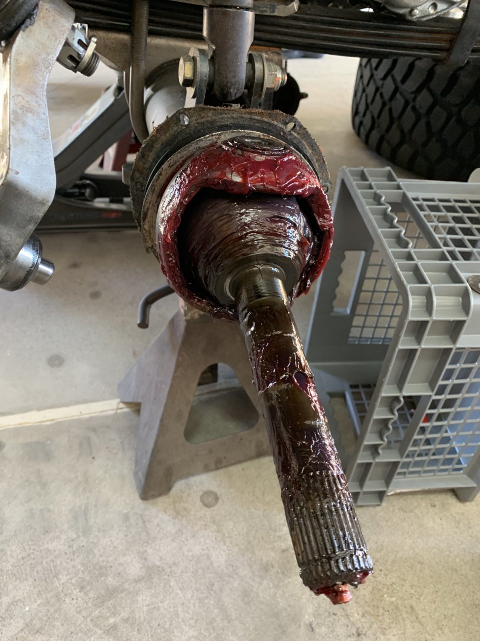

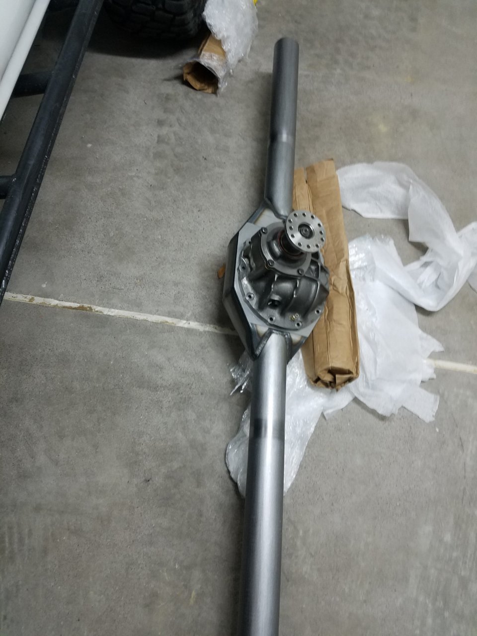

    Got the axle back and assembled so I can figure how much I have to trim off the axle tubes. As it sits, it’s 80.5 inches wide. Plan on taking off 12.5-12.75 to match the front at 68 inches. It’s a heavvvyyyy axle now and doesn’t have much added to it. Also tore apart the front while I was measuring it so I can put in the new 3rd.
    B8313721-11A2-40E9-9FE2-BD3F2BC75D1F.jpg 32A1A7AF-F31F-4425-A633-2257C8B8286F.jpg 712A7C81-DA21-4DFE-ACEC-69962A492358.jpg
    Was nice to see everything still intact and good on the front end.
