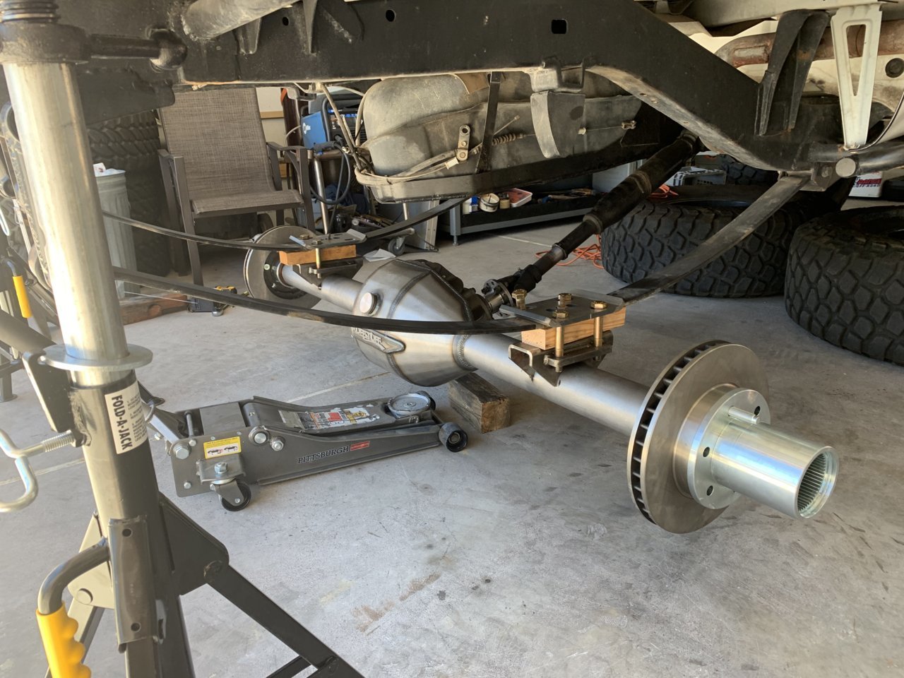

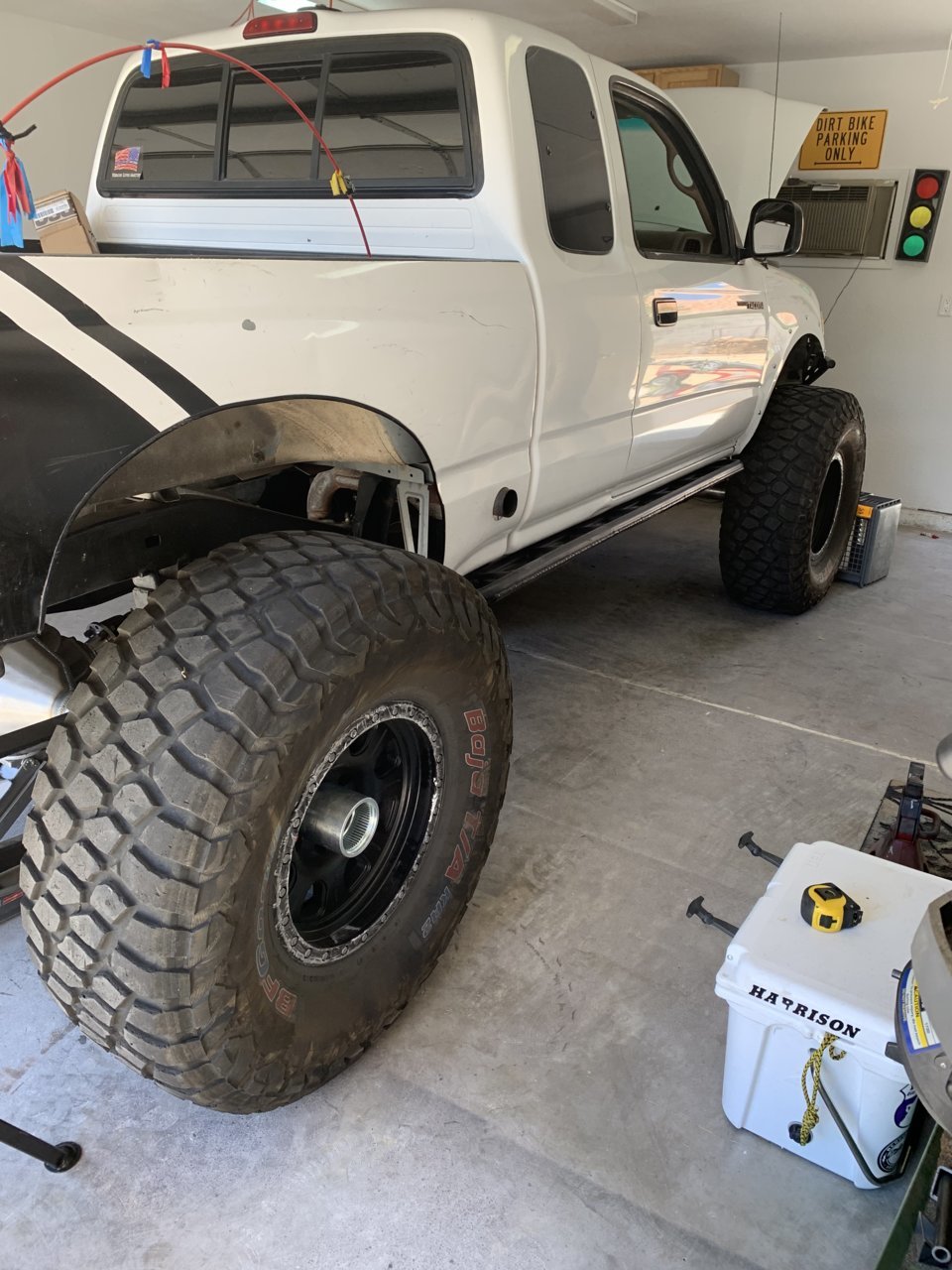

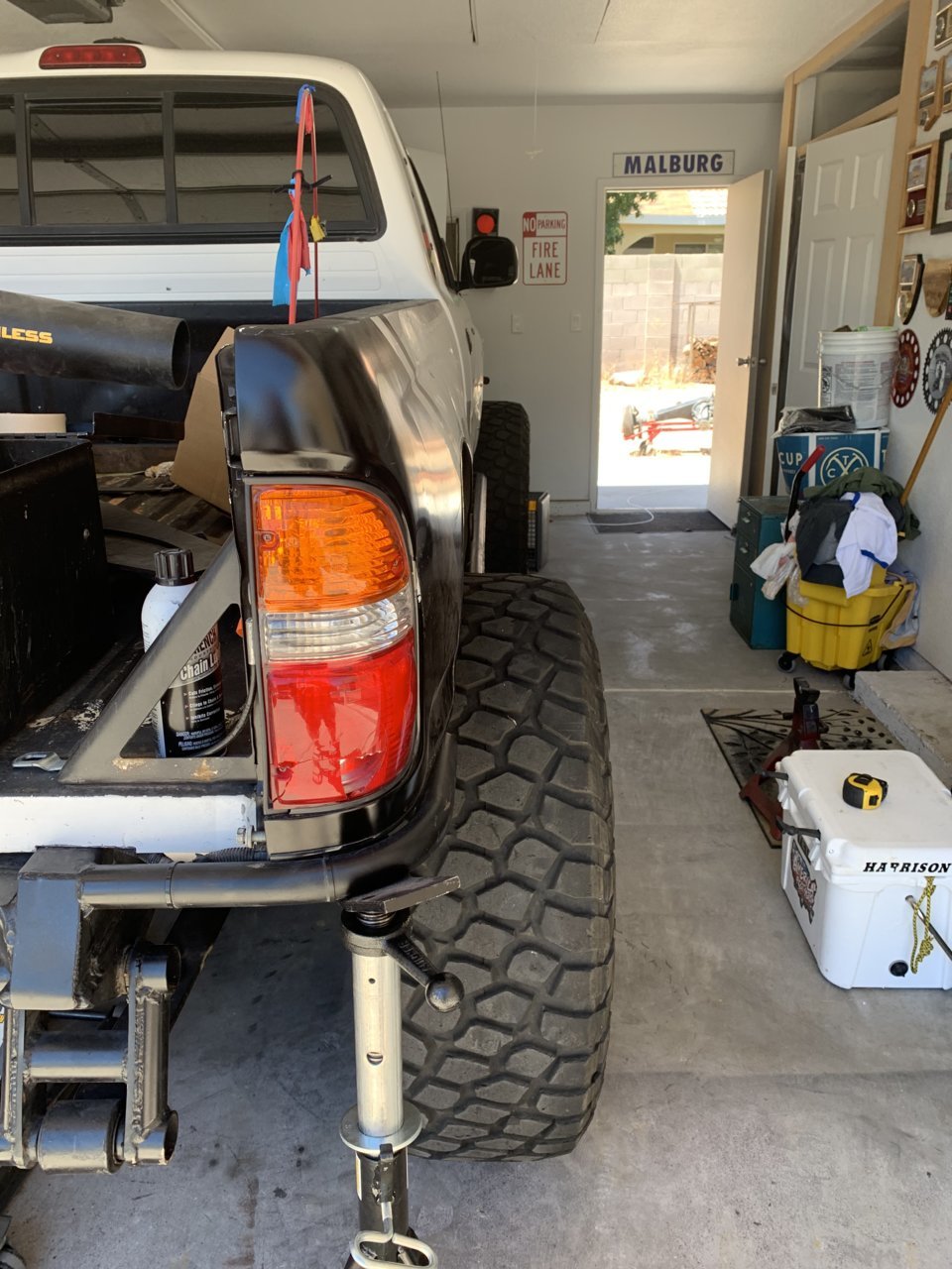

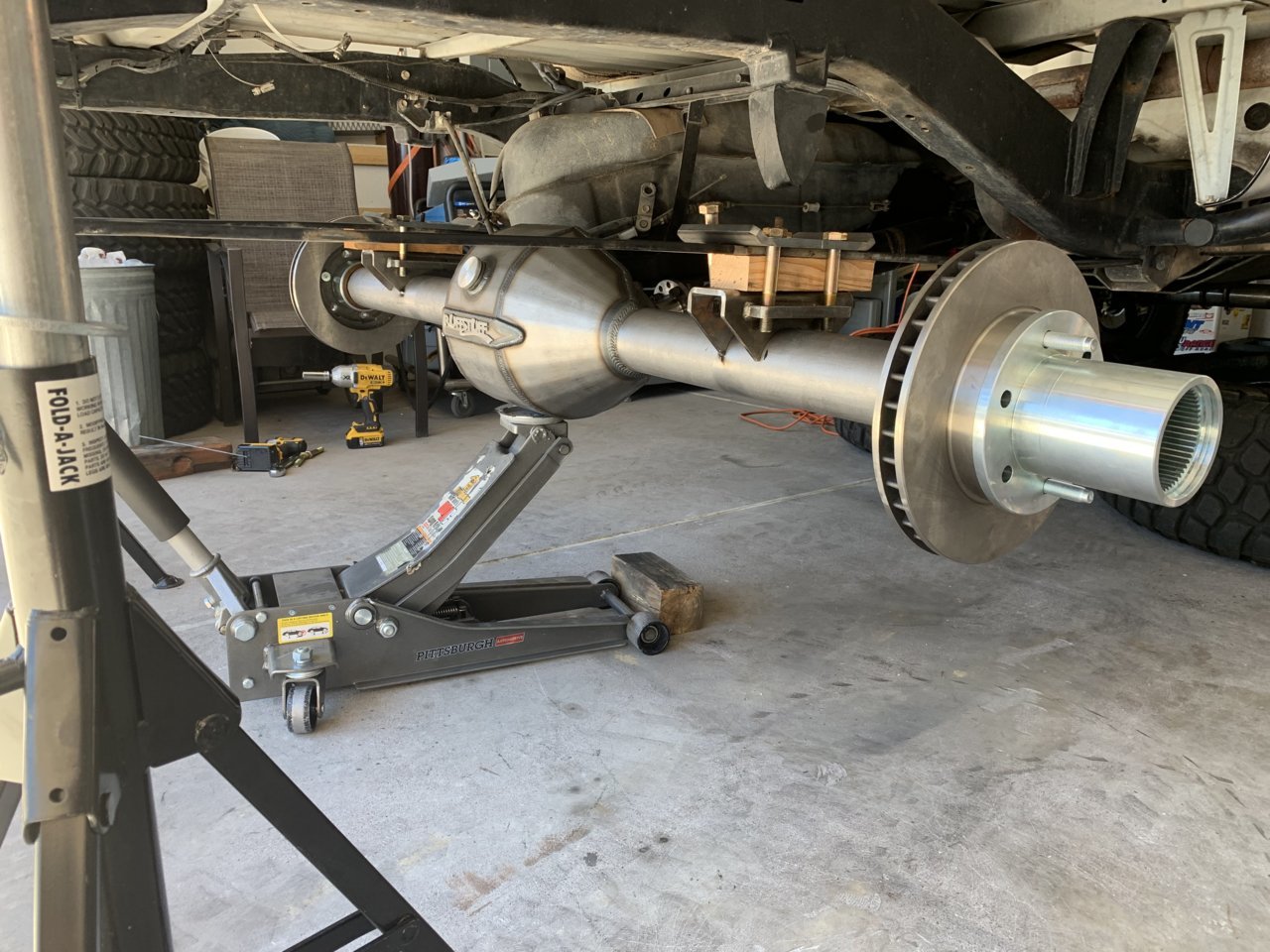

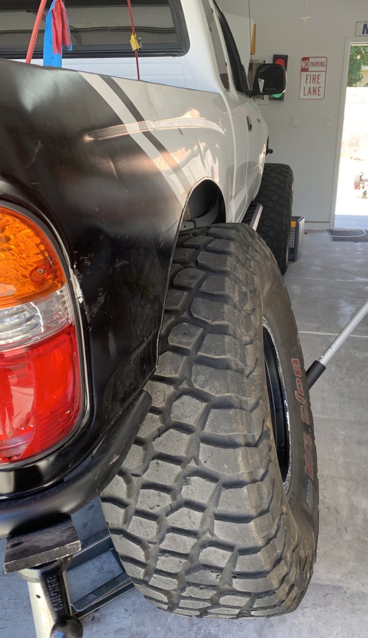

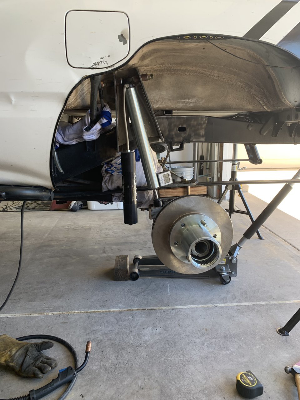

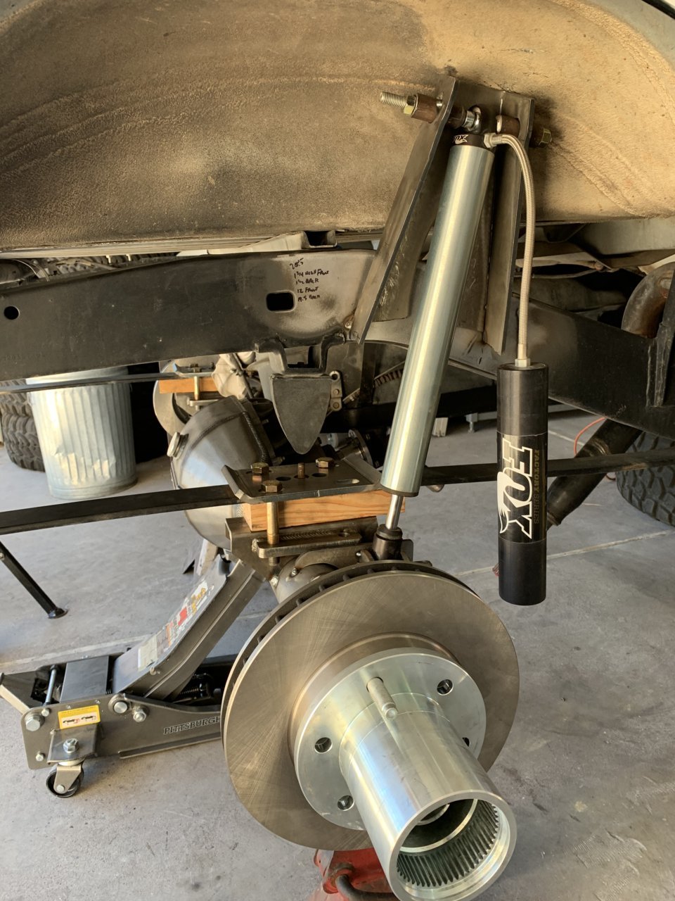

    But did make some progress today. Got the front end put back together besides oil and torquing the 3rd member and got the rear axle hung after redrilling the perches. It’s wide but looks like everything will clear. Driveshaft bolted up and now just to cycle and mount the shocks and bumps.
    06330151-621C-4E0A-A7AB-4D66D773BEBC.jpg AFF4E02F-403D-4387-A2AB-80BA22F84D16.jpg 835157A2-9737-4F44-90D2-816C5151596C.jpg
    Think this will end up being full bump
    And full droop
    Need to put some weight in the bed to get it to articulate properly.

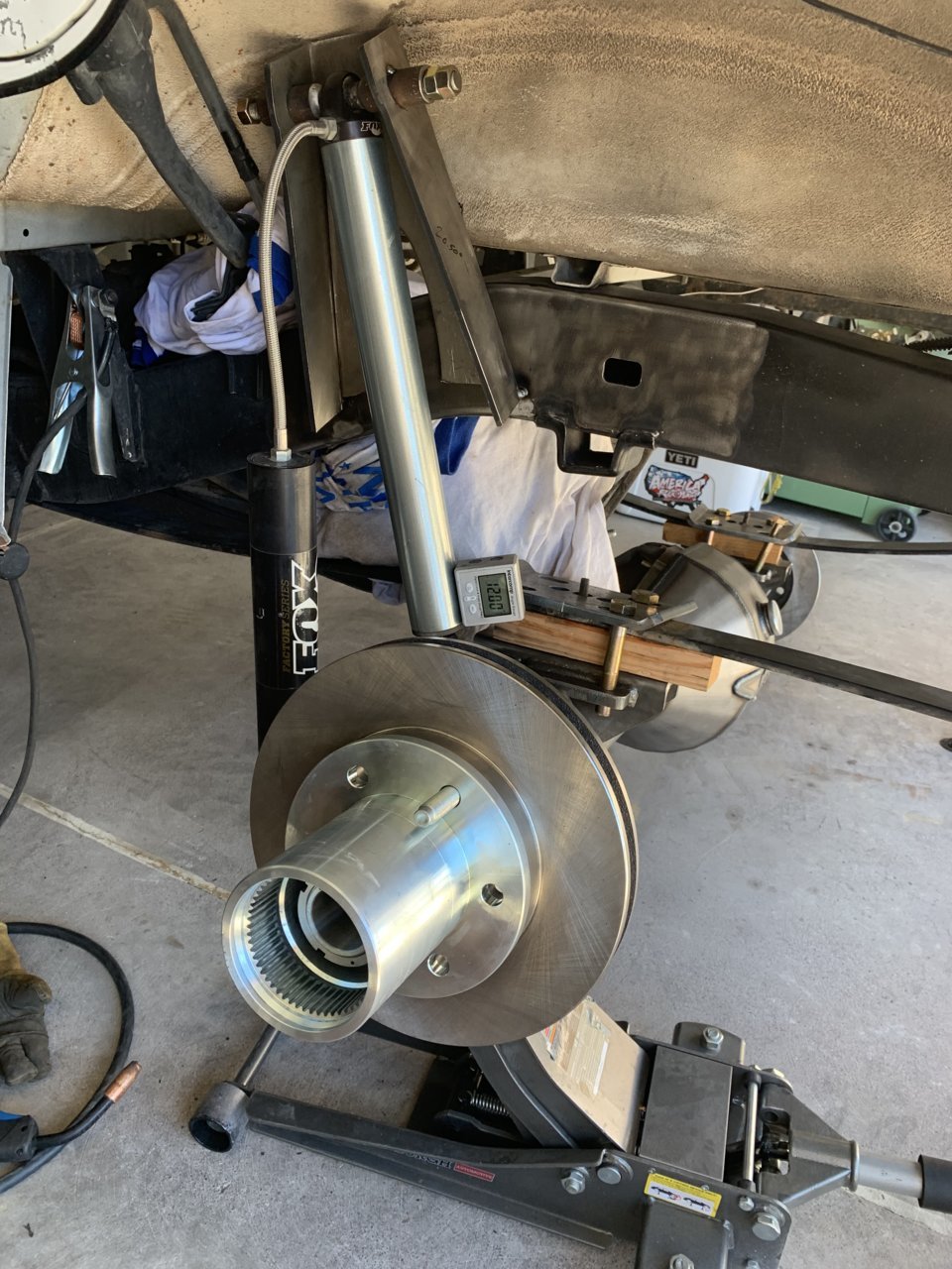

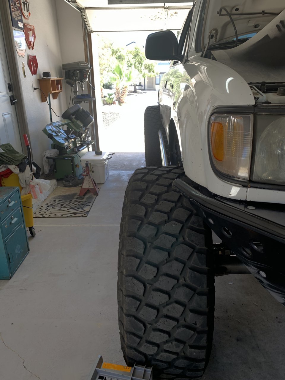

    I mean it looks cool if nothing else.

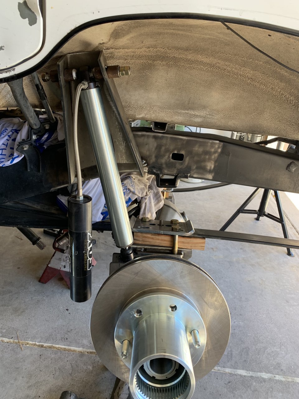

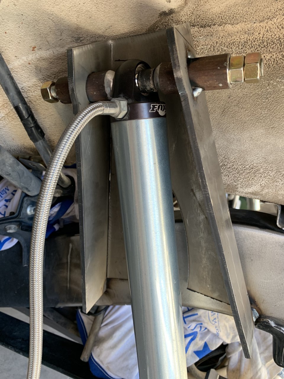

    Looking good, are those 12" or 14" shocks?
    Be a good time to weld on some frame plating where those shock towers are!

    12in shocks.
    I made some templates to plate the hole rear frame but decided I’m just going to do some 1/8 scab plates were the shock tower will be.

    Those shock towers from ballistic? Look nice

    No, had my dad cut them on his plasma table. He drew them up and made them. Same ones i put on the front though.

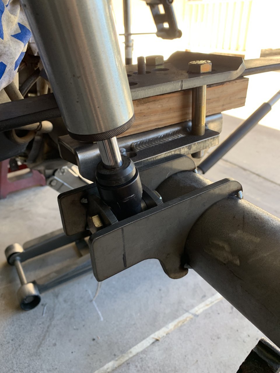

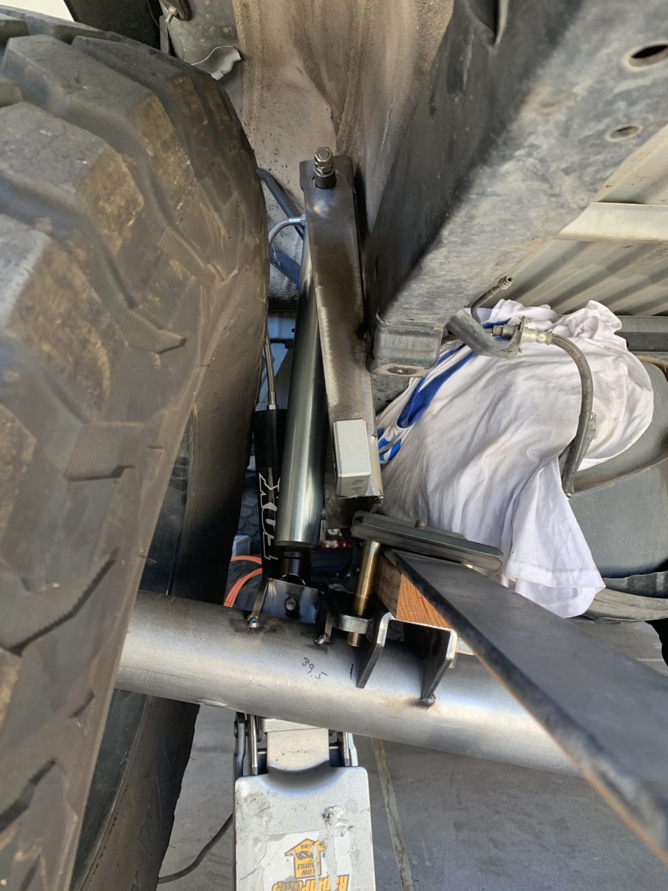

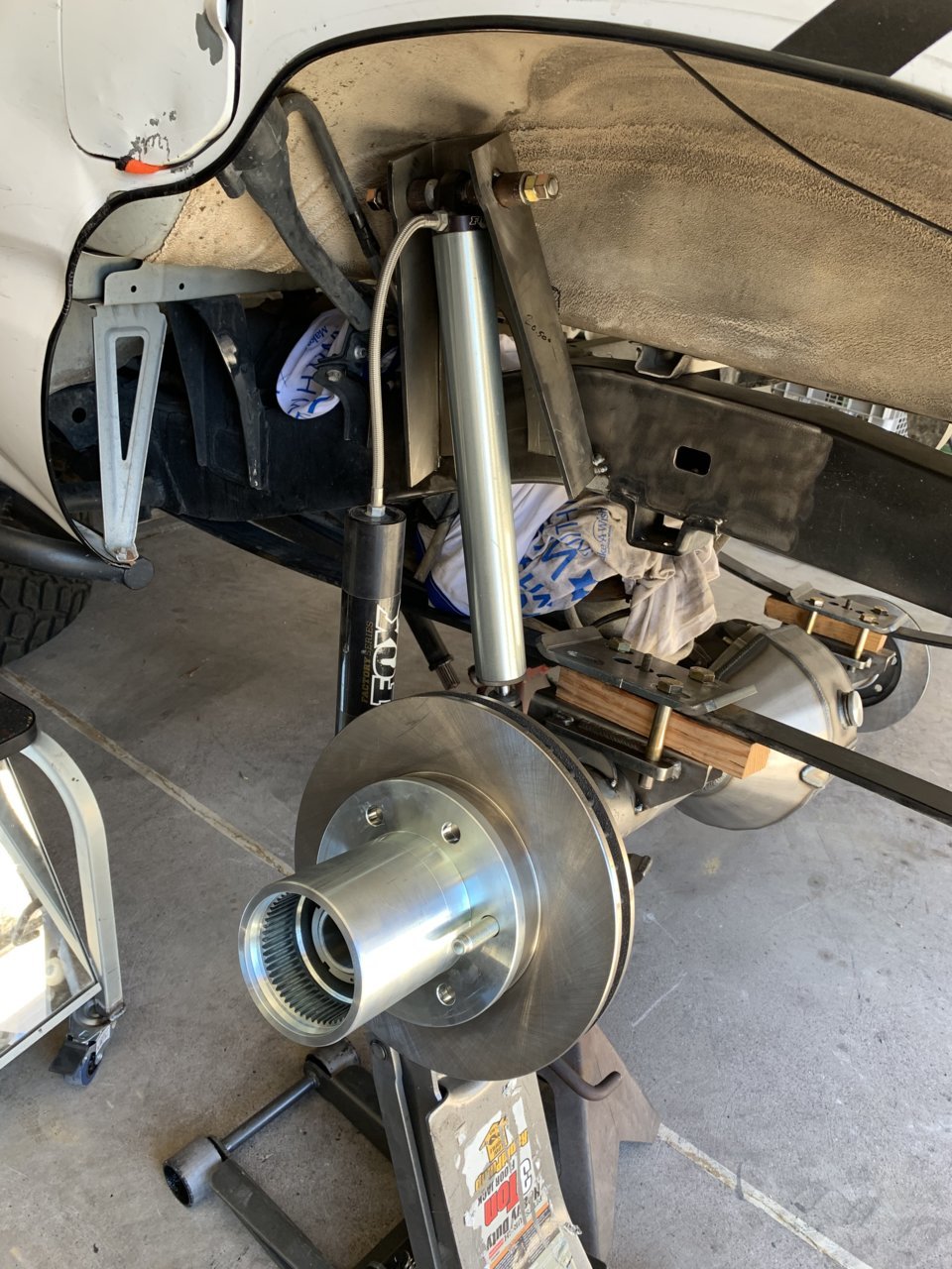

    More progress. Both sides tacked. Time to start on the bumps.
    This is at full bump both sides up.
    A0426DA0-C283-4D00-97CF-EE098EC5EE6A.jpg E7CB6D9F-5C11-43FF-8D4E-9F28A1047F15.jpg
    And driver side at full articulation.
    Some close ups of the shock towers and mount
    581D979F-5FE8-40A7-97AB-162820A4C33B.jpg CF2D2032-869E-46E9-856C-3EA90428DB37.jpg
