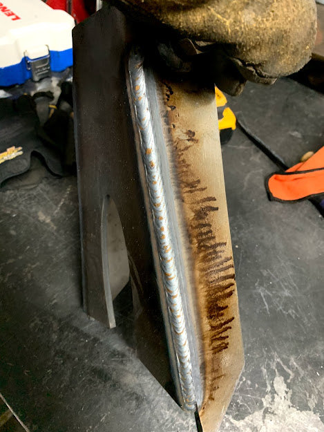

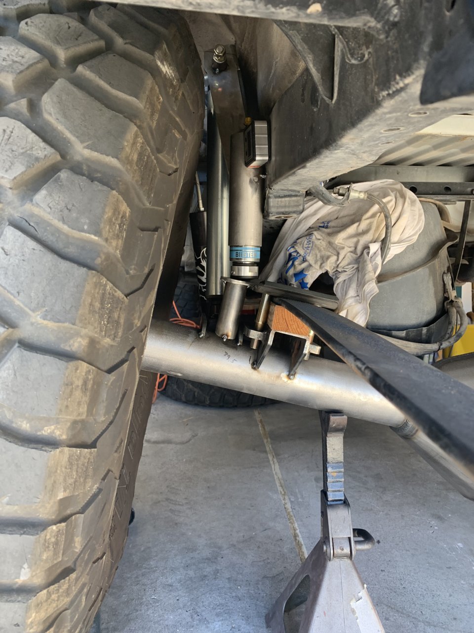

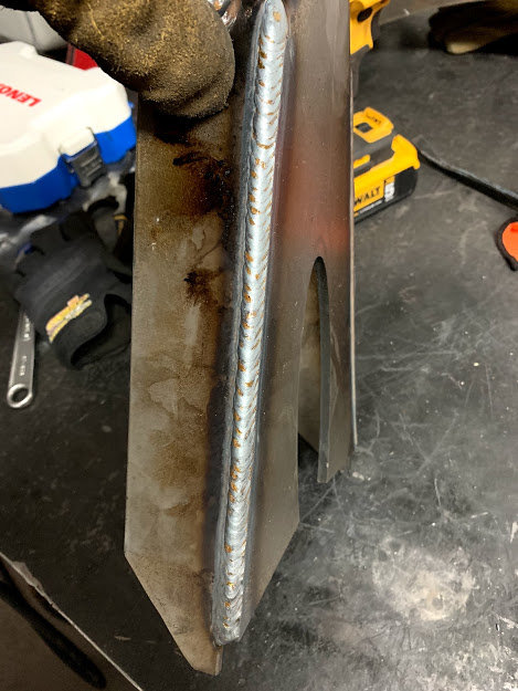

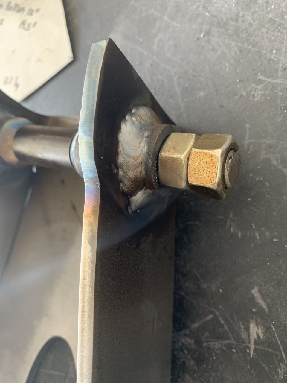

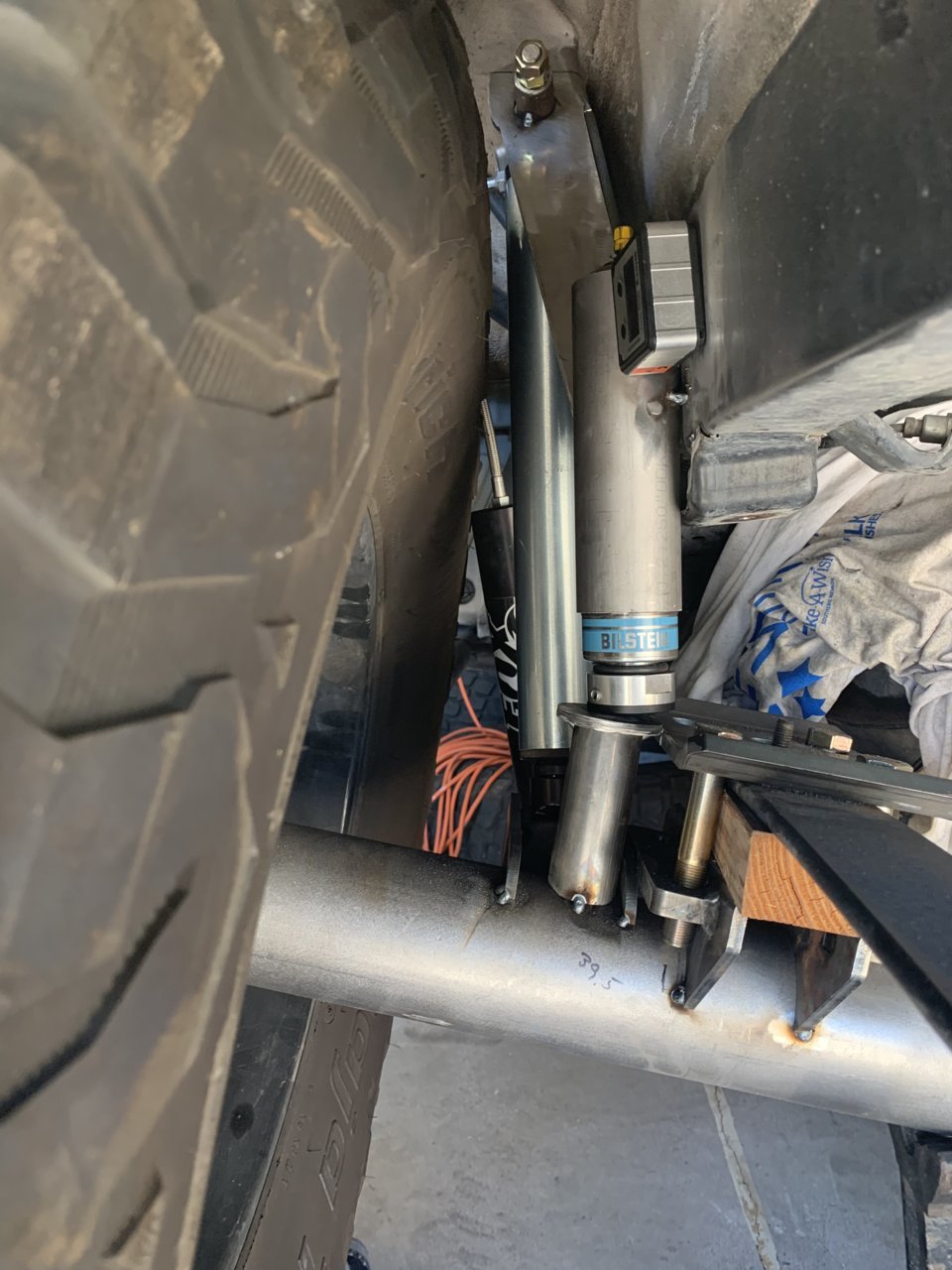

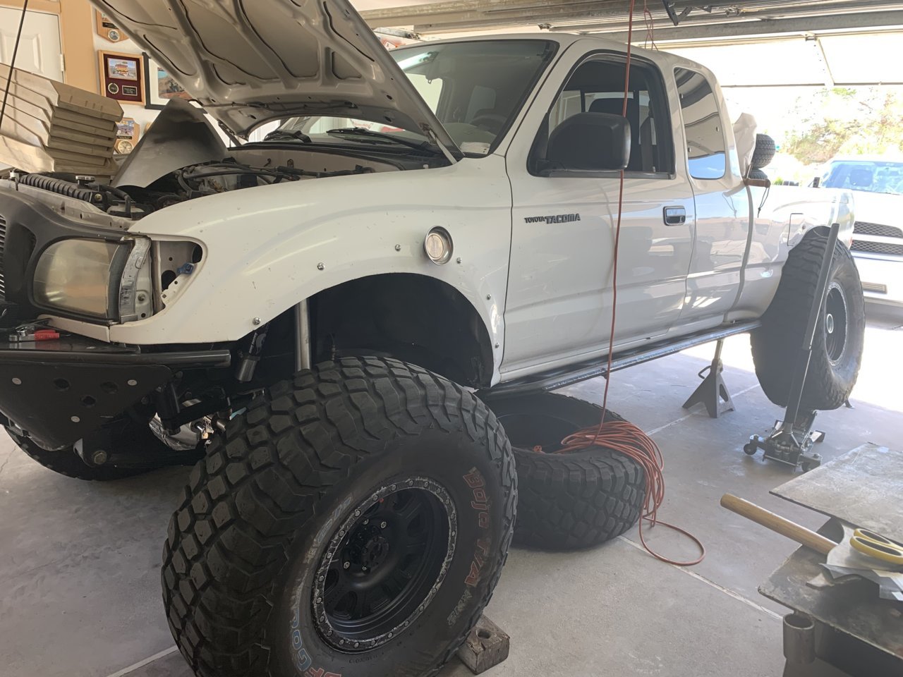

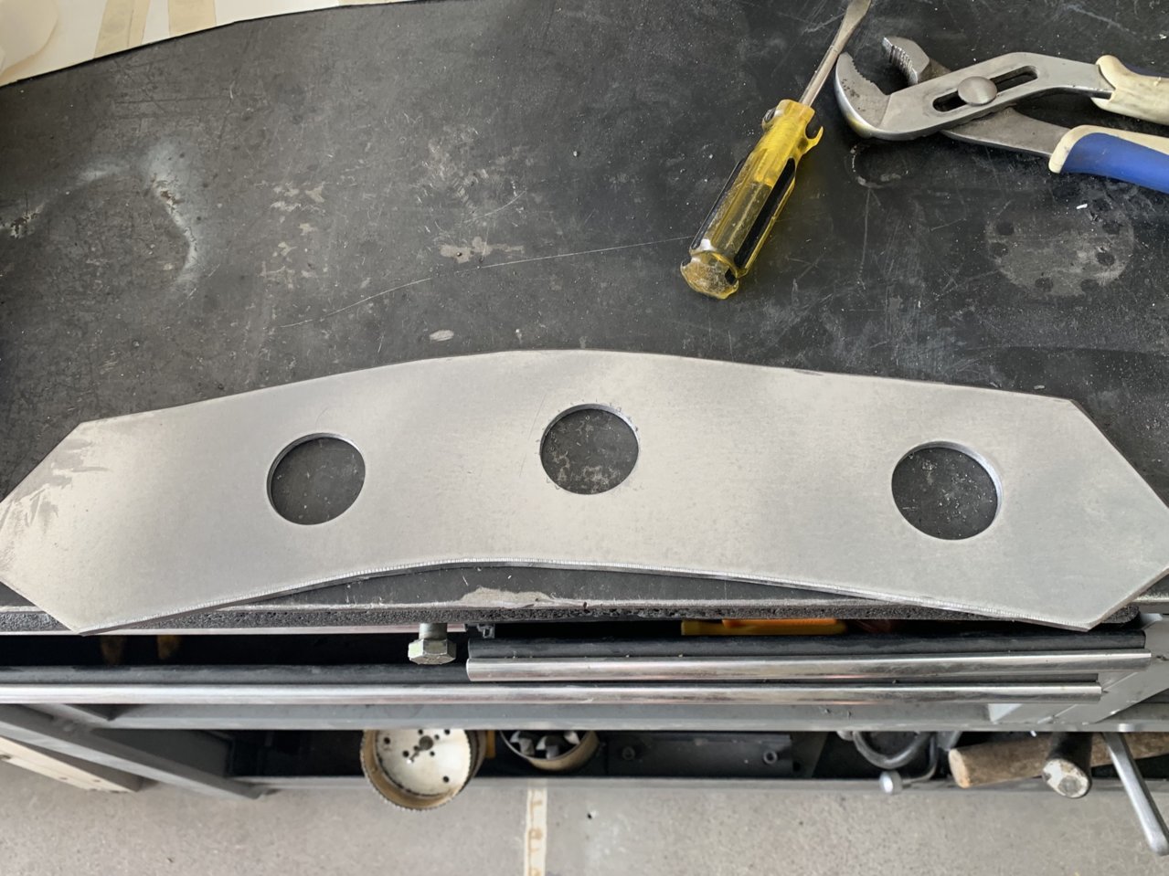

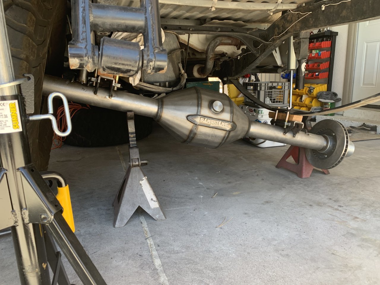

    More progress. Figured out the bump stops. Time to get all the gussets and frame plates cut them time to start welding. Going to beef up the strike pad for the bumps and do some plating but think it looks pretty good
    Full bump
    Full articulation
    And just some clearance pictures

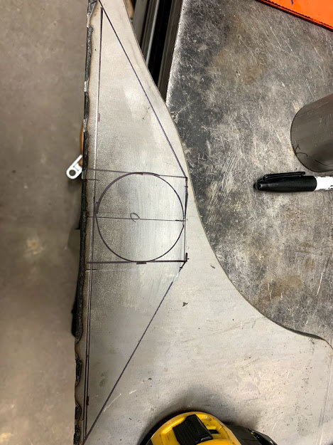

    And the frame plates I’m not looking forward to cutting out. May need to go borrow the plasma

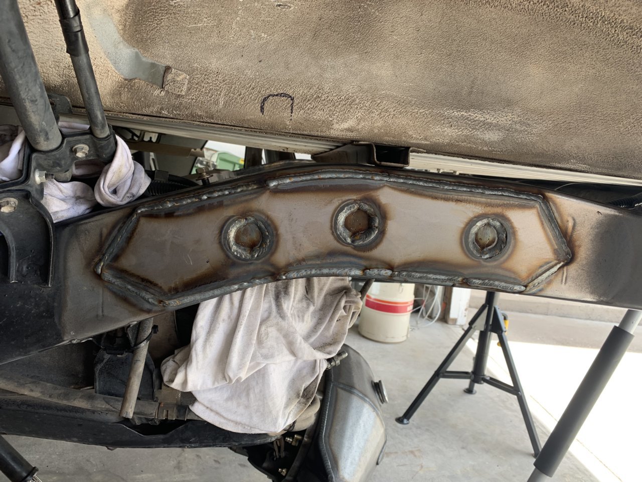

    I feel like I get so much done then I take pictures and realize it’s barely anything :rolleyes:
    11868E0B-A0B8-46CA-955F-FB4118F796F0.jpg 0D12D24D-0A43-48DB-B2CB-2A21E551CFF1.jpg 8570F915-E230-4632-9C64-4AA1BD8576AA.jpg 287E5314-CA4C-4607-B13D-B3E4CE92A33D.jpg 7AF84DB1-9B60-424B-A87A-A6BF9A4F30B8.jpg 180361E9-6080-49E9-A6F9-B75197F7810C.jpg EFC60D62-5680-4DEC-BE42-CEF2D02A0108.jpg

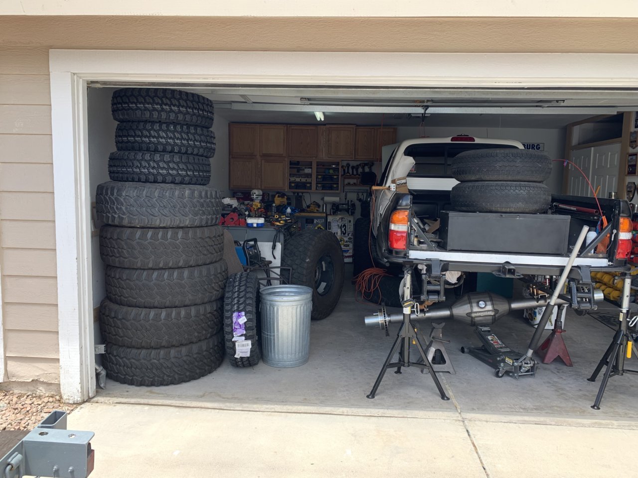

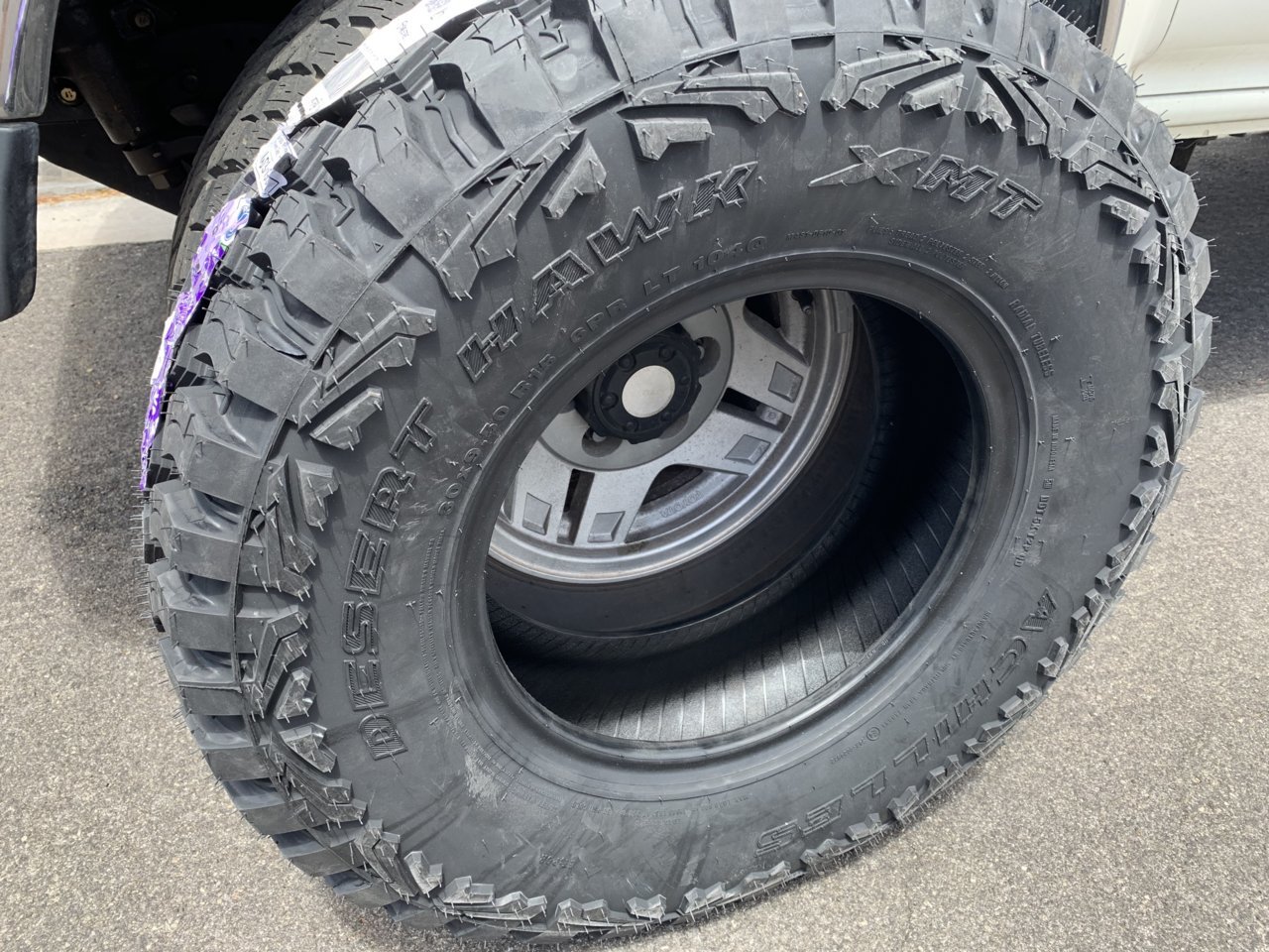

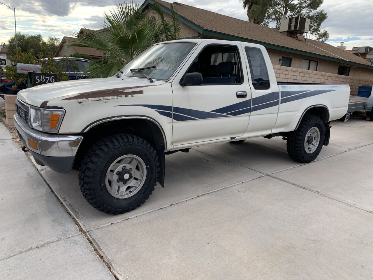

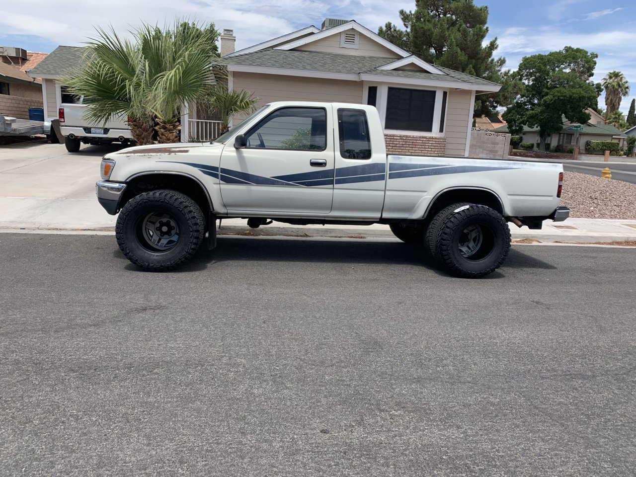

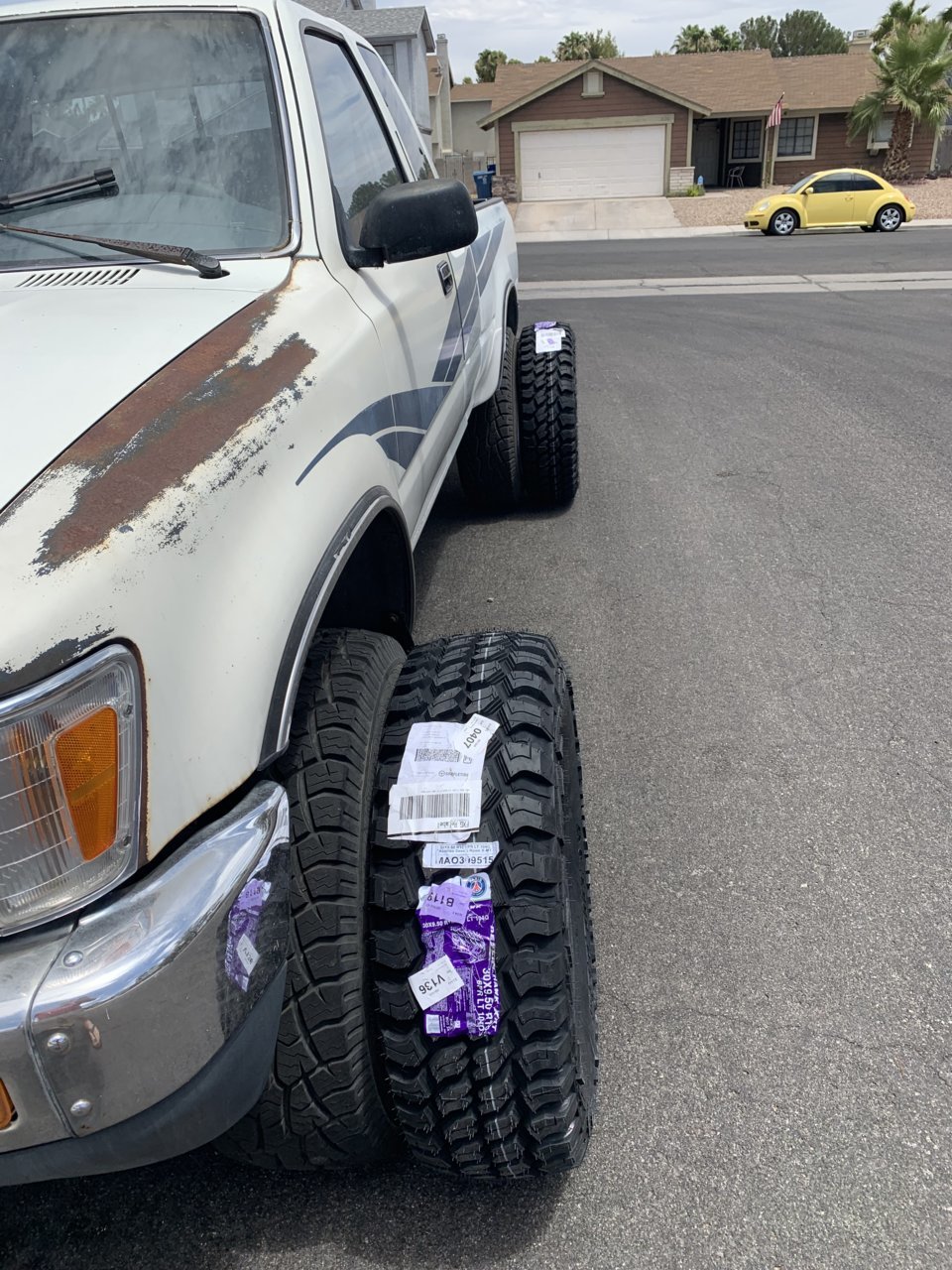

    But new tires for the 89 showed up. And the battery died in the dodge...
    A91E287D-0E9B-4E07-9158-B58309A86026.jpg 314D3335-0447-4115-96A7-7C9D61AE5CF2.jpg 02360E1B-43FC-45AF-A614-F97B34CE816F.jpg

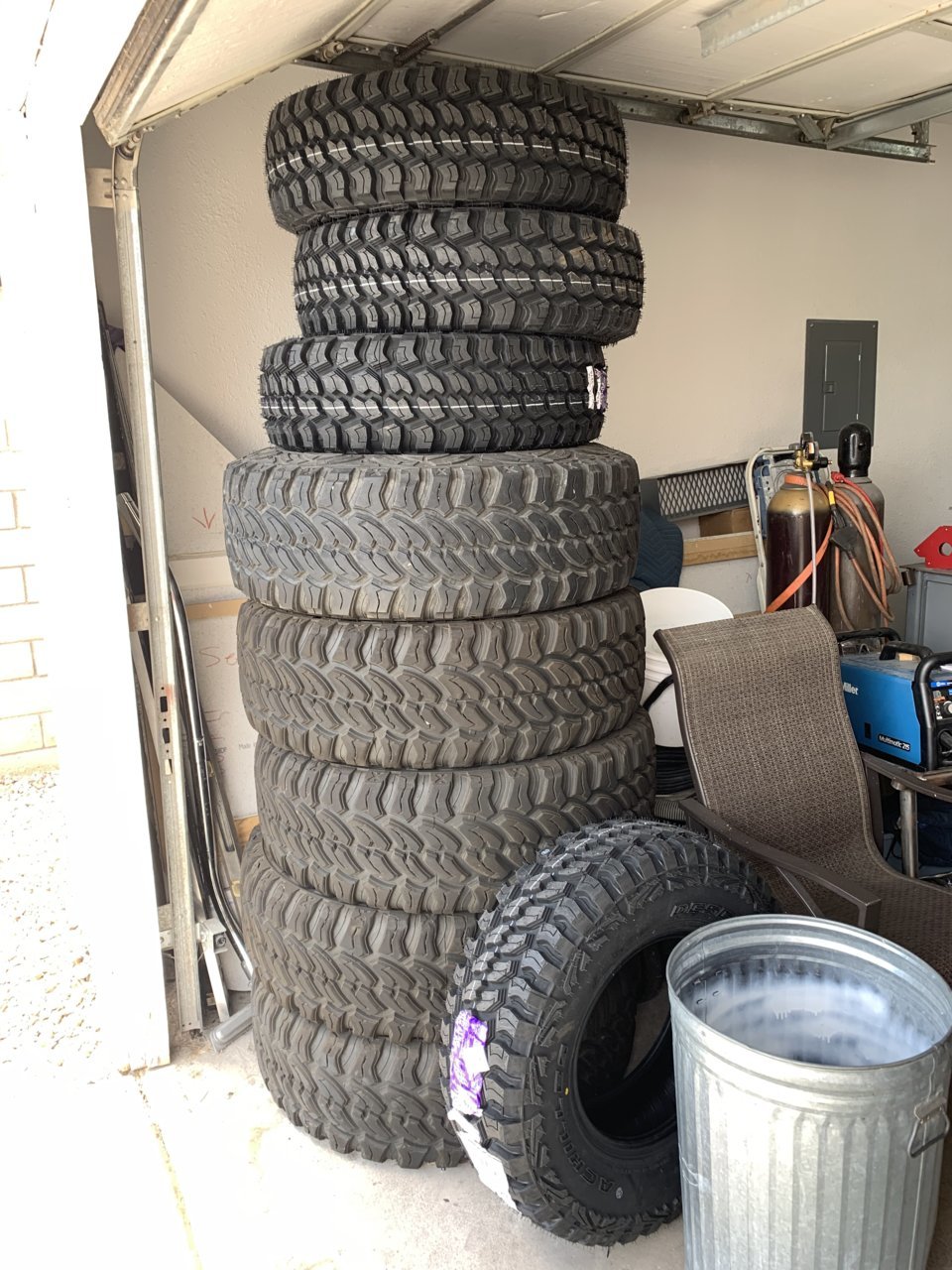

    And my wall of tires... someone buy these 37s

    89 looking good.

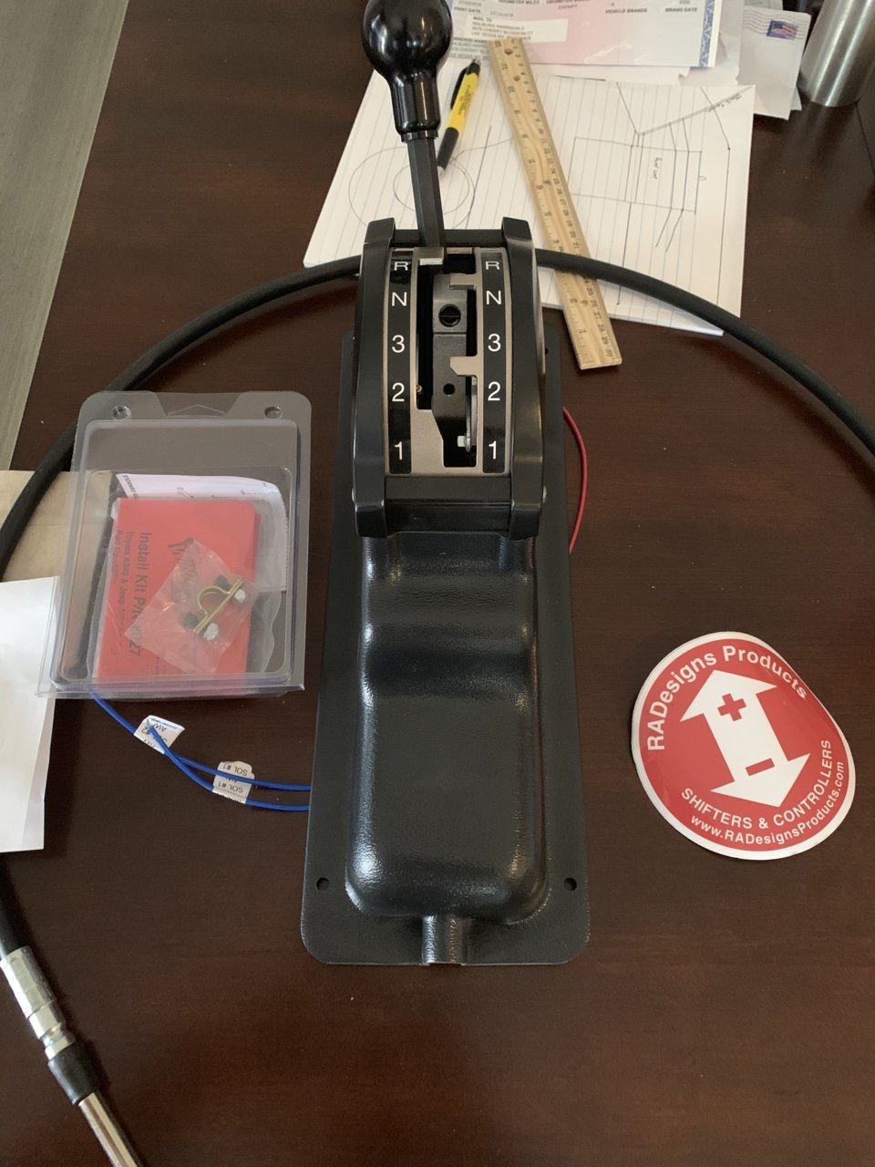

    And because race truck. Let’s yiu shift the automatic like a manual.

    Is that for stock Toyota A340?
    Link?

    Yep. I bought it new in box off a guy but here’s a link.
    http://www.radesignsproducts.com/winters-elec.-control-kits.html
    The way I understand it is when you put it in 3 to the right, it’s like drive and it shifts normal. Left 3 is 3rd. 2nd then 1st and it looks it in those gears. This is the rock gate so you can slam it from 2nd to reverse fast. Not sure how I feel about that but I’ll try it.

    That is one thing about the slush box is the inability to hold a gear without hunting or surging... nice find!

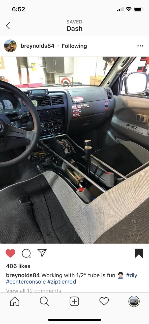

    Does this unit fit under the stock console? Looks really cool.
    Do you have a shift kit in the trans?

    Highly doubt it’ll fit the stock center console. I plan on making a new one. Everything is included with the shifter. Just wire it up and connect the linkage. Or atleast that’s how I understand it from talking to other people. We will find out in a few weeks hopefully

    3 is D, no matter left or right position, 2 is 2nd gear, 1 is 1st gear. The A340 is a 4 speed so overdrive is the 4th gear, overdrive off is 3rd gear (if you are on the highway). Once you get it all apart you'll figure it out. The overdrive button on the stock shifter will need to be wired to a different momentary switch, or the stock one if you want to keep it. I bought a generic red momentary button for mine.

    Cool thanks man. I’m sure I’ll be messaging you when the time comes to build a center console and put this thing in. Do you have any pictures of the sub frame of your console and how you mounted it? Thanks

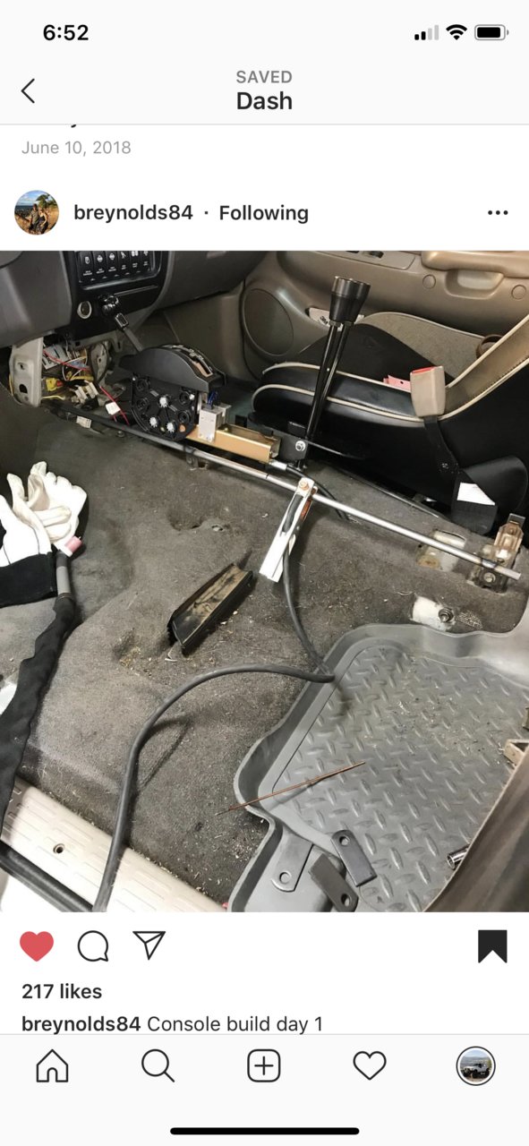

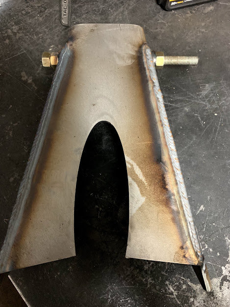

    These are what he had. Gives me an idea of how to do it.
    More on his Instagram of the completed one.

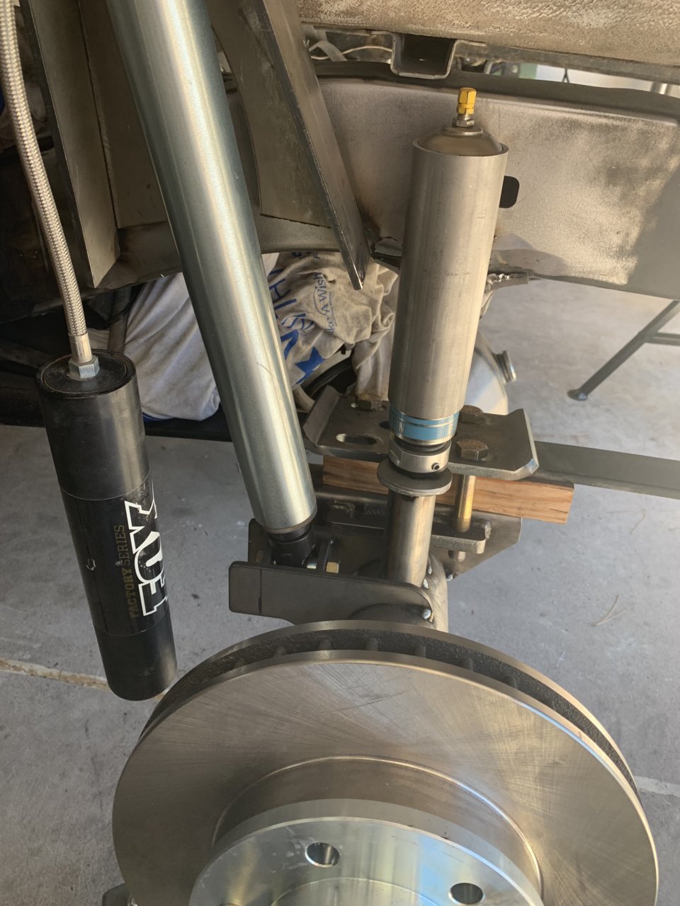

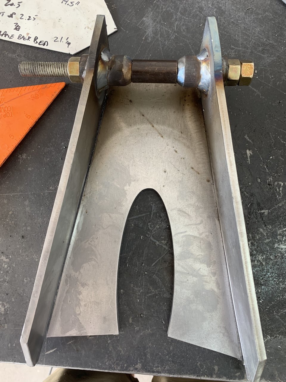

    Its hot... Progress has slowed substantially.
    Plan for the bump stops so its all one piece. will tie into the shock tower some how.
