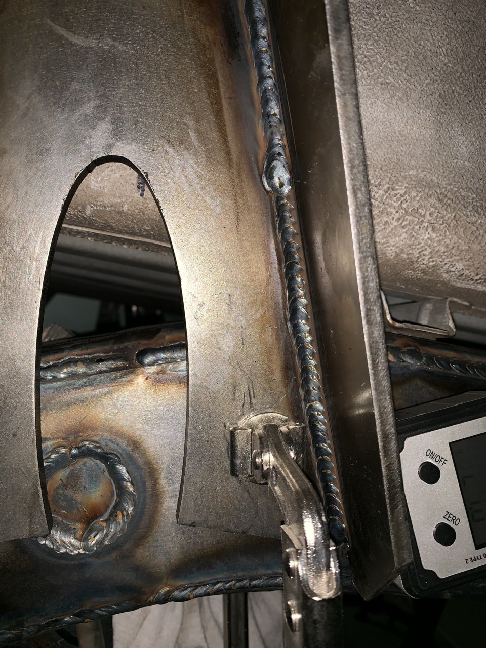

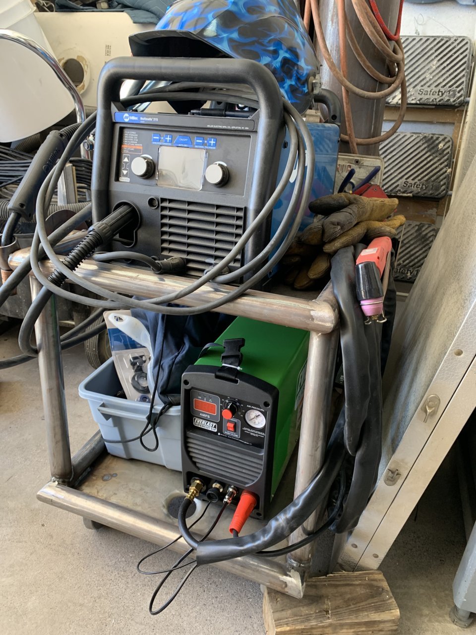

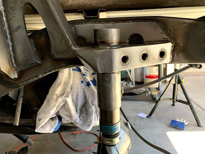

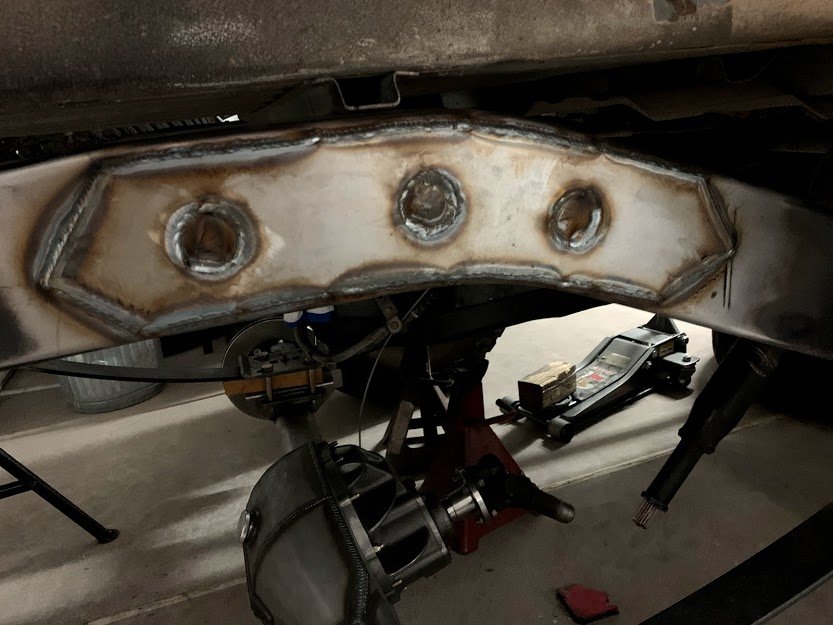

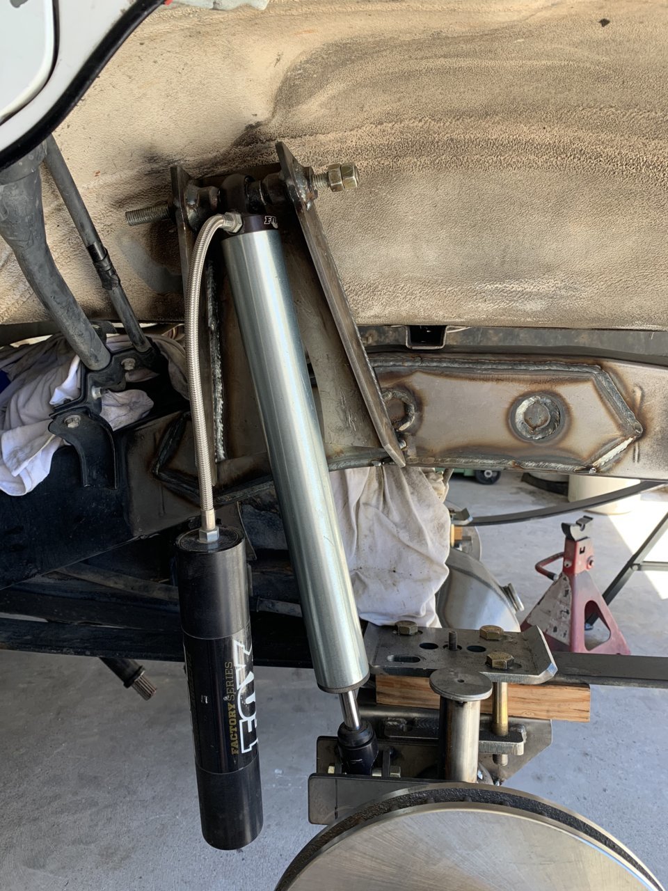

    Shock tower tacked in place and started making the bump stop mounts. Should work fine once it’s all boxed in together.
    B280C6F7-4600-4D1C-A08C-E0AC0E003D6C.jpg 18097BA3-69C9-4EF7-973F-CFBBA27A9E0D.jpg C9BACD42-460D-4E43-BC3B-813279FD9BEC.jpg

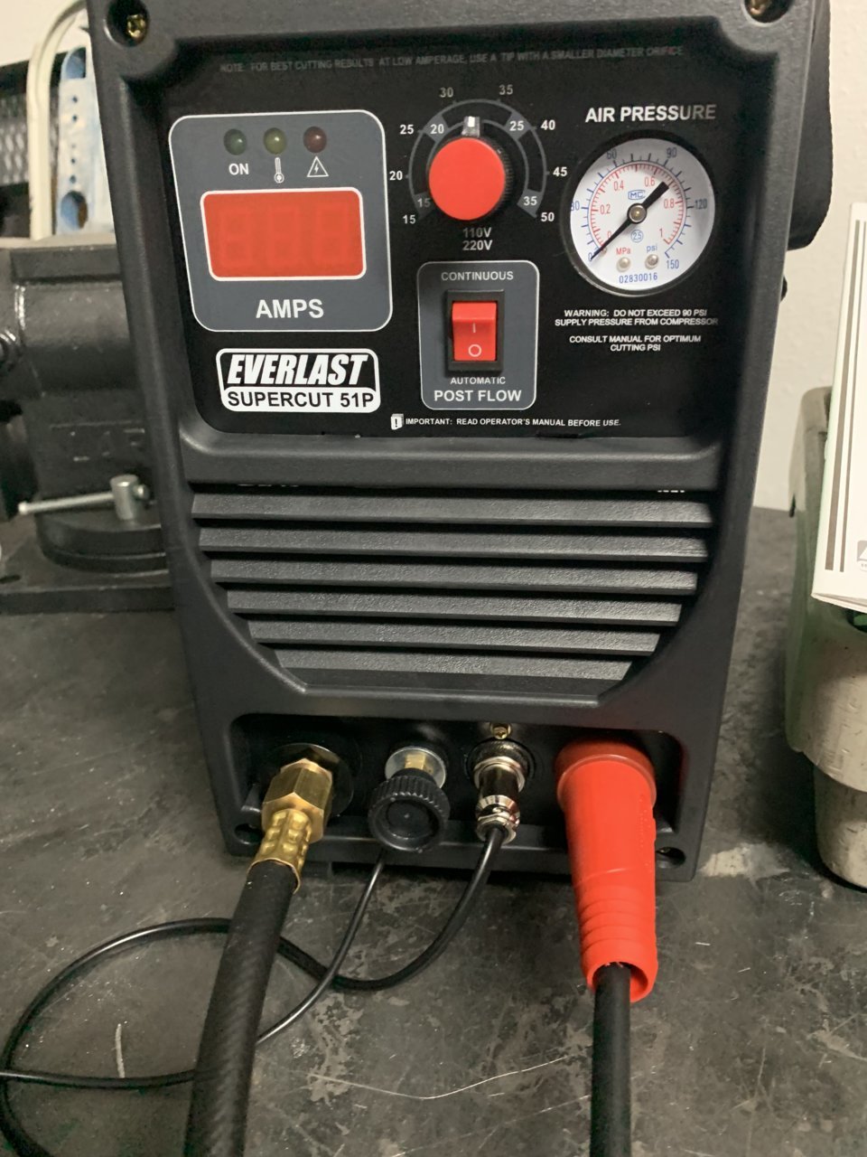

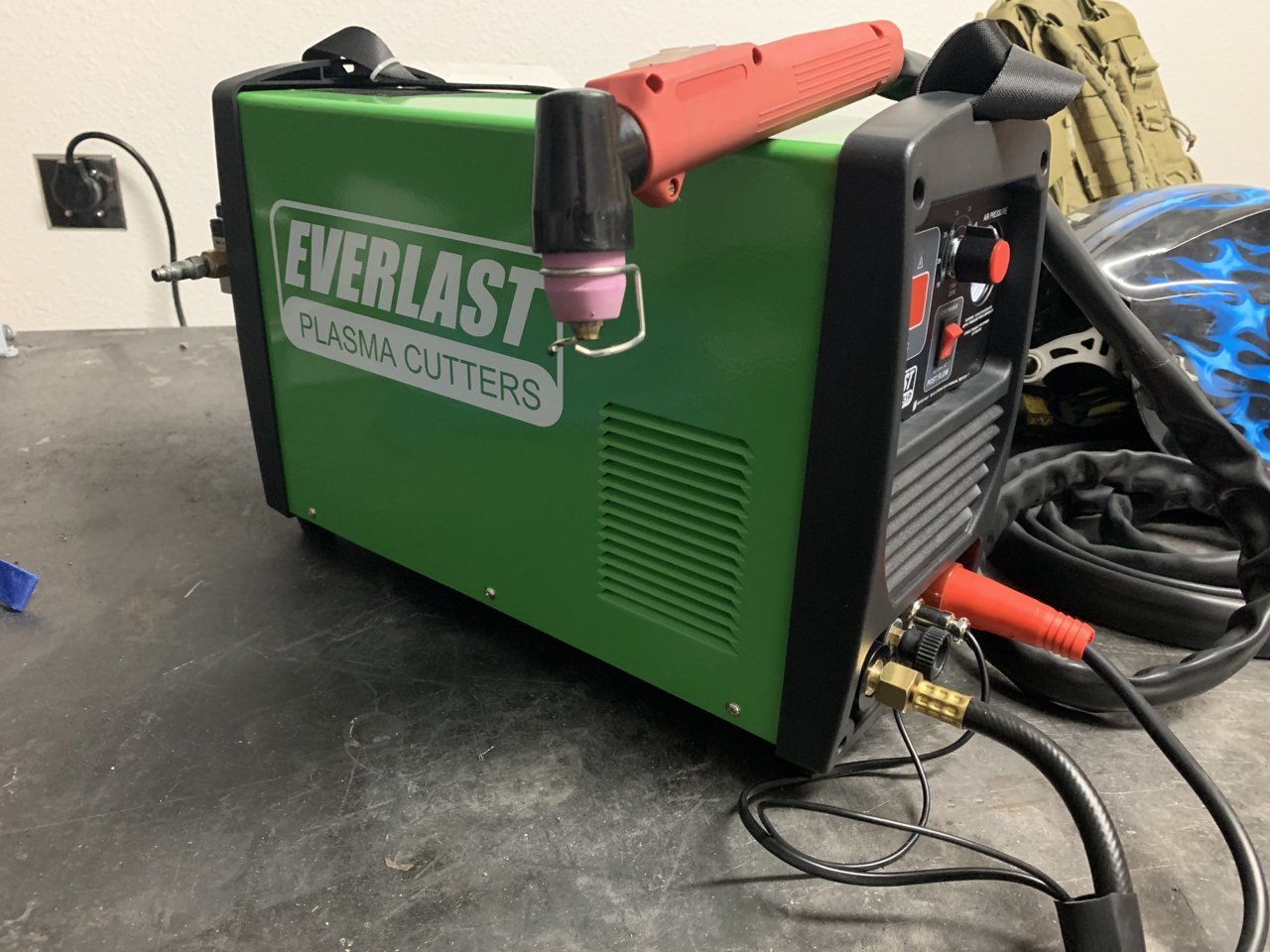

    And got the plasma to it’s final home. Used it most the day to cut the bump stop gussets and once I figured out the straight edge it was making super clean straight cuts. I added an inline filter to give it cleaner air and it works well.

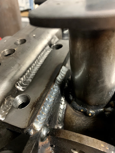

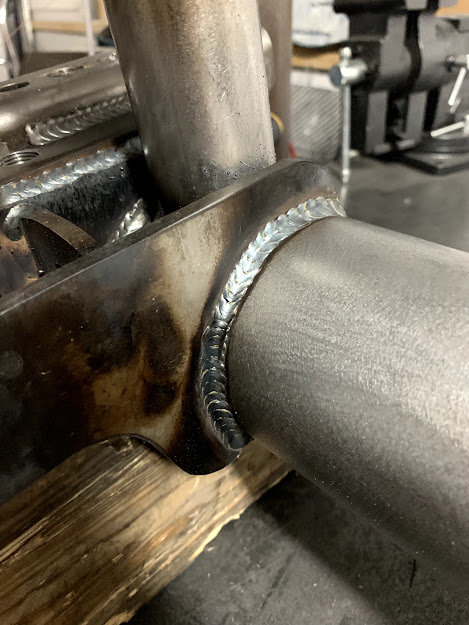

    And shock towers all welded together last night. One of my best welds next to some of my worst. Machine decided it didn’t want to weld after I finally got the setting right. Oh well

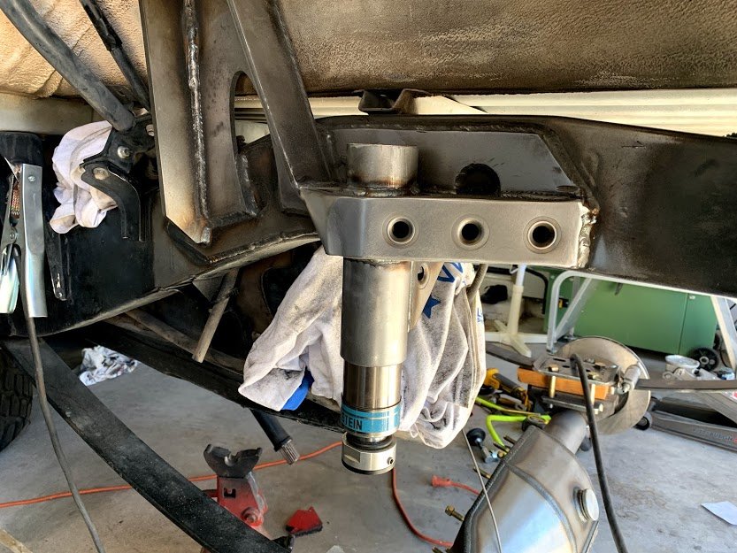

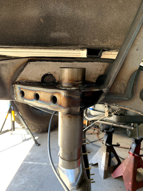

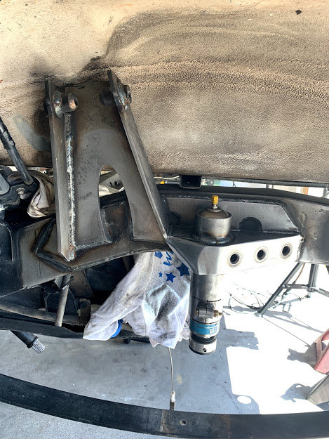

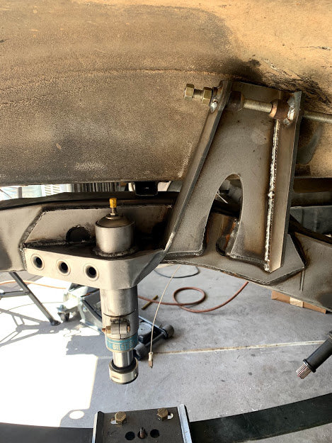

    Moving right along. Been nice having the plasma. Got all the frame brackets cut after finalizing how i wanted to do everything and zipped them out with the plasma. Got the driver side welded besides the can and the last filler plate and back gusset. Passenger frame plate welded on. Hope to get the passenger side done this week and move onto finishing the axle side bump stop and then burn everything in.

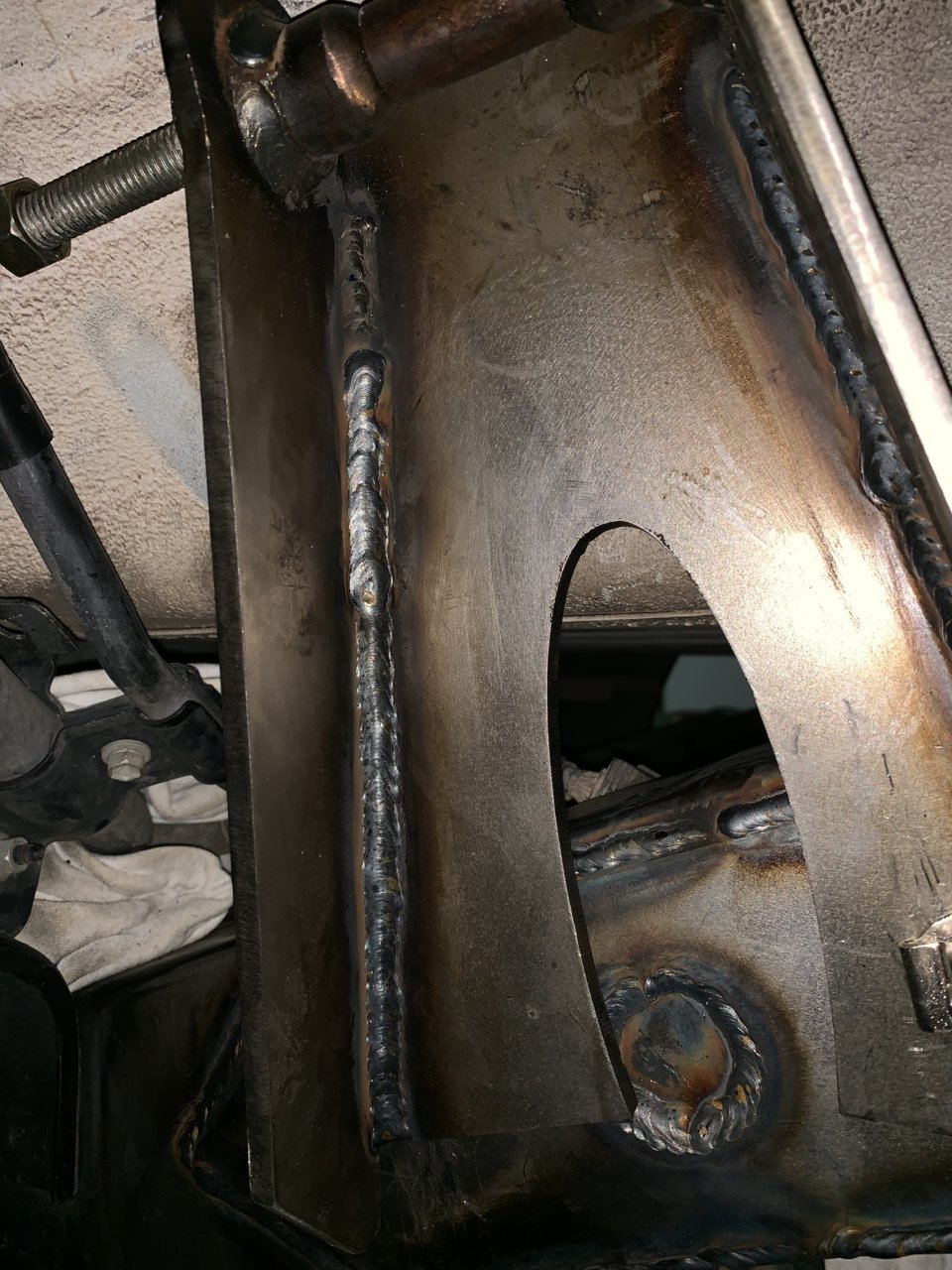

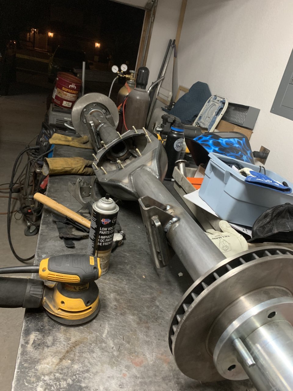

    Driver side done. Passenger side about 90%. Hoping to get most the axle welded as well tomorrow.

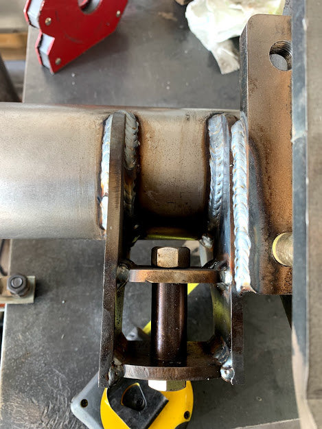

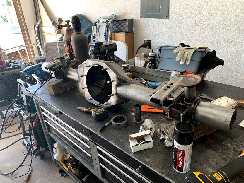

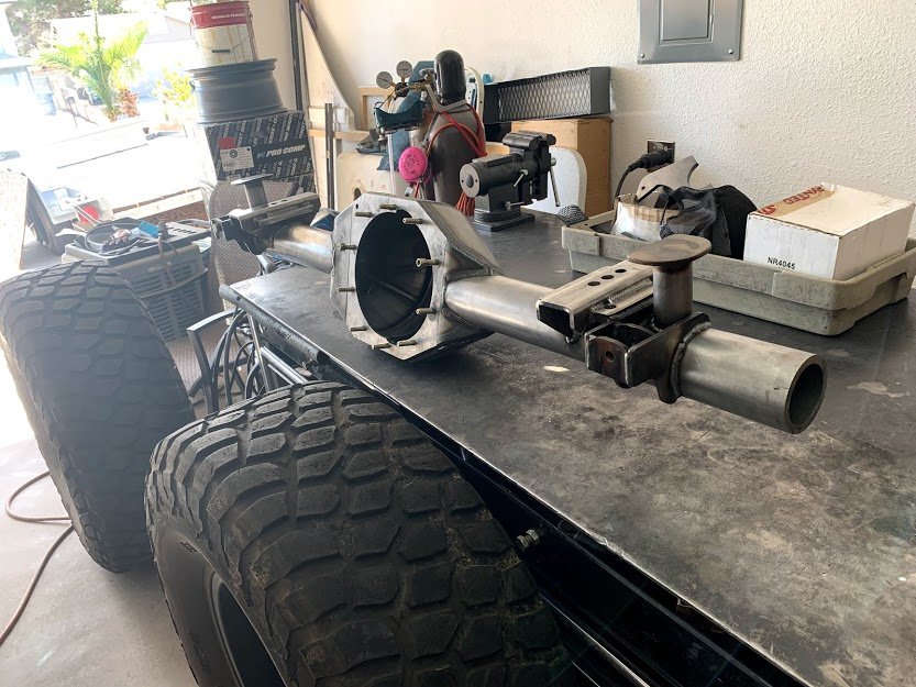

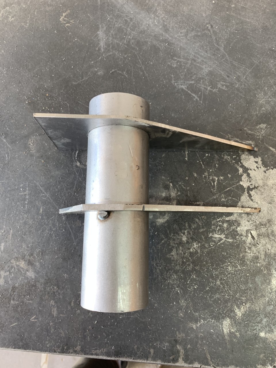

    Slowly but surely. A few hours every night after work or in the morning on my days off is starting to pay off. All the frame side brackets are done besides the set bolt for the bump cans. And started welding on the axle in hopes of dropping it off to have the spindles welded this week.

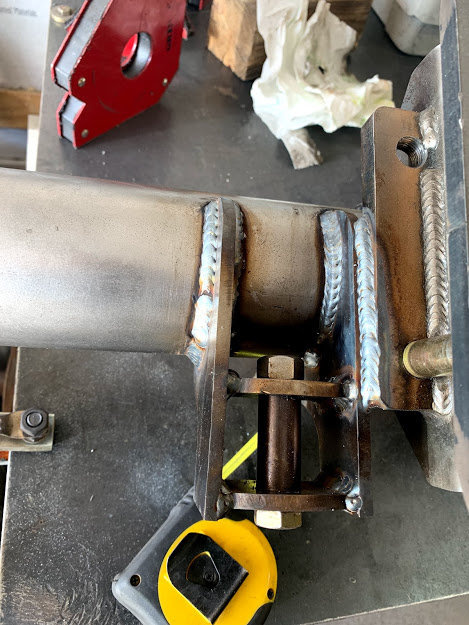

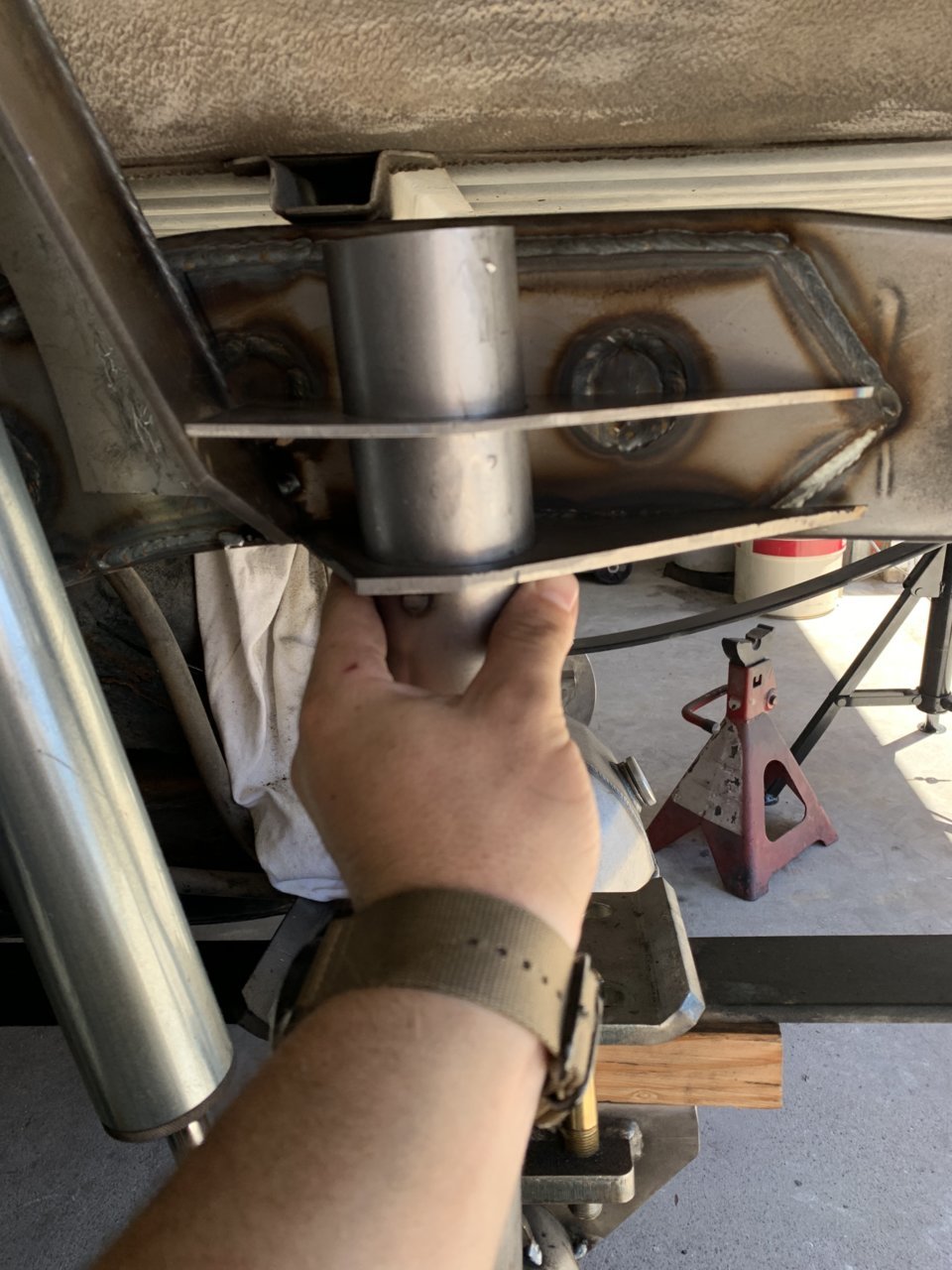

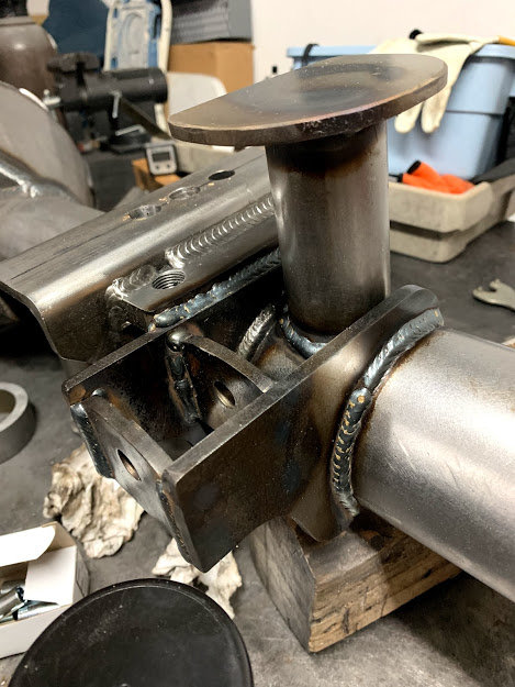

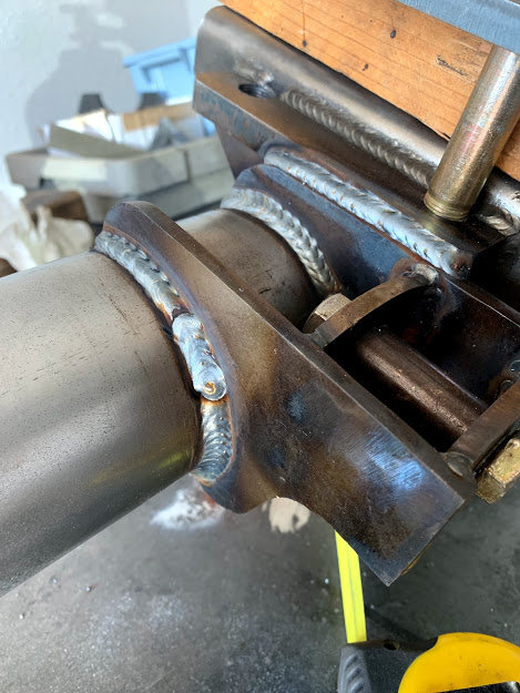

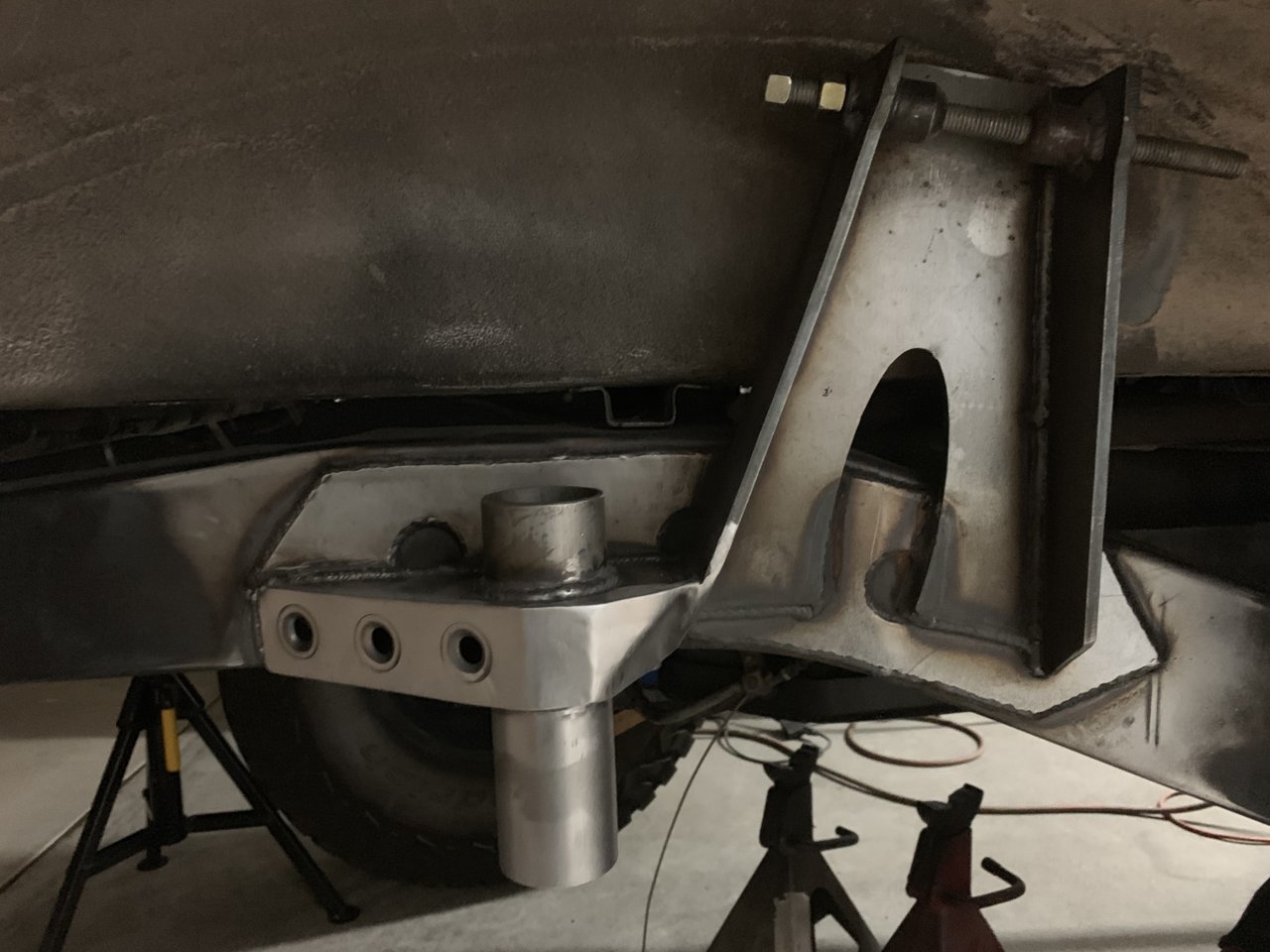

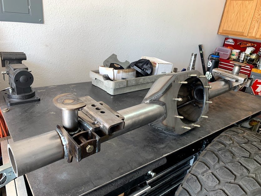

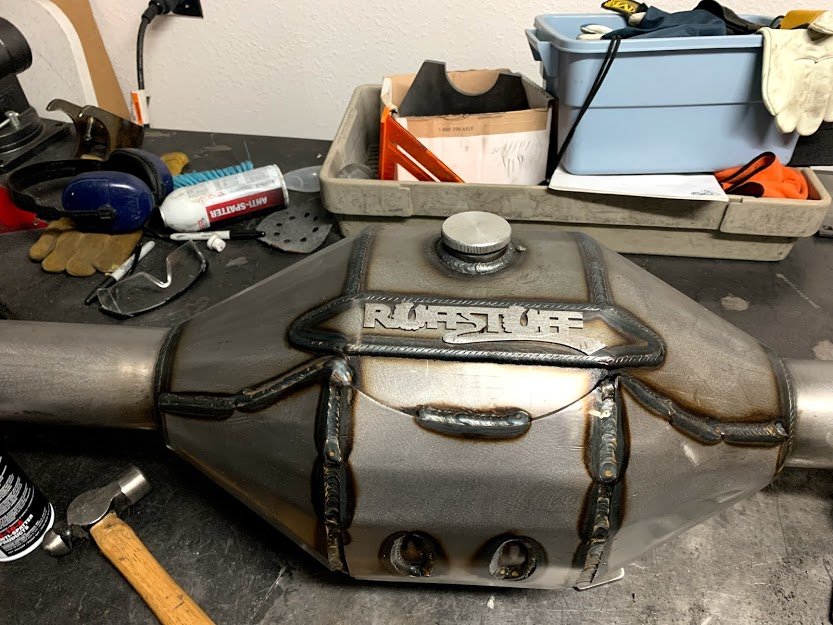

    Got a lot done since the last update. Frame brackets and pinch bolts done just needs paint. Got the axle cleaned and fixed after welding the shock mount for the passenger side on the wrong side of the spring perch. Had to remake the shock mounts and bump pads. But none the less got it all welded back up and dropped it off at Dans driveline in vegas to have the ends and brakes welded on. Hopefully get some metal tomorrow and start on the center console.
    Diff armor i had my dad cut and bent and welded on
    Pictures of the screw up...
    But at least my welds are getting better... the best welds were on the side i had to cut off lol.
    and pictures after fixing everything
    and pictures of the finished frame

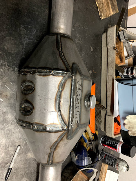

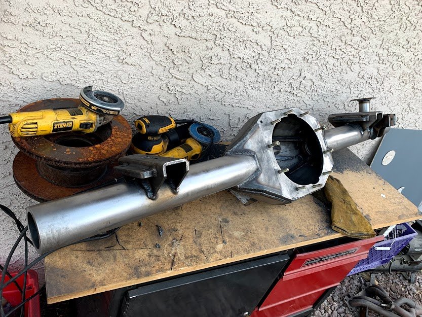

    Picture of the finished diff armor
    and you can see the grinding dust in the background from cutting all the 1/4 in brackets off from my screw up.. was nice having the plasma to blast most of it off but still sucked

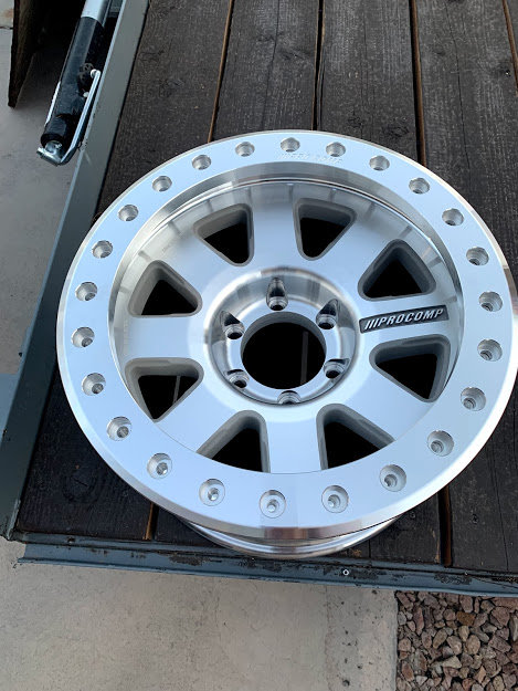

    And the new wheels. Found them for 190 a piece on eBay so couldn't pass it up. Even got a matching spare. Just need to find a 5th tire now.
    Old wheels are for sale. 500 for the 5. Their 200 a piece new and 1 is brand new only had a tire mounted. the rest have rock rash. ill post a link to a forsale thread.
