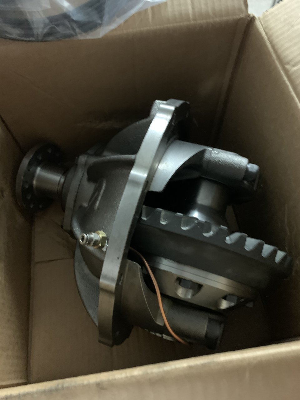

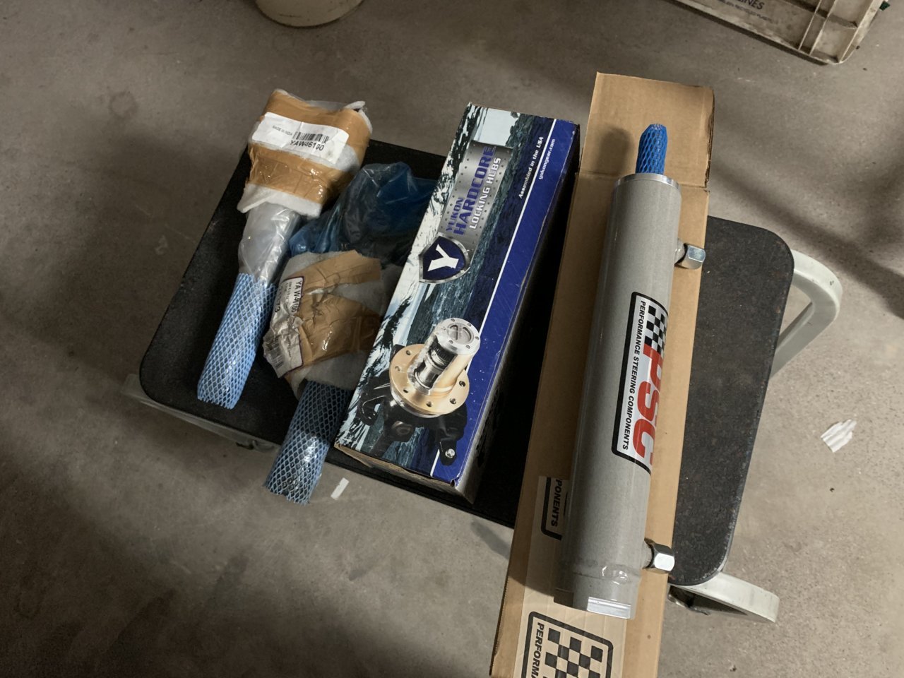

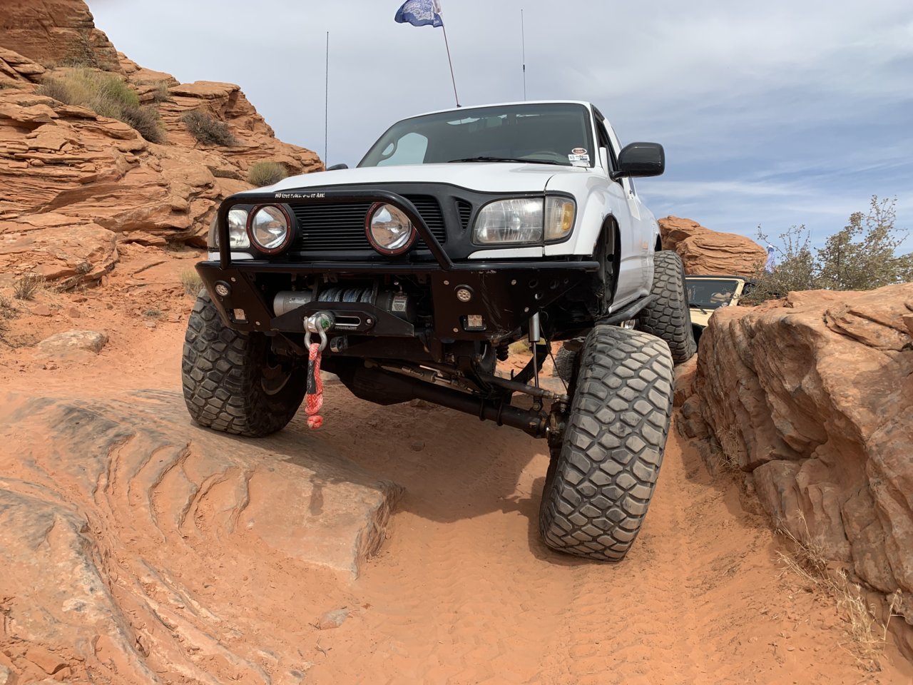

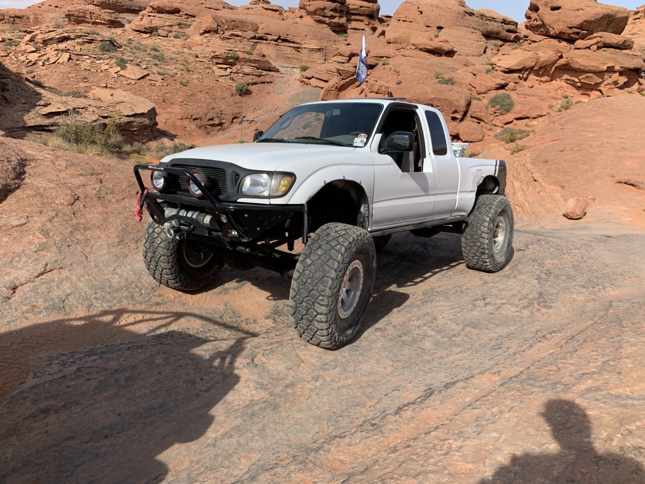

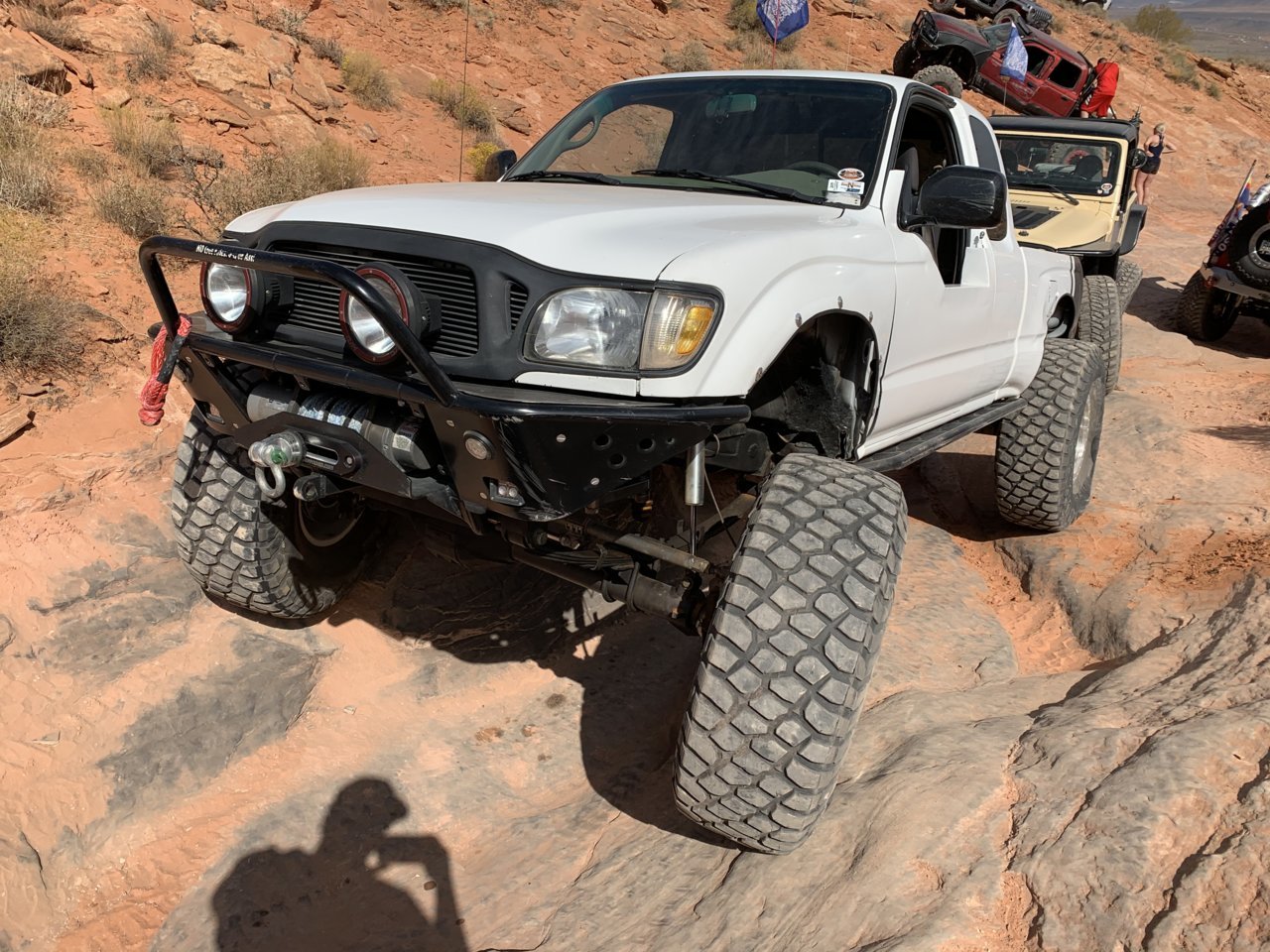

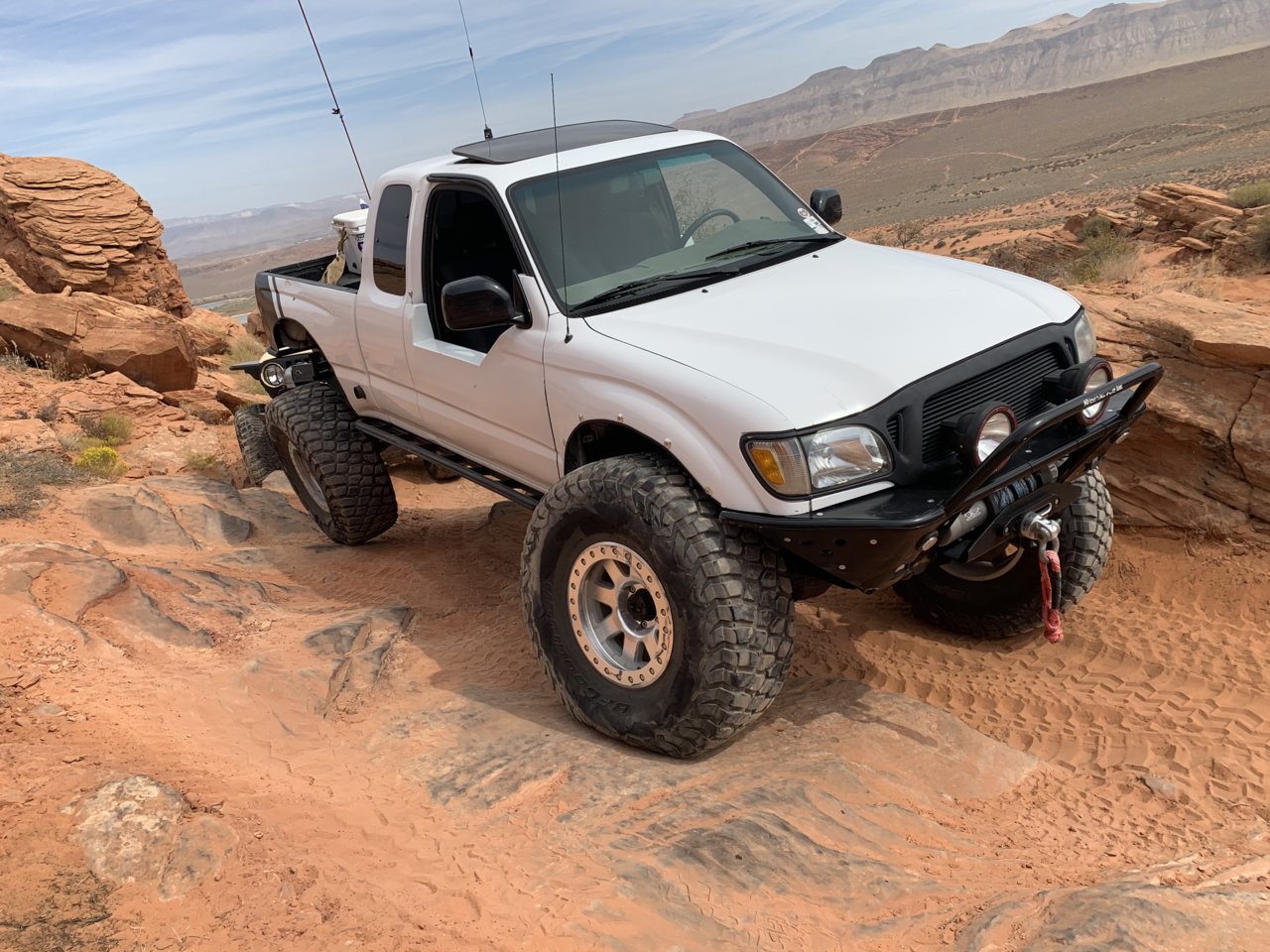

    One more day left here at trail hero. Ran a bunch of trails so far and just having fun with my dad. Trucks doing well. Working it hard and it’s not disappointing. Ran johns trail with a few other Tacoma’s today which was cool
    also picked up some more parts for the front end I ordered and bought some more but that’s still to come

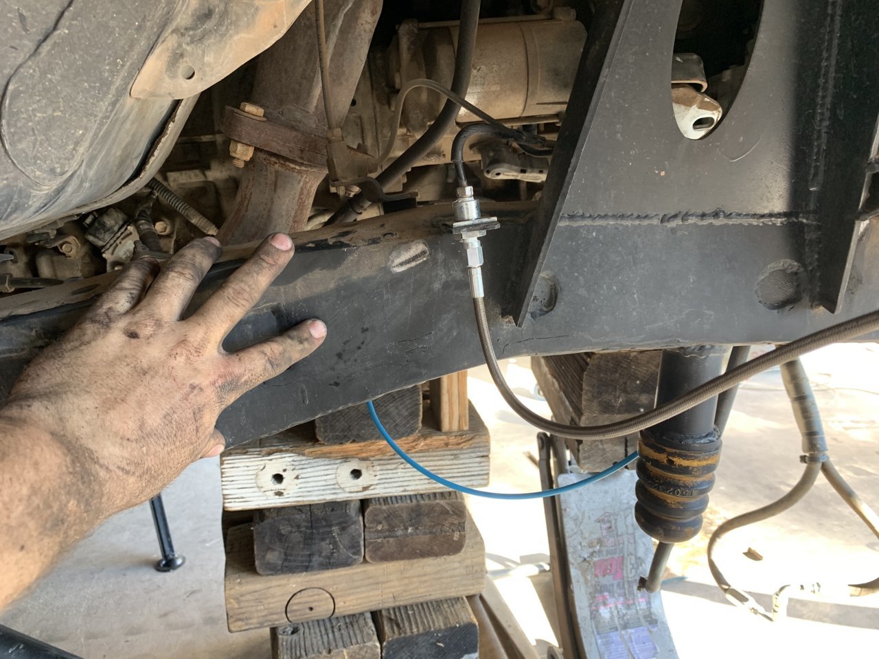

    Some parts I picked up at trail hero and more being drop shipped this week. No real issues. Hose clamp on exhaust came lose. Rear axle drive flange is leaking. Overall good trip. Watched one rollover were dude is lucky to be alive since he wasn’t wearing his seatbelt and a buddy rolled his yj but we got it upright and pulled the plugs and started right up.

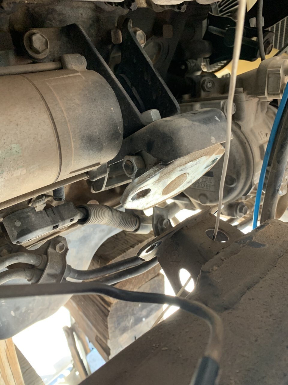

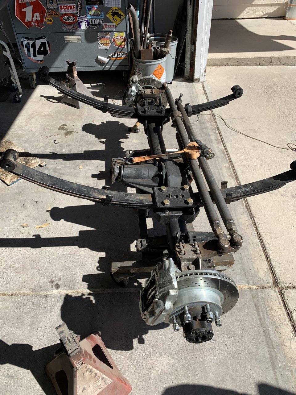

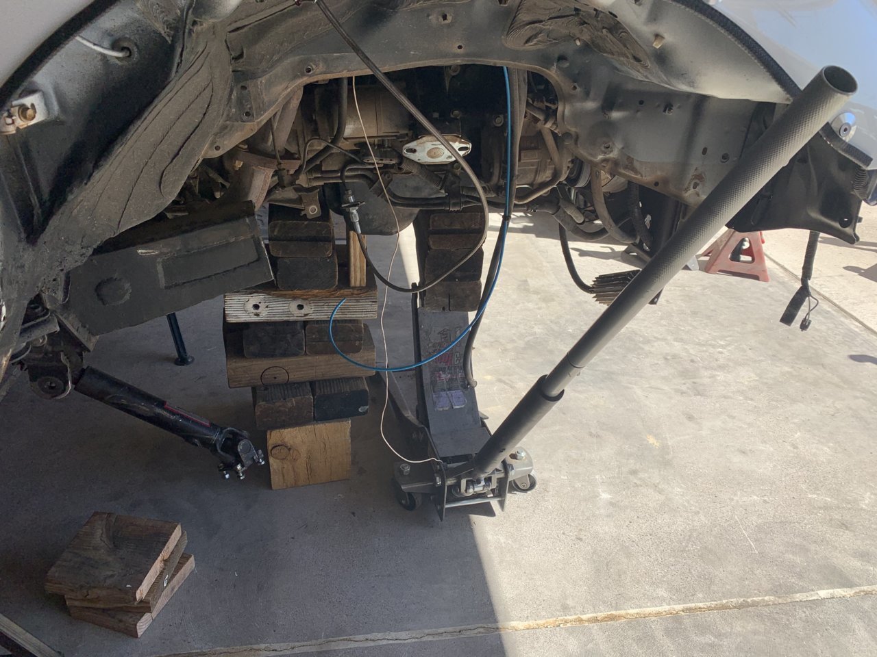

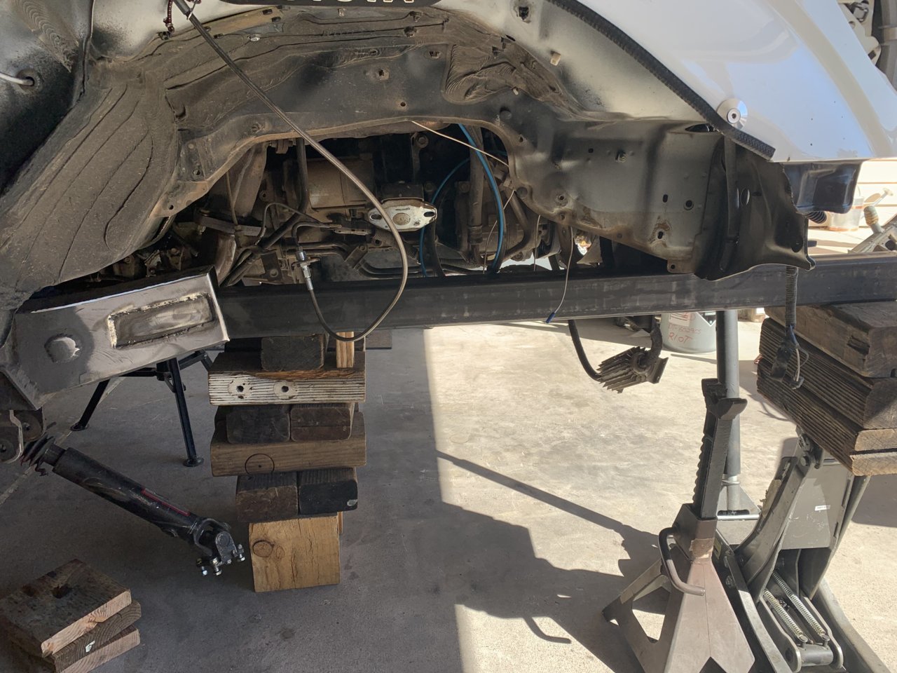

    Old stuff is out. Going down to the steel yard tomorrow to get metal for the frame and cut the old stuff off tomorrow. Raised the motor 2.75 in. Just from holding stuff up and matching the rear/existing ride height, should end up around 24-25 inches to the bottom of the frame and lower links will be somewhere around 40-44 inches. Probably closer to 42-44. Shooting for 7-8 inches of up travel and new wheelbase will be around 128 (from 125-126 ish) so the steering clears the oil pan
    Finger will be roughly were I cut the frame as that’s where it flattens our

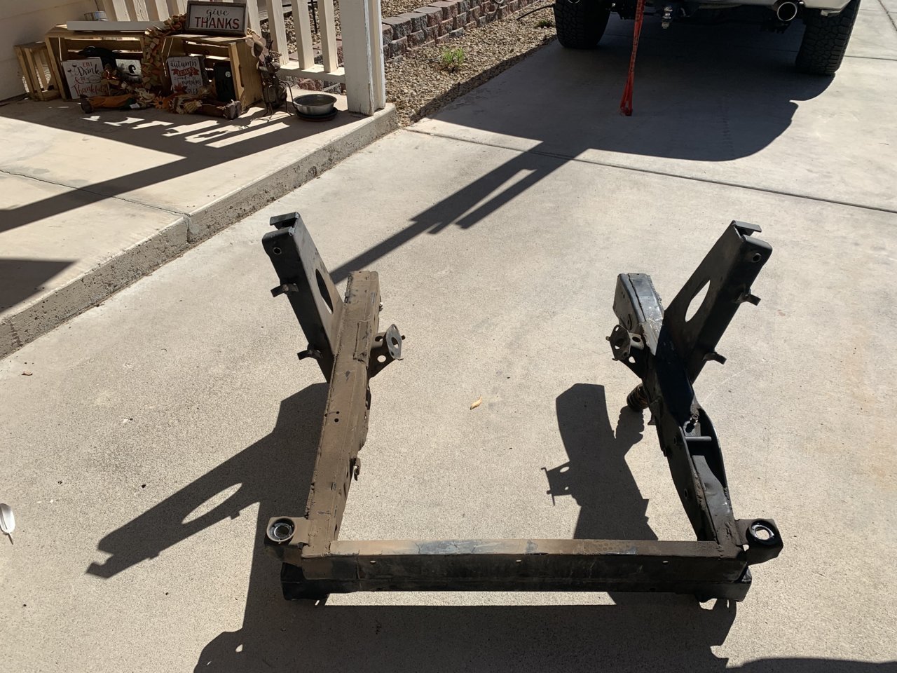

    Front frame rails are off. Now to decide do I notch the core support or just cut it out.
