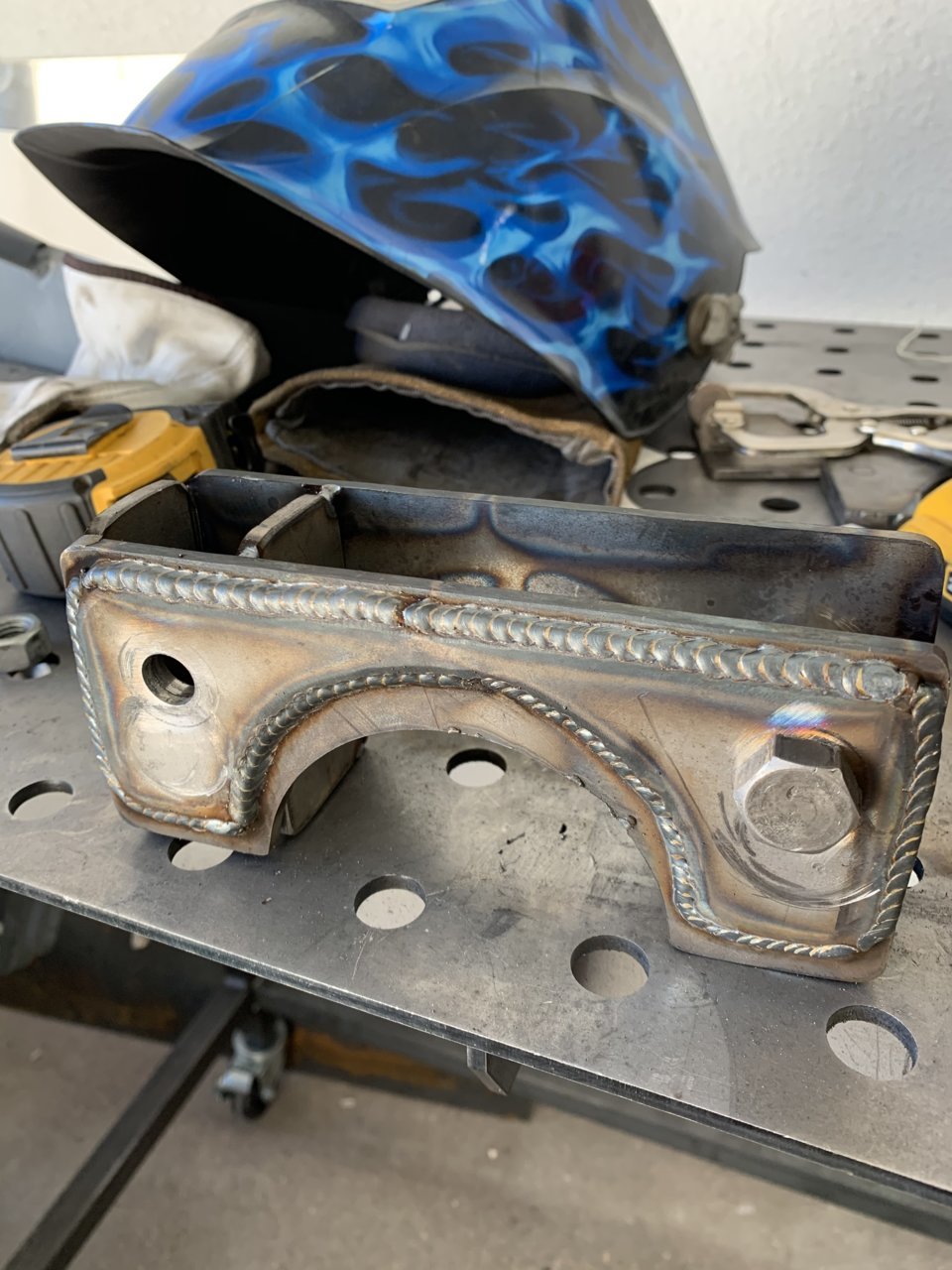

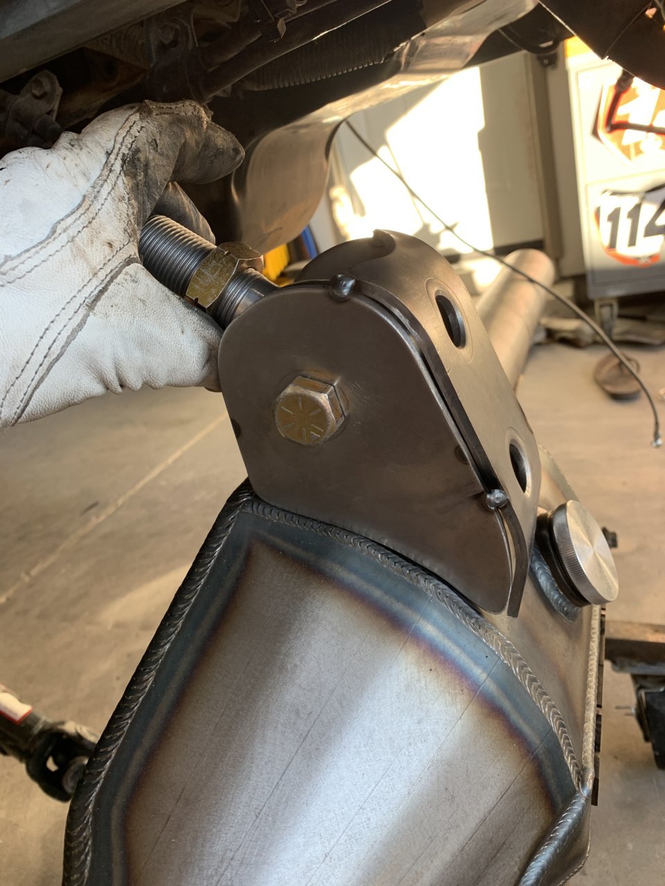

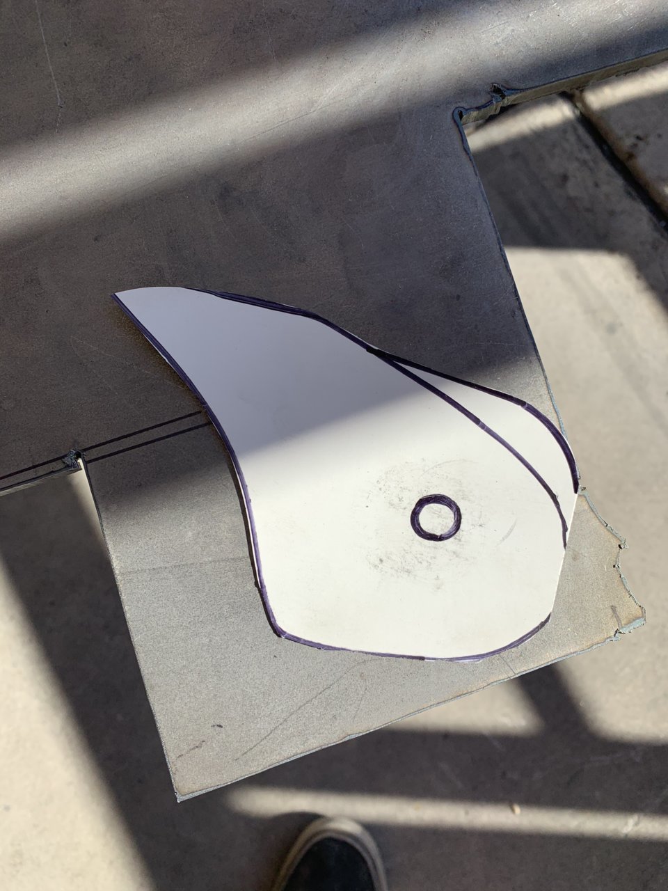

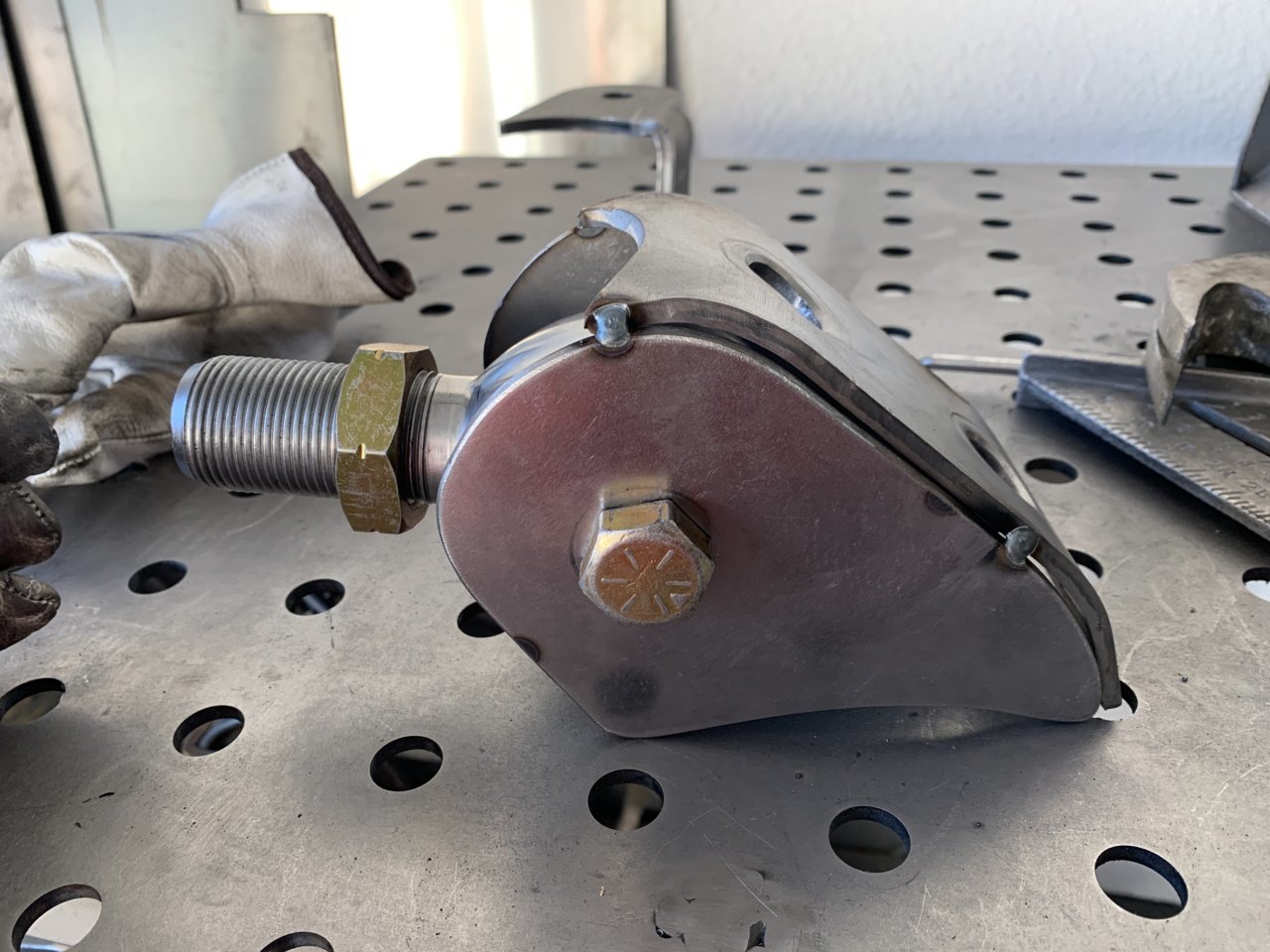

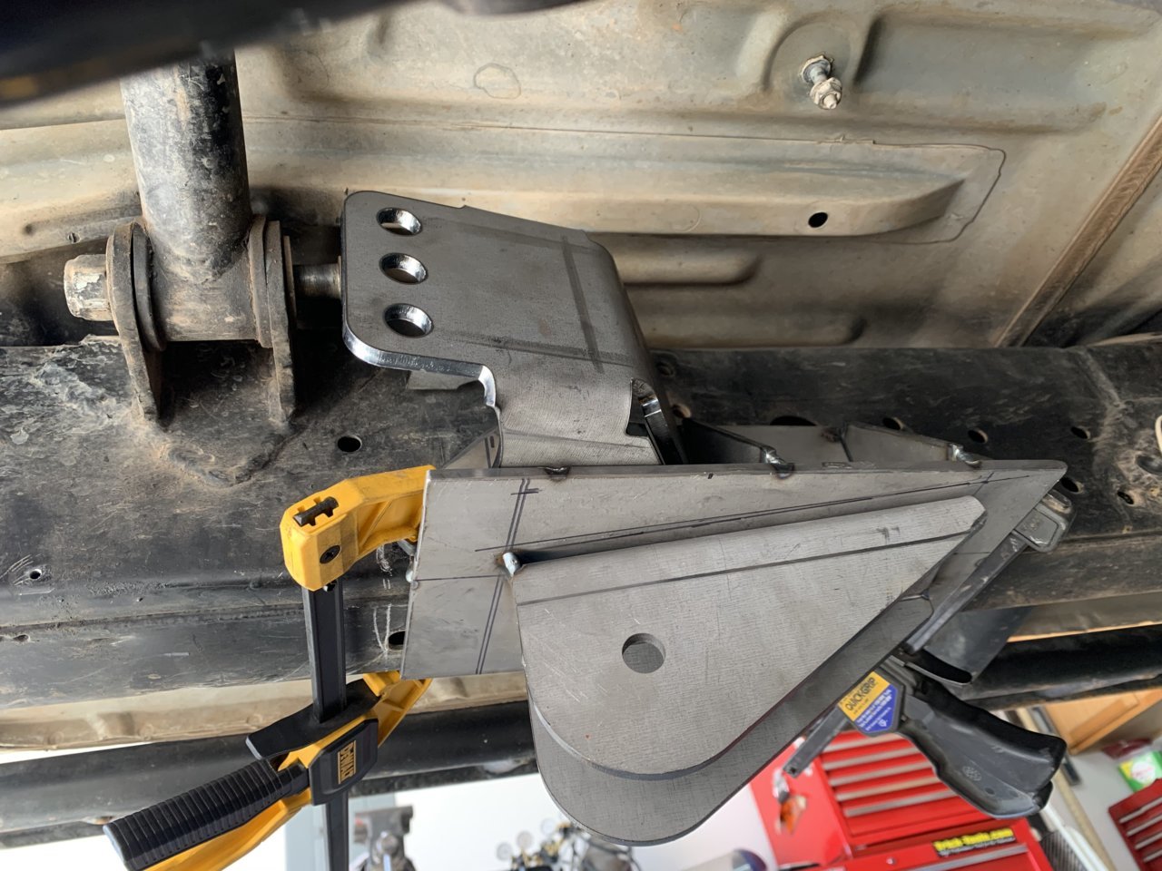

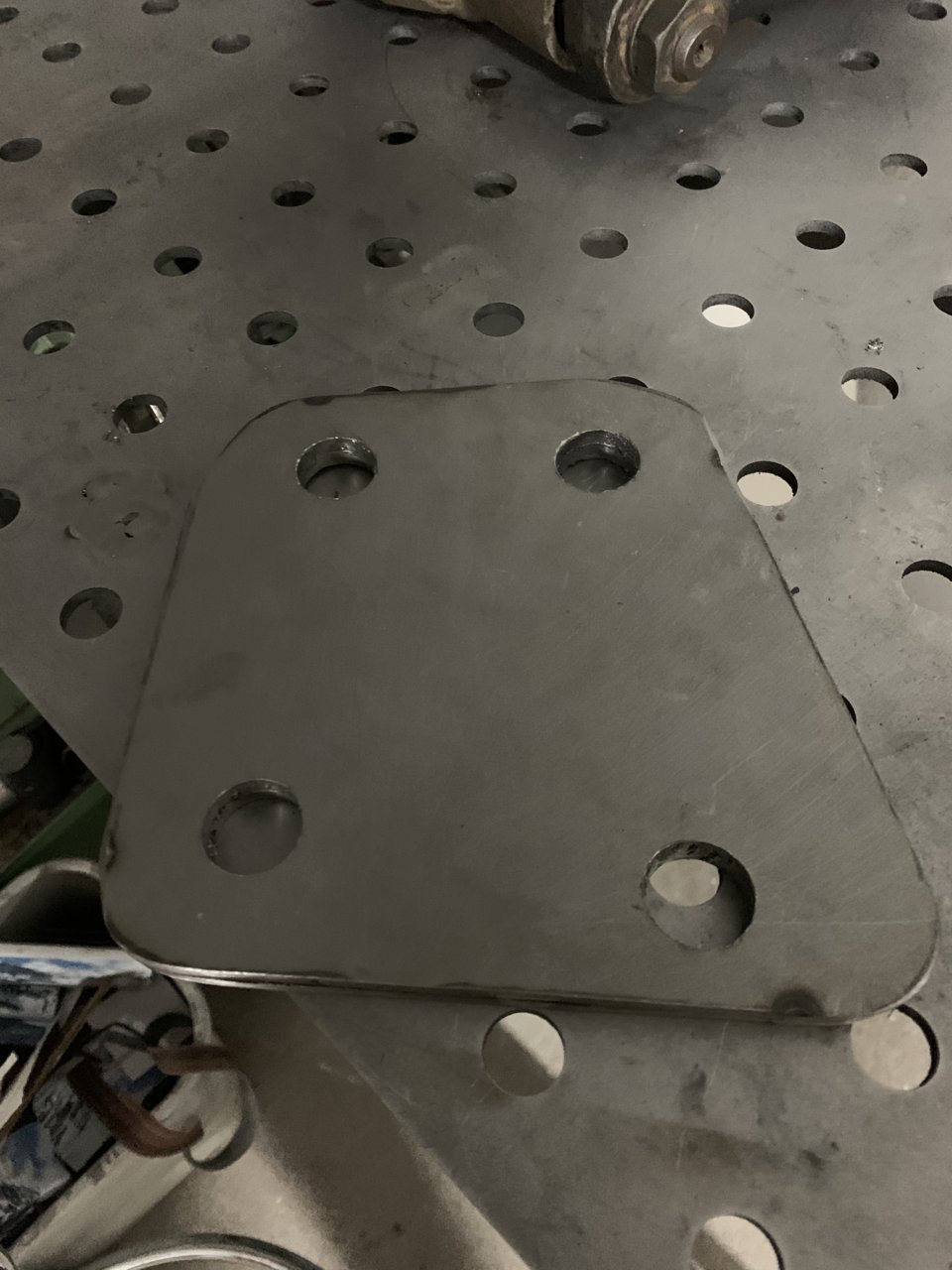

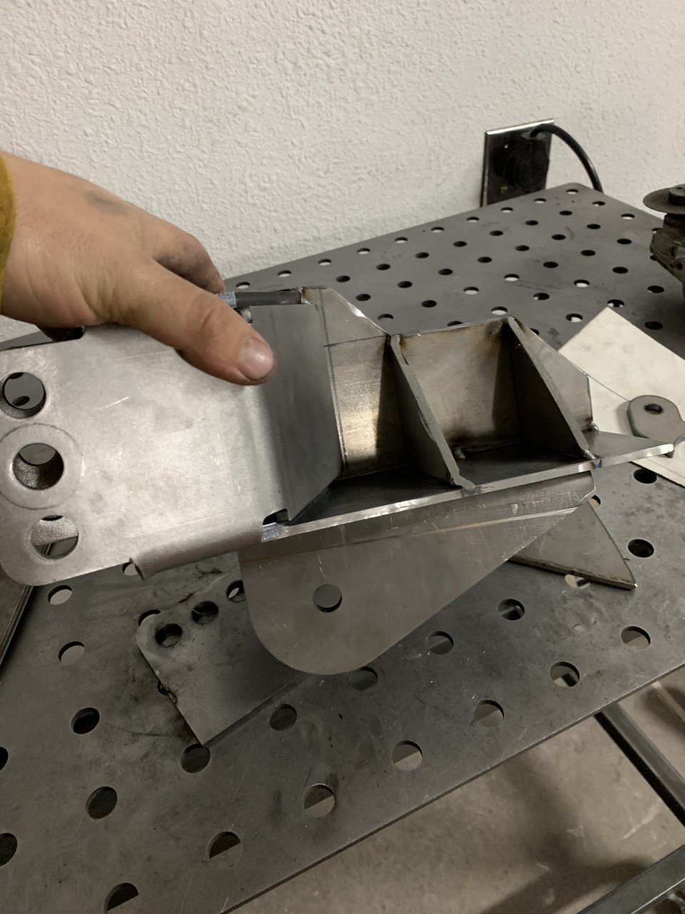

    Redid the driver side a little to incooperate the upper link mount. Had to take one of my transfer case tabs off to redo it. Working on the upper mount for the axle now. Still waiting for my high steer arms and lower kingpin caps to reassemble everything. Maybe I’ll drop the cs off to be machined tomorrow
    Original mock up. Had to knock that right tab off the transfer case mount. I’ll weld a new tab on top of the upper link mount to bolt it back together

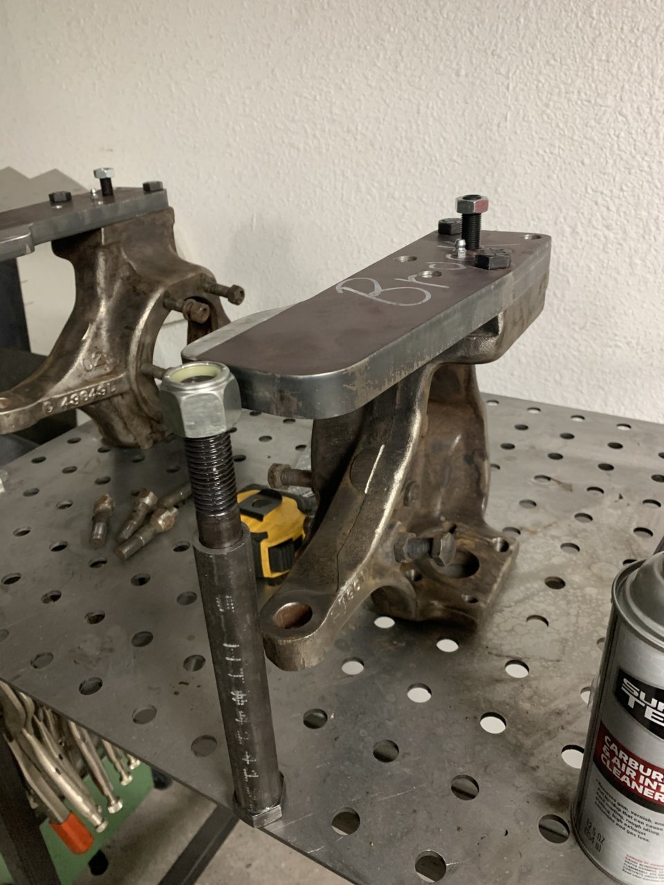

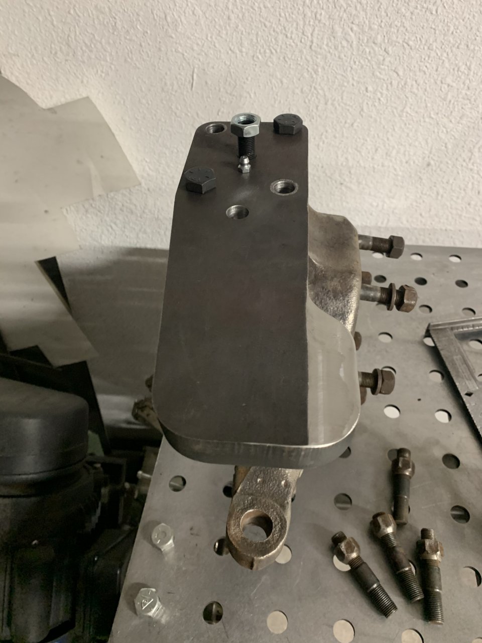

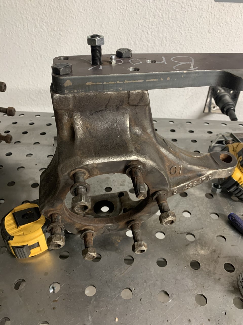

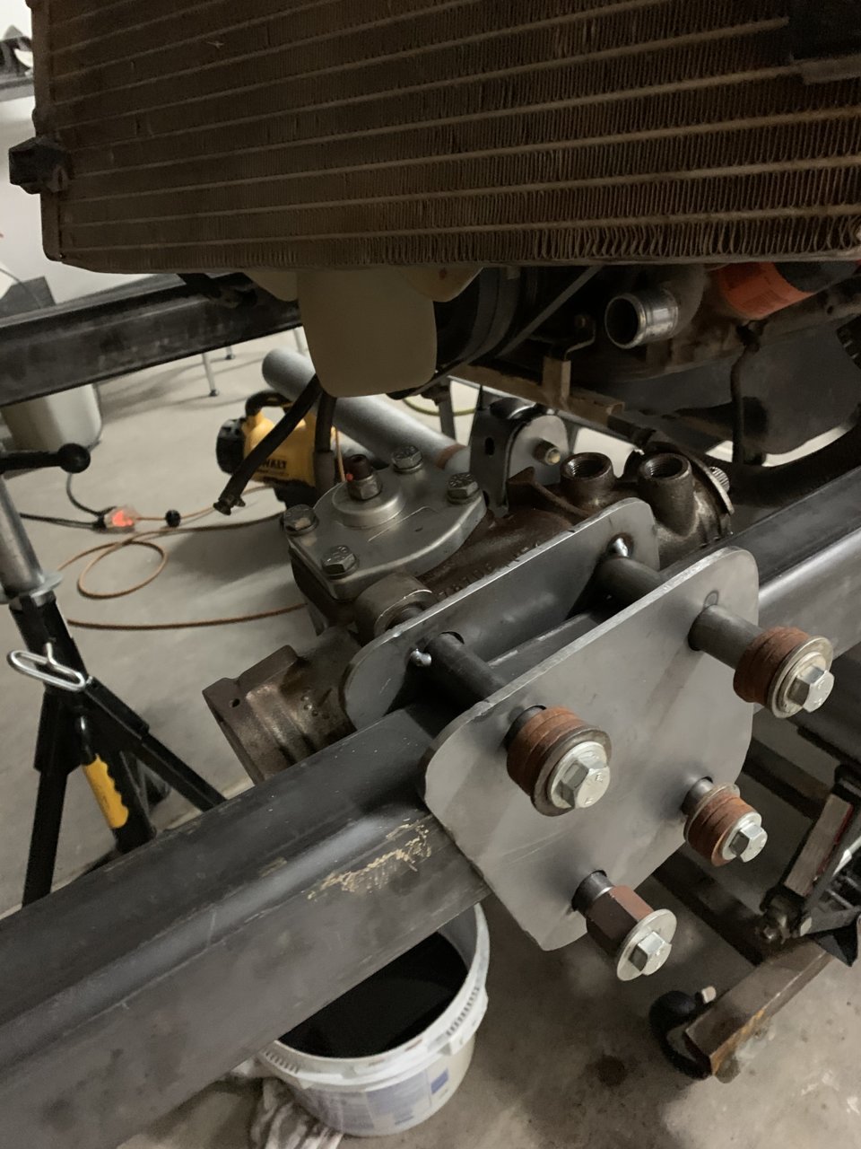

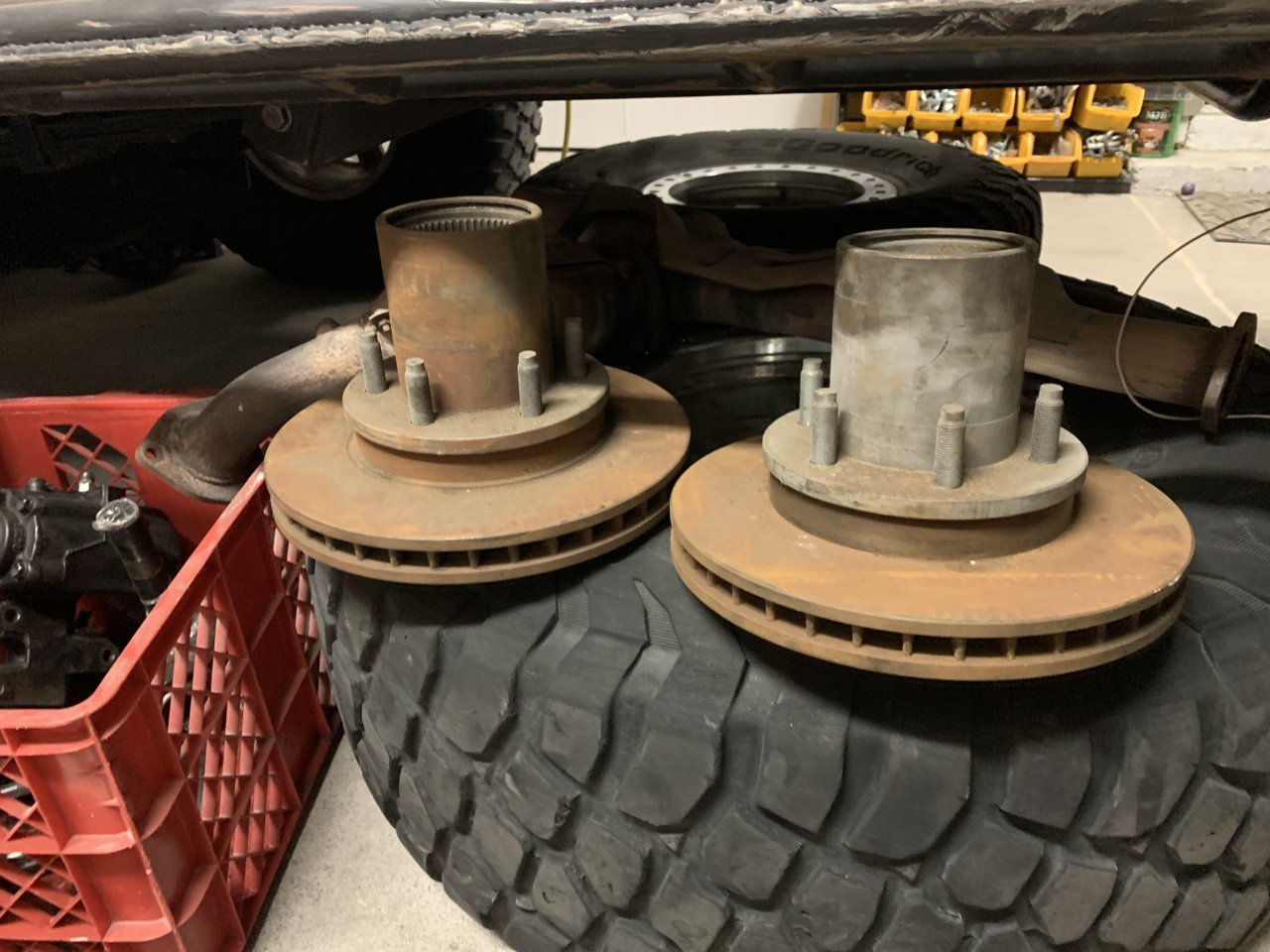

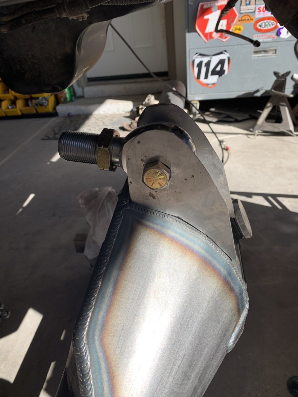

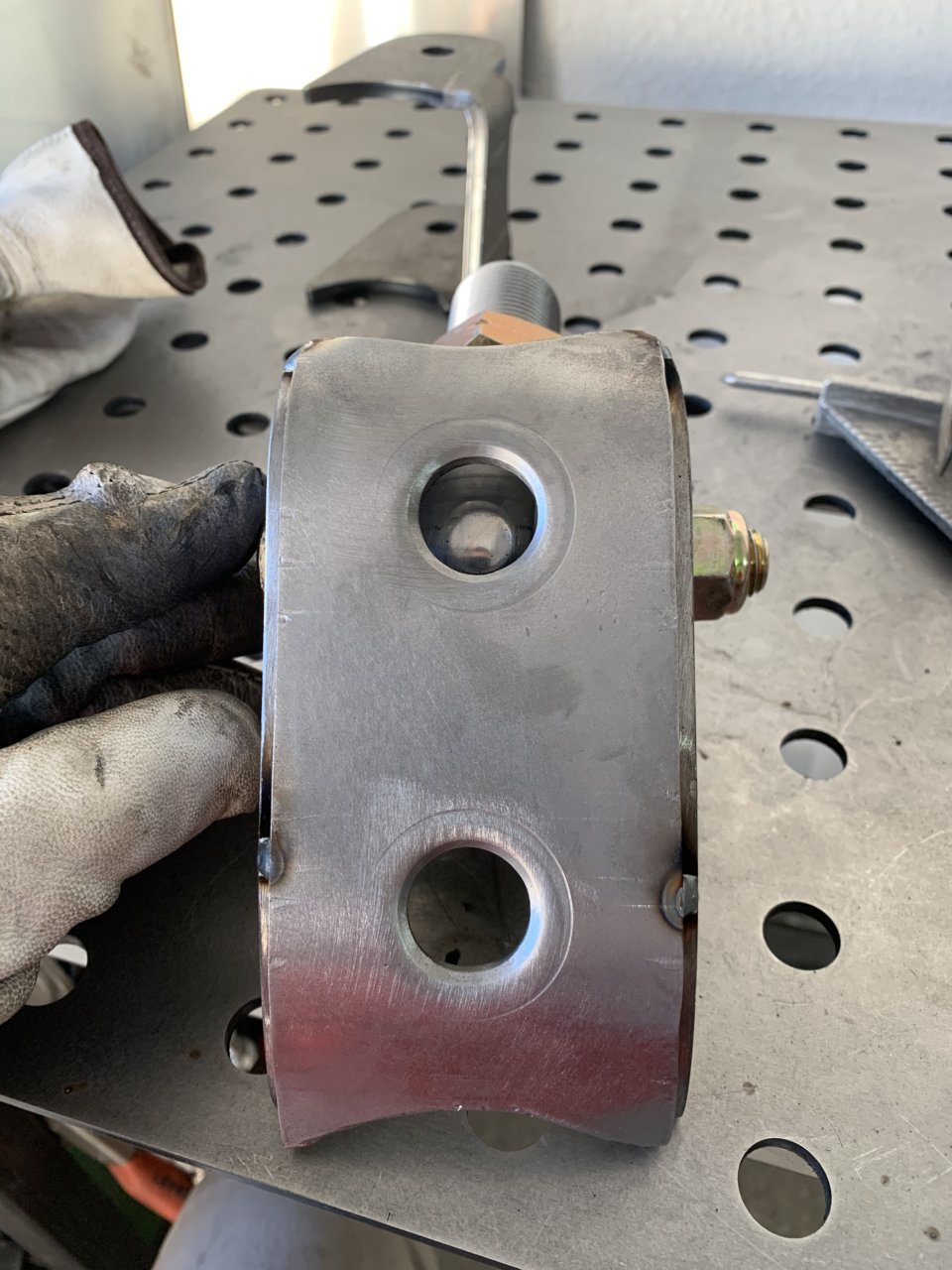

    Got the axle end upper mount done. Redid the steering box mount to give it more material around the bolt holes. Dropped the cs off to have the id opened up. Hubs showed up as well.

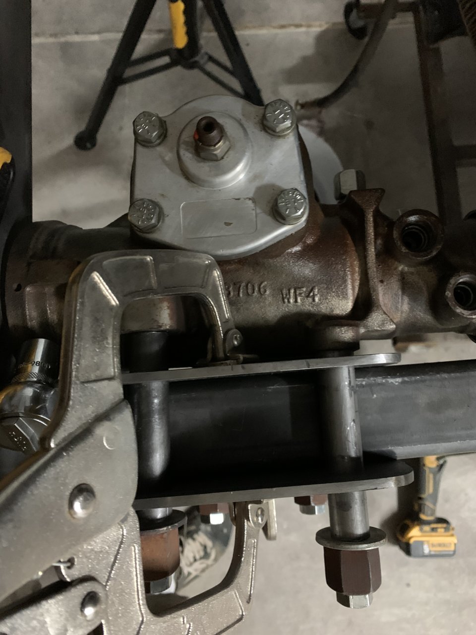

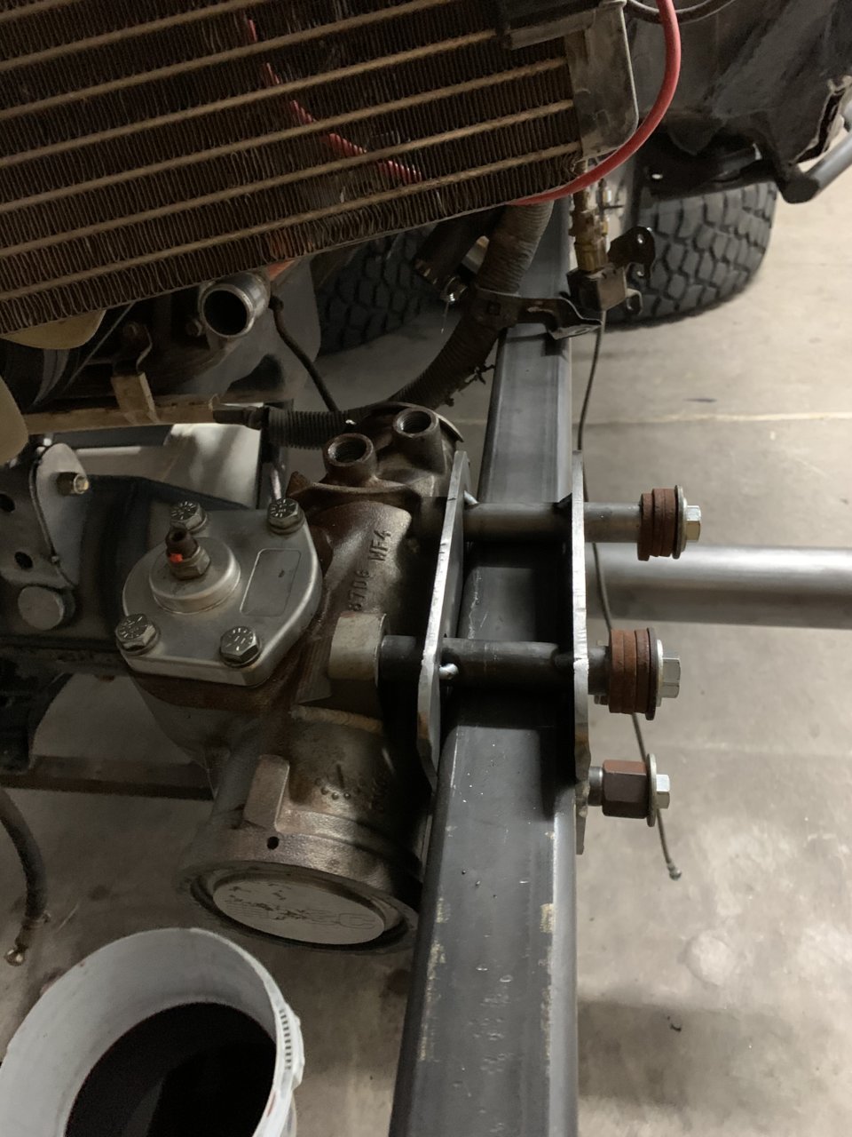

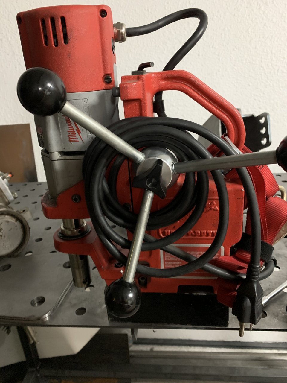

    Only went in the garage for a few hours. Got the steering box sleeves tacked in place and mount in it’s rough mounting location. Radiator pulled. Traded some old parts for a mag drill I don’t really need but oh well.

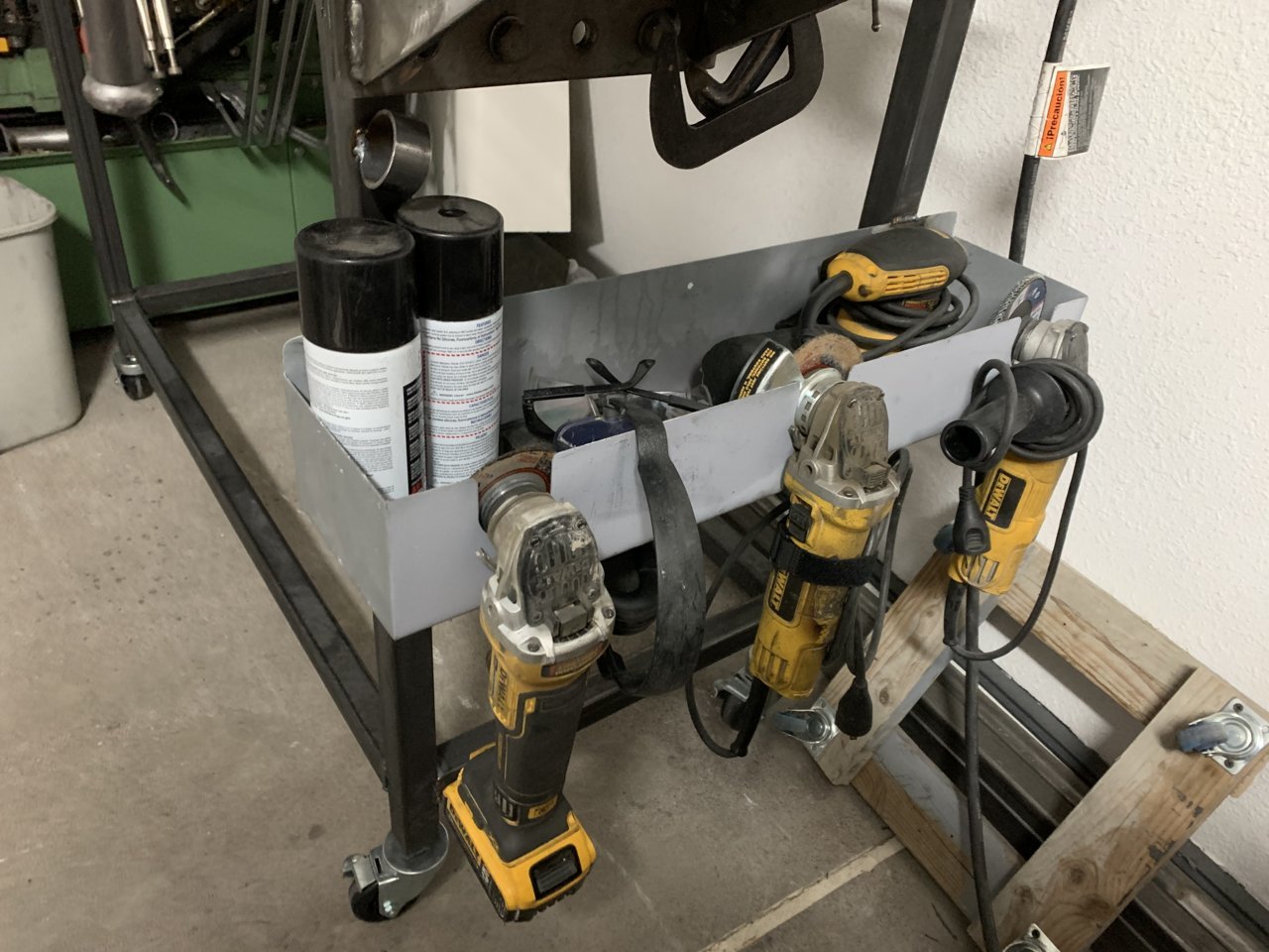

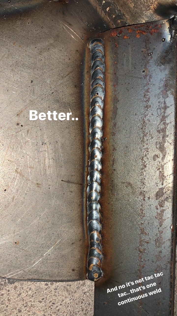

    finally mounted this grinder holder my dad made for me last Christmas or so. Welds came out decent on that.
    079B15AE-E12B-4682-AF36-DFB219FF19C1.jpg 79327D4A-9F9F-4487-A454-36DE2734CE58.jpg

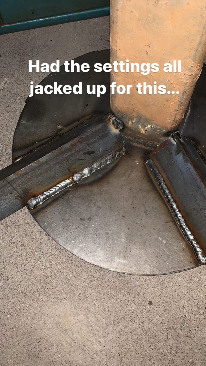

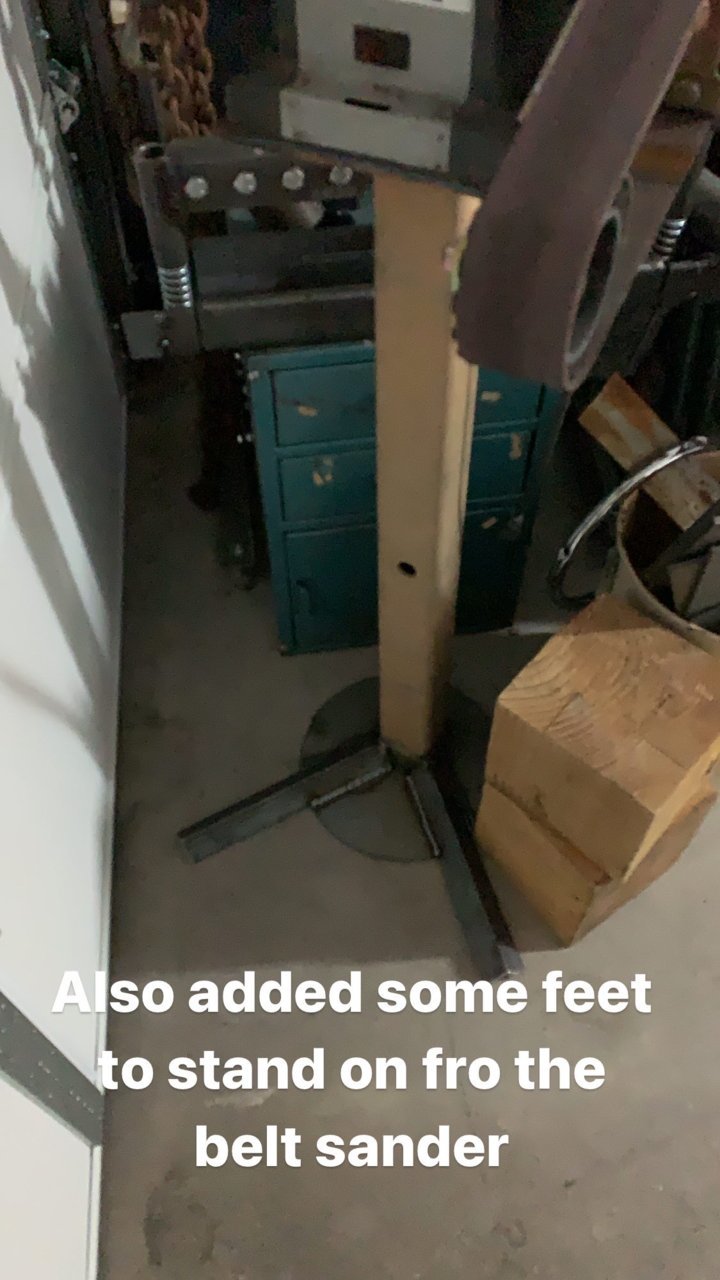

    Also added some extended feet to my bench grinder/belt sander to help stabilize it. I jacked up the setting so welds aren’t great but some were and it’s good practice on the longer runs.

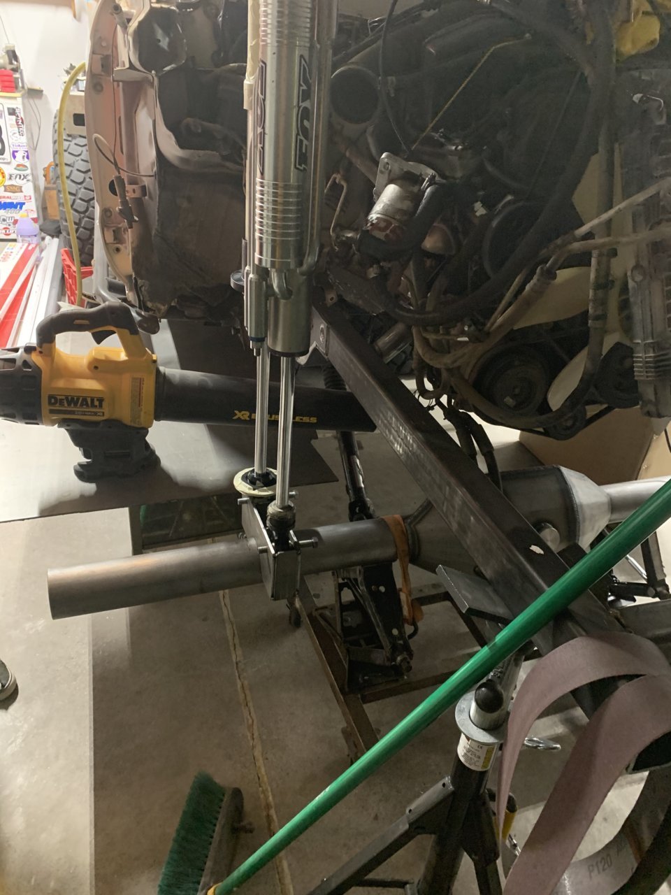

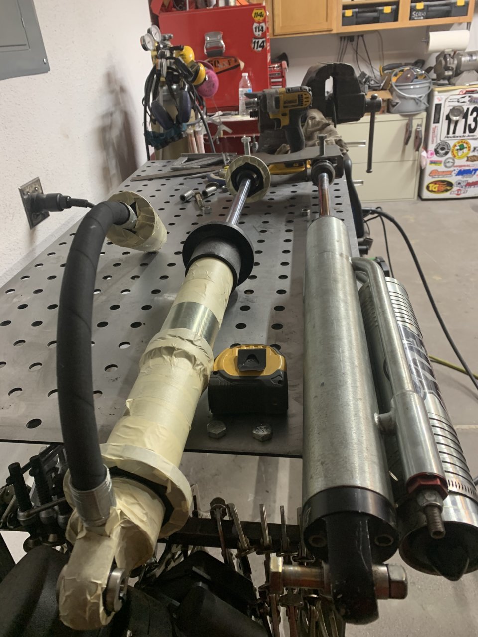

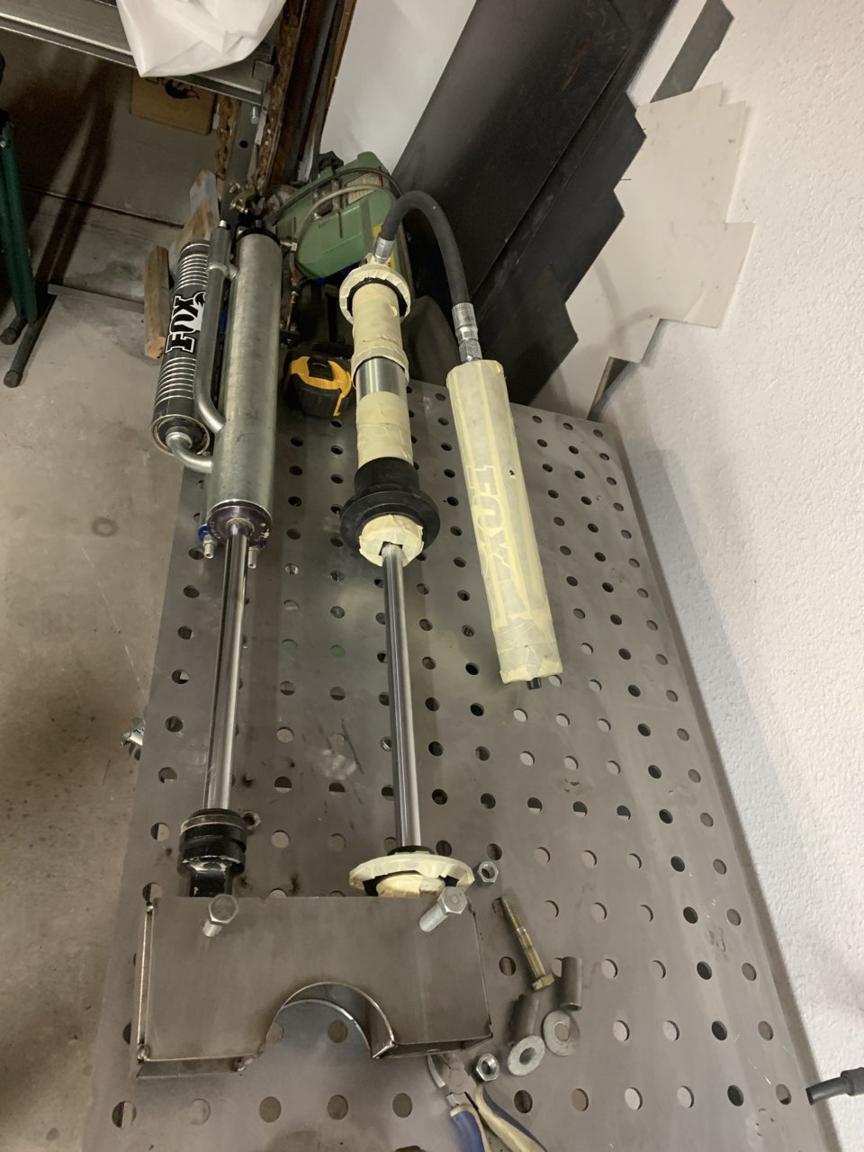

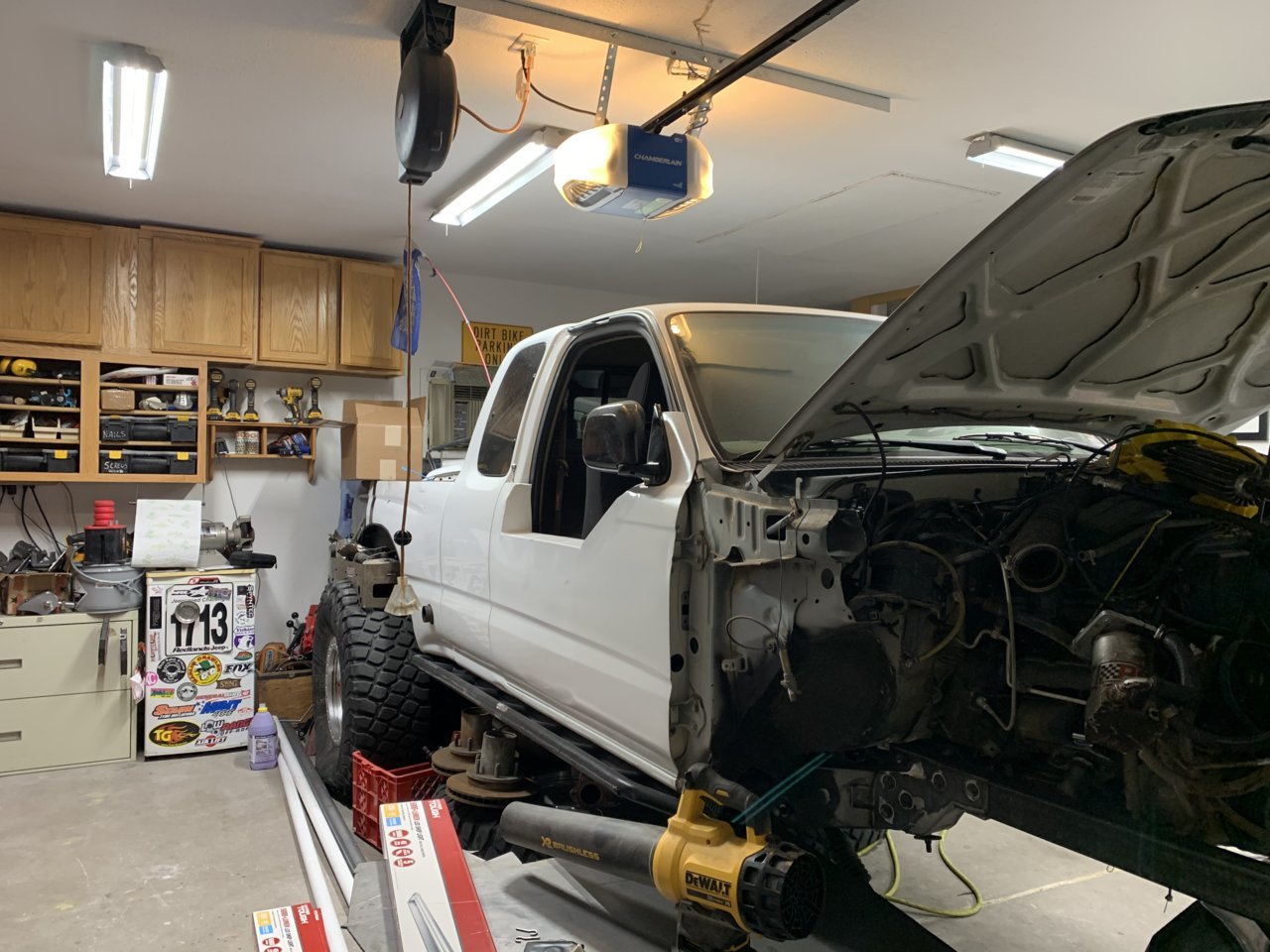

    Coil overs showed up. I attempted to make a coilover/bypass axle side mount but screwed up my measurements. Got some new lights from Wally word and got them up in the garage. Big difference.
    waiting on the inner cs and high steer arms to make anymore progrsss really

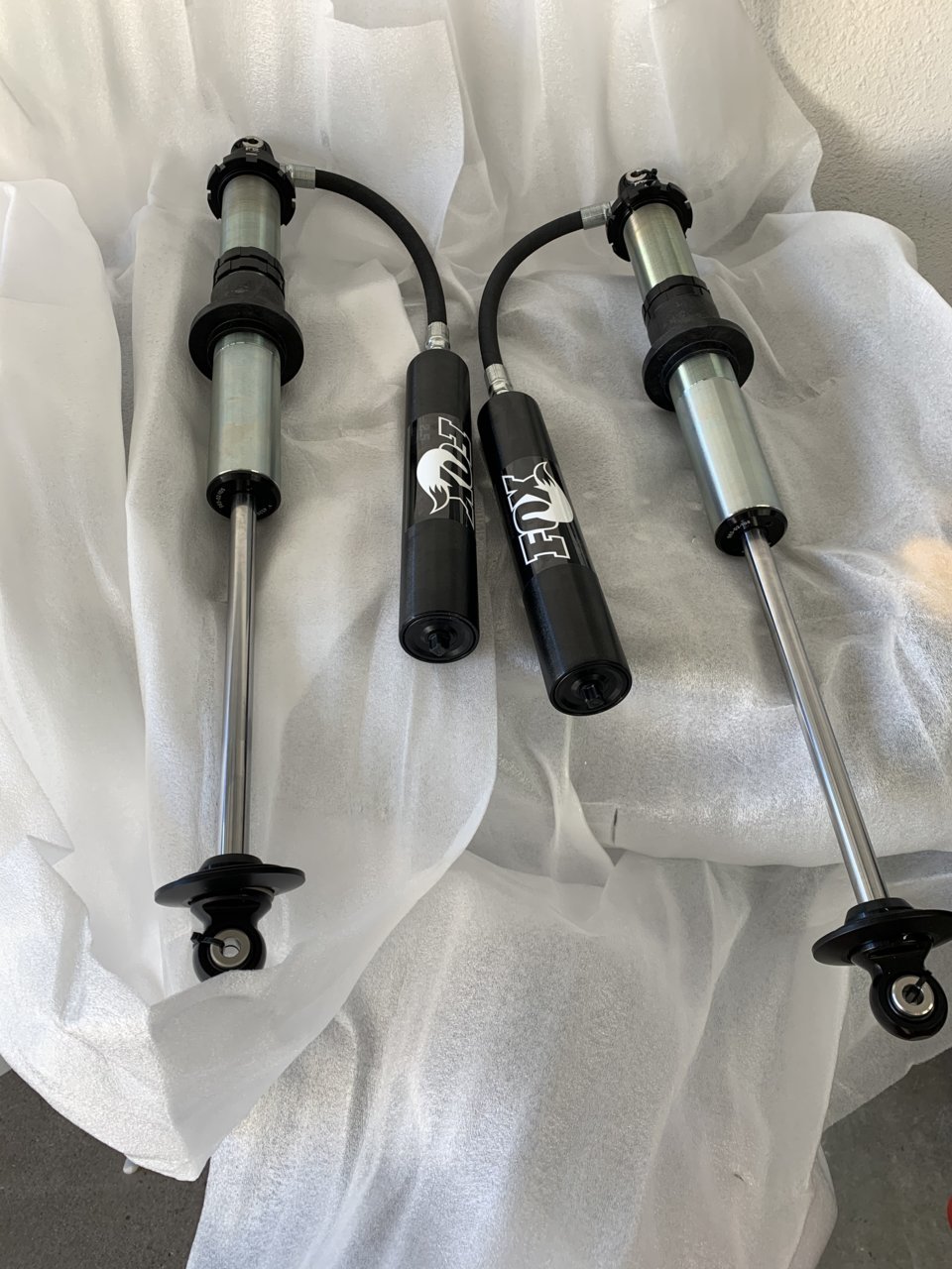

    Also picked up some fox 2.0x2 in bumpstops and sold the radflos to @Snowy. 38A79A0B-043A-4242-ABF6-C2C49381848F.jpg

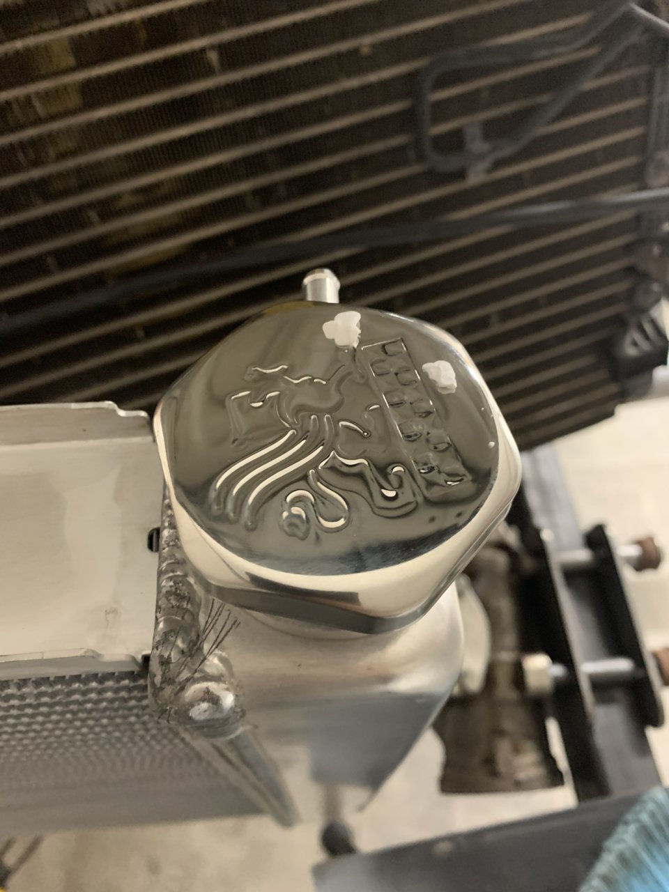

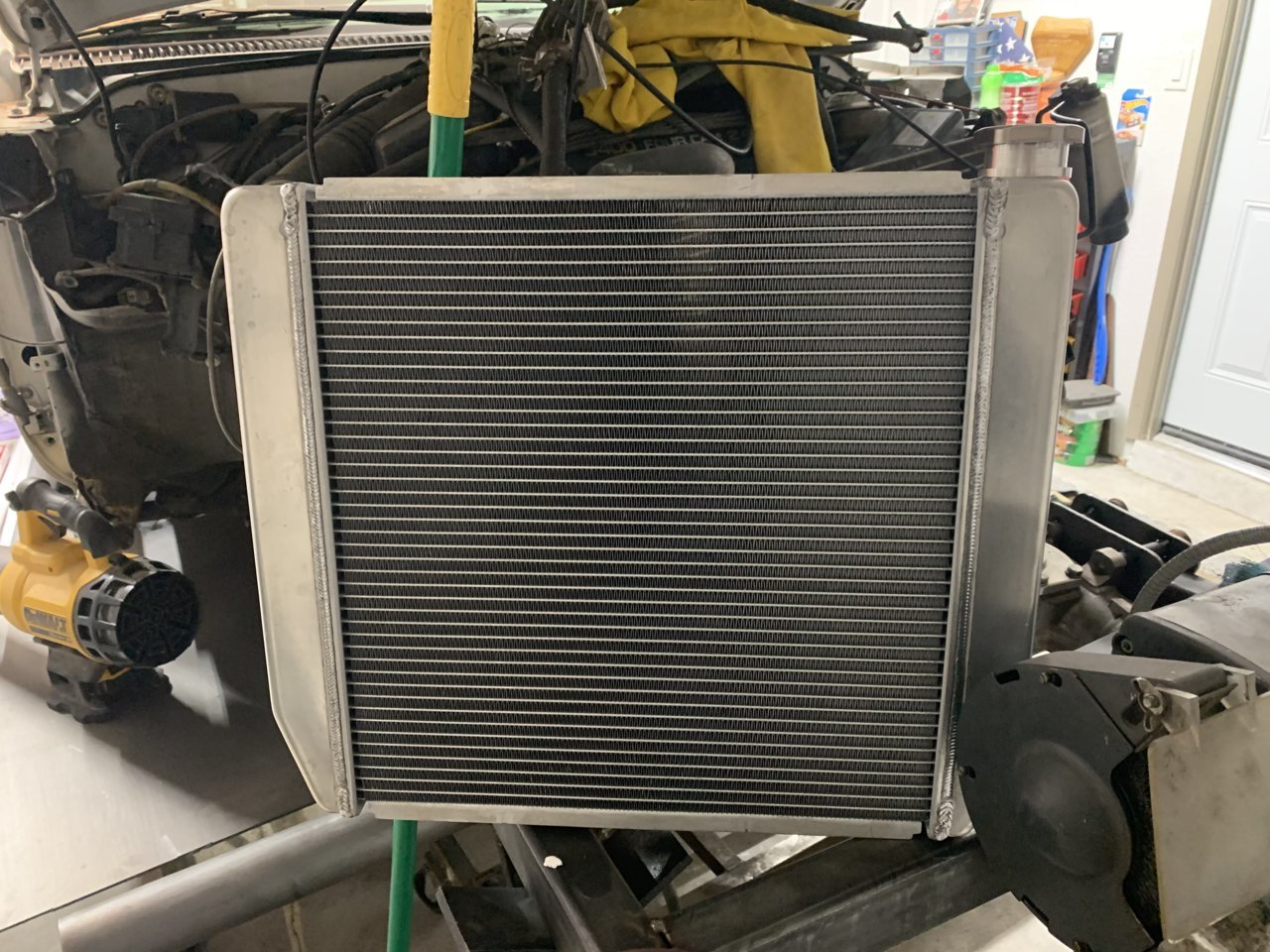

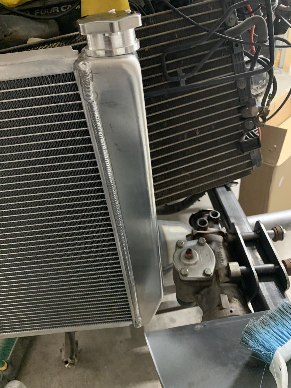

    Radiator showed up. Should clear the steering box by 1/4 in or so.

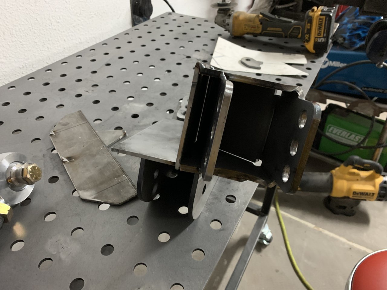

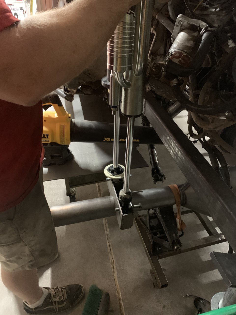

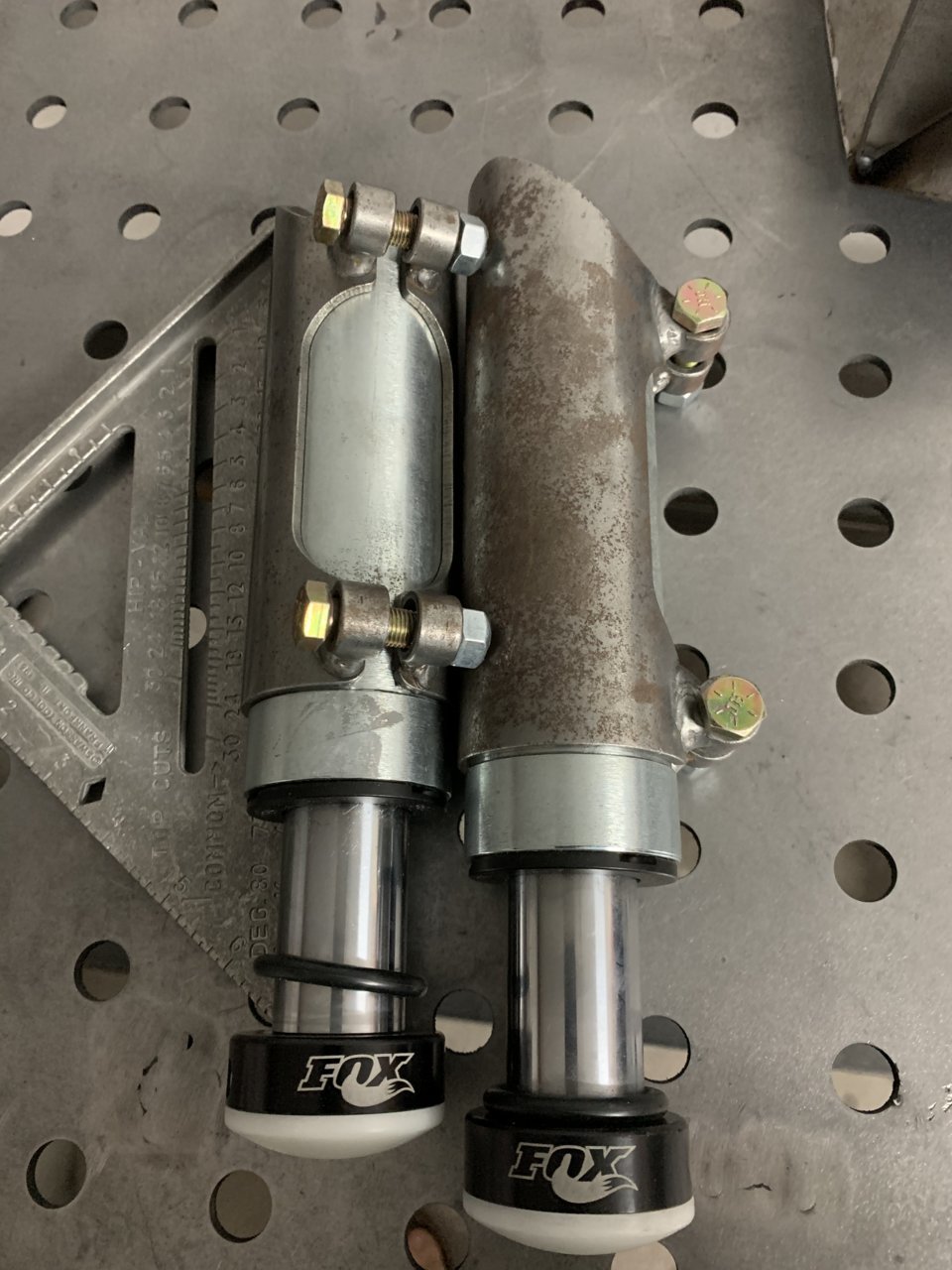

    Redid the bypass coilover mount. It’s a little tall but the pattern will work with some angles cut in it.
    Looked at some other mounts and shock towers. Most did 5 in spacing between the two. I went with 6.5 just to be safe. If I have the room I may move them in half an inch but I’ll wait

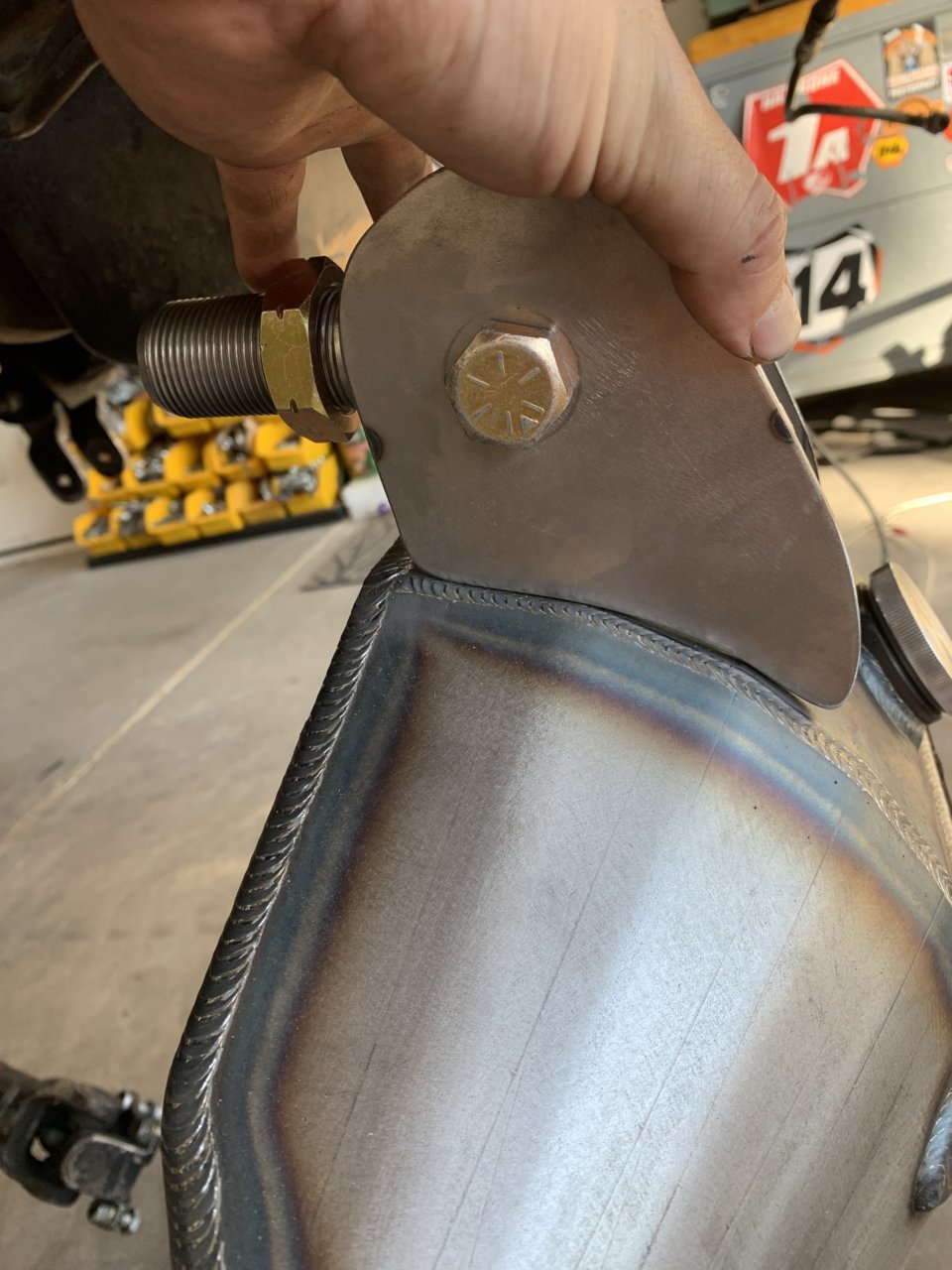

    Steering arms showed up two days early. Chased all the threads. Bent the link mount pieces to contour the frame.
    need to pick up a 3/4 and 5/8 reamer and get some studs or bolts for the steering arms
