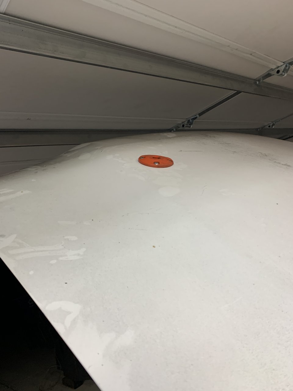

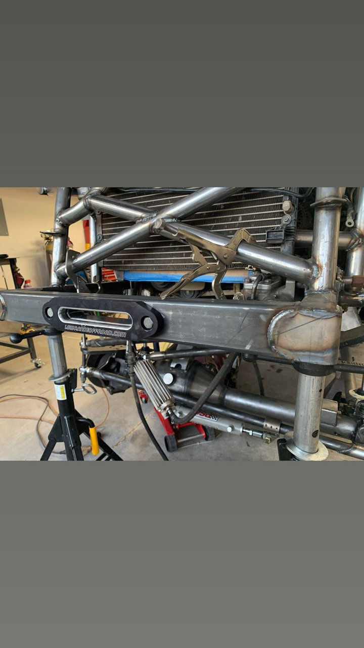

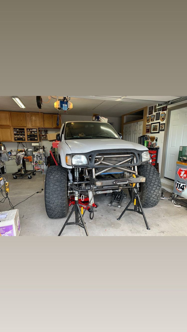

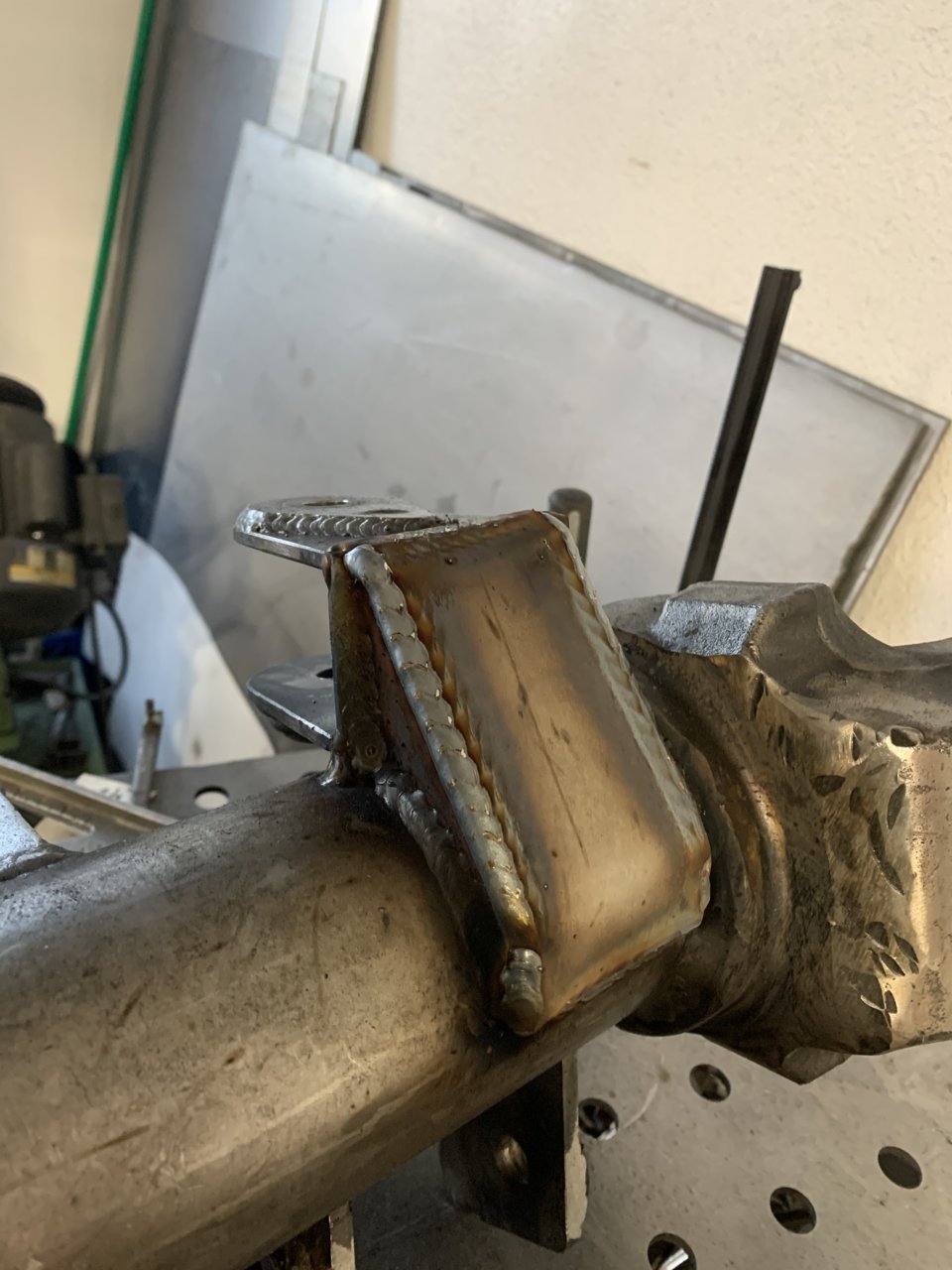

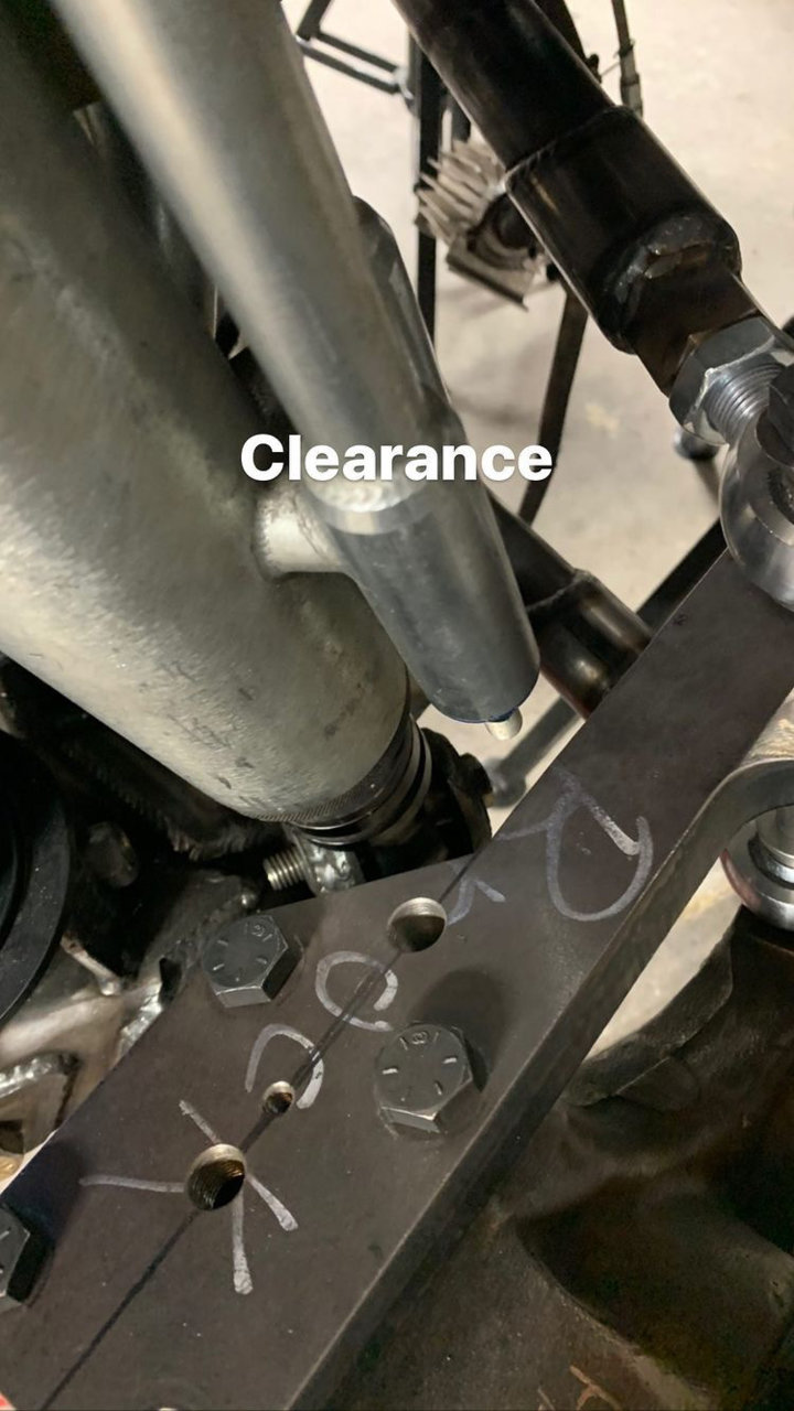

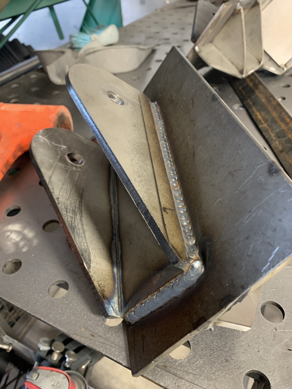

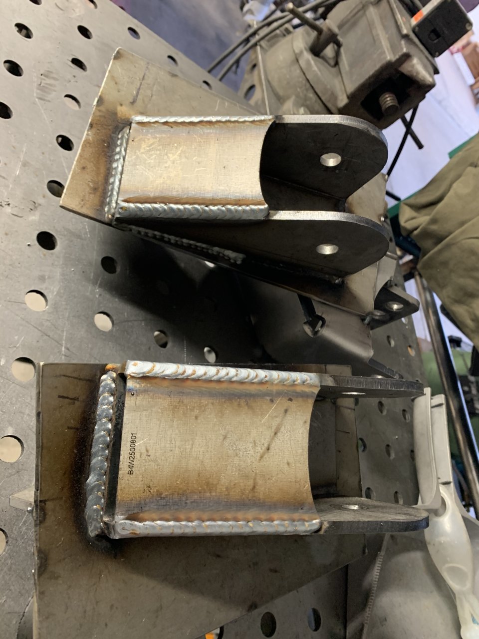

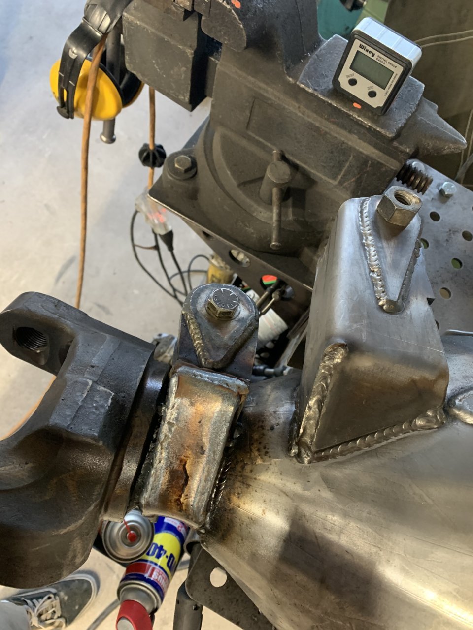

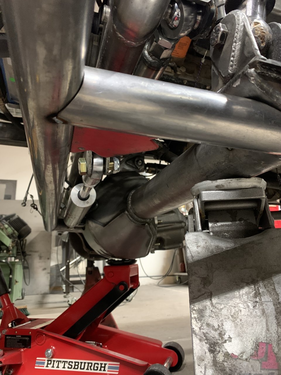

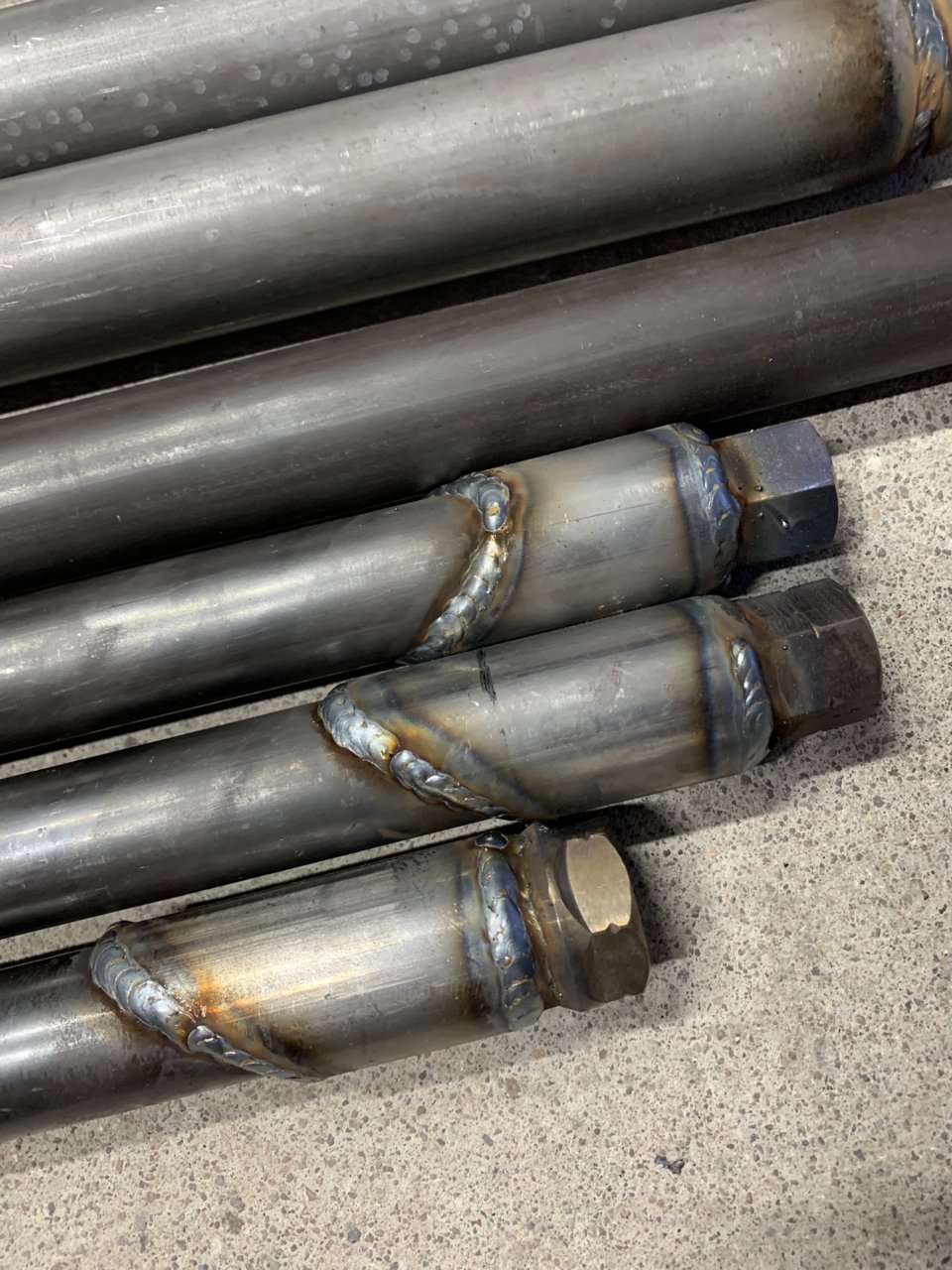

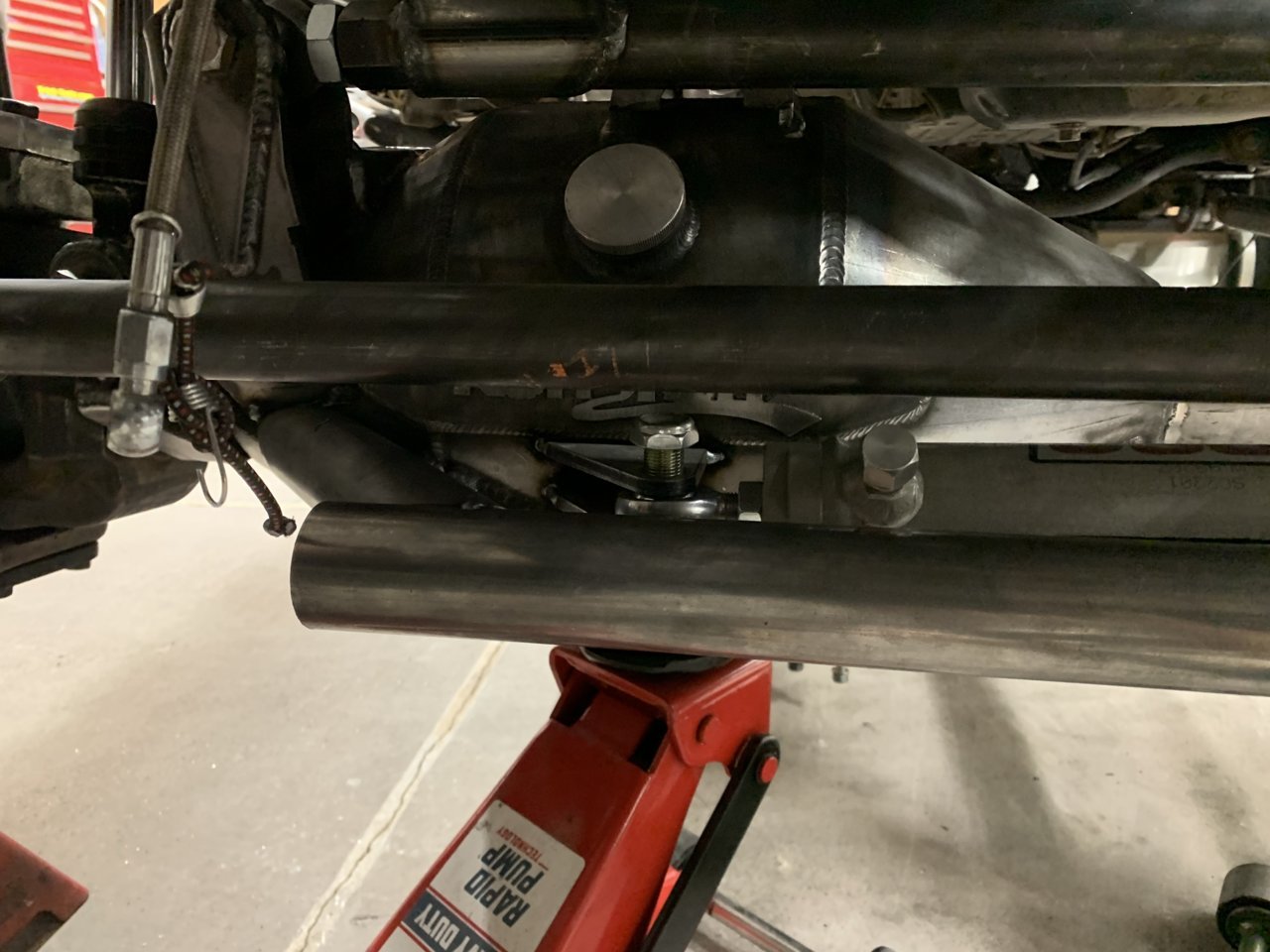

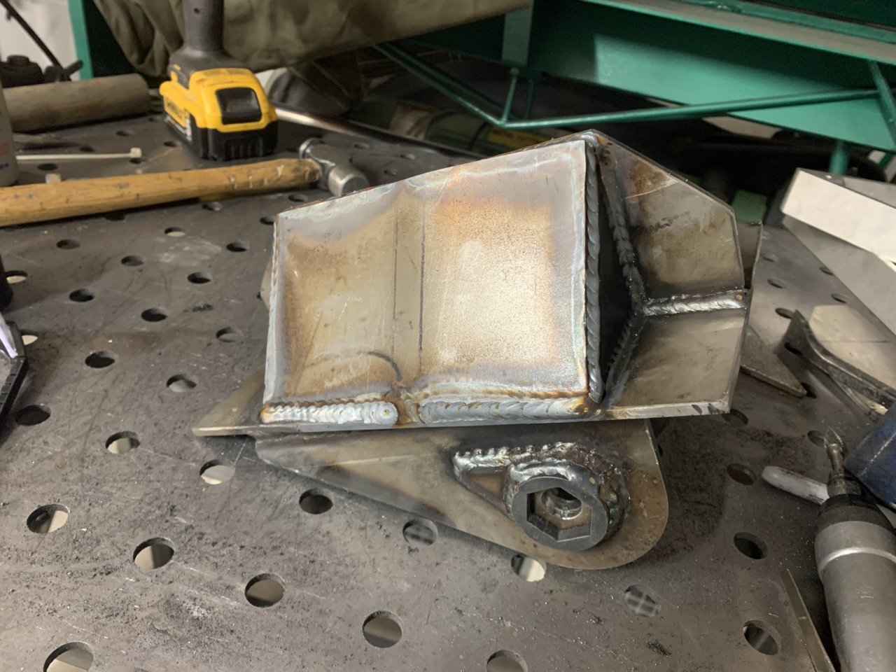

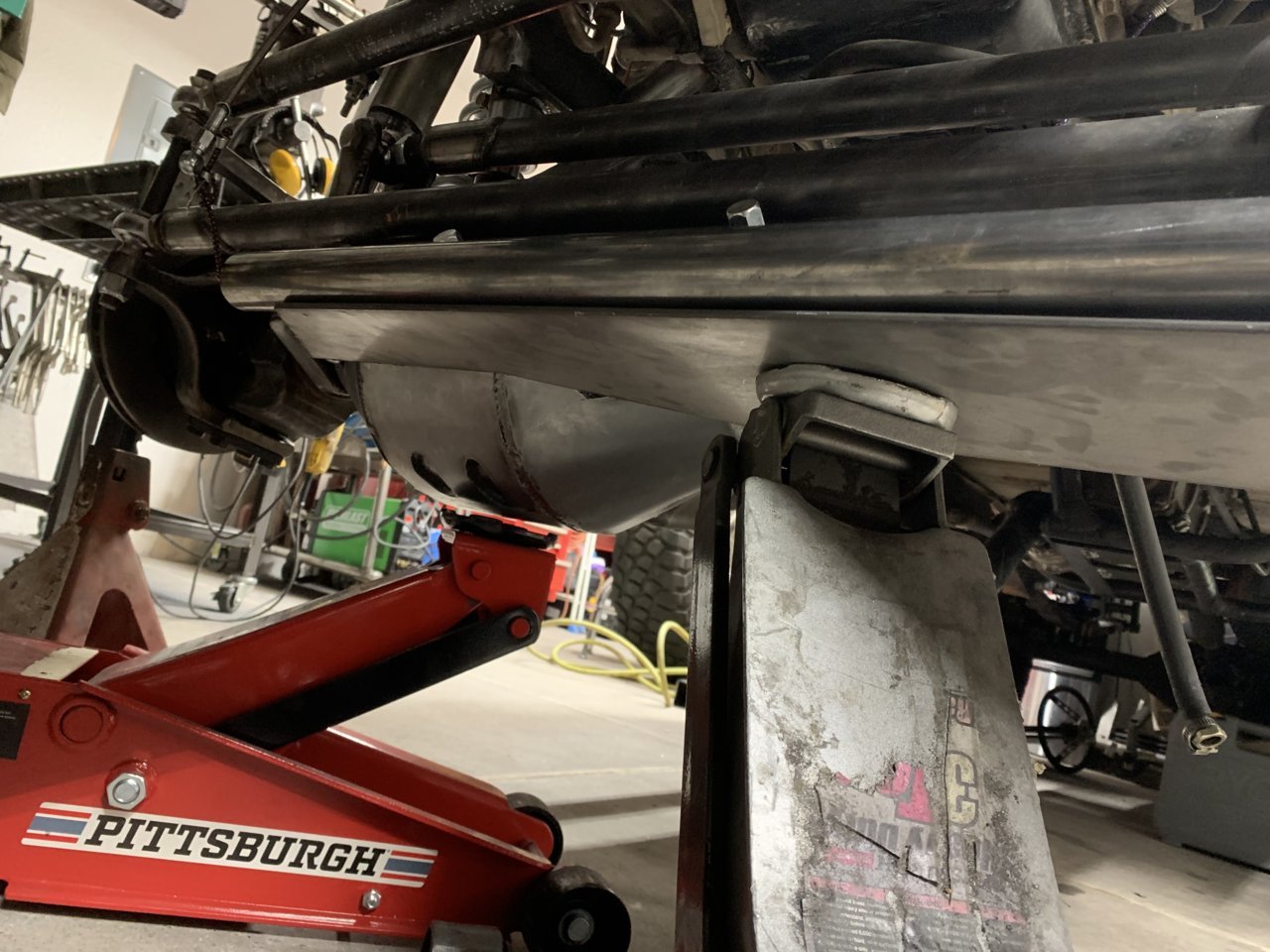

    After a 10 day work week, finally found a few hours before going into work tonight.
    Bypass mounts done. Onto the diff armor.
    53DC1A00-E542-48FD-B6A0-82AEE256EFE6.jpg 0BAA592D-6063-4408-9991-2908A143ED90.jpg 08C3596E-A191-4C89-952A-8F92C031C197.jpg 15C573F2-EA72-4C83-ADE1-F963CB530606.jpg

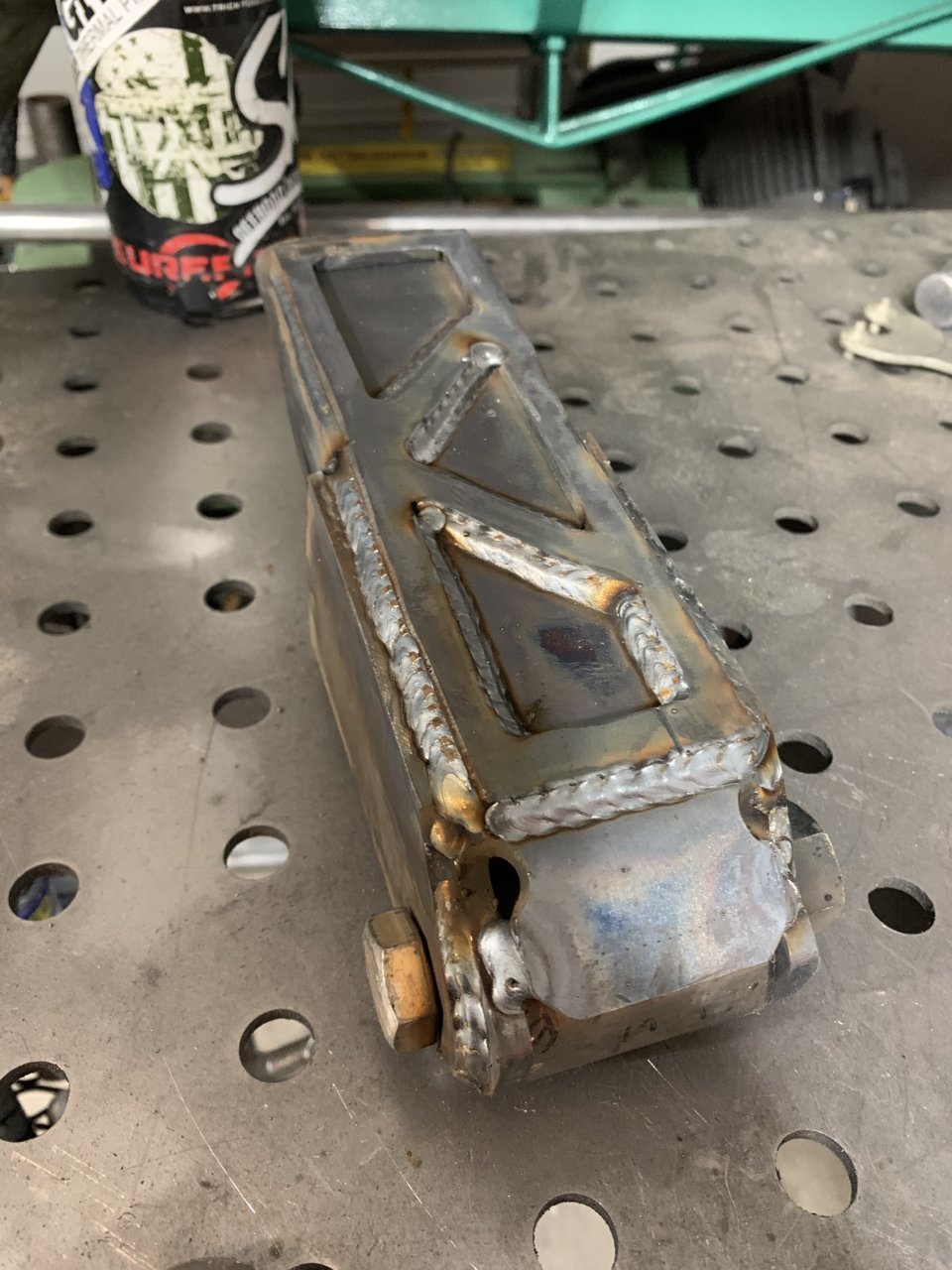

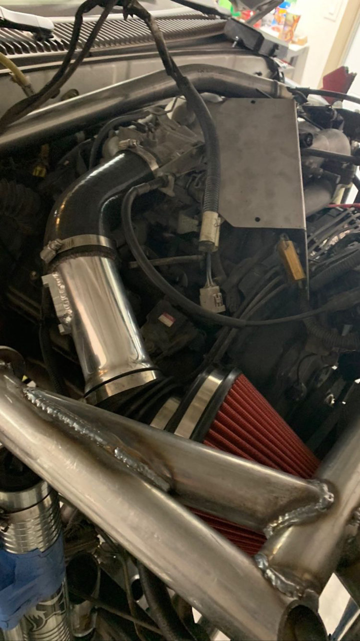

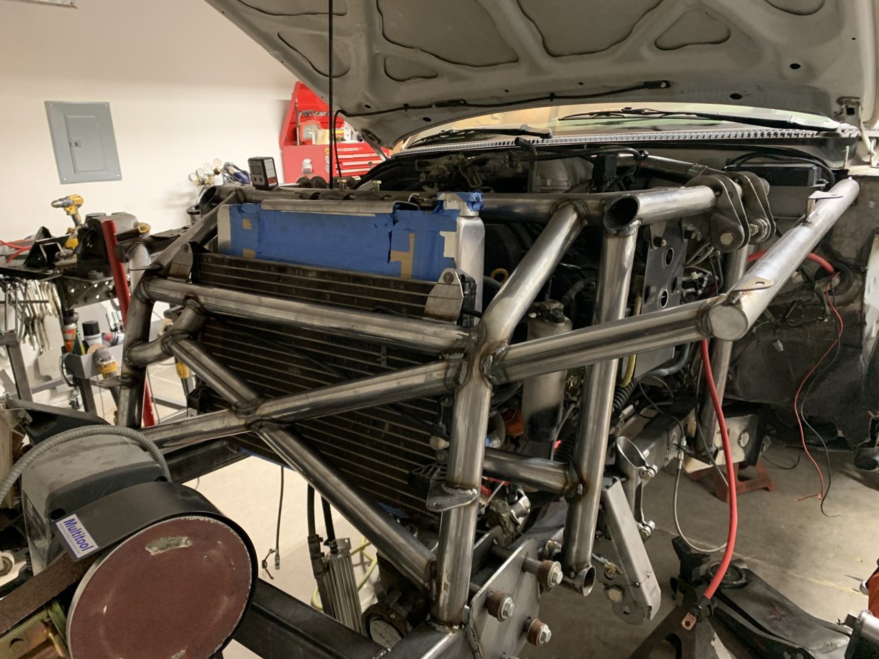

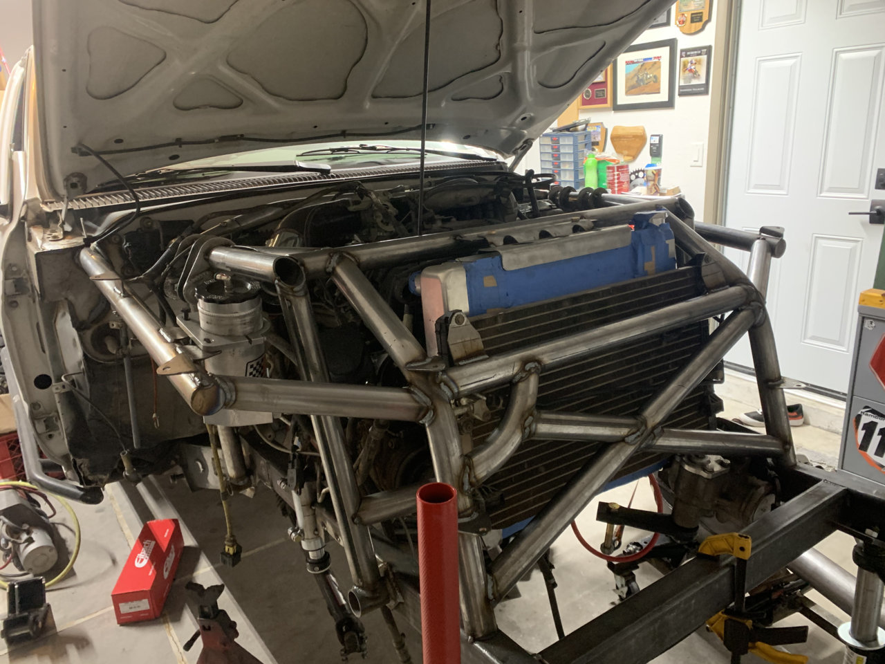

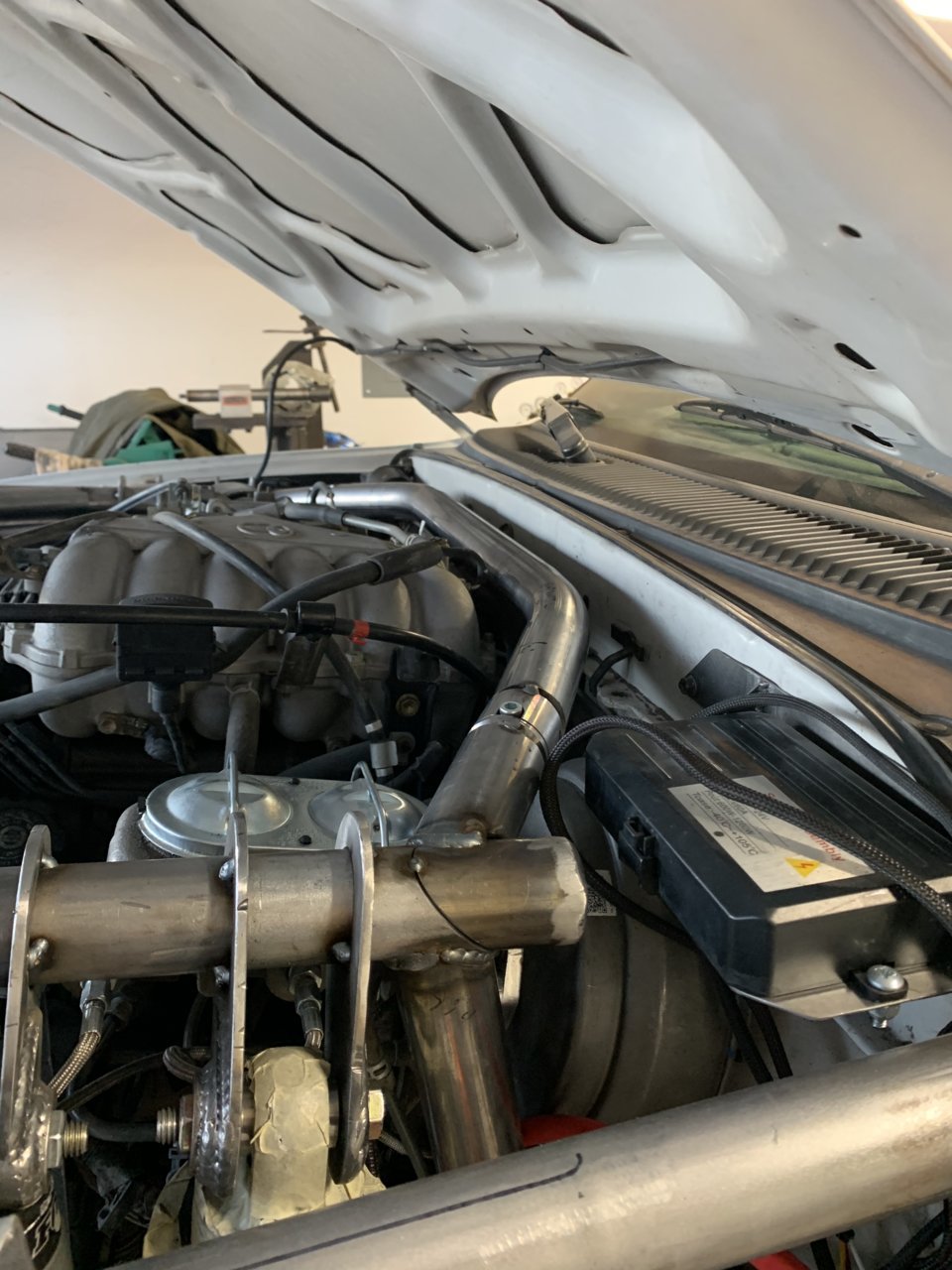

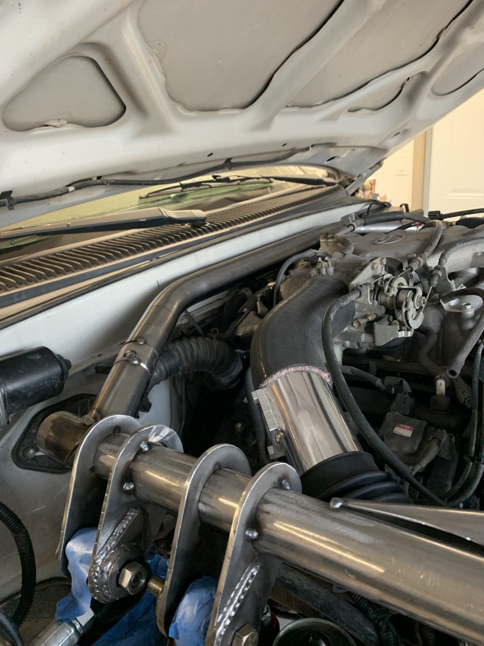

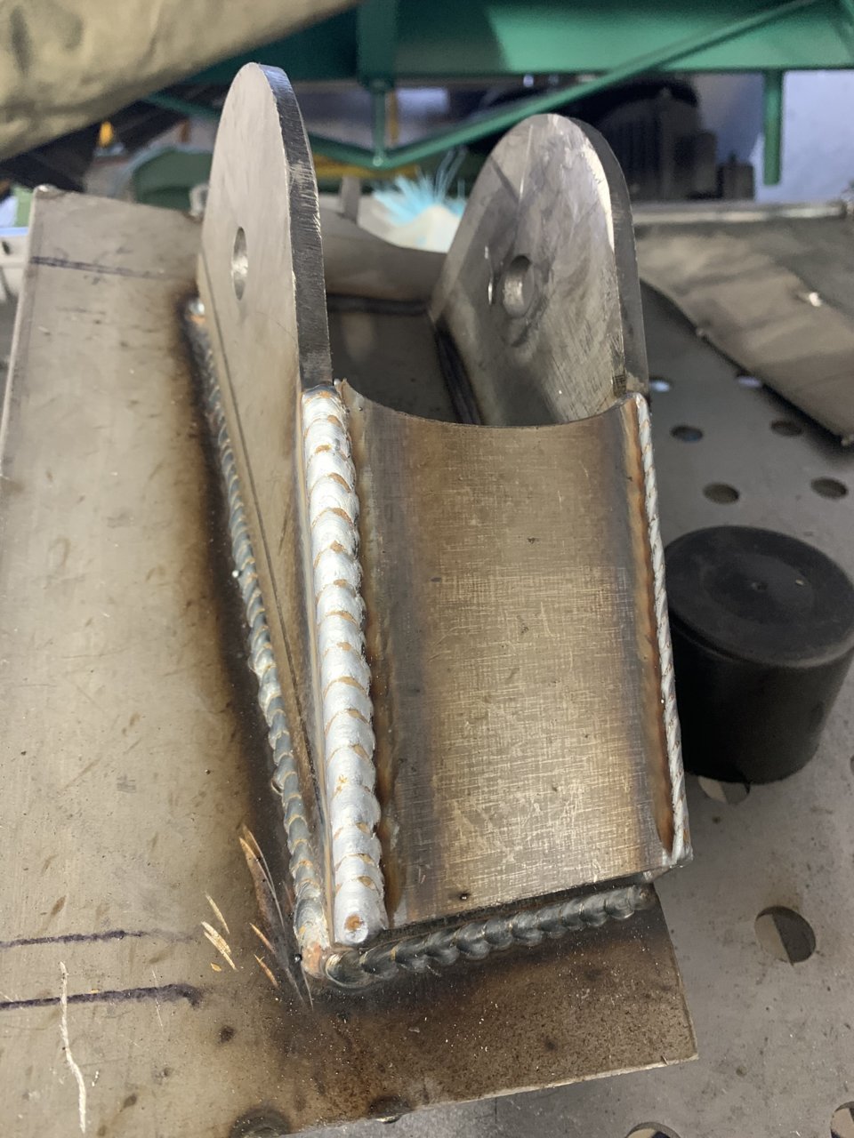

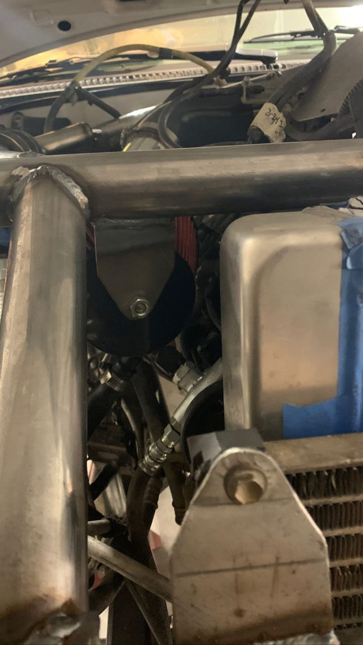

    More work done. Started welding on the engine cage 07D33552-CC03-4186-962E-E28FA5BE4AEE.jpg12C5E0A8-F97B-4213-BAF7-E7A6D278084C.jpgE6A92A61-FA89-4985-8A4B-C80B4022B49D.jpg

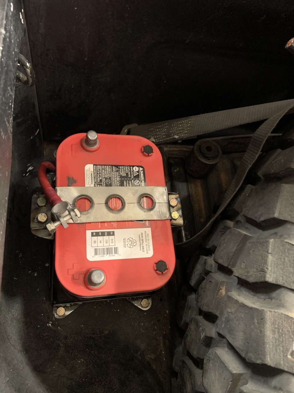

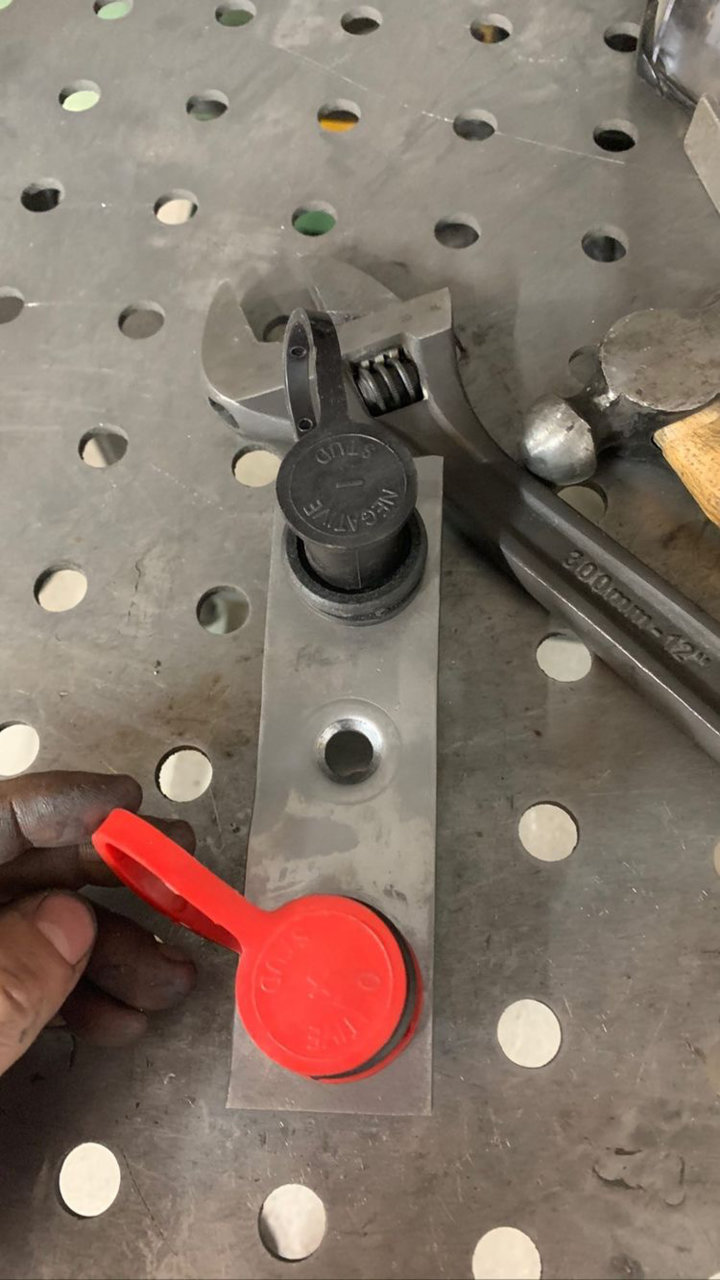

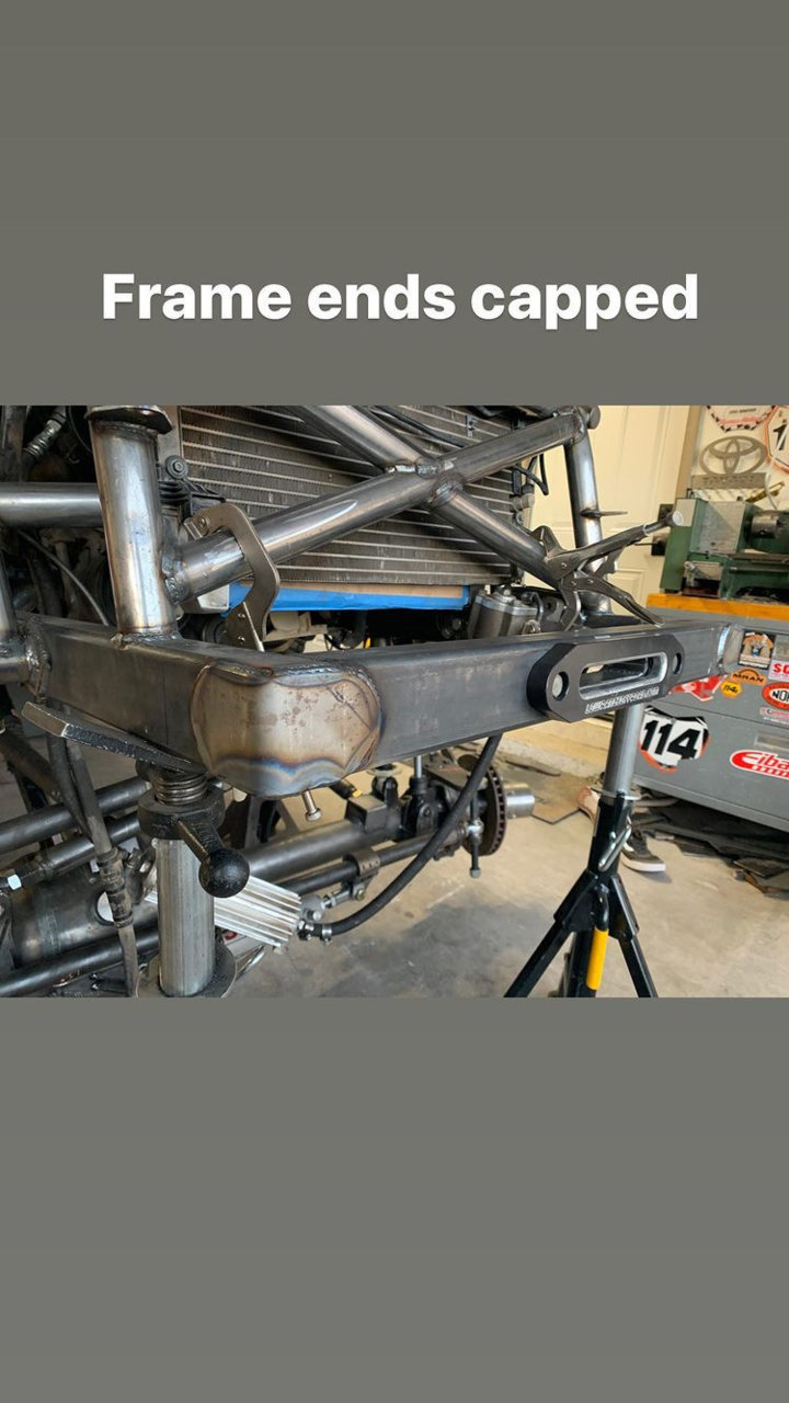

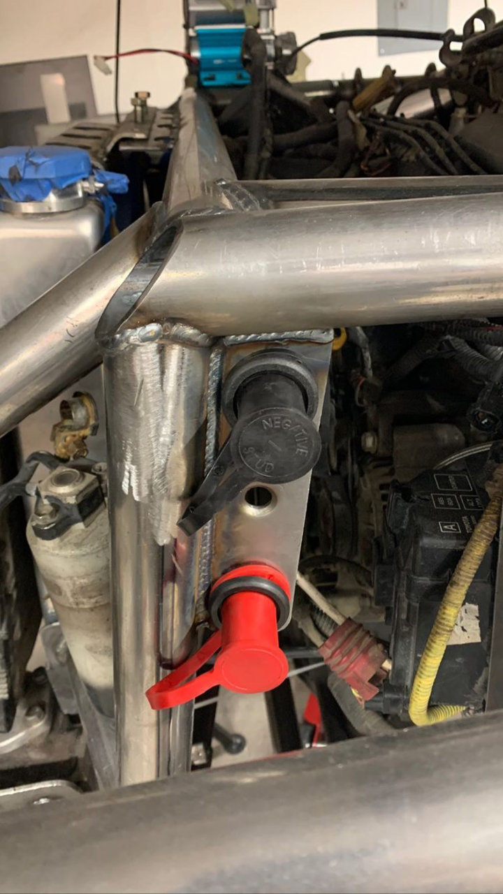

    Engine cage is 90 percent done. Battery terminal ends crimped on. Moving along
    Welding tube is hard that’s for sure. And some of the hood boy when he wanted to help the other day 9CFC5C93-EEDD-4F53-8B93-ED646461F369.jpgF0AF722F-914D-48EF-81BC-BC5B185478C5.jpg3295F086-E366-4C31-8CFD-609CD2DA16EE.jpg

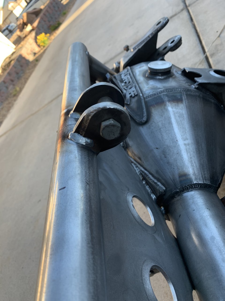

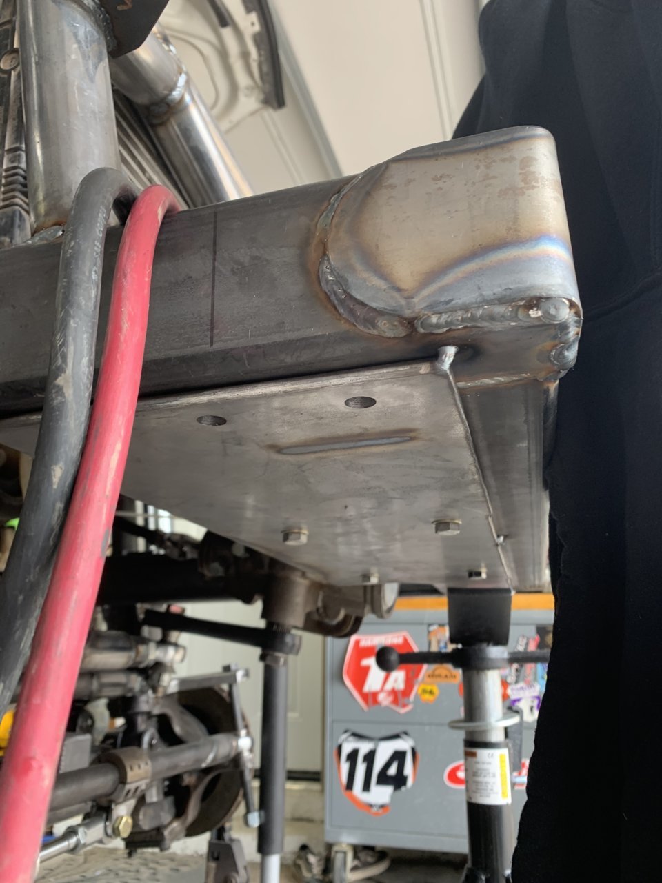

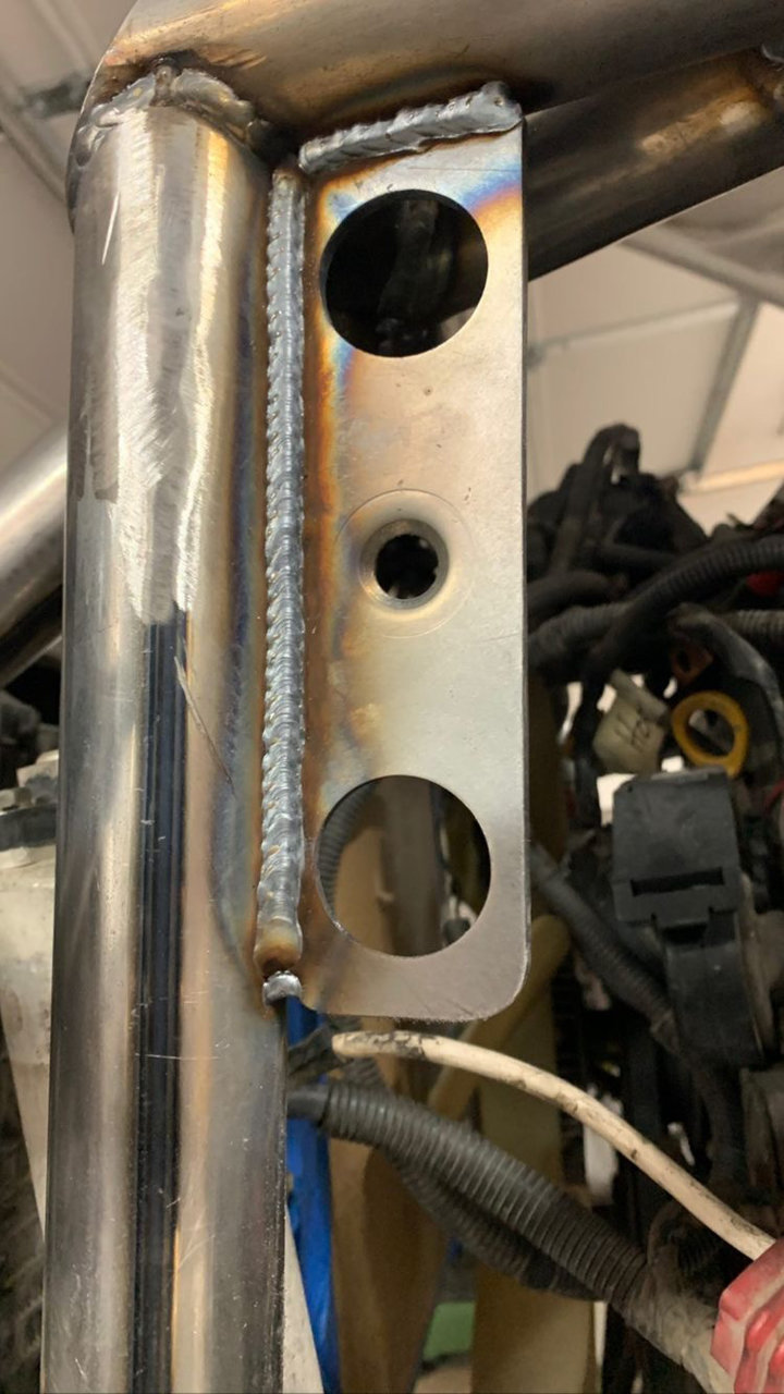

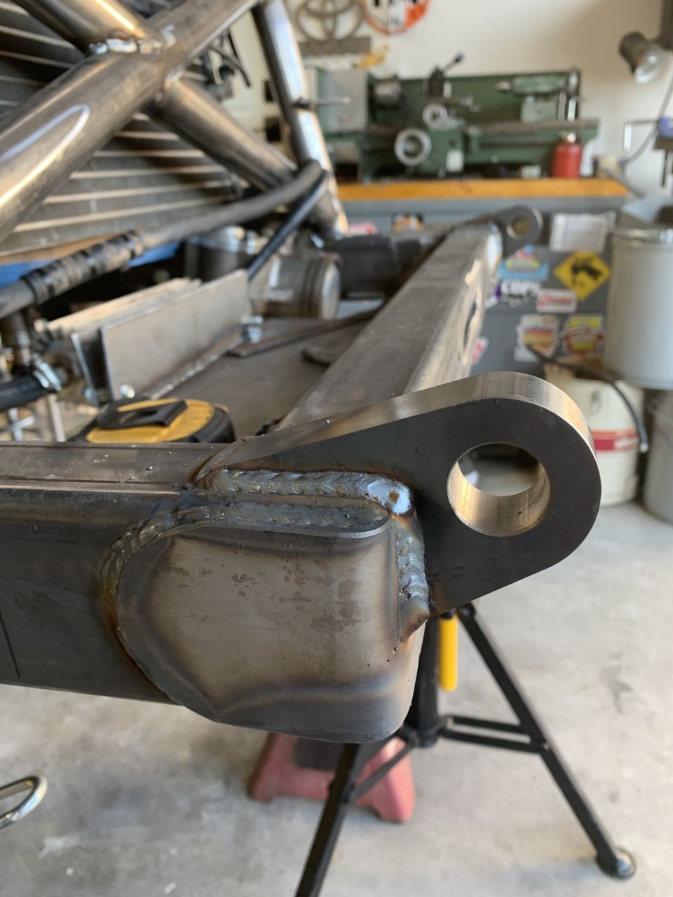

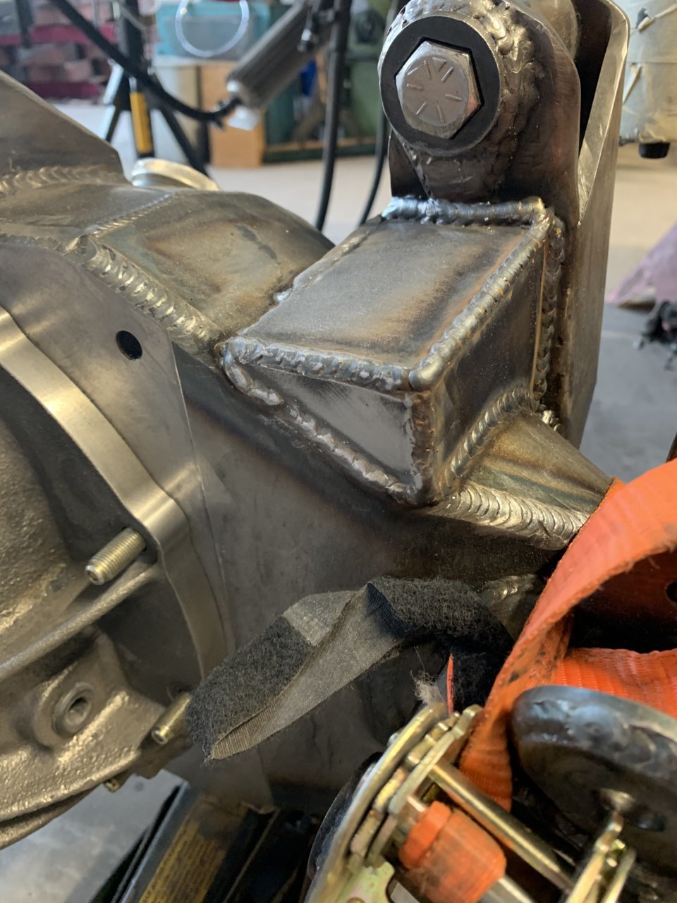

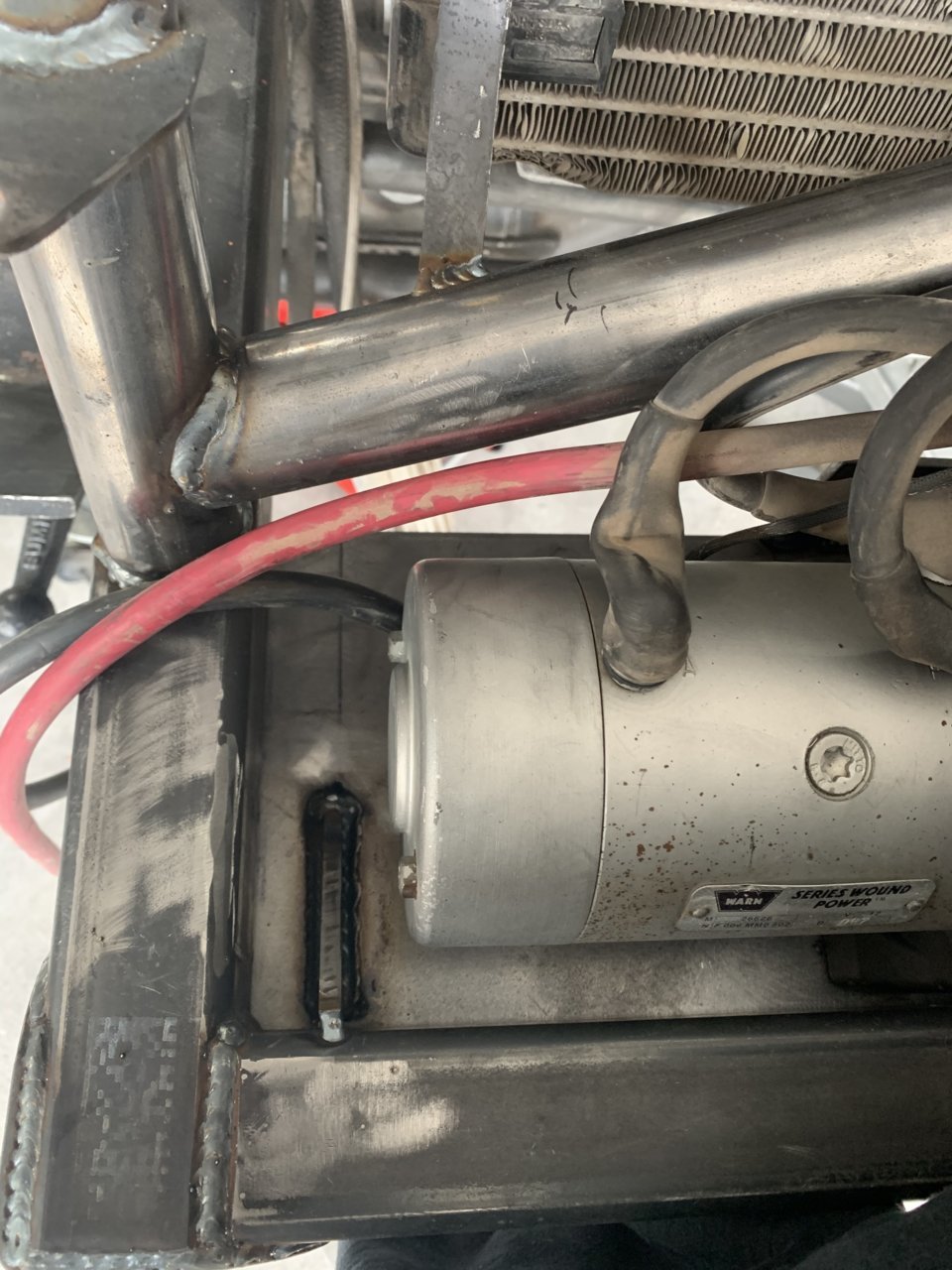

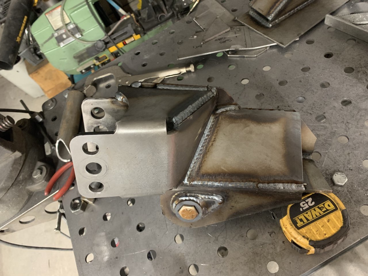

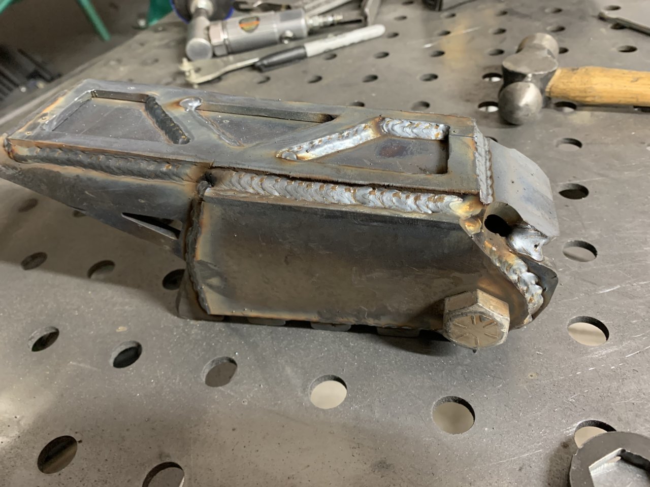

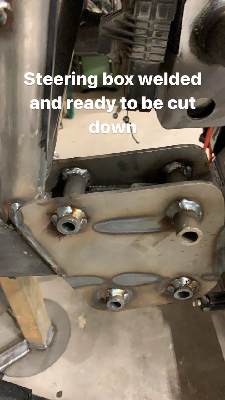

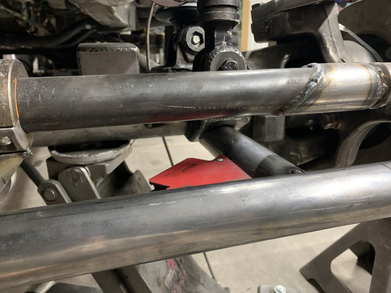

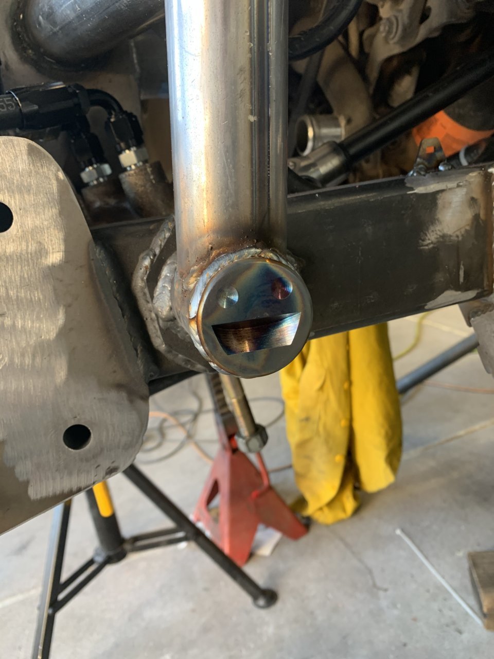

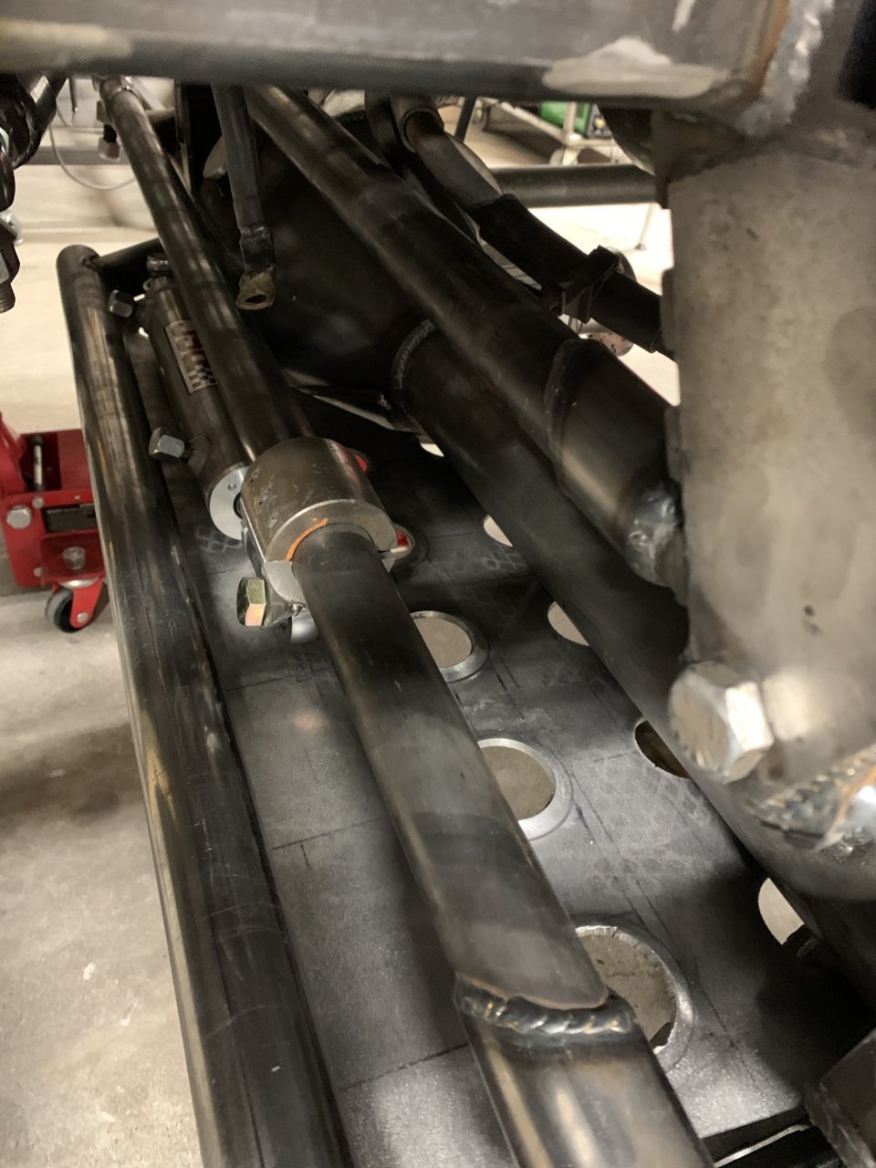

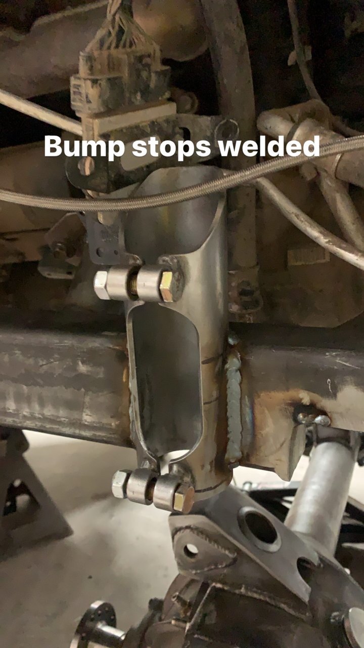

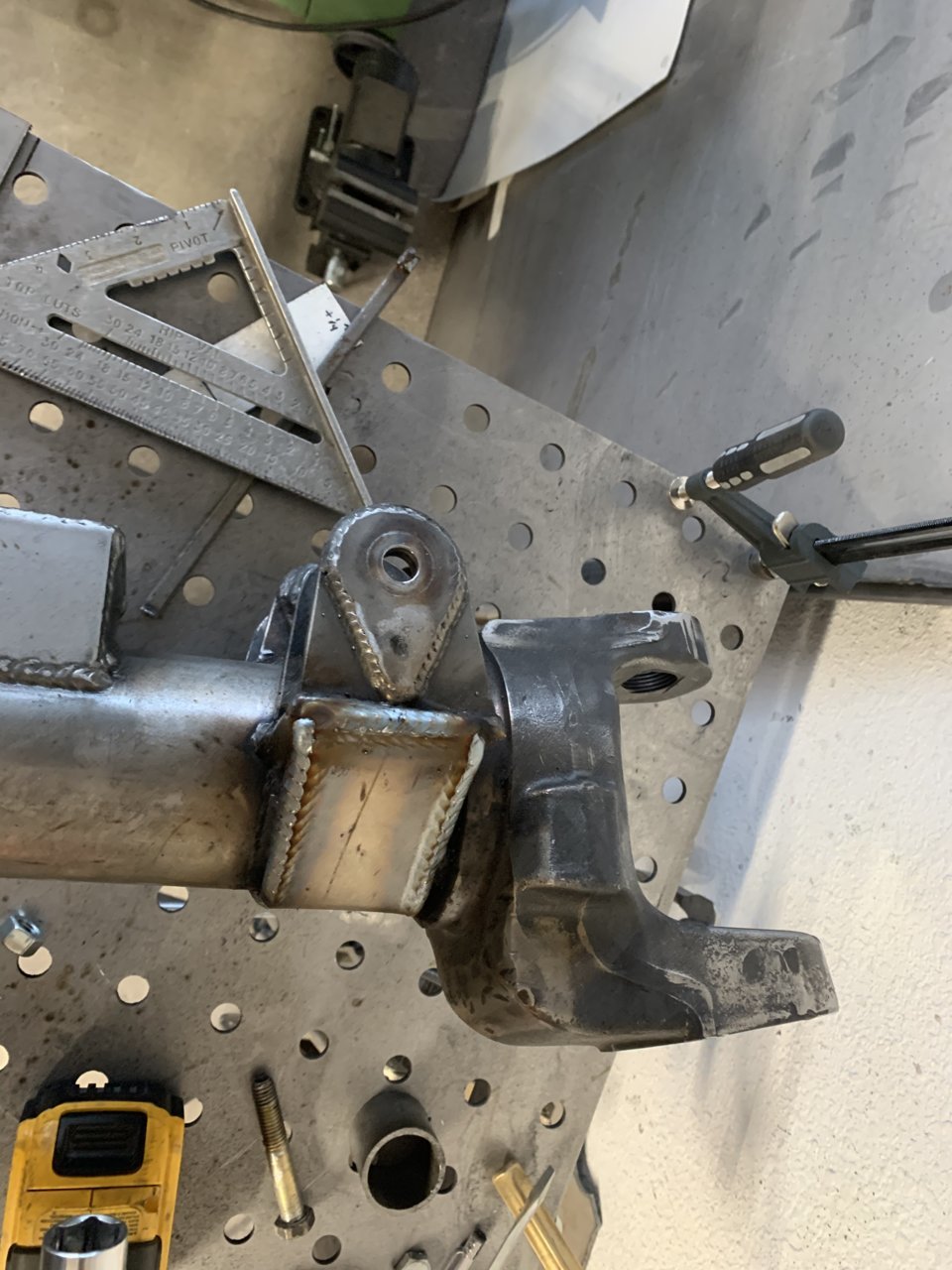

    Engine cage is done. Frame is 95% done. Won’t lie. Some of the backside welds look bad. But it’ll all hold. Bumpstops welded. Upper shock mounts welded. Link mounts welded. Crossing things off quick. C42F6AD0-D31B-4776-88E0-9A68BC150957.jpg0F28FA3E-988F-4B35-ABFD-2979B9753EED.jpg9DD6EF66-BCE5-482A-9542-076220F1D660.jpg6C9E4013-ECC8-4BD3-8F56-BC0A4DCC0886.jpg828331C7-BCFC-4114-A274-13D0BAC061DF.jpg0F189008-F9DA-4148-9F32-24EE034A67EE.jpg

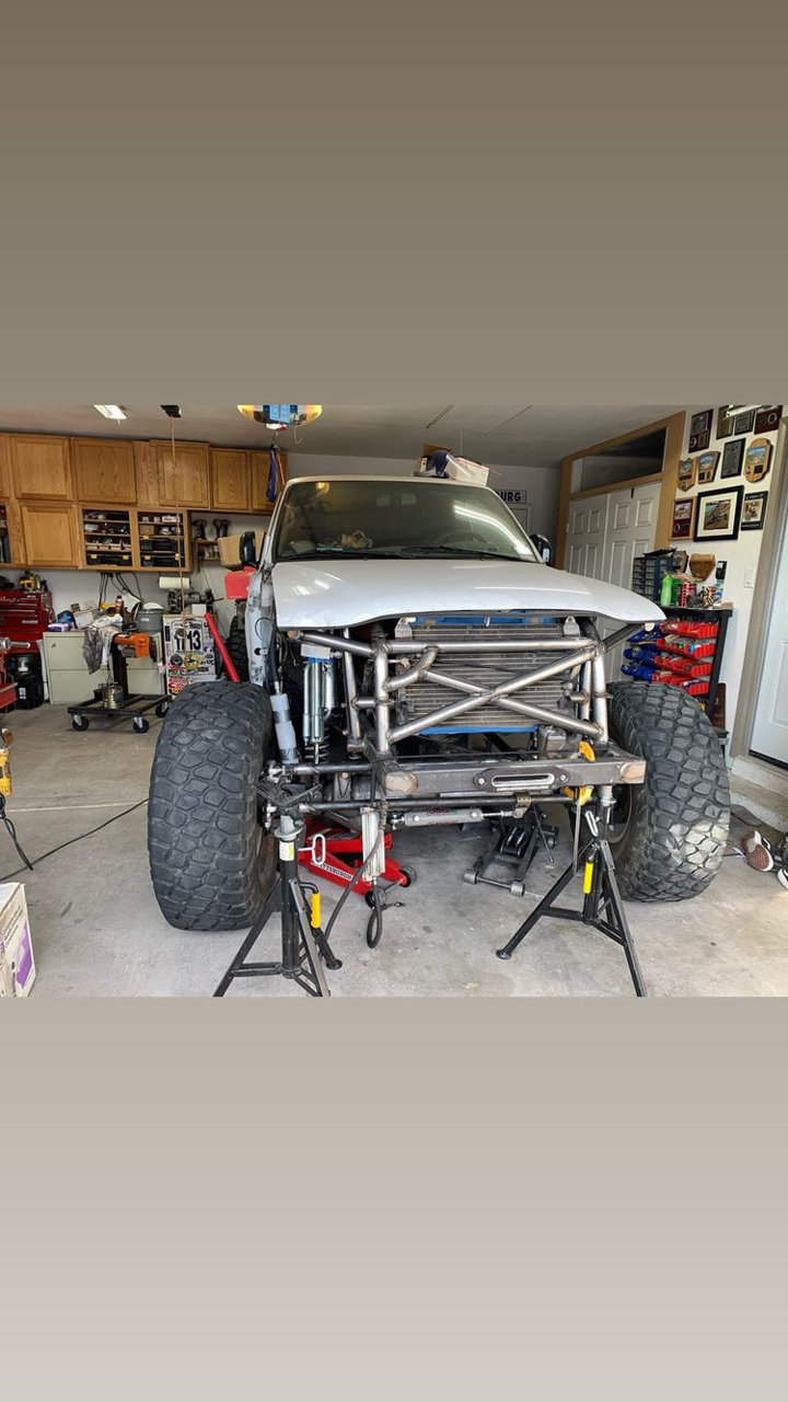

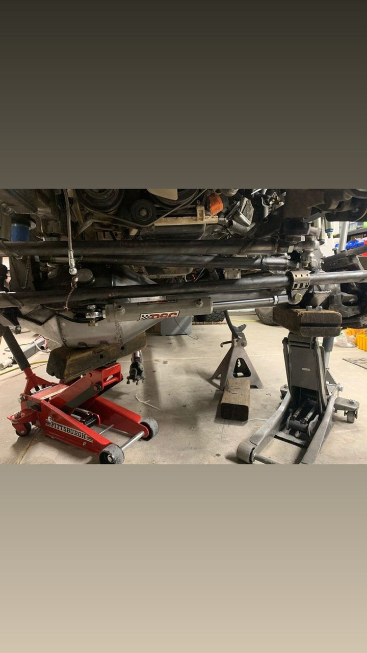

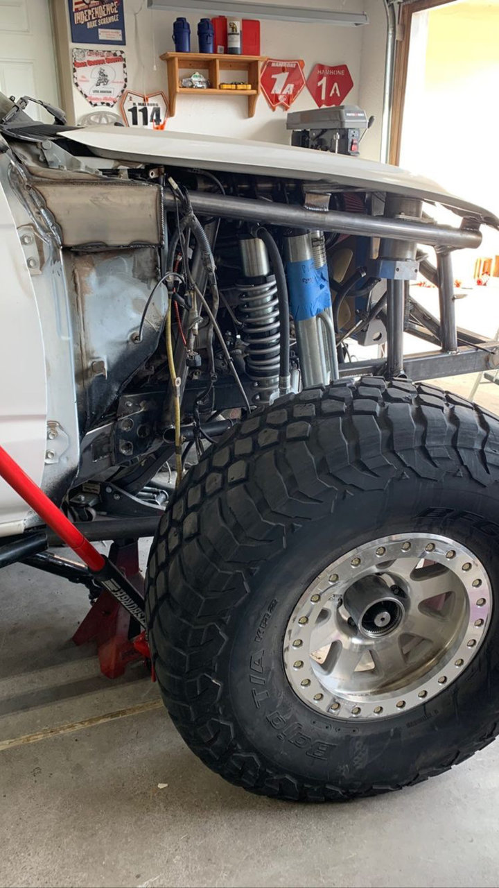

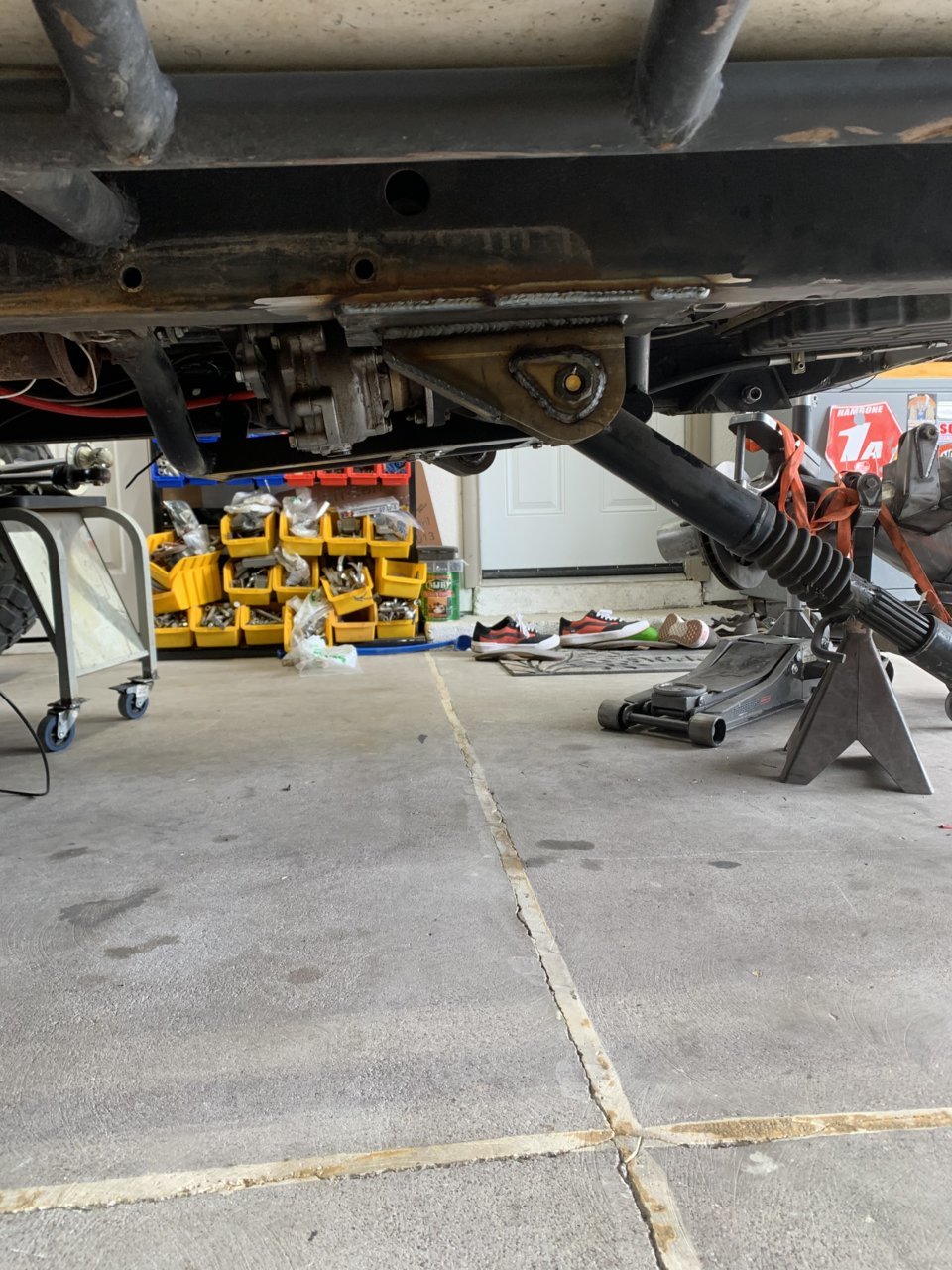

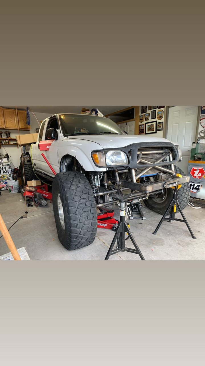

    Photos from the last few days. Been hitting it hard with long hours but it’s showing at least and got it on its own weight for the first time today

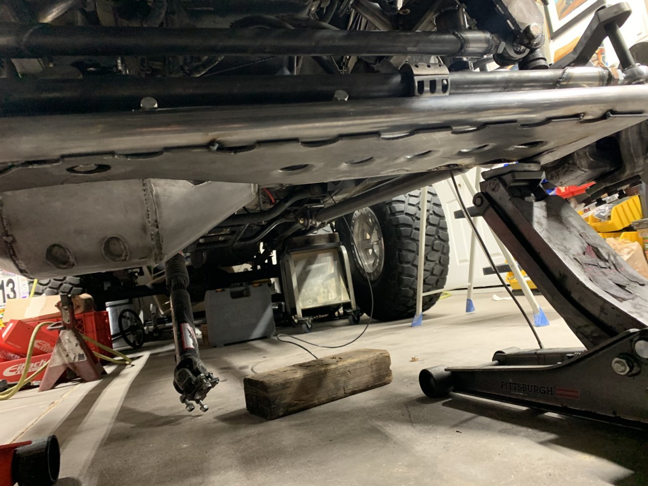

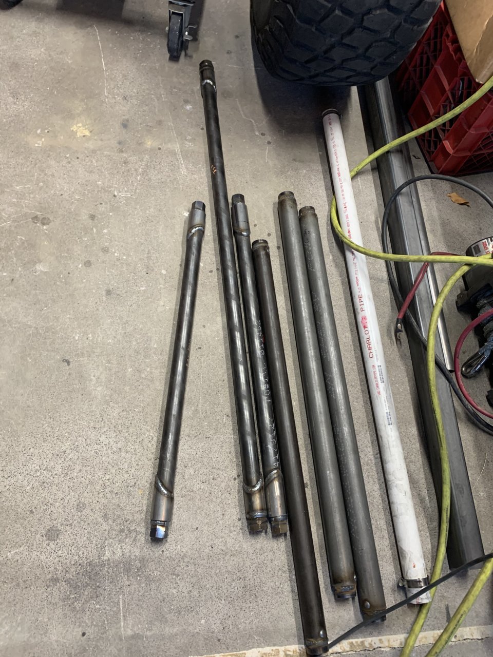

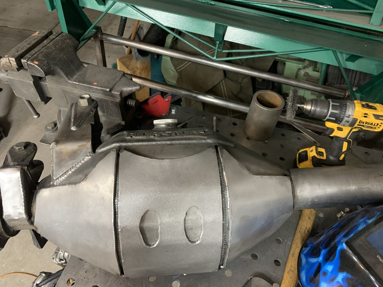

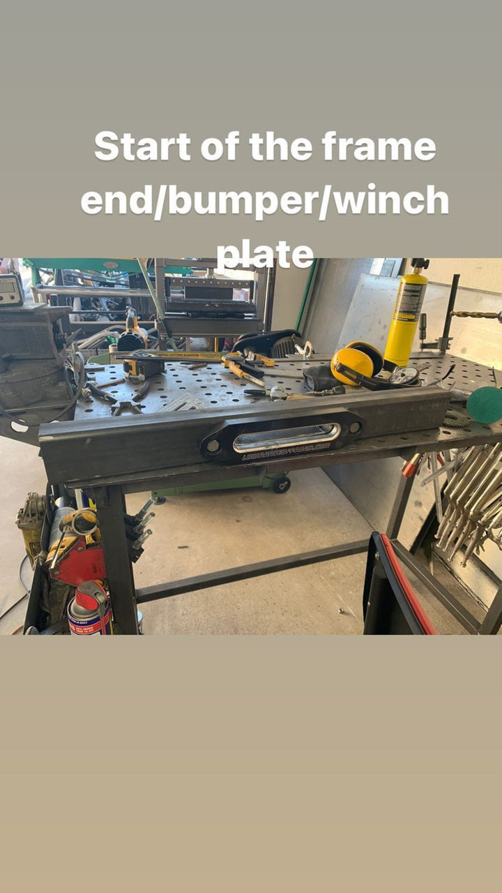

    And some of the fab work from the last few days
    6B45EAEC-8DE1-4F5C-8C90-BA786A4AFFA3.jpg B939C965-3603-4322-A24E-2B0A0DCF4B38.jpg 70603C9A-16FC-45EF-85A5-24597305A069.jpg 4D215213-FBDE-4BC0-BA5D-74F3BC3DC718.jpg 5BCD37AC-59B9-42FE-A80B-A50483BBF6E0.jpg F8E84D85-A1FC-491D-BE3D-EF4B338AF435.jpg 26E5E9BC-71E8-425D-B595-1705C51B33F3.jpg

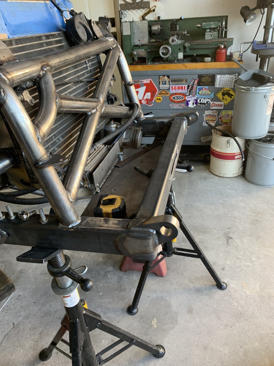

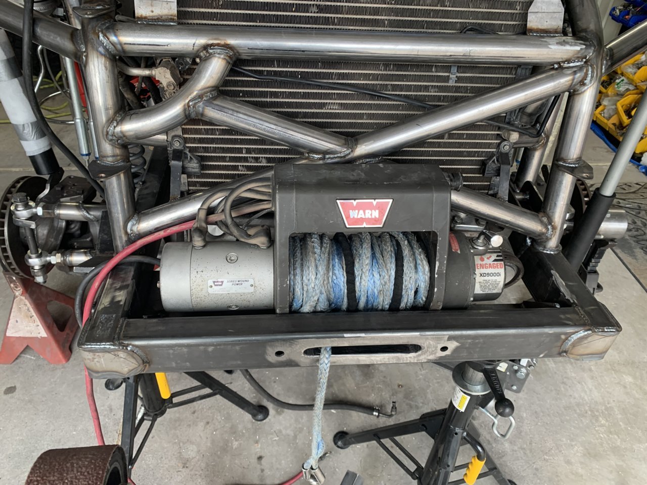

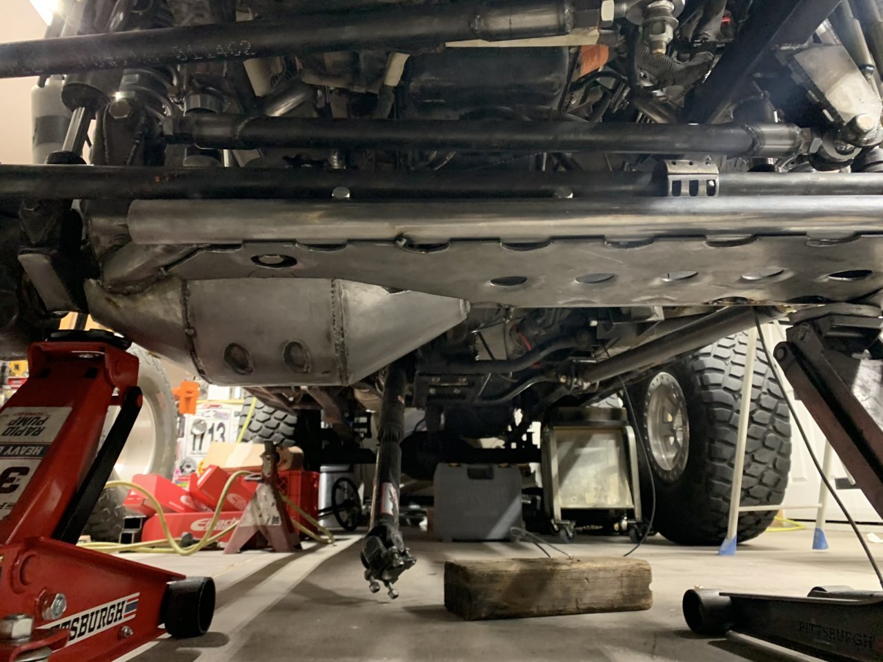

    More stuff done

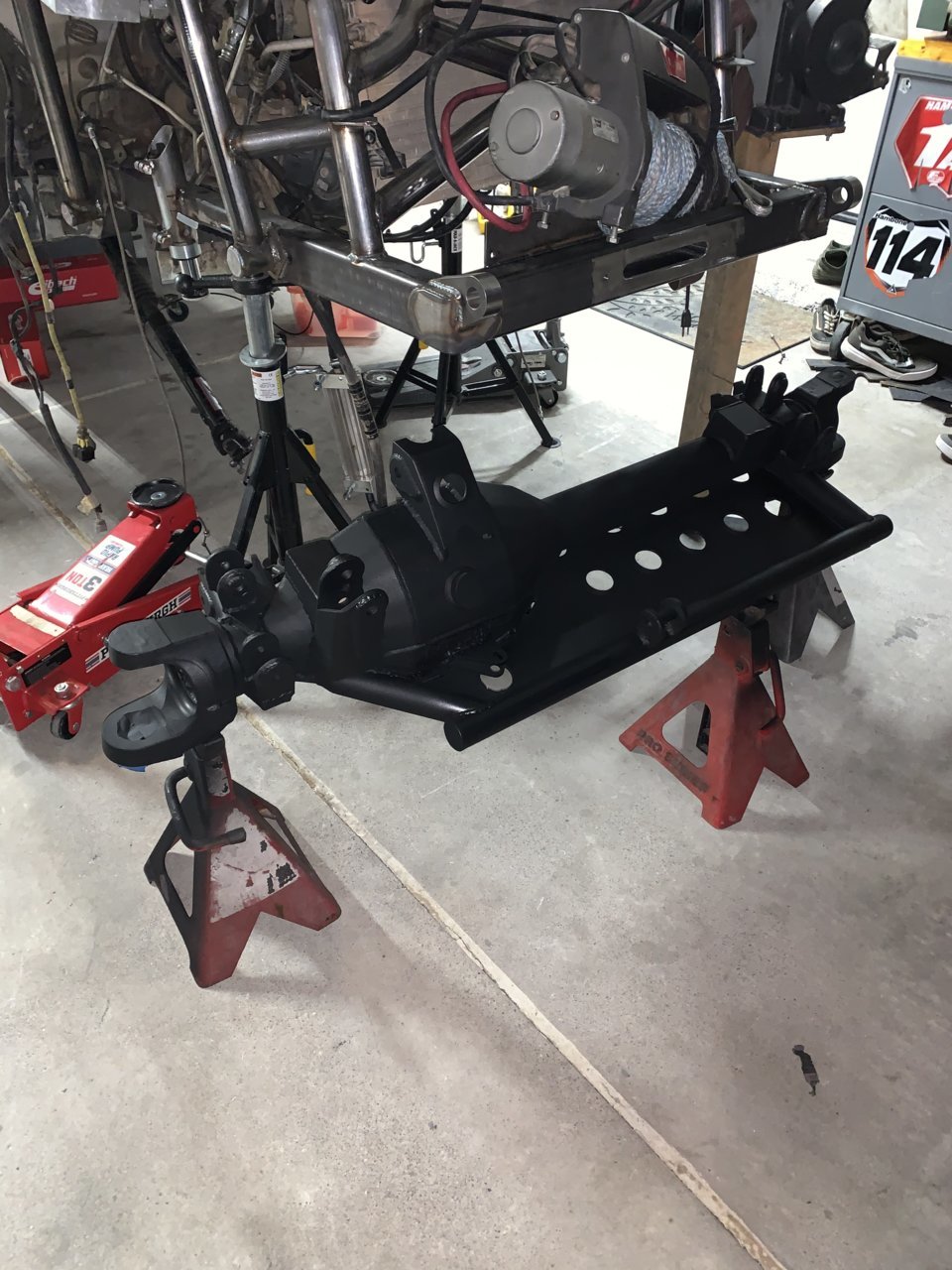

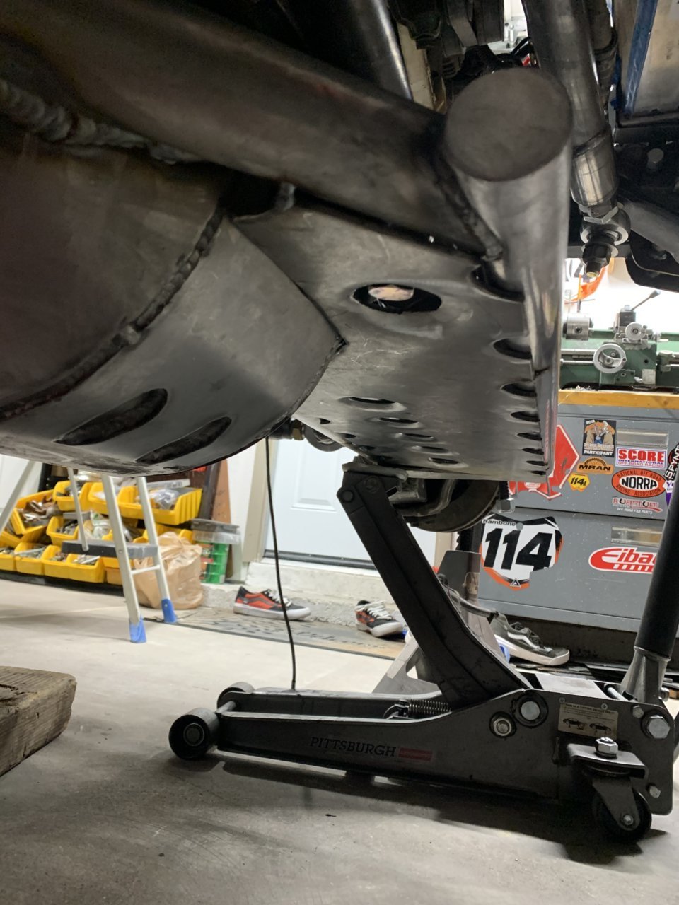

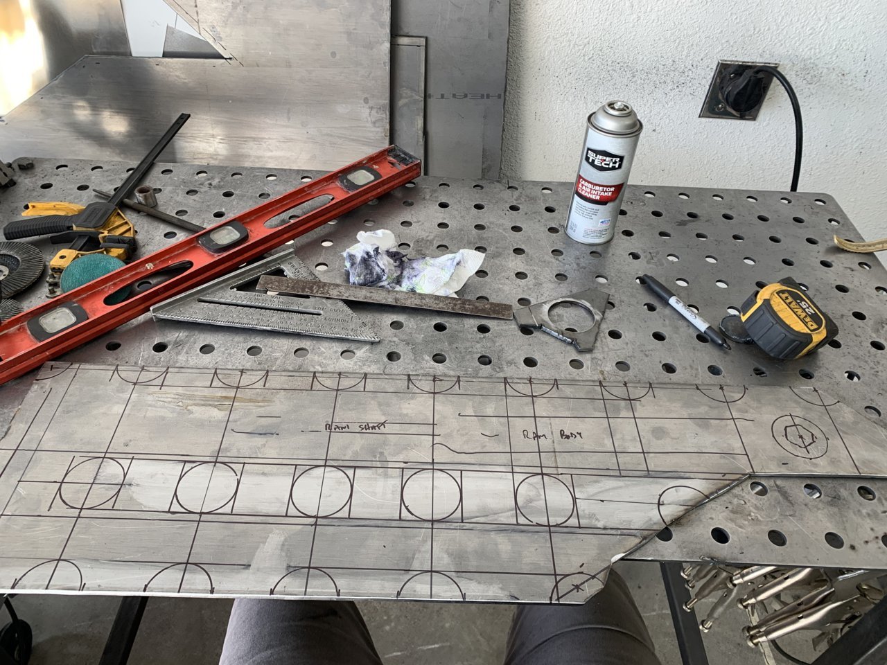

    the ram mount is super low. Doesn’t fit anywhere and want to be able to use the winch as a suck down as well so made a Ram skid. Just have to finish grinding to fit and then some dimples and half circles and it’ll be done

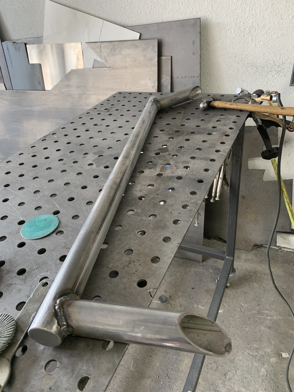

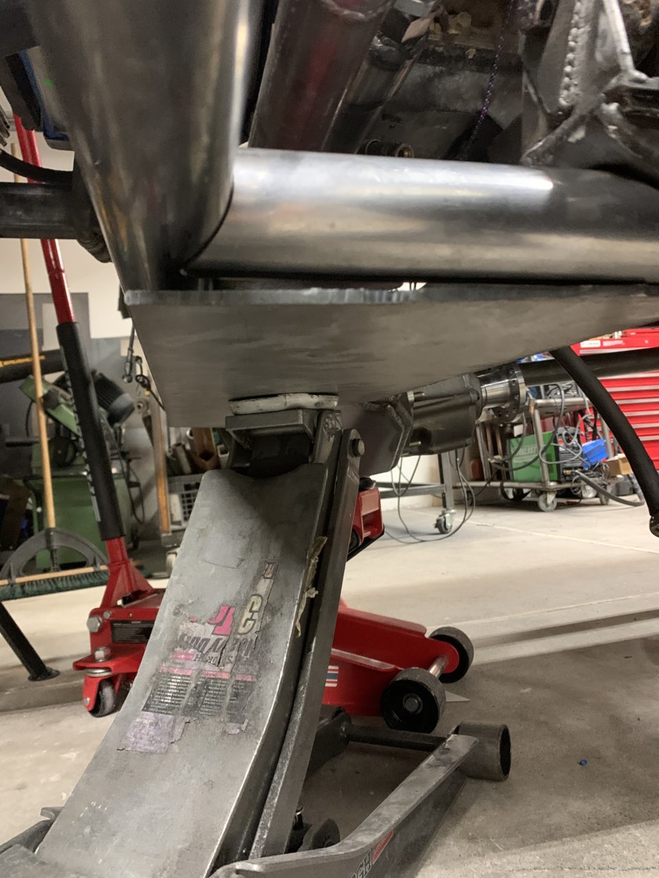

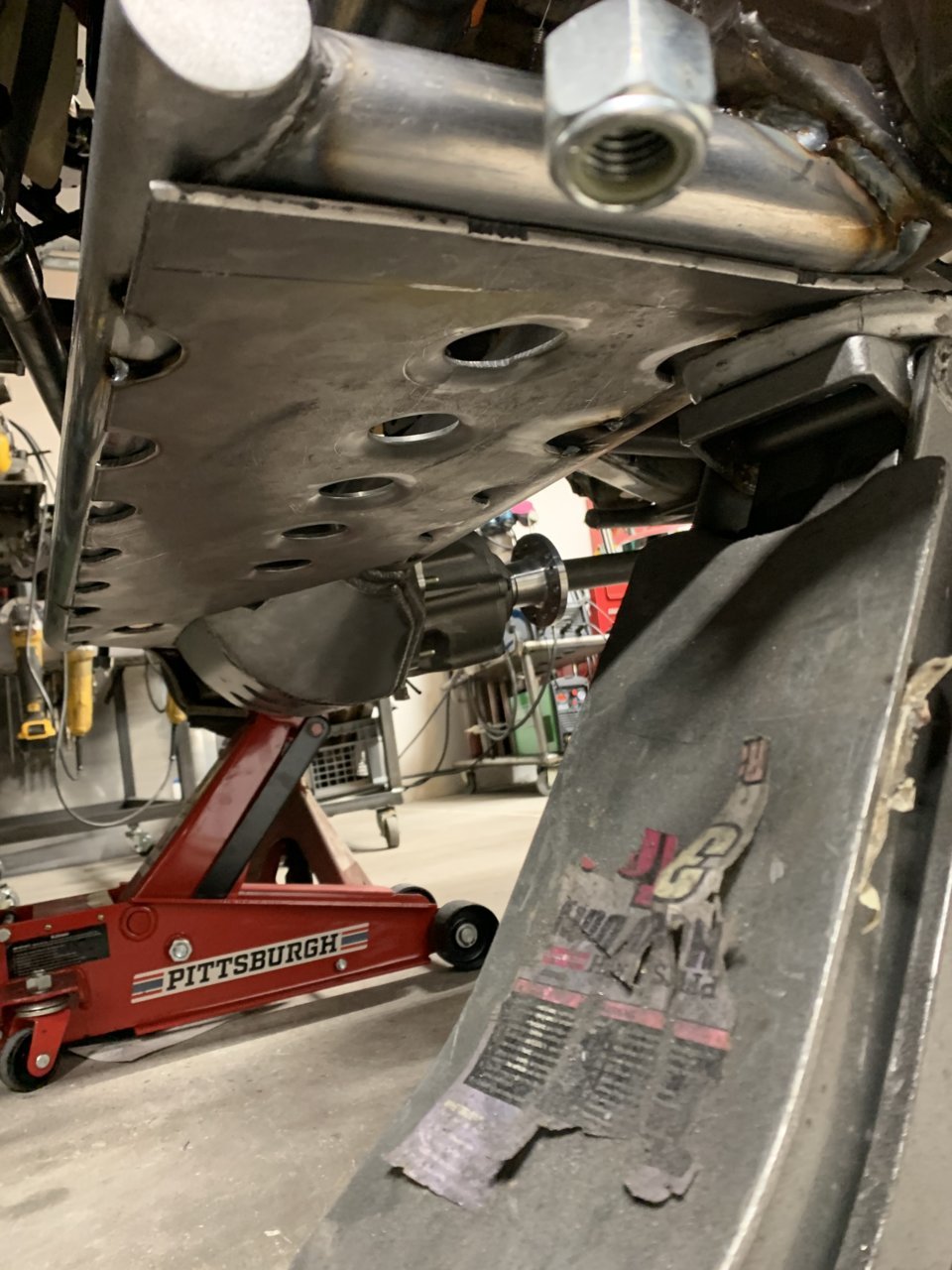

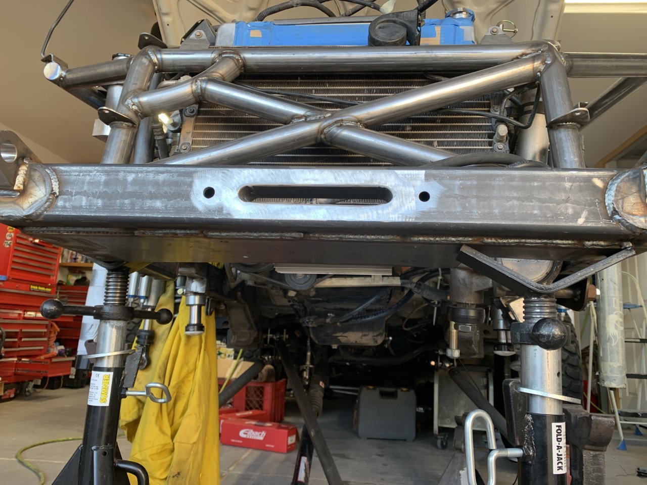

    Ram skid is done besides welding and hood pins in.
    front bar is 1.75x.120 wall and sleeved with 1.5x.25. Should be plenty strong and plate is 3/16 with 1.75 dimples and half circles.

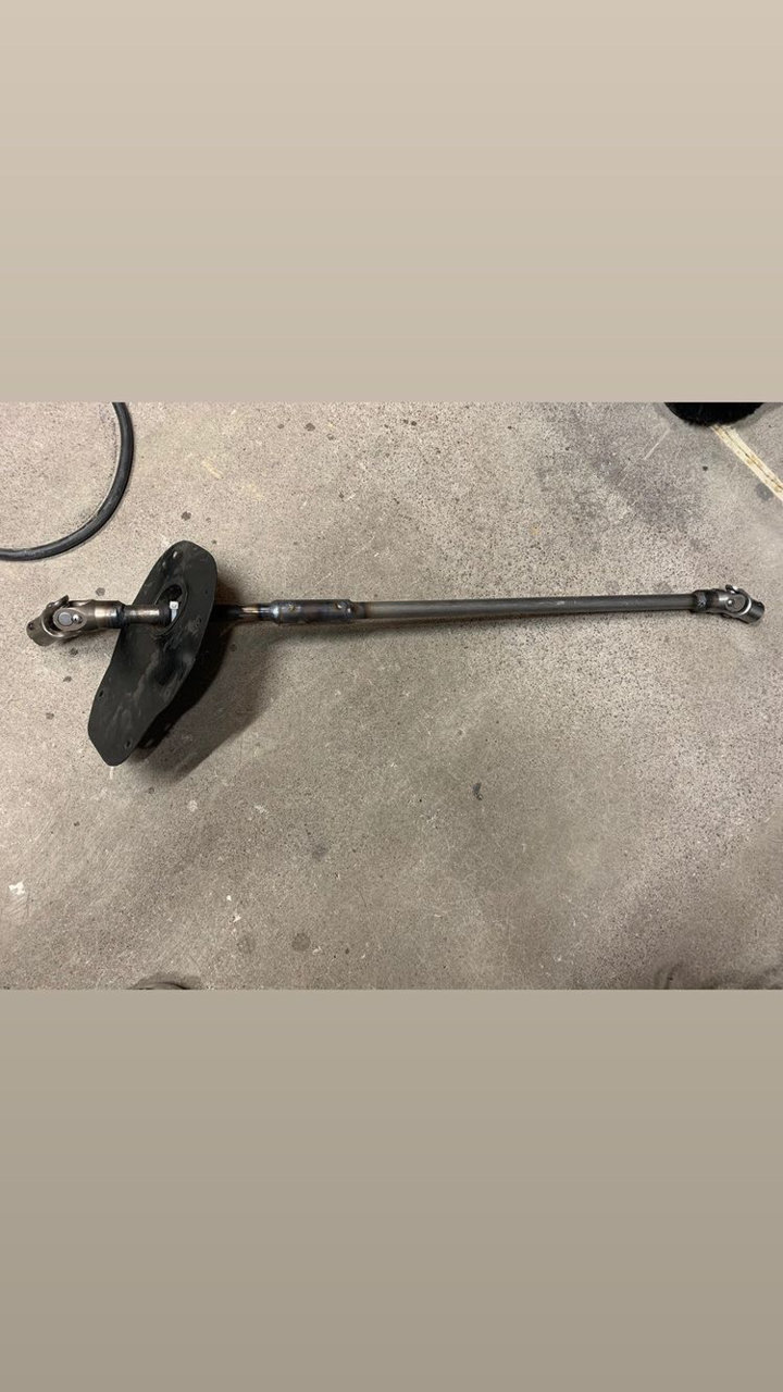

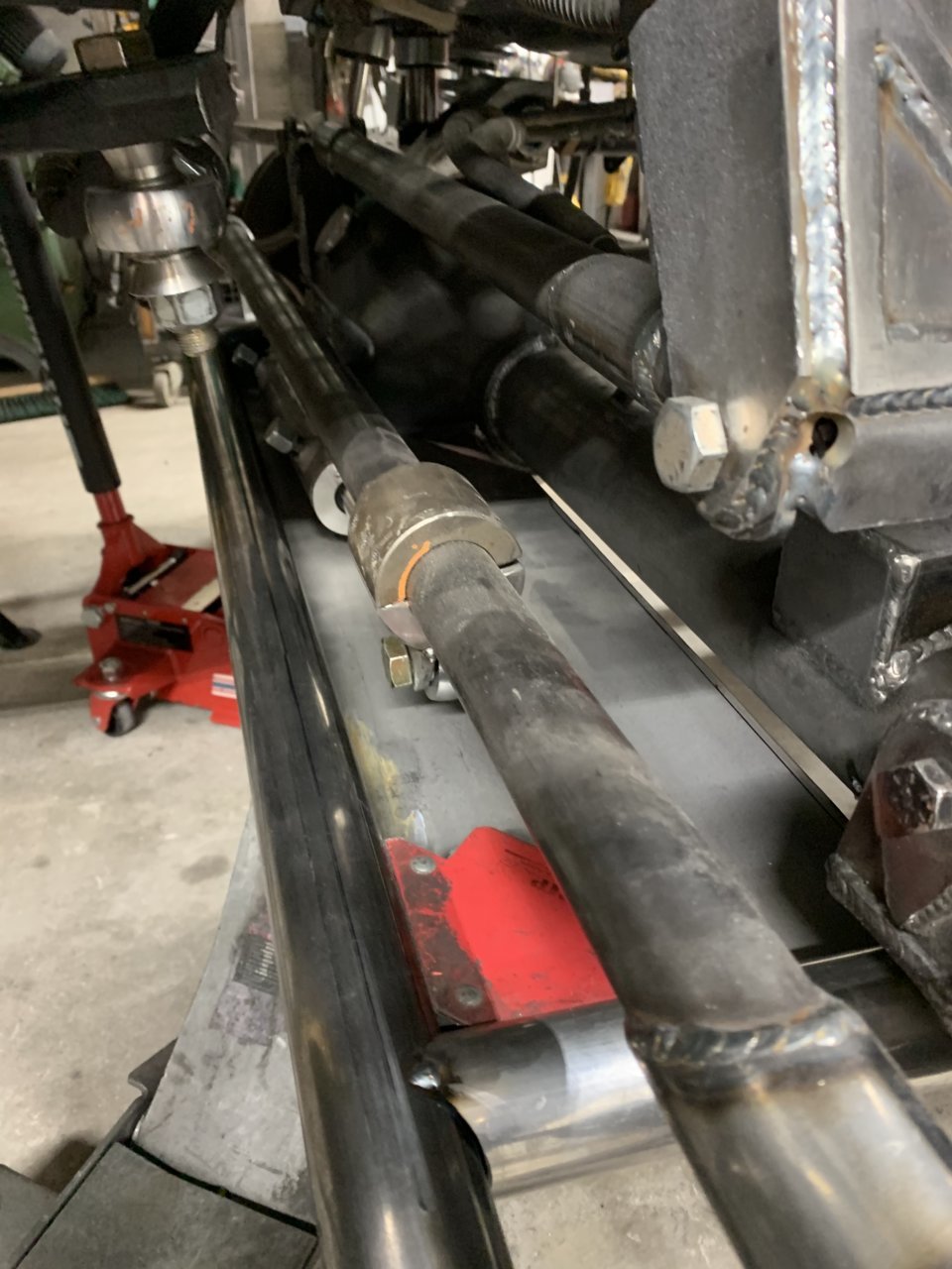

    Hammer slipped today.....
    Got all the steering lines plumbed, transmission cooler plumbed, steering connected. Going to pull the axle next and get it ready for paint.

    My dad had a 4x4 plasma table and cuts me things all the time but lives out of state now so I end up doing a lot of thing by hand... the outside and half circles I cut with my plasma. I tried the simple holes with a circle jig I made but I’m not steady enough to have a clean hold so I dd most with a hole saw. Time consuming but I think it was worth it

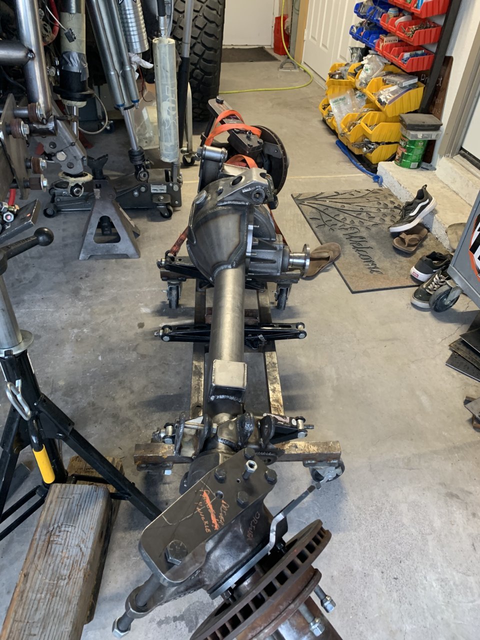

    Finger still hurts. But more done. Only a few welds left and then time for paint and reassembly. I did start painting some of the axle parts BEF9CF2C-69E8-482A-83FA-E290D85959F6.jpgF0873105-0912-49E4-91A4-88DB6F8512C9.jpg9E8F7A61-D484-41C3-8F28-EA5276369FCF.jpgBE59FA5E-DAA9-4874-9A2E-B8C70A0A016A.jpg14062D01-3CA5-4D2A-A297-63F2F7A3CFBF.jpg6F5DBCE2-6DEA-402A-8915-373679C4D240.jpg

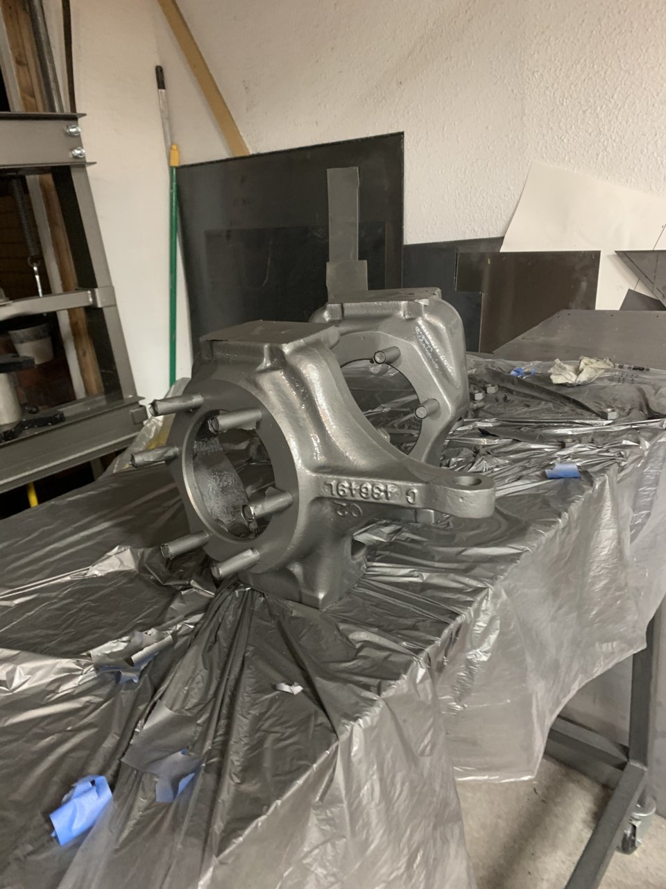

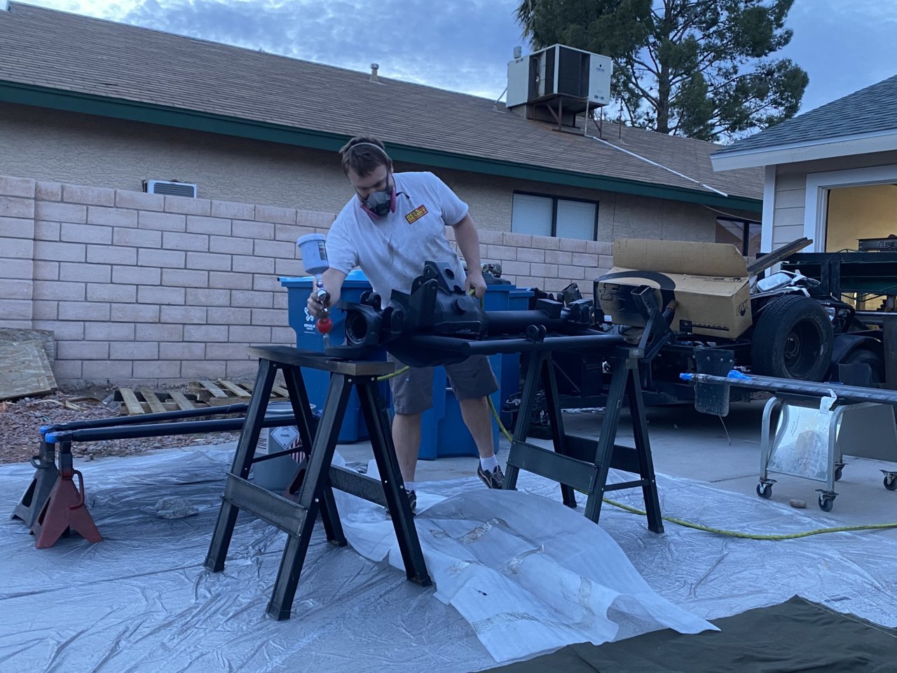

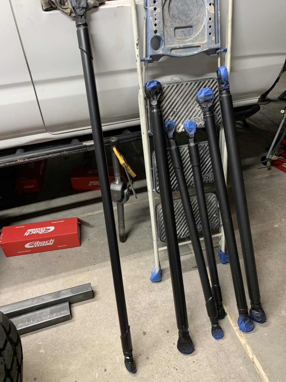

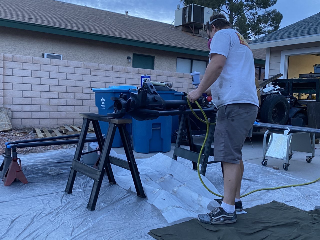

    Front axle and links painted. Got the gf out there to help rotate and move stuff. Steel it paint makes it look like I almost know how to paint haha D10EB88E-9F03-4DDA-804F-2DFE29616455.jpg2E7EC5D1-20AC-4266-B4A8-DA1967F509E9.jpg793433CC-27AD-47F1-A68C-36397EF9C358.jpg11517862-5B45-44D7-8A65-33302DCD6EE0.jpg

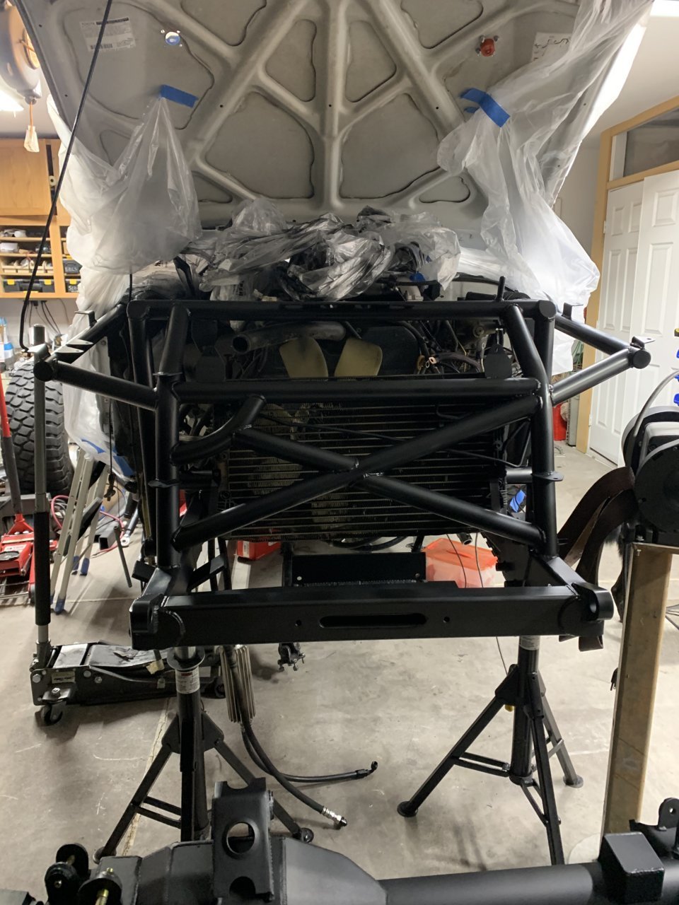

    Frame is painted. I start assembling everything tomorrow hopefully 630638F4-C8BE-4D2F-A6C4-874E37CC4545.jpg8E5C6BE1-ABEC-4A65-BC4A-F5A6EC603916.jpg
