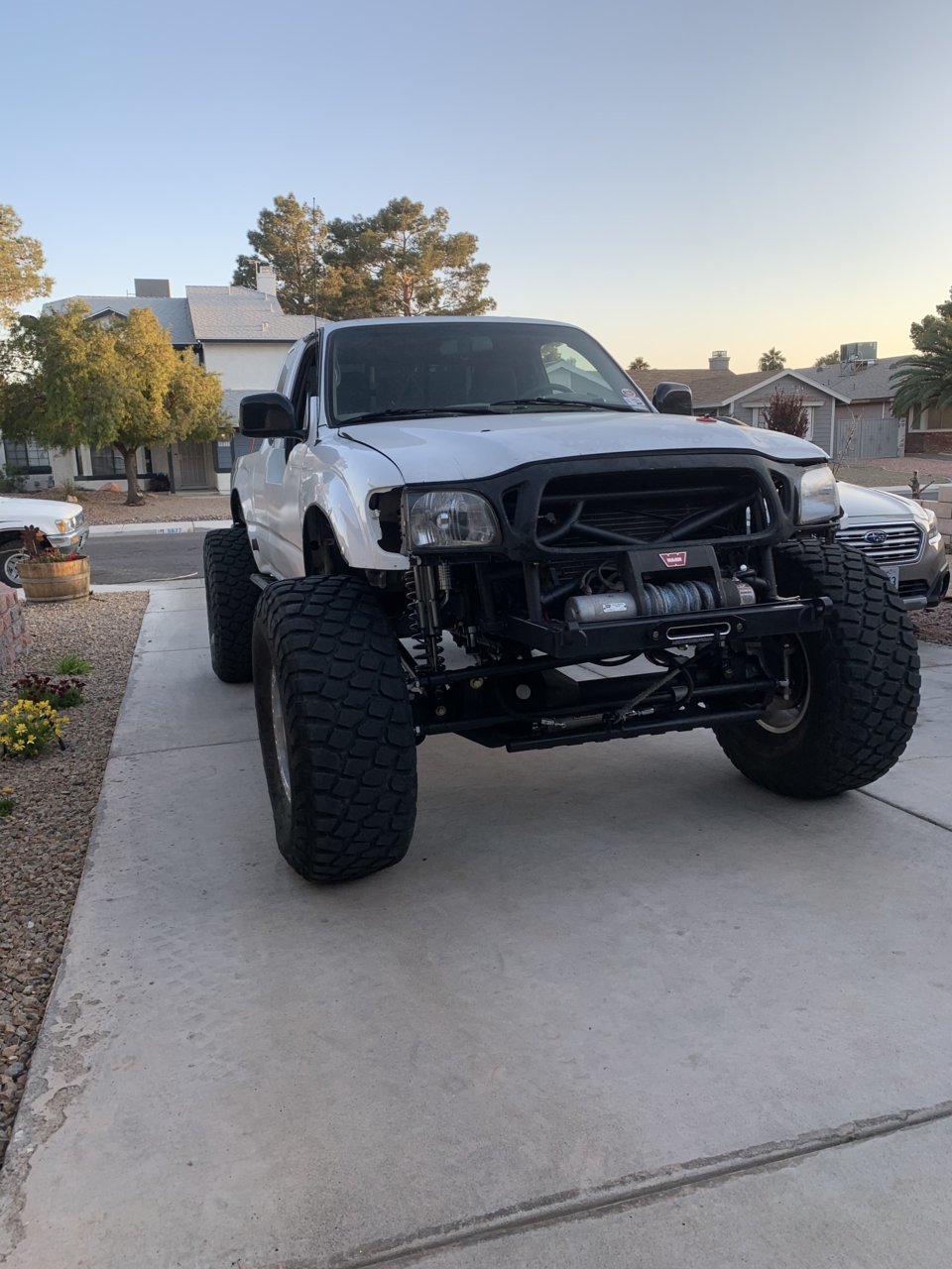

    Time to see how this thing does. Had the castor/pinion angle way off in the other pictures so fixed that and just buttoned u a lot of thingsD7BE90C7-C22F-4ED4-BF60-3925123CA604.jpg CF9BDEAA-1519-4349-8478-E5FB21305946.jpg

    So what's your caster/pinion set at now?
  17. Mar 29, 2021 at 9:17 PM
    #1437
    malburg114
    malburg114 [OP] Well-Known Member
    Dec 26, 2012
    #93766
    3,819
    Las Vegas, NV
    2001 Toyota Tacoma TRD
    Same. 7.5 and 7.5. One or the other has plus or minus .25 in. Forget which one I gave more.
    Drives really well considering it’s on heavy 39s at 8-10 psi with a tired automatic transmission.
    Got it up to 75 today with the tires at 8-10 and no bad road manners or while driving through town. Toes a little off I think as they squeal a little in the corners but could just be the low tires too.
