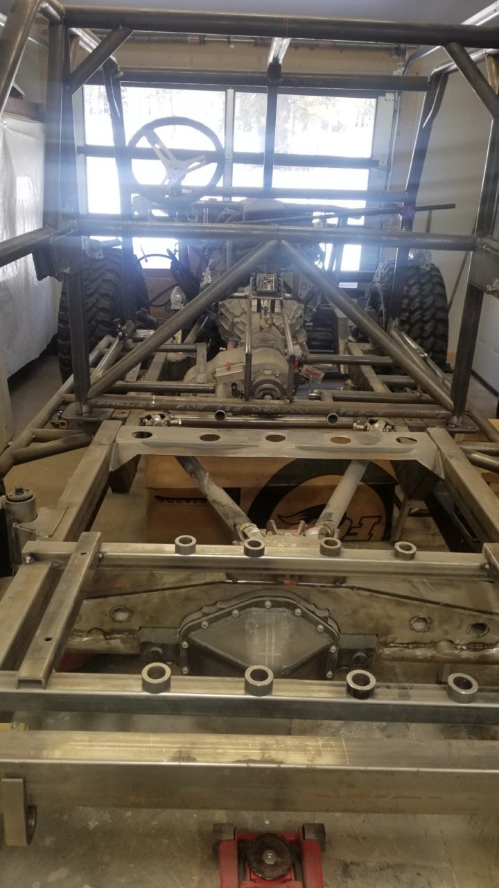

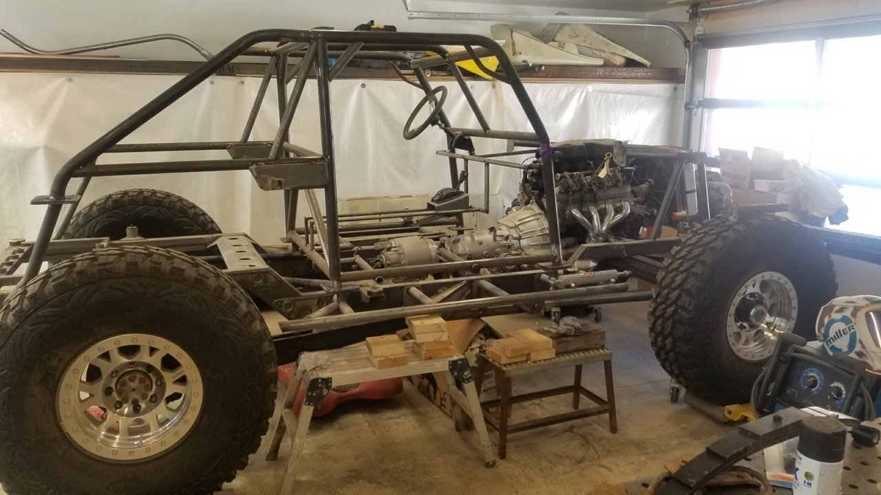

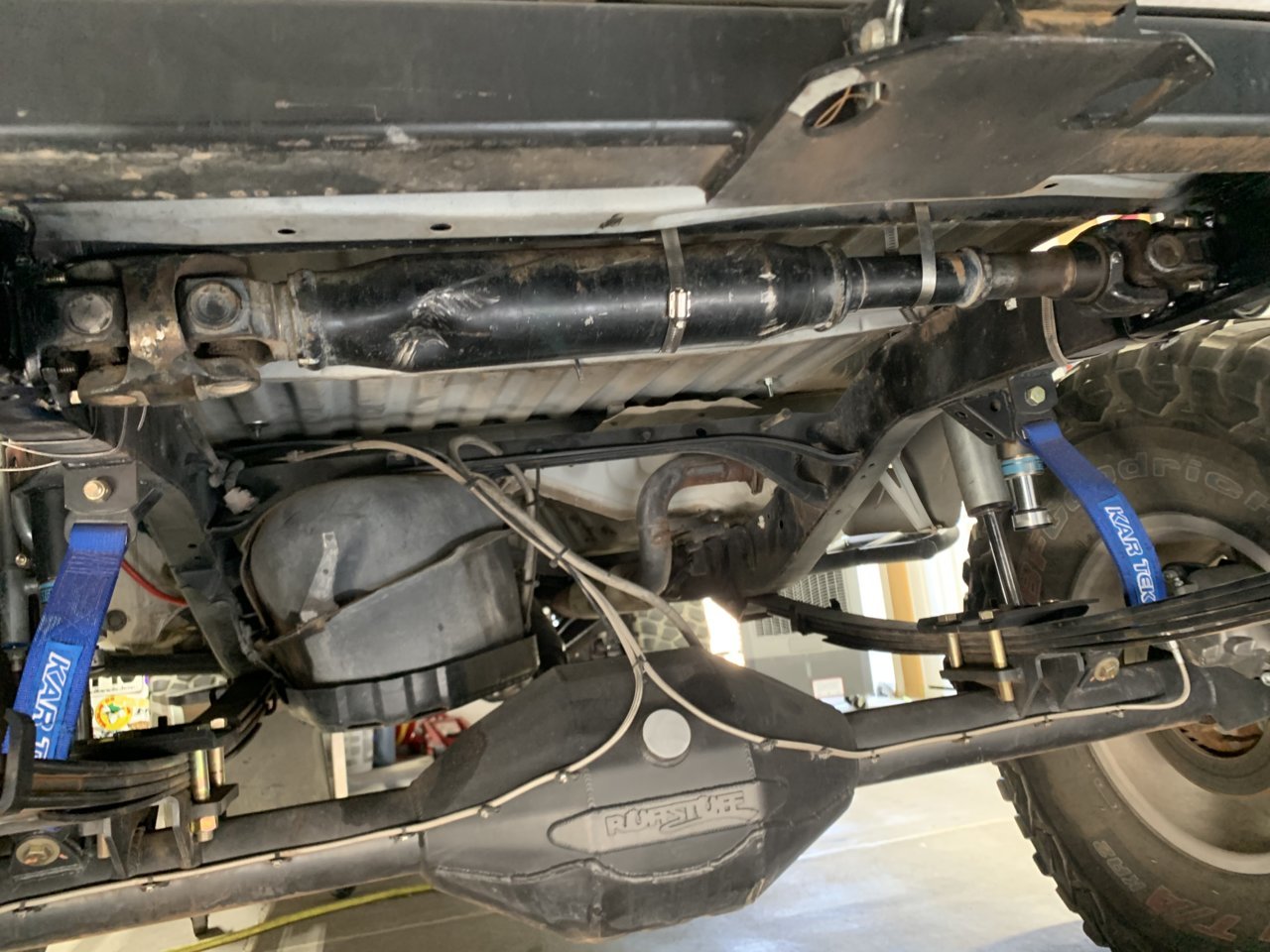

    Pictures of the jeepster with the body off. Some floor skins and door bars and he could wheel with no body haha481CD37A-C1D8-4CF3-B58D-2C699390879E.jpg9E859ECB-E470-4A04-9026-18BCAA5F10D0.jpg

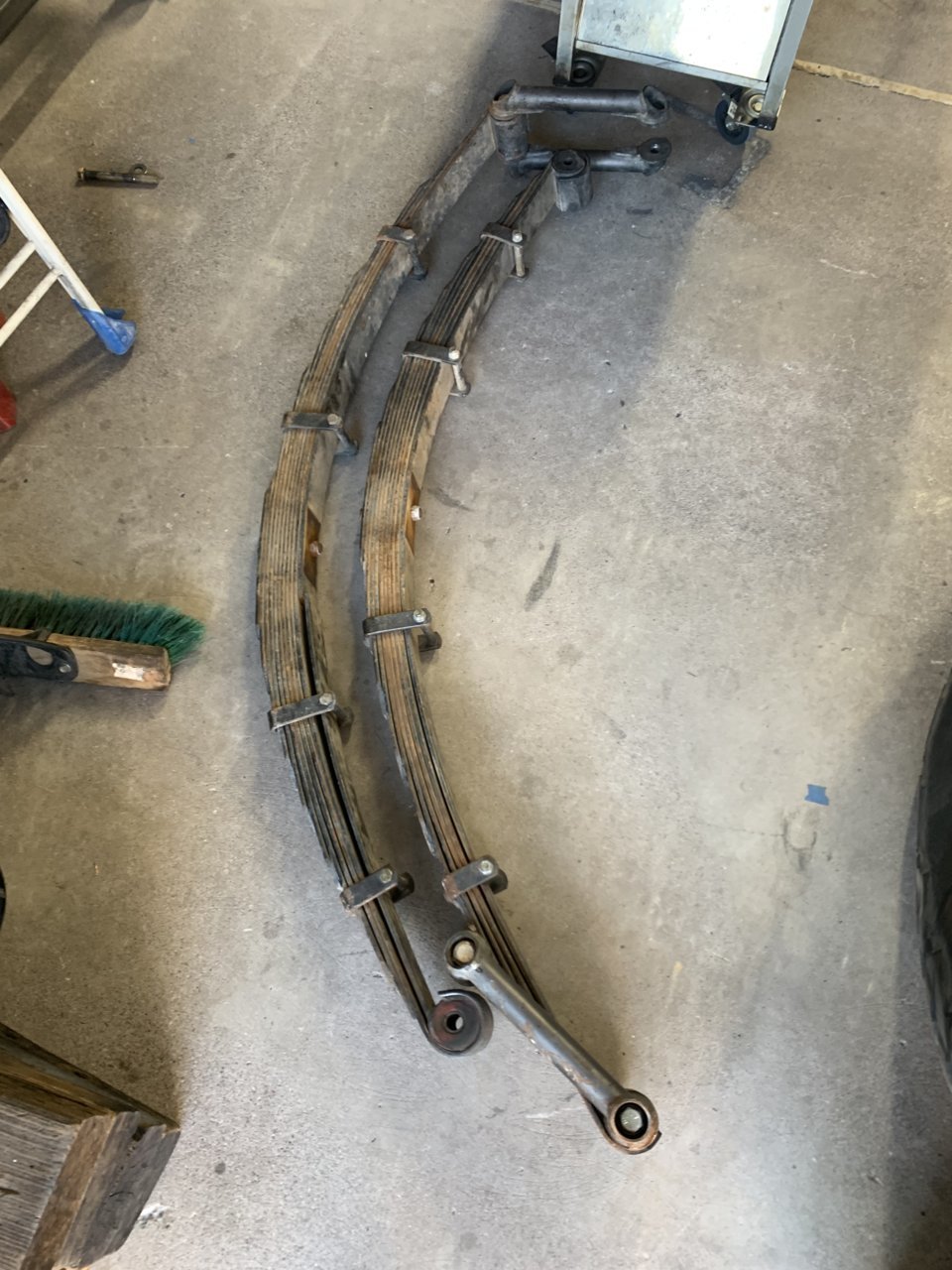

    Picked up a set of deaver 62 in leafs. One of the mains is broken but will
    Pull the pack and put it under my main leaf. Should work well FE6236EF-C0F5-45C4-A674-6222B3E0C810.jpg

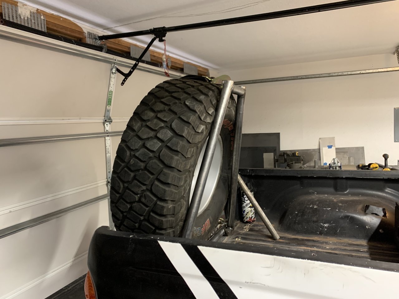

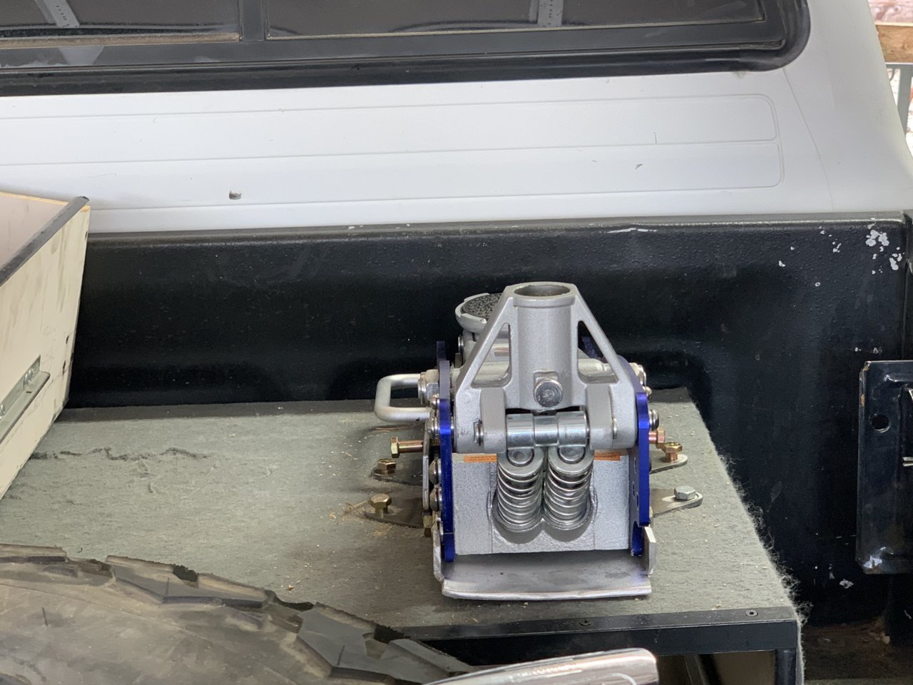

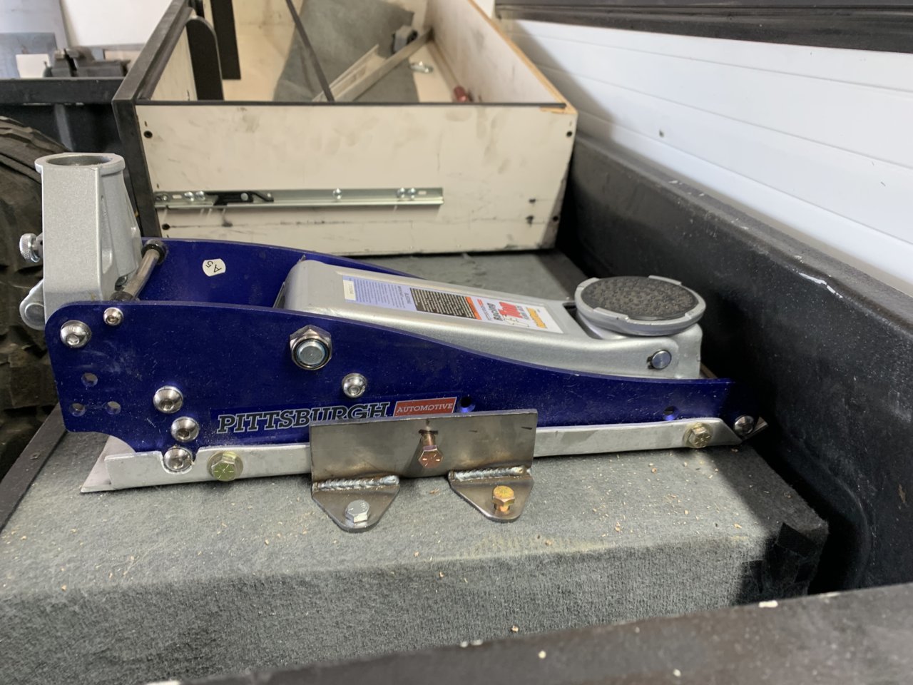

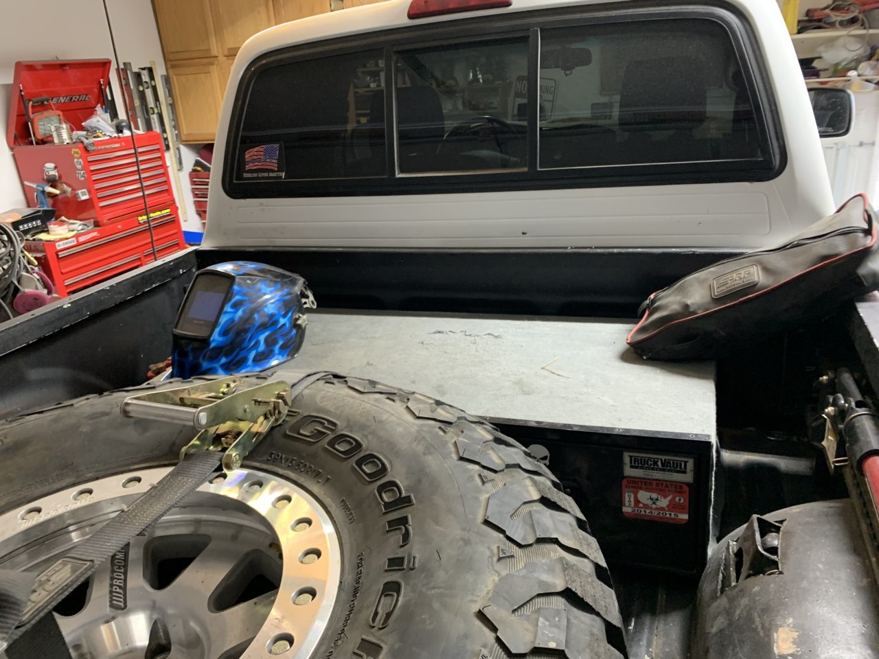

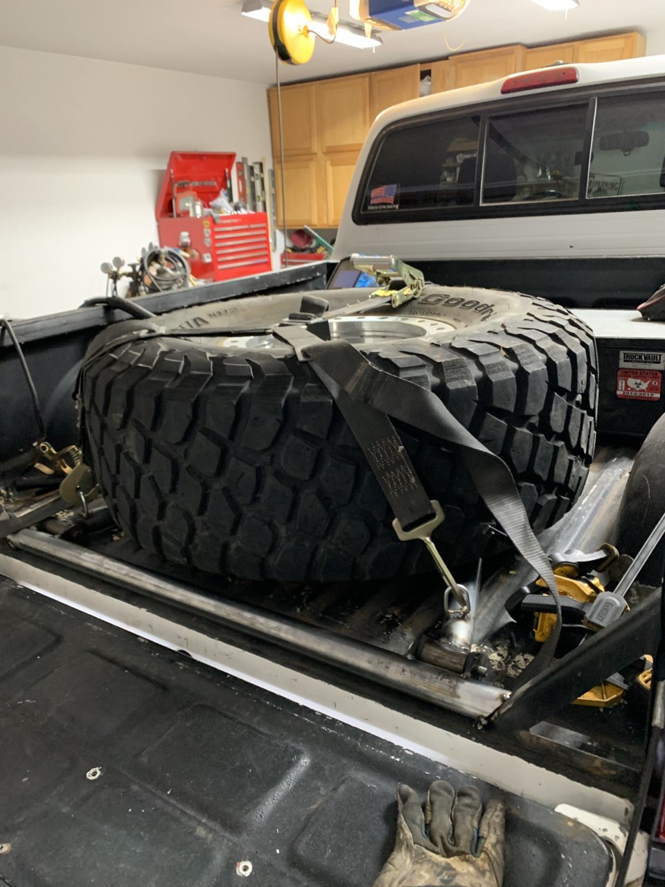

    Spare tire rack done. Pivots up out of the way so the drawer can slide out of the new box. Jack is mounted on top and will mount the cooler and probably a bin in the middle. Keeping it simple for now on the spare tire and using a strap to hold it down to the bed and another to hold it open while tilted back. Just need to fix the hydro assist clamp and it’ll be ready for rubicon. Also got most the templates for the center console done as well.

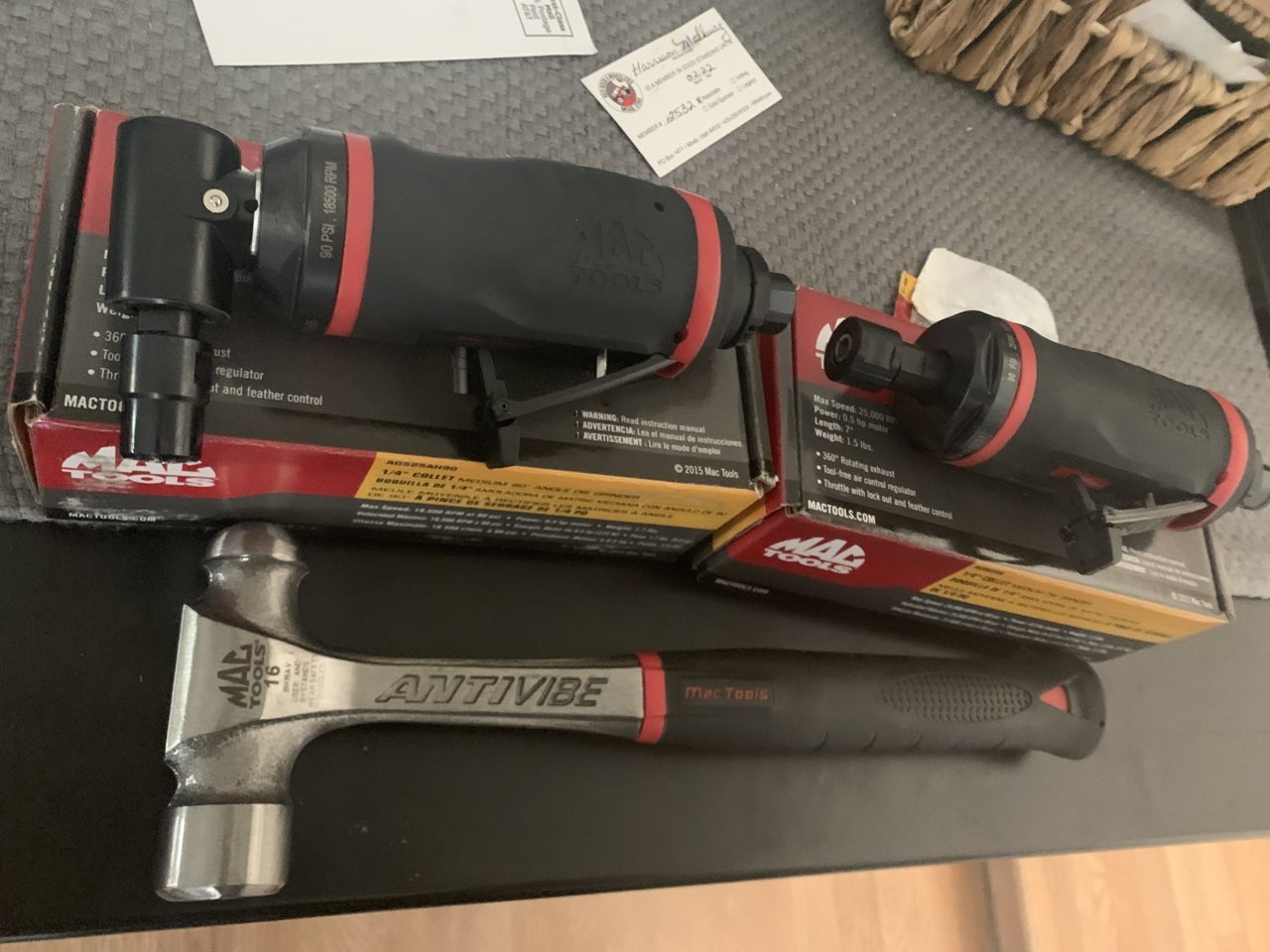

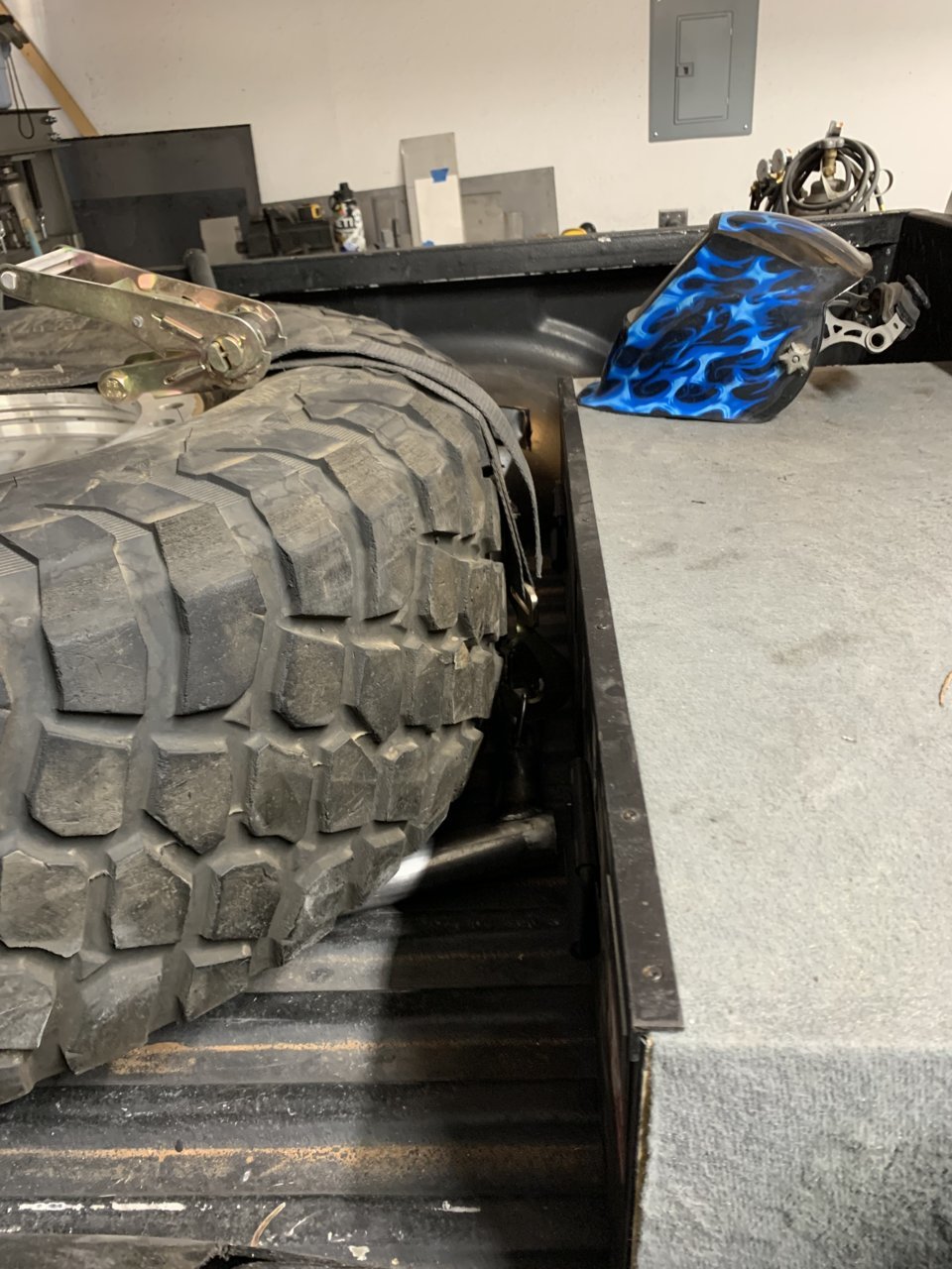

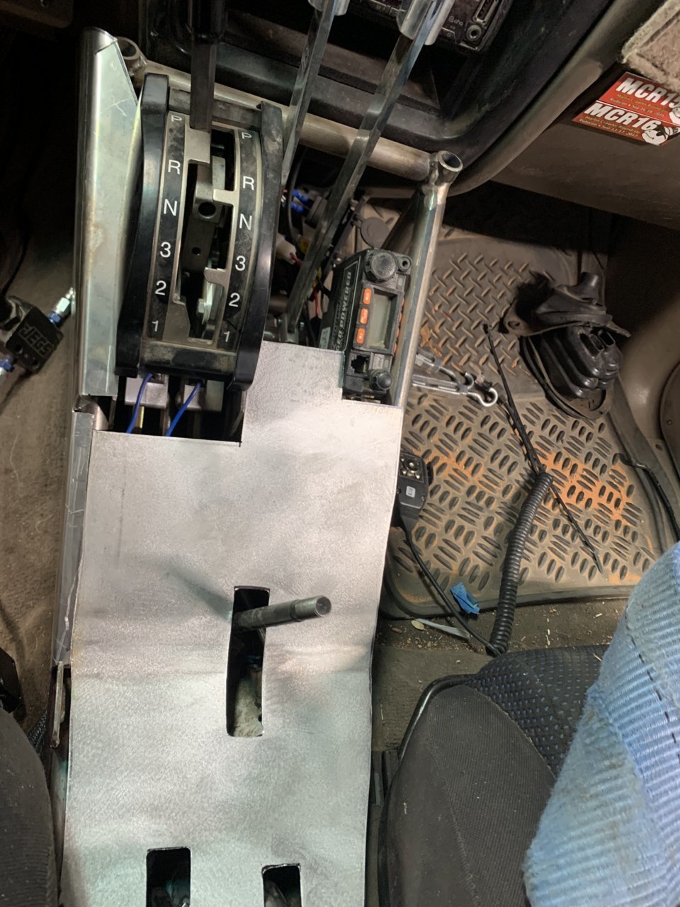

    Little things done. Spare rack is done besides paint. Box is loaded with parts and tools. Tie down points on top. Just need to paint and bolt in the jack mount. Also welded in some studs between the rear frame for my spare driveline. No more bouncing around in the bed. And started on the center console skin.
    DF549090-5848-4062-8AA8-9C1097D7CAA7.jpg 06EB03FC-D2F3-4673-9E9C-69FDC430F867.jpg

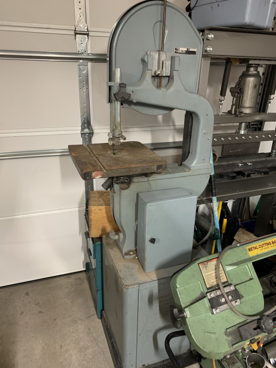

    2001 Toyota Tacoma TRD

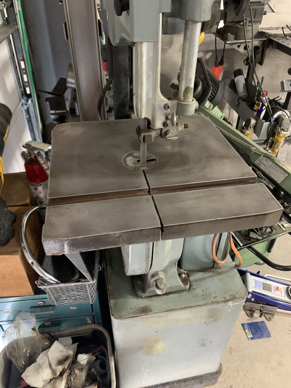

    Old tools are my favorite. New vertical metal bandsaw. Cut the center console skins like nothing. Should be useful to have

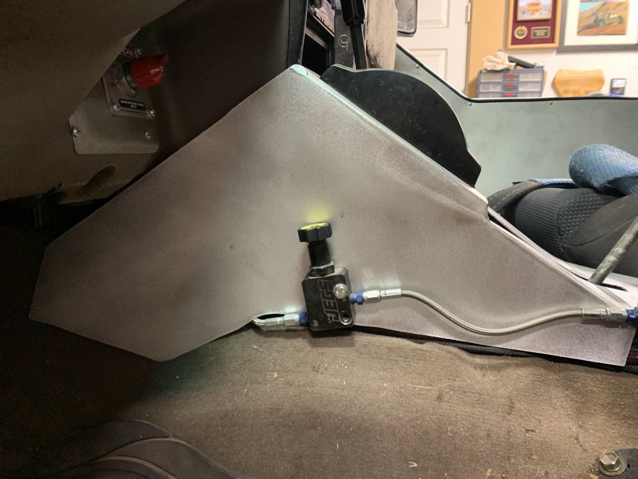

    Las Vegas, NV

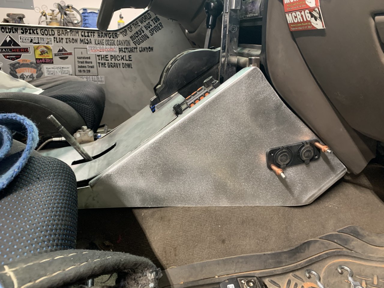

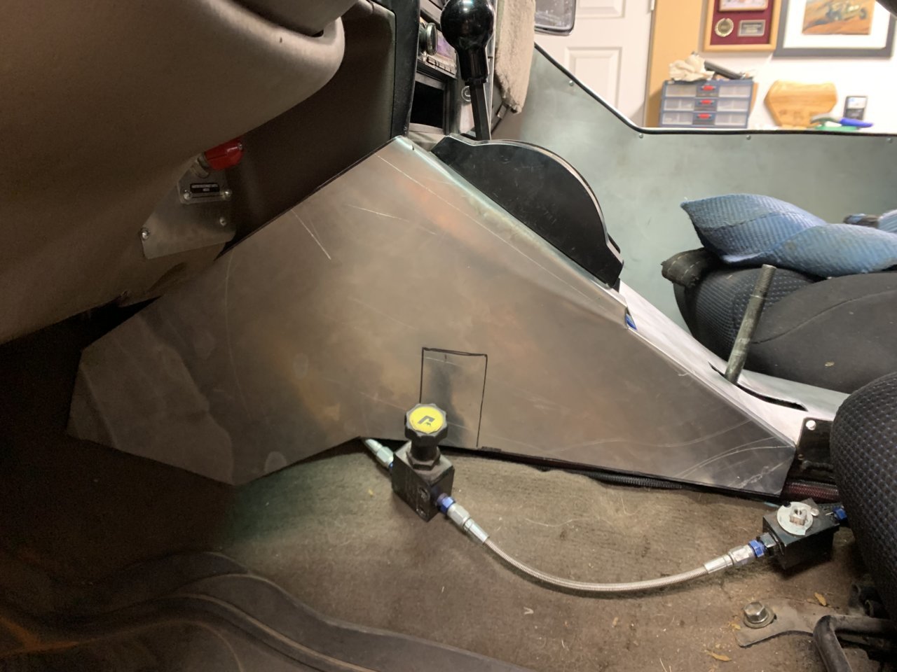

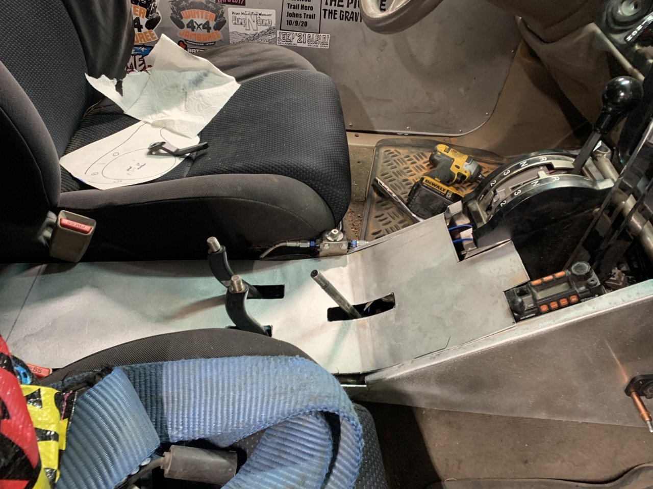

    Another panel kind of done for the center console. Sheet metal work is no joke. I’ll have to learnt to tig to clean I up and I’ll put some dzus tabs later on AC8AC722-9AE4-4787-84AB-5956DA53B178.jpg49CF0B98-857B-41EA-8F9C-377503620B65.jpg

    I have some threaded trick tabs and a bunch of dzus ones. I have a transfer punch for the dzus so think that would be easiest to mark the blind homes is the main reason.

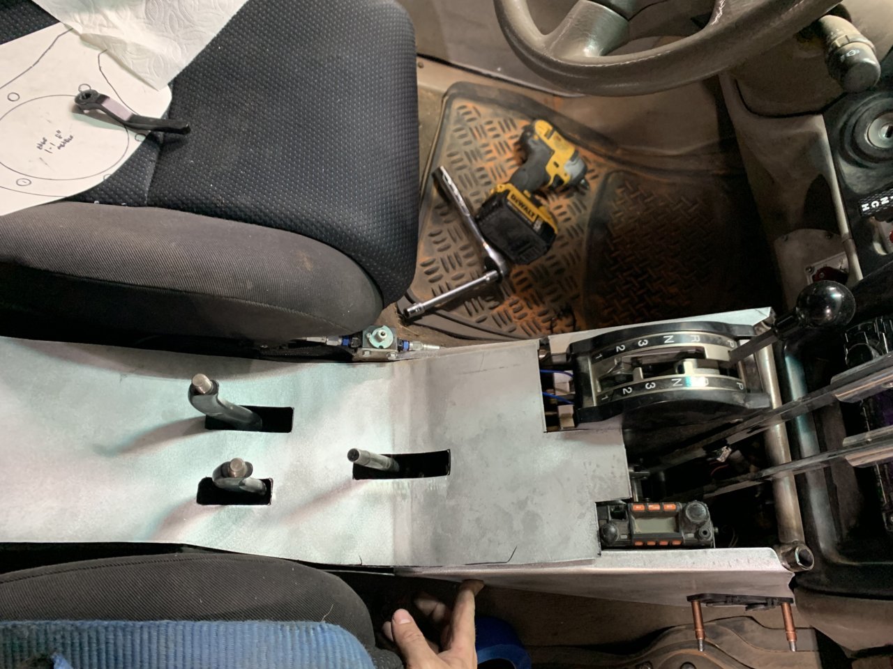

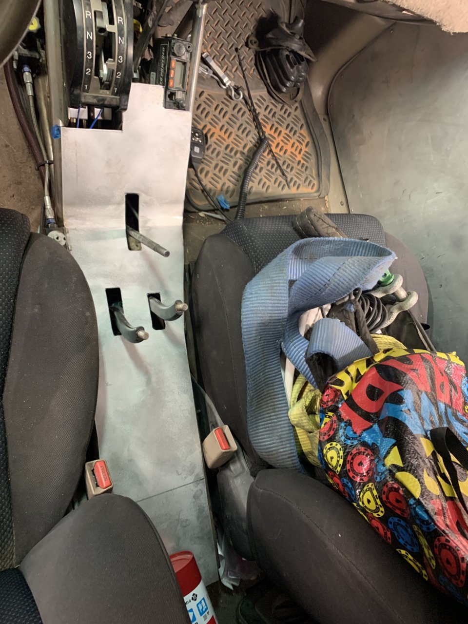

    Props to anyone whose good with sheet metal work. It’s hard and time consuming. All panels roughly fitted to get by for the rubicon. Need to practice tig welding to scab some pieces in and clean it up and then I’ll mount some dzus tabs for it
