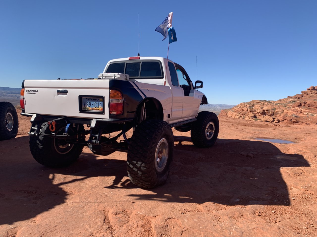

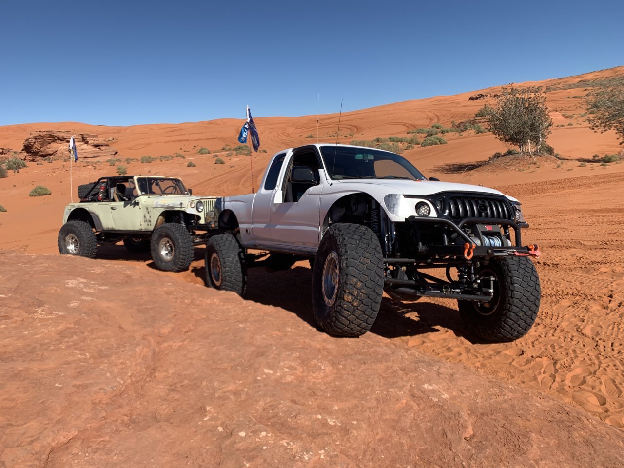

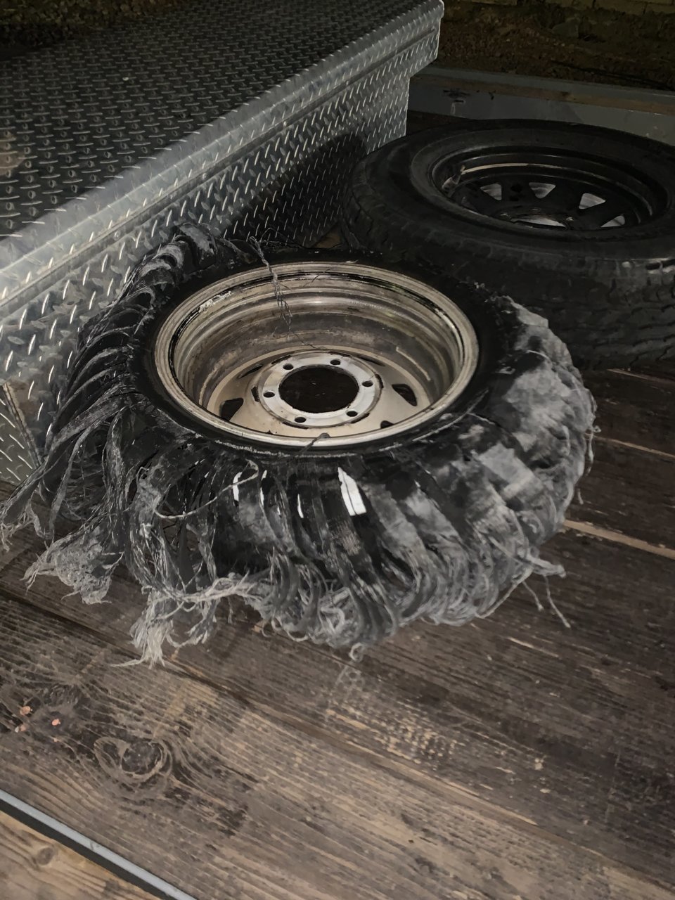

    Sand hollow is always a good time. Another day trip. Trailer tires are only two years old and had 3 separate and got a blow out on the way home.. sucks cause it took out the trailer wiring too

    Half the reason why I don't trailer my shit is it seems like my truck is more reliable than a tow rig and trailer! I had people bail on a trip last weekend because their tow rig broke down on them. Awesome pics as usual!

    that tire.... shits still got some life... :bananadead:

    I wouldn’t mind driving the Tacoma to the trails. But it’s slow, loud and tires are expensive haha. That’s my 2nd blow out/flat on a trailer in 7 ish years so I’m not to mad. I even caught it before the trip but discount doesn’t have any to swap under warranty as they’re all in Georgia so kind of my fault. I replaced the worst one and noticed this one in the way home but thought I could make it. Plus 75 with cruise set and my favorite station with no struggle is nice. And I can wheel hard without worrying about getting home haha

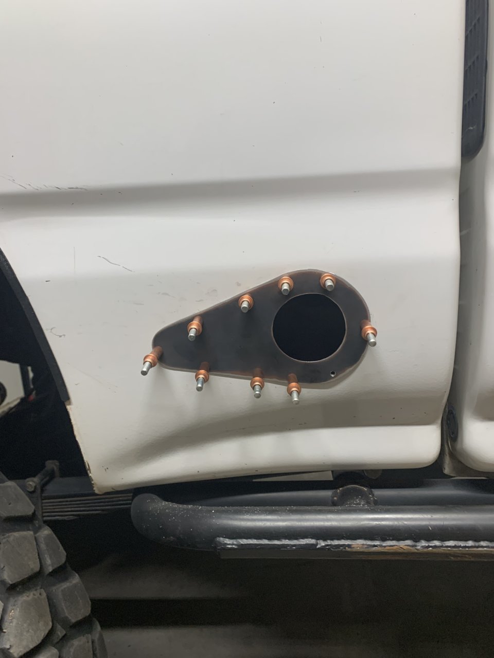

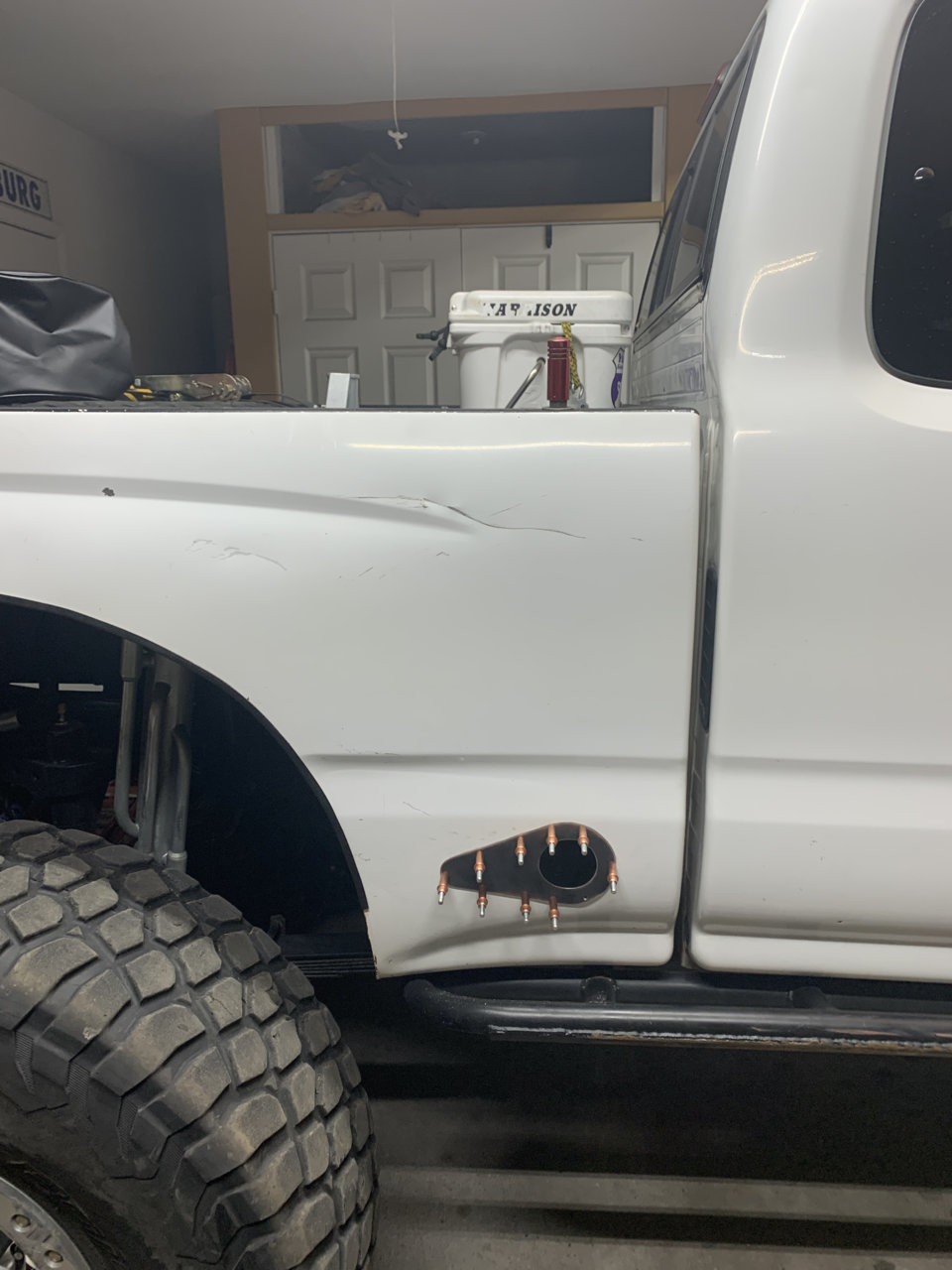

    Actually made something for it today 47BA5109-202E-4DA5-BAC1-EDE564FCA623.jpg8D1277DF-8D62-4313-B541-328DB9FC389C.jpg

    Race truck

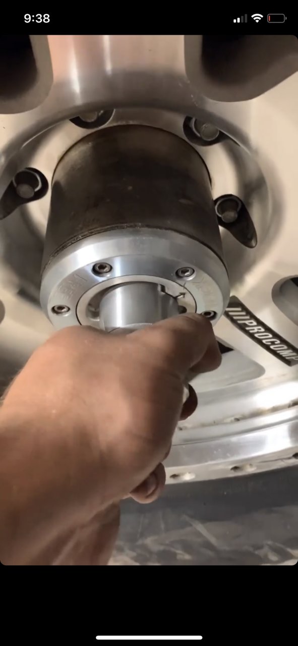

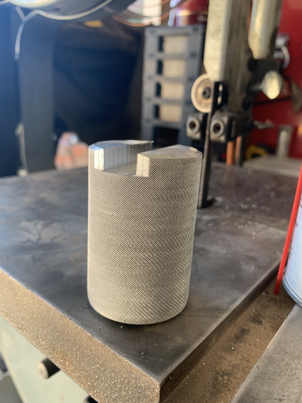

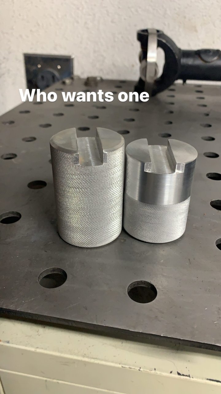

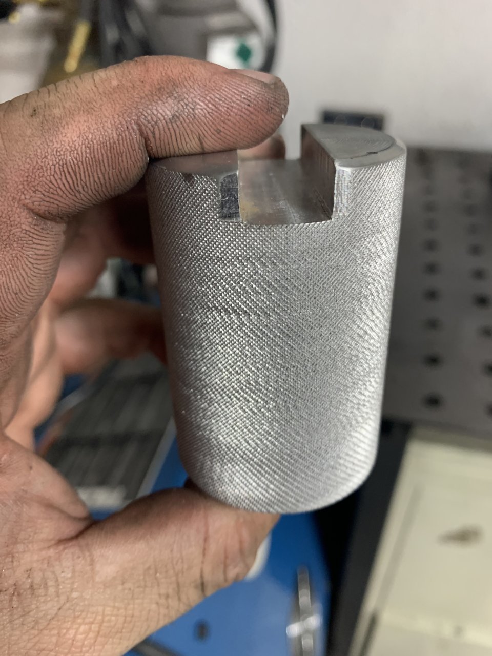

    Made a cool tool today. The driver side hub sticks and I have to use a crescent wrench and screwdriver to rotate it. Knurled some aluminum round bar with a slot for the tab and now it’s no issue 276C8DF8-F8E3-4555-933E-EDC29216A910.jpgA0D80E77-3DCB-4307-A764-7ED984FB928B.jpg5DE5022A-1A80-4F71-8DFE-FC2DB3A47577.jpg63960B1A-9048-448B-84E7-852E854E62FF.jpg

    1,810
    Price? I don't think I'll ever need one tho.

    Had a few people message me about them. I’ve been telling em 60 shipped. Let me know if you really want one as I need to make 4 today.
    had someone mention they’ll use em in the winter when the hubs freeze up which I thought was a good idea too
