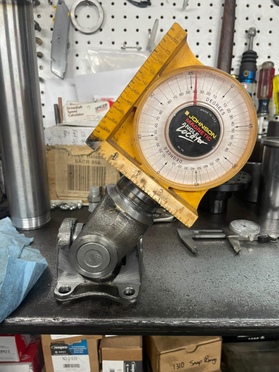

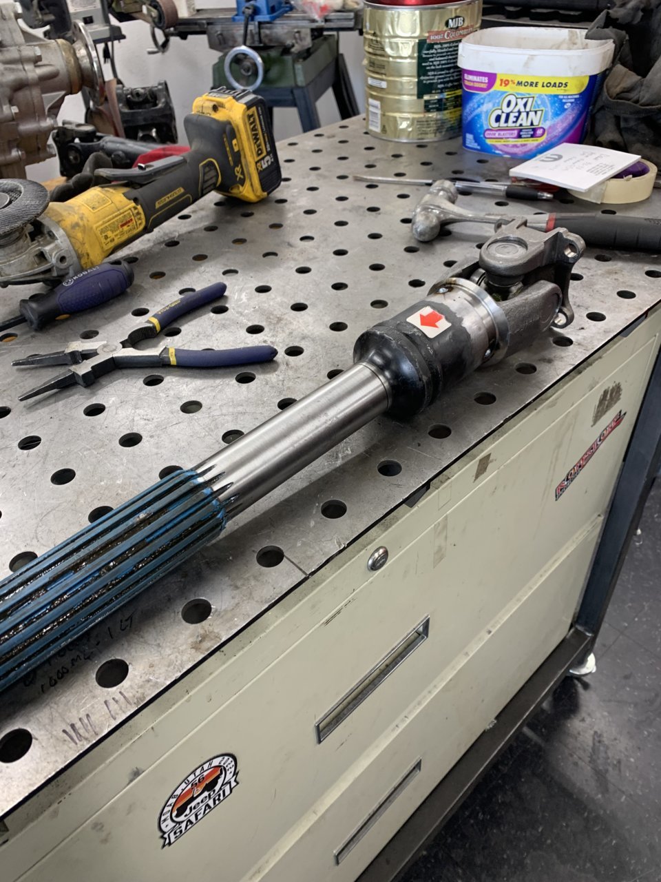

    Messed with the driveshaft some today. Got the cv cut off, single u joint end tacd on. With the slip at the axle end, it still binds bad. Talking with driveline tech in hurricane and he was messing with a trail gear slip and realized they get 40 degrees of angle so flipped it and it was closer. With some grinding I ended up getting 49 degrees out of the yokes and u joints move freely. I’ll finish welding it tomorrow and see if it works.
    I’m hoping it does or else I’ll have to limit the travel till I can afford a high pinion. A 14 in limit strap (16 in currently) will work but it translates to a lot of lost travel so that’ll be my last option.

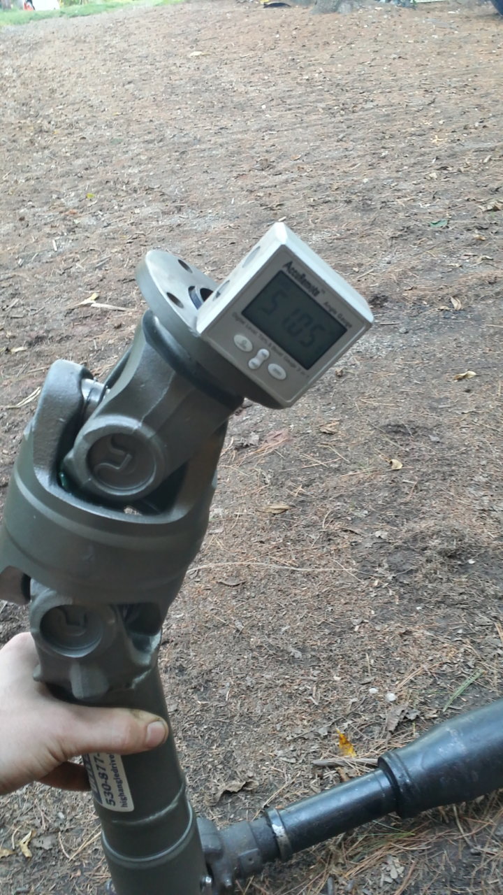

    High Angle CV head too long, or wait too long?
    Did take quite awhile but I coughed up for the 49* CV front.

    Yep I can grab some measurements later today, pics make it look big but don't think it's too long.

    Measured tonight, 7.5" in Length, Roughly 4.5" width.
