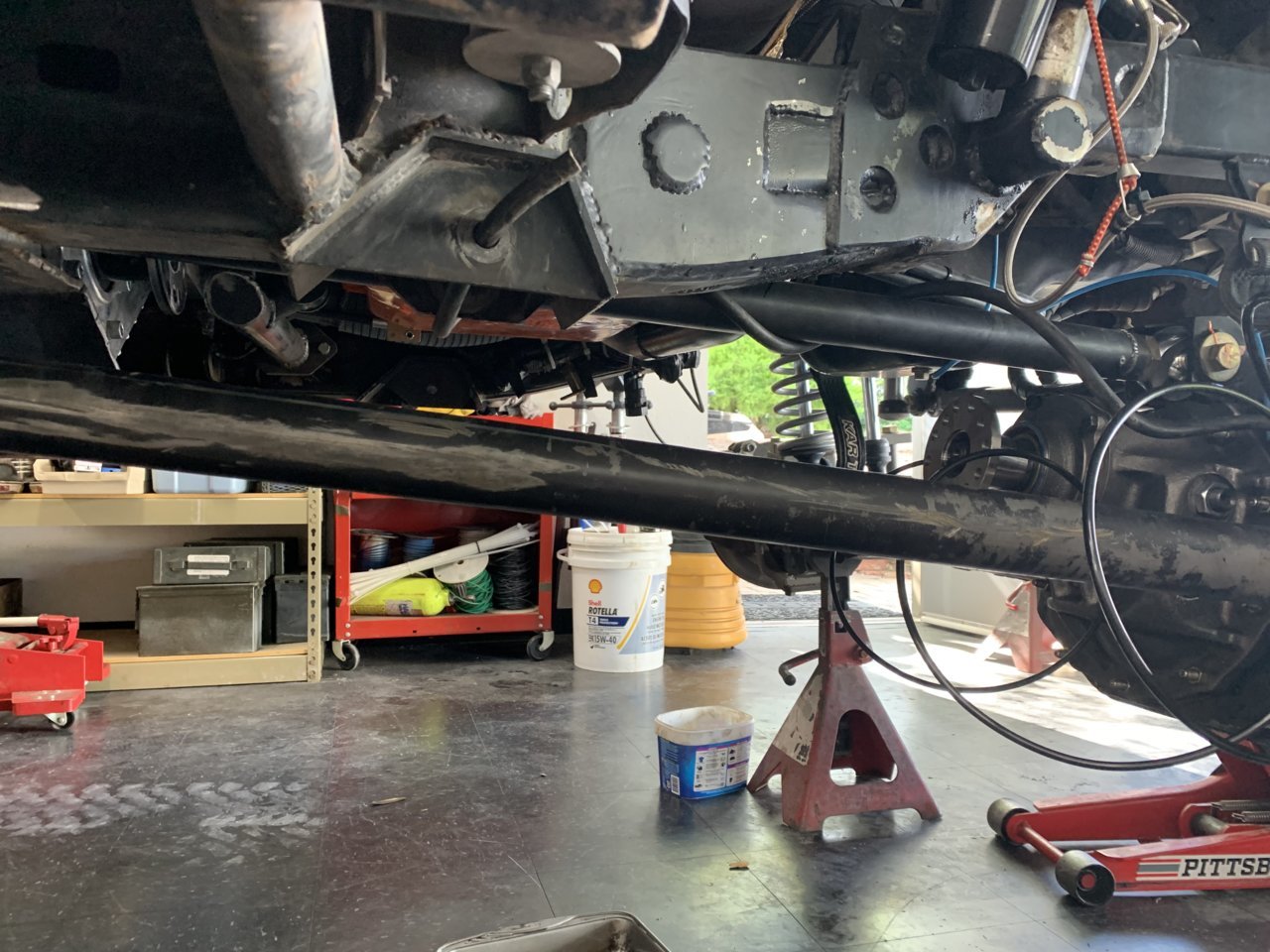

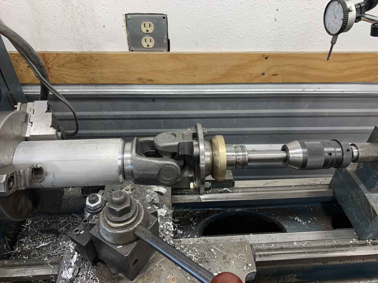

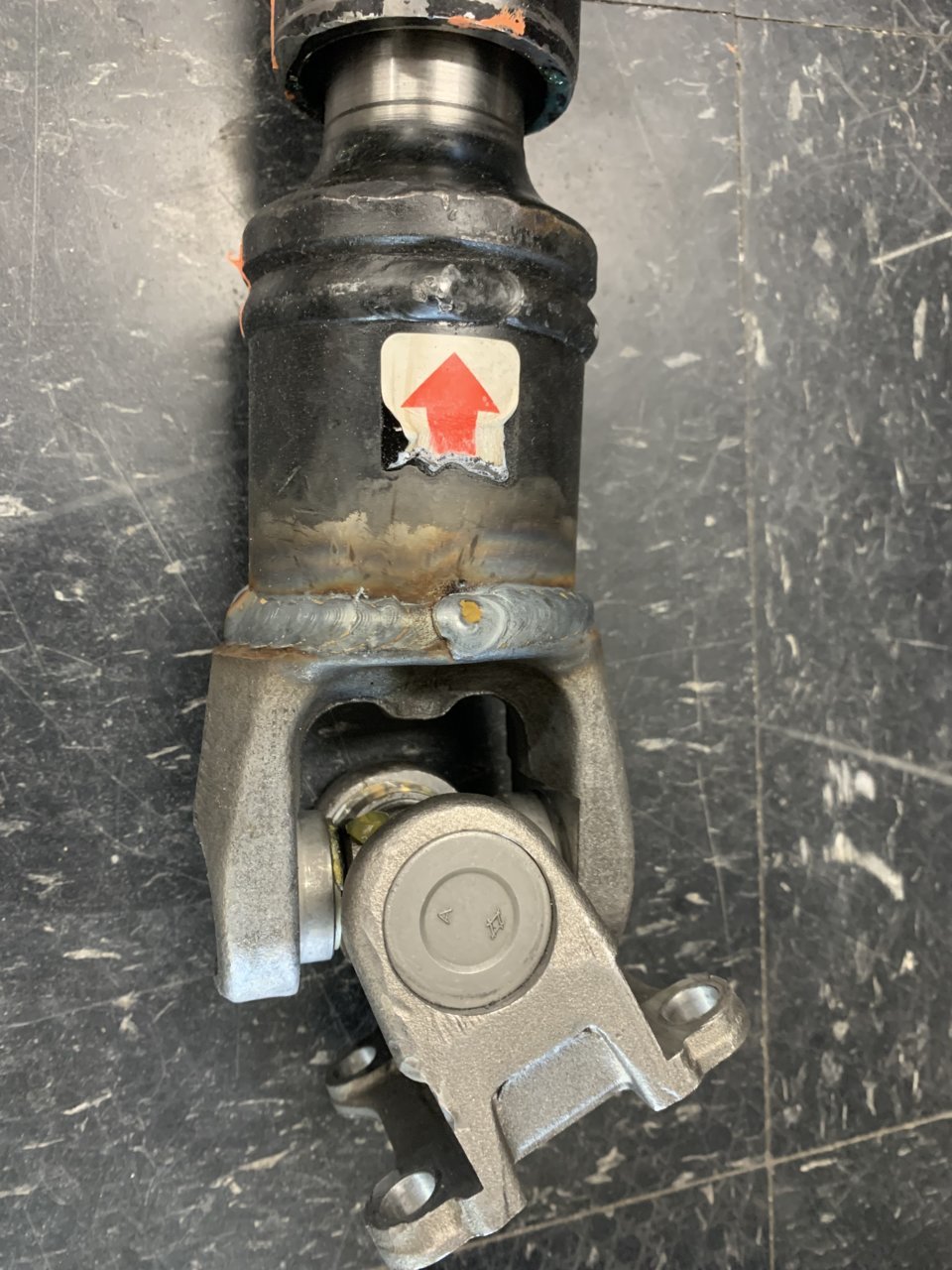

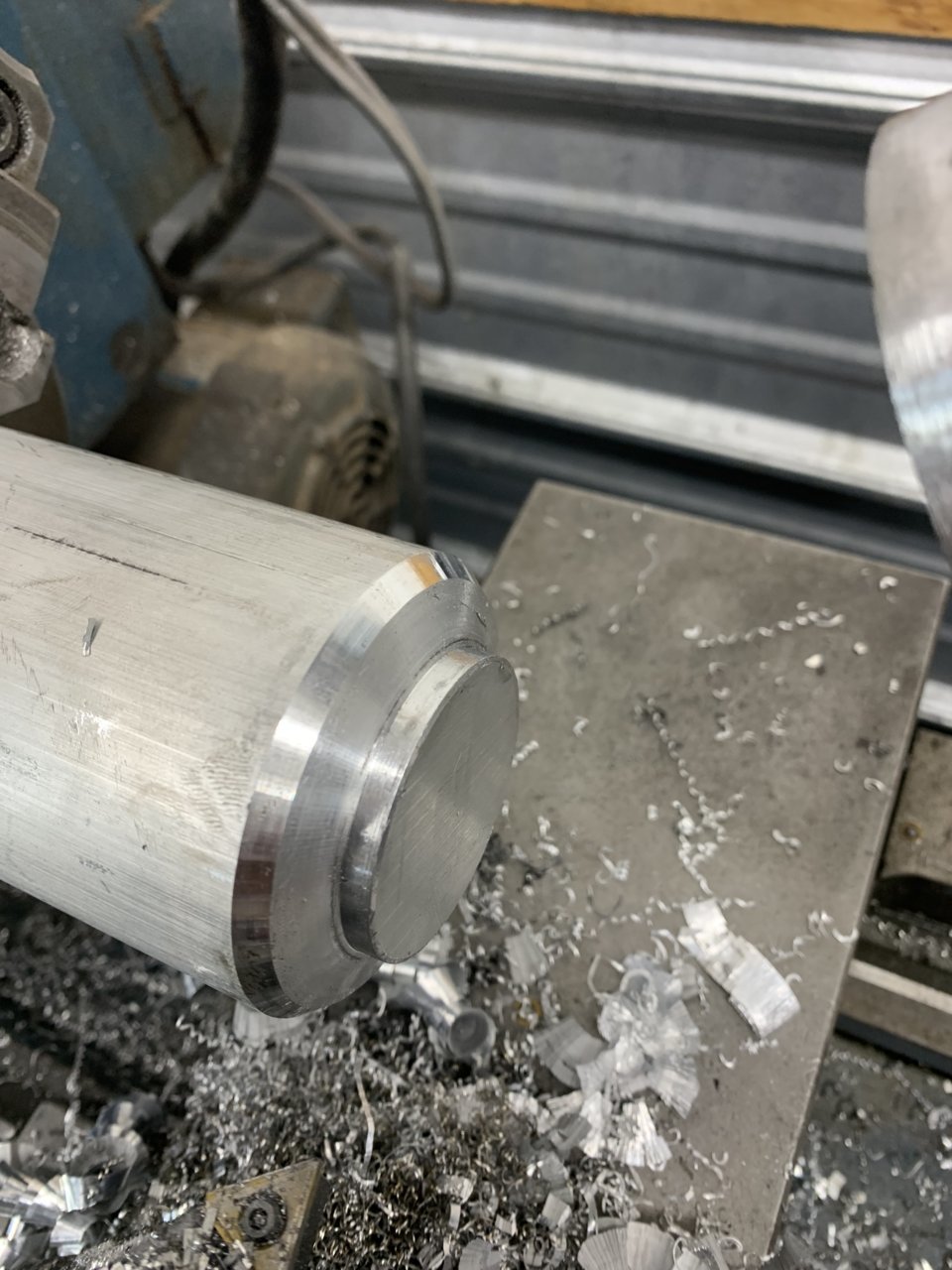

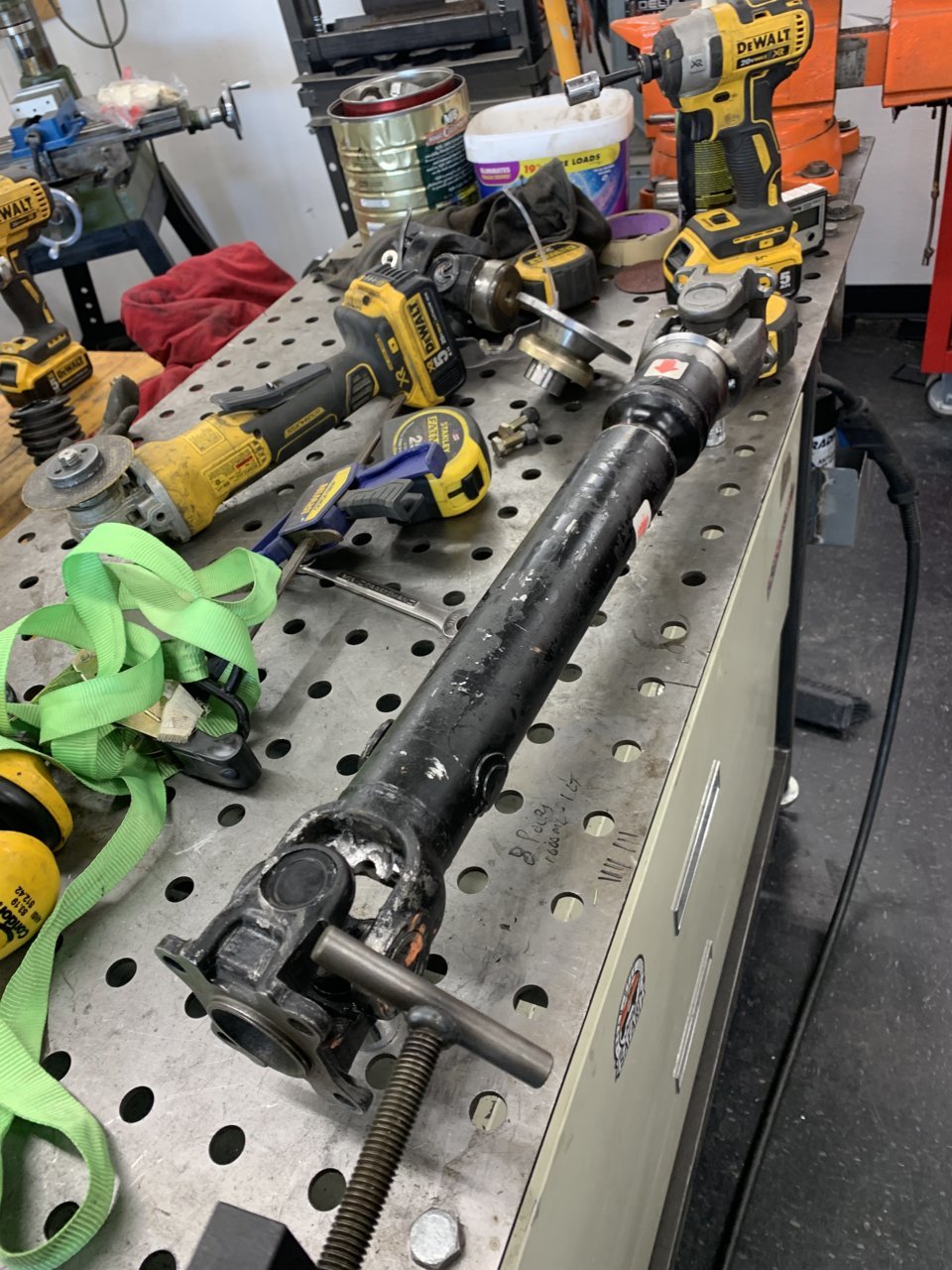

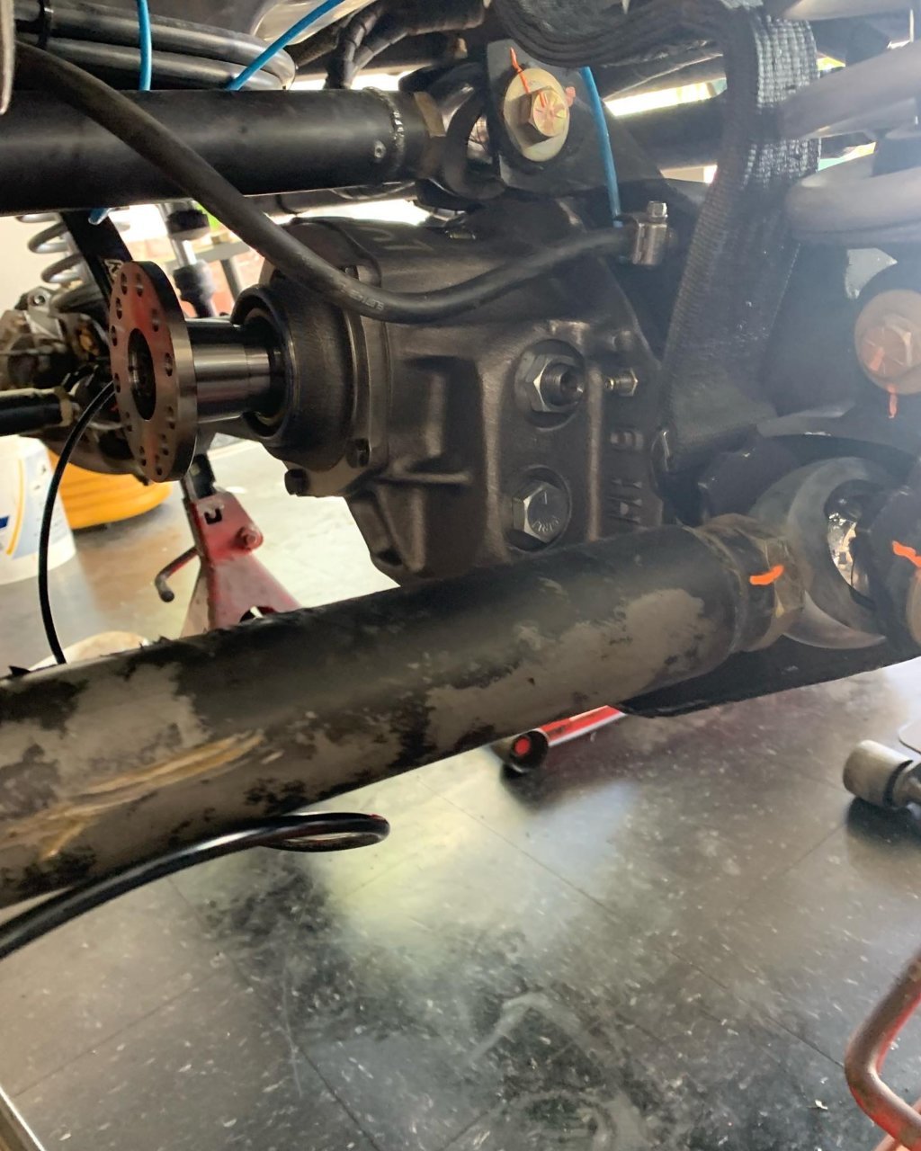

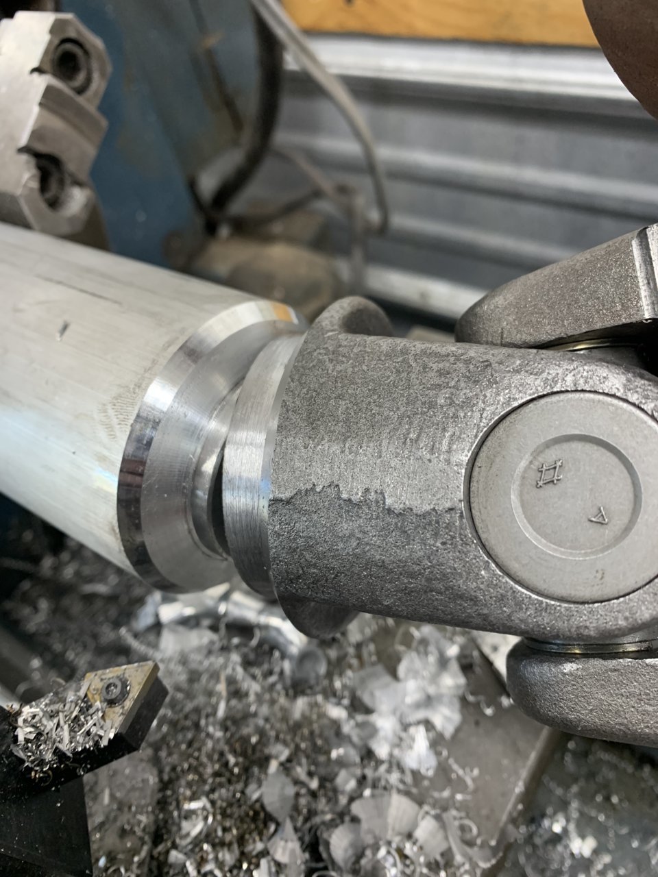

    Well made a new driveshaft with a single u joint at the top. A quick rear drive proved there was no way in making this work unless I went back to a cv and limited the downtravel. Go figure limiting the downtravel would be almost 4 inches (only 2 or so inches of downtravel after).

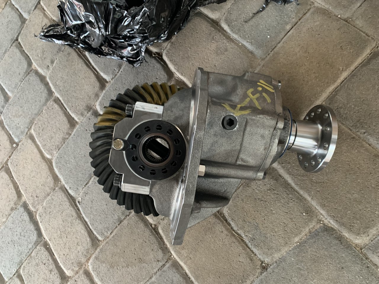

    after a ton of calls to driveline tech to figure something out, it was determined my only solution was a high pinion. So like usual, fires the money cannon and ordered a high pinion. Should be here next week hopefully.
    driveline issues didn’t even cross my mind when I was putting the atlas in.
    some pictures of the driveshaft though
    4C68C37F-A86C-4509-9F9D-B33B49FD7F4B.jpg C7B3968A-F390-4424-91CA-8C828C2BB7D8.jpg 9CD2BEFC-F860-4EB4-A77B-DBAD295C7EF7.jpg E820FF23-3180-454D-AB3C-1133ACF2885C.jpg 668A4AEB-67AB-41FA-835E-99443FD74CD9.jpg 77ADBC67-FEFC-43E0-9587-C1E78788F8F1.jpg 06544FC3-70C5-43DF-BD99-0080C33D58EC.jpg

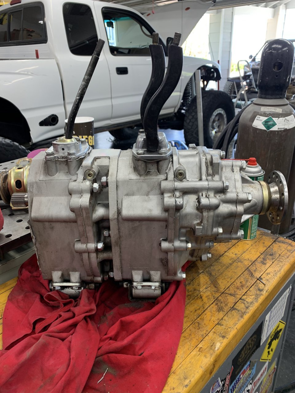

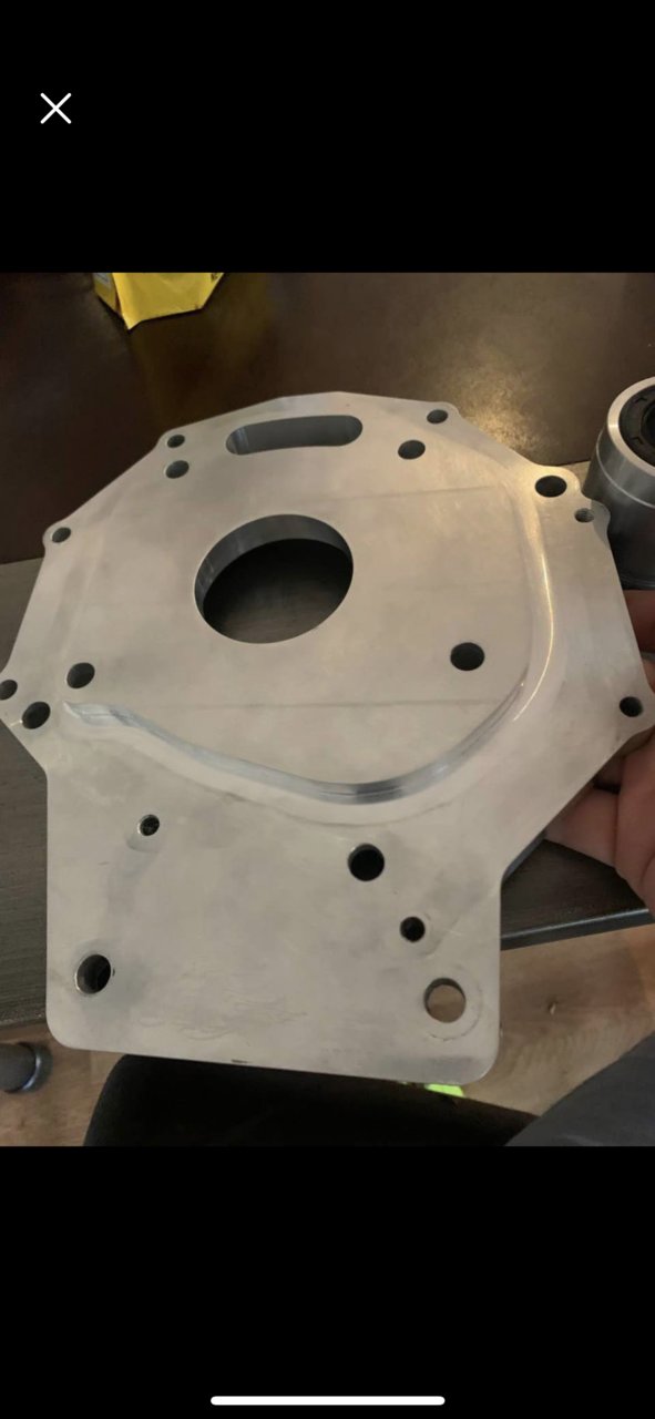

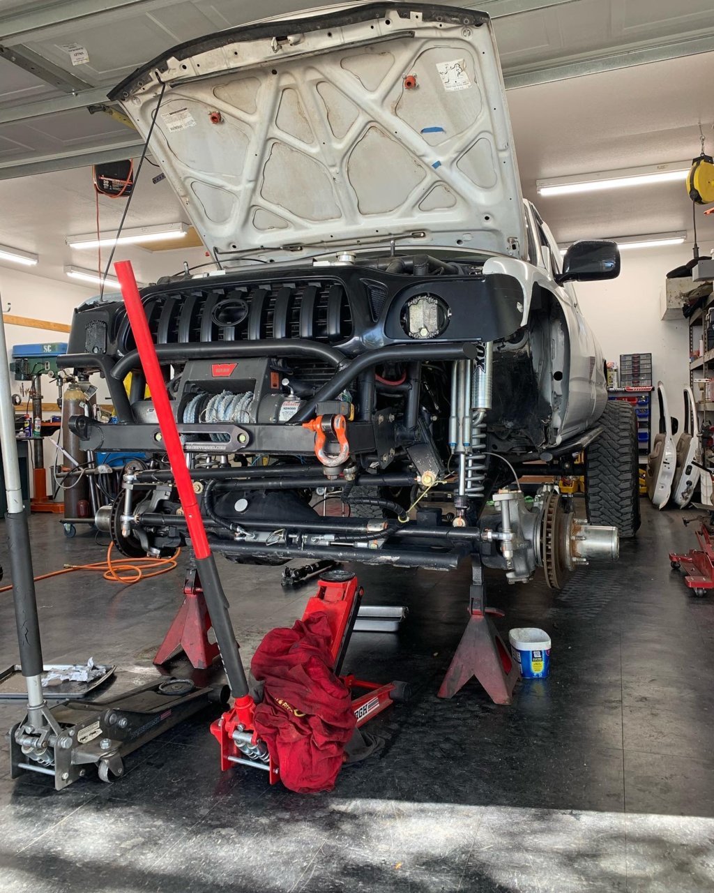

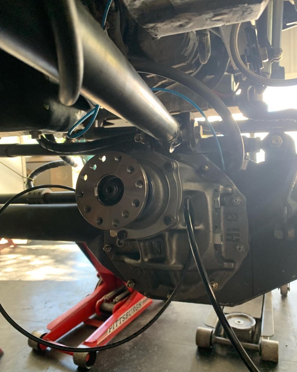

    High pinion showed up and got that installed. Need gear oil and to put the transmission cooler in and it’ll be ready for a shake down run.
    618E8432-3A13-4090-8885-0B00D90C44F9.jpg F0B972E9-5145-4E0D-B9B2-07B17D2368C3.jpg A9A19D08-6F4F-4912-833C-6DF13218BF21.jpg D7EB1DE4-38EE-47EF-ADD4-30BB30982ED1.jpg 3C6B6A23-DA7D-4D53-AA28-7F584BD195B9.jpg

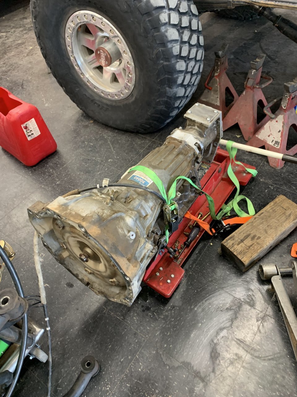

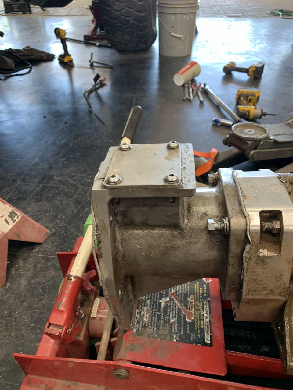

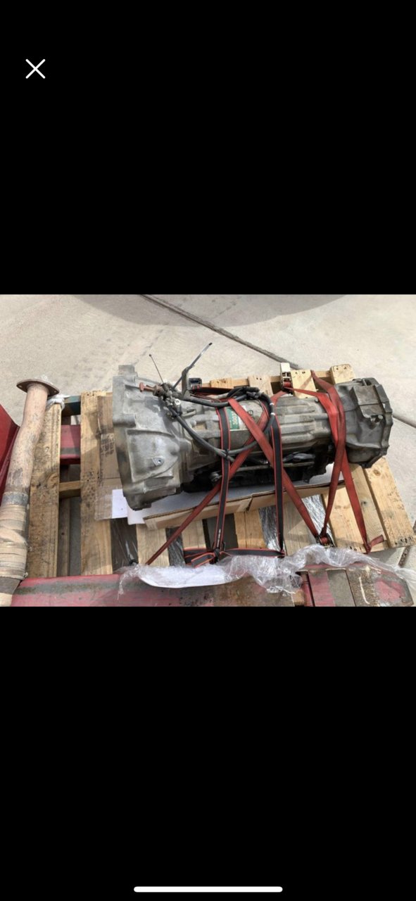

    Transmission cooler installed 0BC909D2-2173-4595-8B72-570FCAB4FEC7.jpg51223476-70EC-43A8-B985-9013DD3EFEB5.jpg43DFB76A-2798-4DB6-A9B7-22F44B81982D.jpg

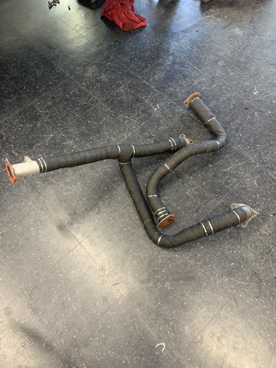

    Wrapped the exhaust to cut down some heat and resealed the header to exhaust flanges. Still waiting on oil for the third but hoping to do a test run next week and then trail hero the following week. B7B1C5F5-0A30-47CA-80D1-B5BFF7B41585.jpg

    Do you seal your exhaust flanges with RTV?
  8. Sep 23, 2022 at 9:35 AM
    #1728
    malburg114
    malburg114 [OP] Well-Known Member
    Dec 26, 2012
    #93766
    3,821
    Las Vegas, NV
    2001 Toyota Tacoma TRD
    I have been with this new exhaust because I made the flanges and had some exhaust leaks. Seems to be working. I’ve been using that copper rtv which is the high temp stuff

    Interesting. So just the RTV with no other gasket. Never tried that.

    I'll need to try this!

    Copper RTV is the shit for exhaust work but it only works well with no crush gasket on really smooth/flat flanges. I use it in conjunction with doughnut gaskets though and it works super well on my shitty flanges and cobbled together exhaust

    Great info guys, ive been chasing a p0420 which im 99% sure is due to an exhaust leak around my 02 sensor somewhere after doing some exhaust work. Looks like im picking up some copper rtv.

    +1 can confirm copper rtv on doughnut gaskets with shitty flanges and cobbled together exhaust

    The mid flange is nothing but two pieces of metal so I shoved a gasket in there and then copper rtv. The header to downpipes had a bad leak and it’s almost all gone. I just need a better way to clamp them since the studs broke and I have vice grips holding them currently together.

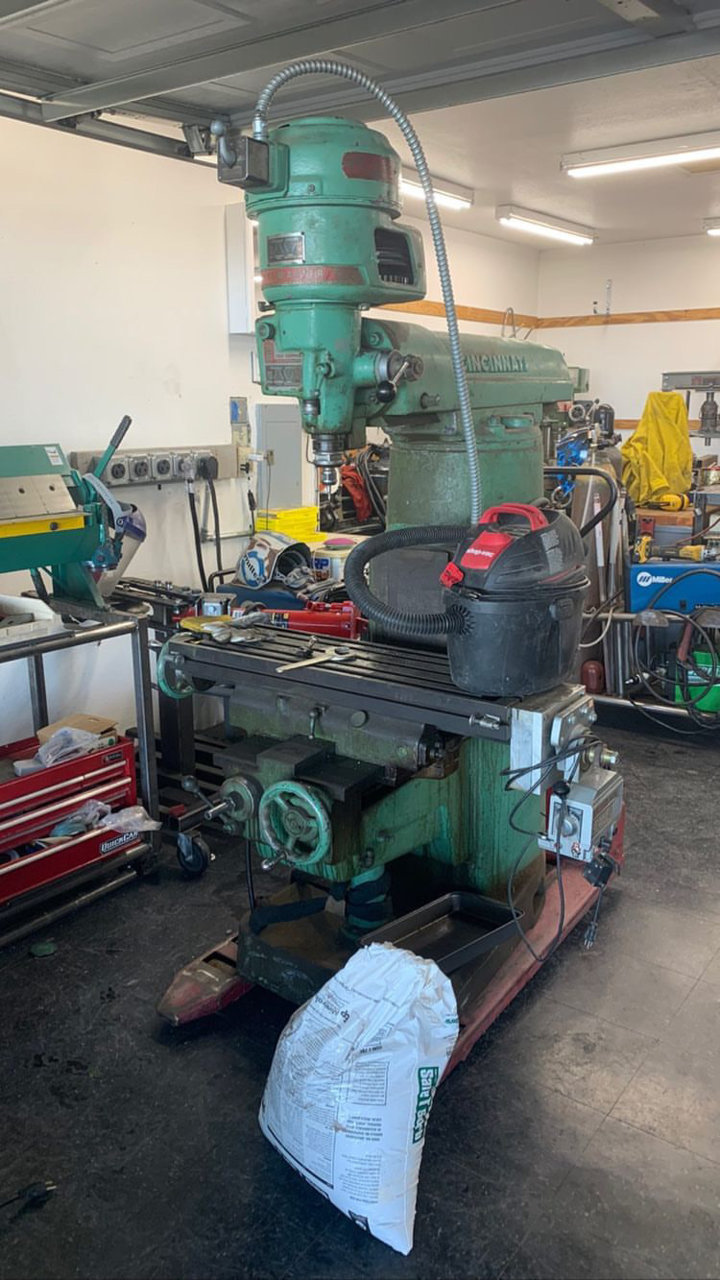

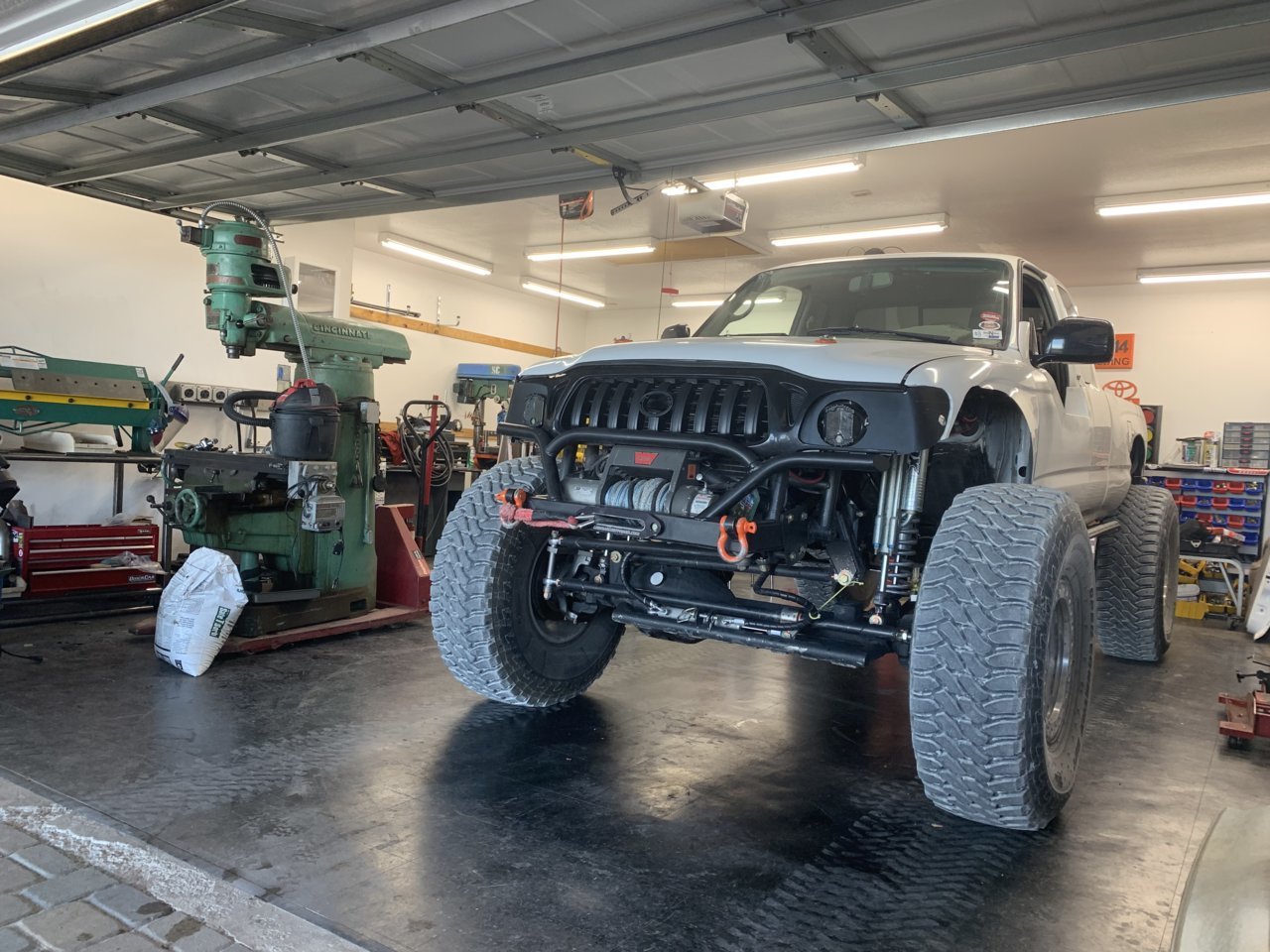

    Got the truck back together and went for a drive. Seems to drive well. I’ll do one more drive tomorrow to finish breaking in the gears and then a shake down run next week and trail hero the following. Also picked up a new tool. A 1955 Cincinnati tool master mill. Should be fun to play with.
    FDCAA2F0-2B31-4374-BAFA-37AC2ED77614.jpg 1A39FE8F-6949-43AE-8CCB-5BEF9499D7D3.jpg E7A39049-D349-4508-9B85-40256952D94D.jpg
