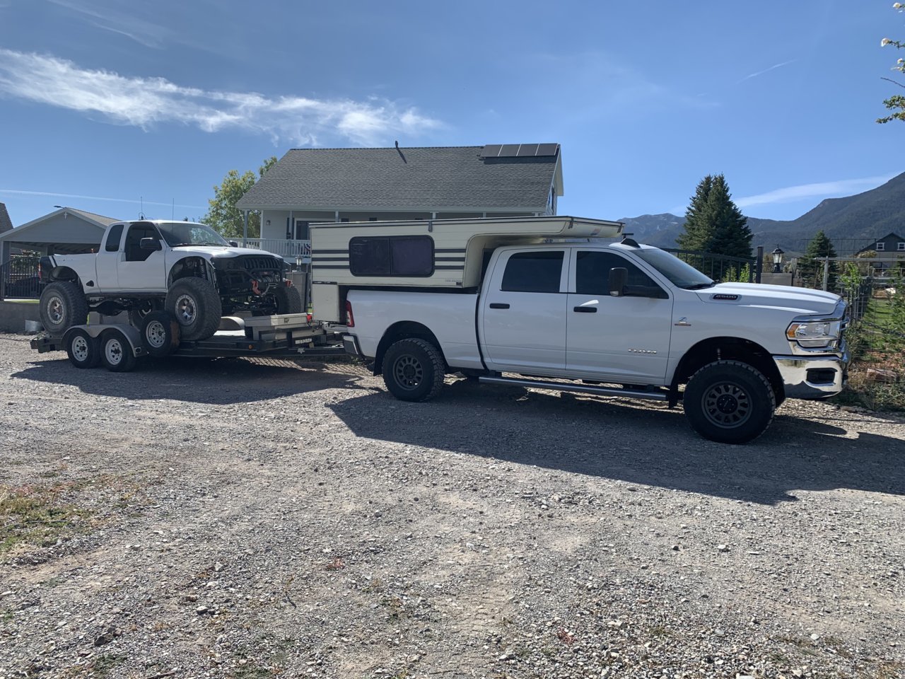

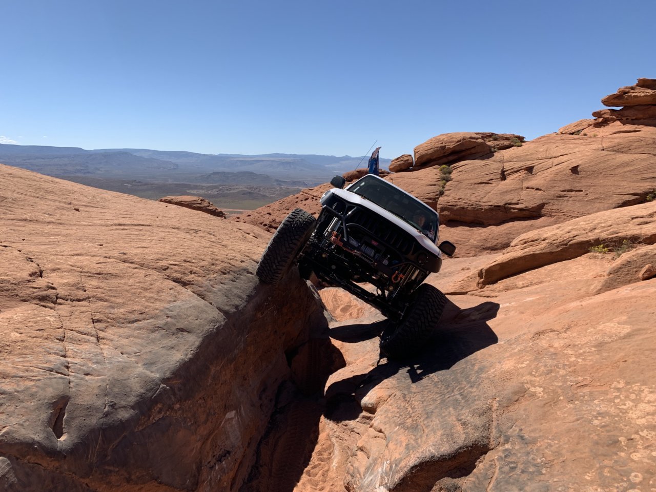

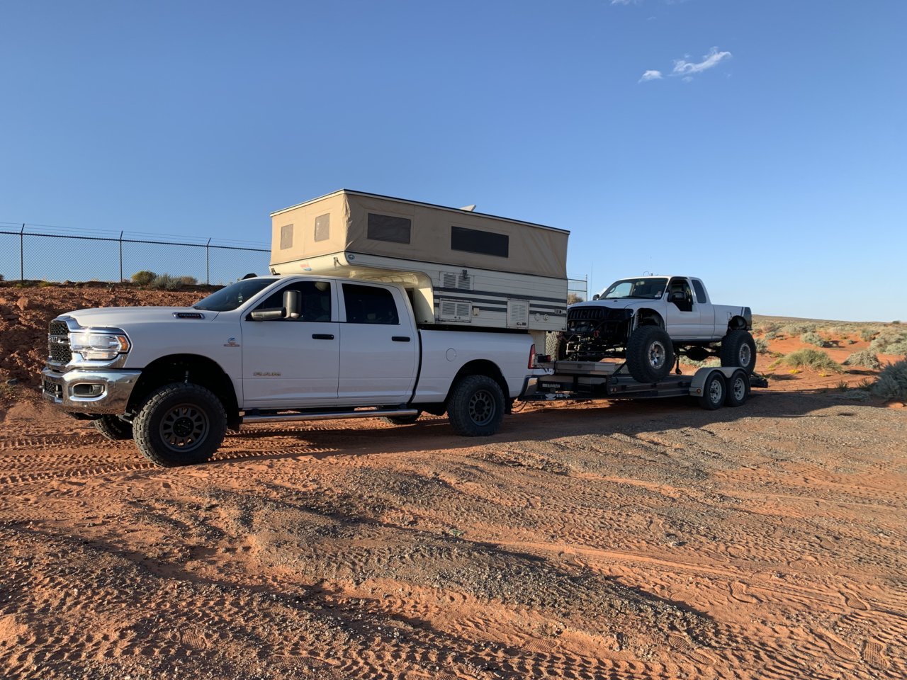

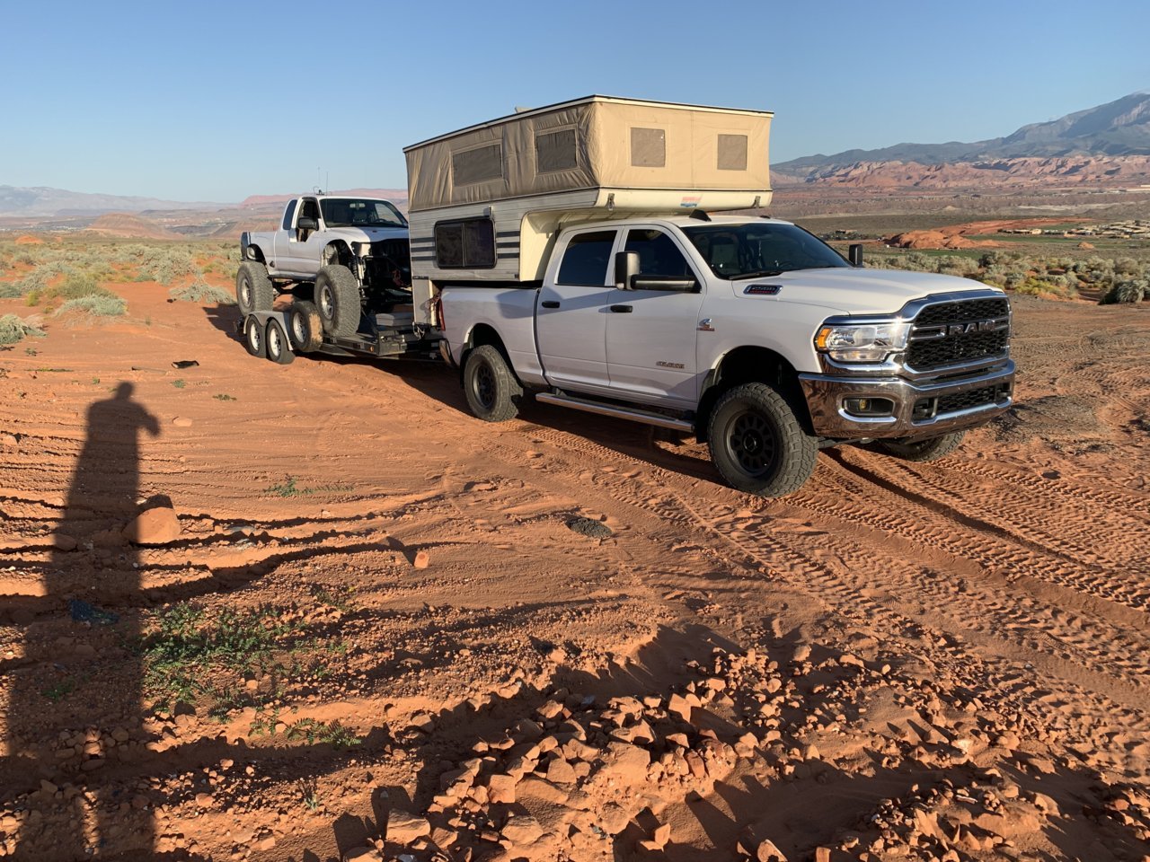

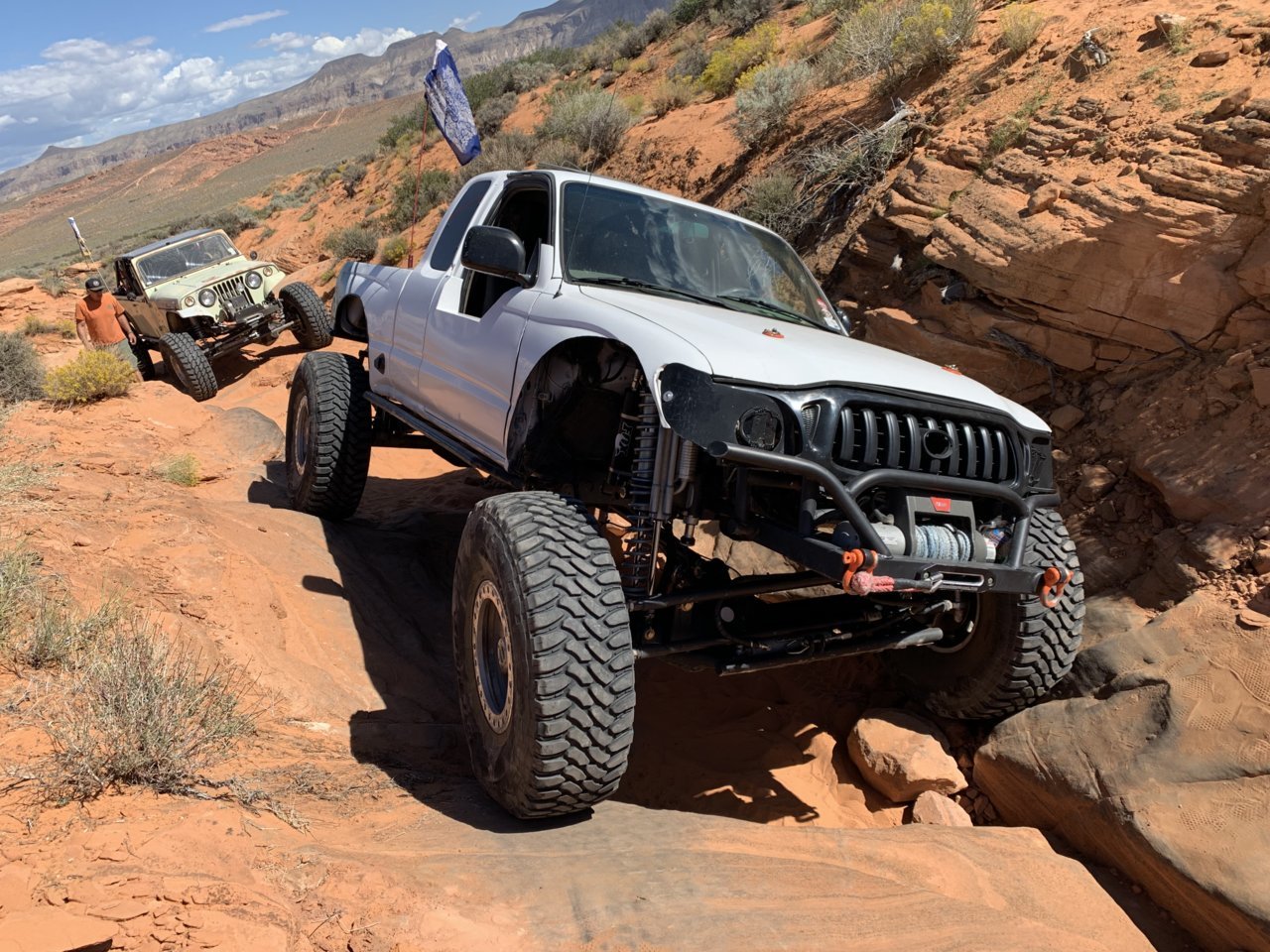

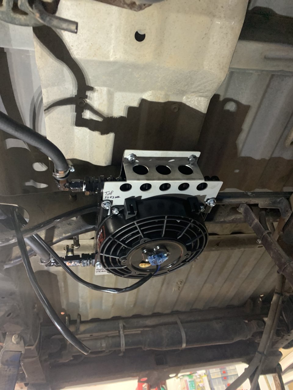

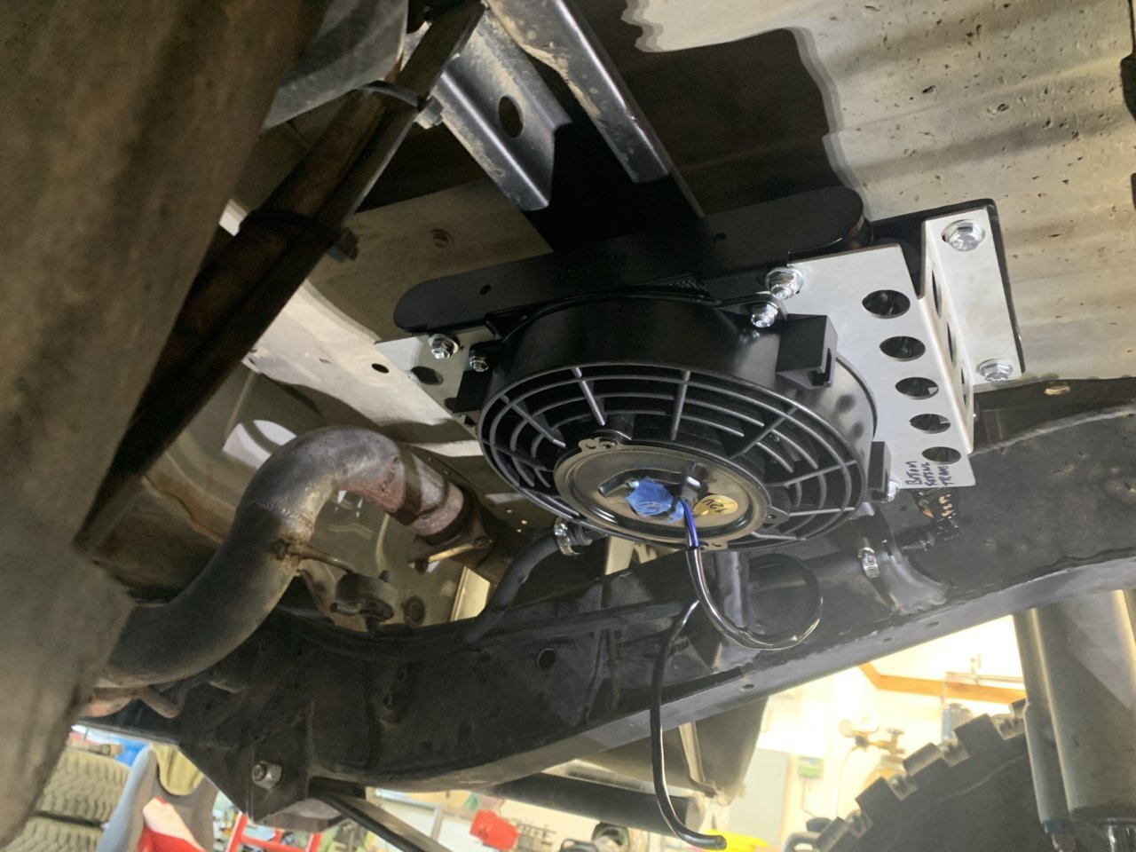

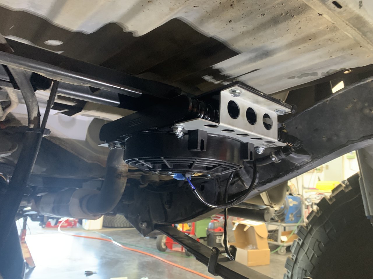

    Day trip to sand hollow to shake down everything before trail hero next week. Everything seems to have worked except the fan on the trans cooler but I’ll bypass the thermostat and just leave it to constant on when the key is on. Also took the camper and slept in it and worked out well. Looking forward to more trips. 8560441C-B3FA-4502-A0E6-40E22706CAEC.jpg6C32E812-A9EE-41A5-9FBA-FF6C9F2940E9.jpg52CFA6D3-6C10-434F-8322-7102F4DBC474.jpg697B55BE-D60C-46BE-84A9-8EF4AAF7DA7C.jpg

    for a second I thought the camper had a full on roof in that last picture

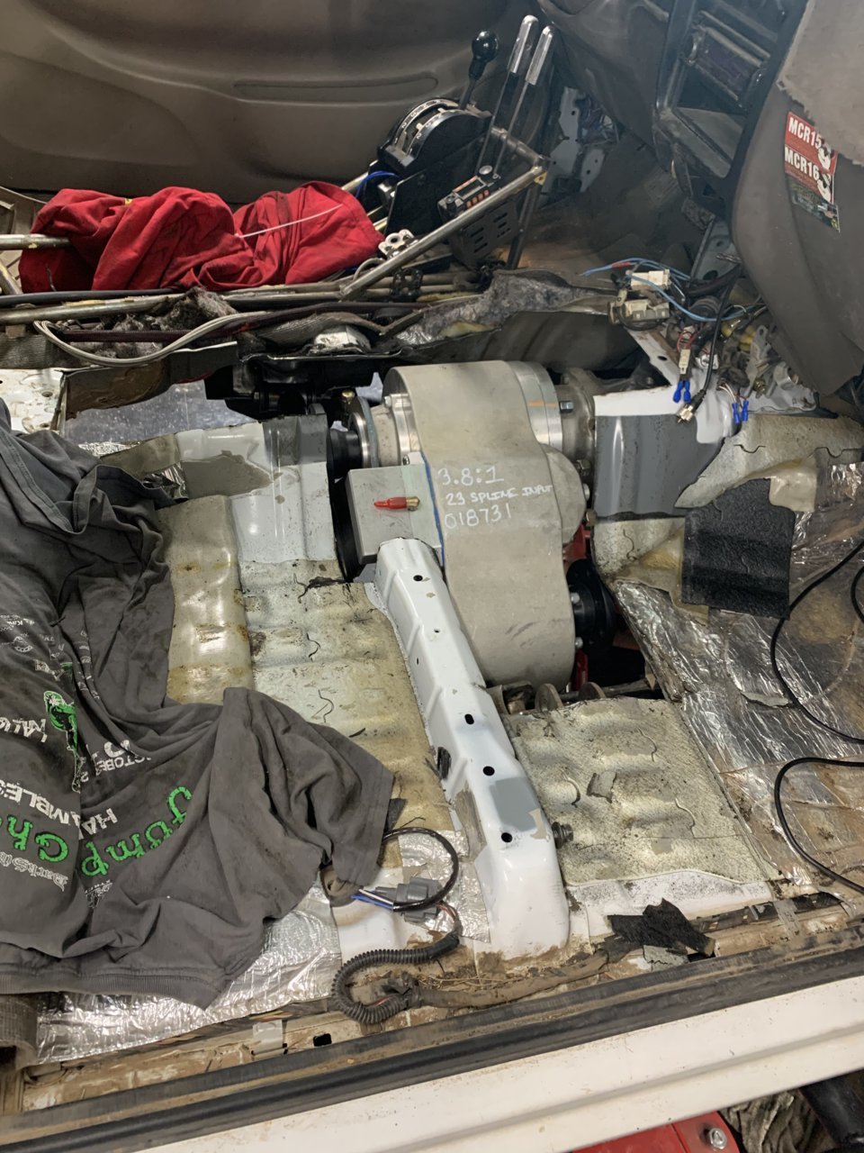

    have a pic of the shifter setup all in and done?
    How is that trans cooler working out? Was gonna do in-line but a friend told me stay away from in-line and to do like yours.

    I can grab some pictures tomorrow of the shifters.
    trans cooler seems to be working well. Before I just ran it through the radiator and got this to help save the new trans. I just made a jumper wire so it’s constant on when the key is on. I don’t have a gauge yet but my dads jeepster has the same one and seems to keep his cool

    Cool, yeah, would like the see the setup. I saw the frame you made but it was off to the side in the pics of the trans swap.
    Th fan is a good idea for low speed stuff. Your shit is done smart.

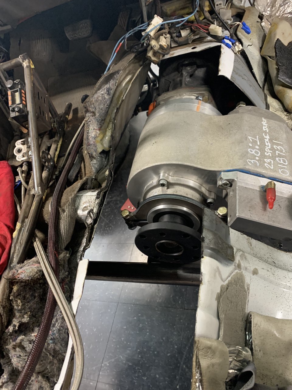

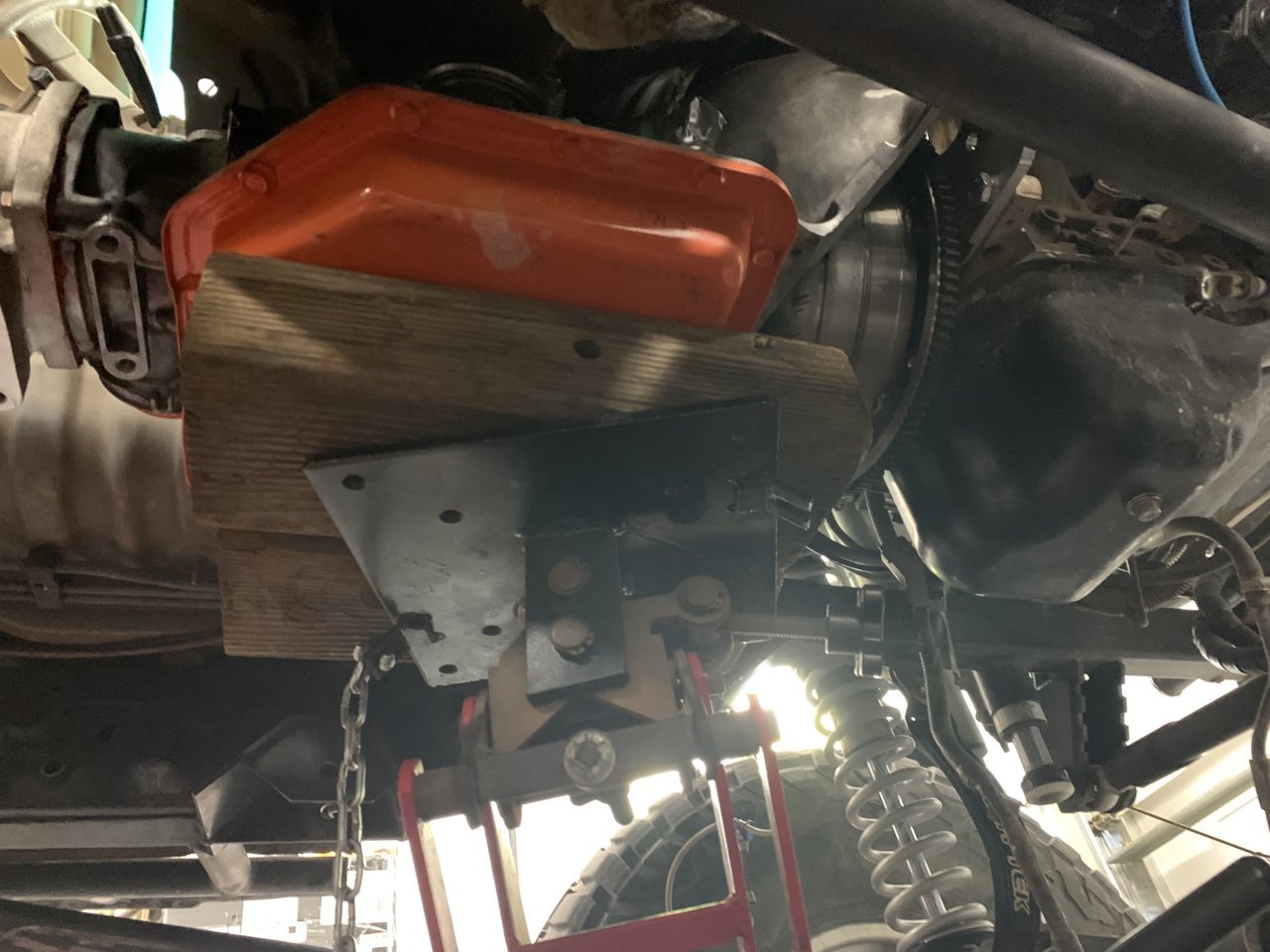

    Got a question..... Im not 100% sure everything is gonna work out til I run it so gonna stick with just the 4l80 mount to crossmember then was gonna add 2 more points of contact and the t case brace setup to another xmember. In the mean time how much flex do you think I will get up and down from atlas with the 2 5/8" adaptor and the rest hanging?

    I honestly have no clue how much flex you’ll get with just the atlas hanging. My dad ran no atlas support on his tj for a while and after cracking two transmission outputs he put an atlas crossmember and hasn’t had issues since. I can tell with my two crossmembers there’s less rotation/movement in it vs my Toyota cases. I could watch the shifters move on the Toyota cases cs the atlas I don’t see them move at all.
