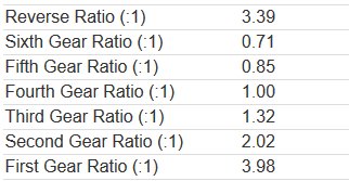

    The gear ratio is less than 1:1. Basically a gear that reduces the engine's rotation to be slower than the wheels are rotating (kind of an oversimplification).
    Here's what I found for the gear ratios for the Tacoma's MT:
    So you get a lot more torque in 1st gear, but you can't get to a very high speed. With an overdrive, you sacrifice that torque in favor of a low RPM, which is fine for cruising because you don't need the torque.
    My gear physics is rusty so someone can probably provide a better science lesson than me.

    Ahh gotcha so it’s a nomenclature thing for gear ratios lower than 1:1.

    You’ve got it.
    and I need to copy that list of gear ratios!

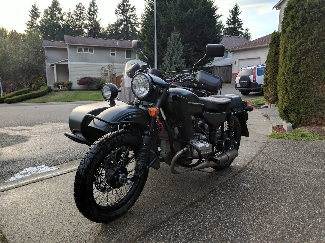

    Nice. I didn't see that.
    And you own a URAL??? Sweet!
    I spent a little time with a sidecar in my youth. A WHOLE different animal!

    I had one for 4yrs before the Taco. It was new and unreliable, but it gave me the off road bug. So, I got the closest thing that I could.
    There are days that I really miss riding it to its limits, but the Taco makes me happy. That is something that I didn't think I would ever say about a 4wheeled vehicle again.

    Ya, I've always wondered how reliable those things were.
    Not as reliable as the beemers they copied eh? LOL

    Yeah. In 2012 / 2013 when I was looking, folks were saying that they got their act together and were reliable enough for commuting. Flat out lies.
    -- GB opened under warranty for 1st / 2nd shift fork problems. It was sent to HQ for the fix.
    -- It started dropping out of 3rd under load after the warranty was up. I took it apart and found the issue and that they botched the first fix.
    -- Then the con rod roller bearing cage fragged and the misinstalled wrist pin retainers manifested themselves at just 16,000mi. I rebuilt it. While doing so, I found the friction plate splines were toast and wearing the output shaft.
    -- Just 4k after that, the FD bearings lunched themselves. I rebuilt it and sold it.​
    A friend bought a 2014 new and had a whole crop of other issues.
    2wd plus reverse were killer features. The worse the weather got, the more fun and capable it was.
