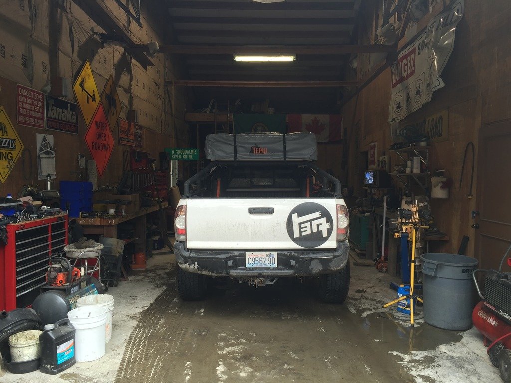

    I'll be a test mule. Bonus points for TEQ sticker?
    49A02CD1-BA76-42F1-94F4-18DA9B0246A2_zps_82548b451e64ae6bda8f49d27fd4ba81e4cdc529.jpg
