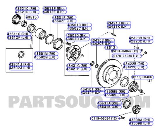

    Here’s my question: do you have to press the bearings out of the hub to convert from ADD to manual lockers? Also, what all do you need to make the switch? I’ve looked around at local pullaparts, but I haven’t had luck finding a hub/spindle/CV assembly with manual lockers for a quick swap. I’d have to use my existing spindles. SO! What all is needed for the convert?
  9. Oct 18, 2019 at 8:23 PM
    #49
    DJB1
    DJB1 Well-Known Member
    Jun 8, 2013
    #105835
    2,223
    Dave
    SLC, UT
    2003 Regular Cab 4X4 5MT
    They use different wheel bearings. You can use your existing spindles if you deal with that issue. Other than that you just need manual hub CV axles, the correct Aisin hubs and a hose clamp to lock your ADD actuator in 4WD. But it's an easier swap if you can score a complete non-ADD front axle assembly.

    Spindles are the same on Prerunners, 4x4 with manual hub, and 4x4 with ADD.
    The difference is in the axle hub.
    Matic[QUOTED] and Wulf like this.

    Im just saying that in late 2000 early 2001 was the last year for manual locking hubs.
    Also, its more cost effective if you can purchase complete spindles, knuckles, rotors, manual hubs if you can find a good deal as opposed to pressing prerunner bearings out and 4x4 bearings in and piecing a system from there.
    Just waiting on a response for complete L/R assemblies for $400 from a 2000/2001.
