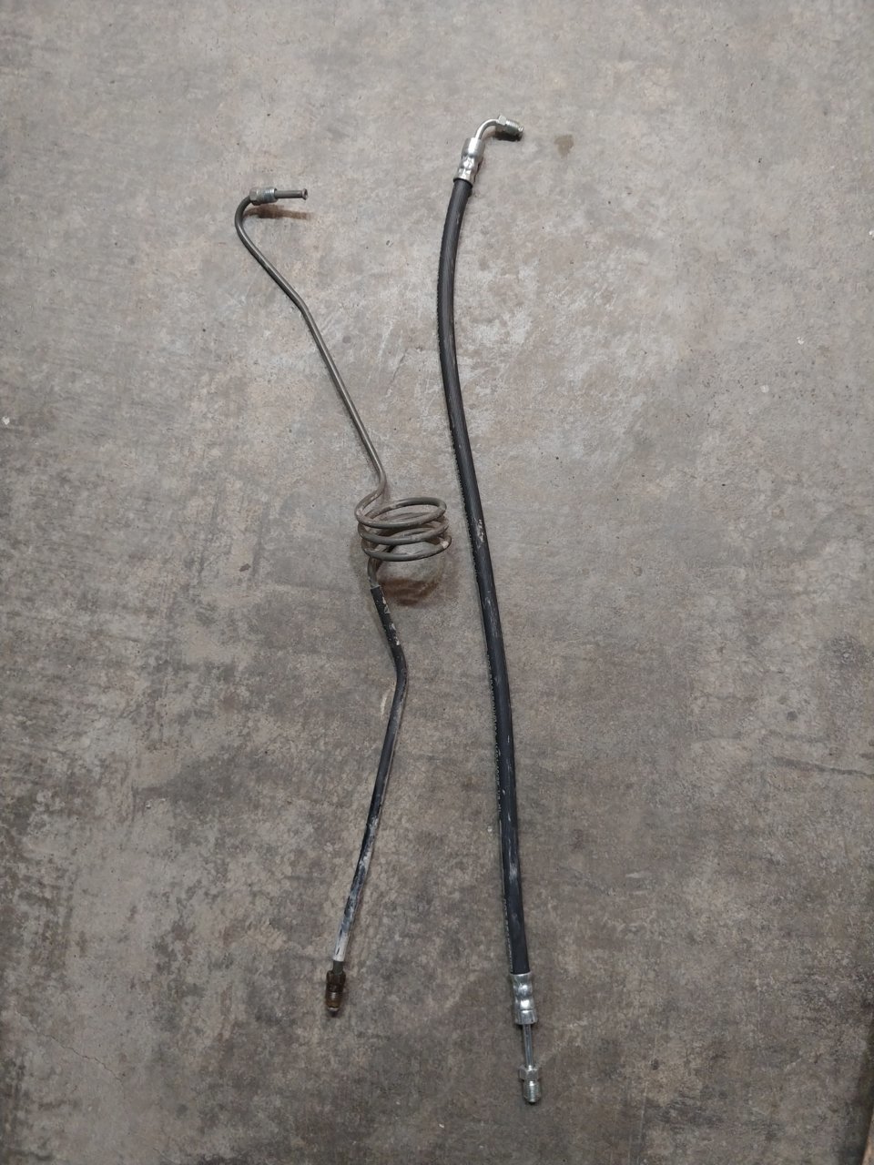

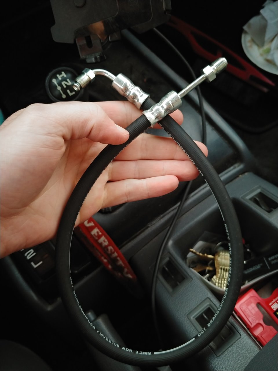

    It's not plug and play, I pulled an entire return line and modified the existing rear lines
