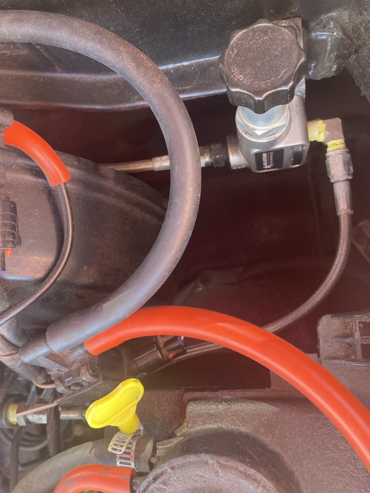

    This is my setup for under the hood. I struggled a little with how long the braided lines should be. If you want, when I get home later, I can pull up the stuff I ordered to do it.
    Also, I did try my luck with doing the universal lines & bending them. Ultimately, I ordered from my local Toyota & picked them up because they charge a whole lot to ship them. I did struggle though, with getting the line to meet up with the rear line bracket because it fell about 3-4in short due to the valve no longer being there. Clear as mud? I can post a pic later which should clear up what I’m referring to. Course others may have figured this out easy peasy & will pipe in.
    I’m telling ya though, if you think you stand a chance with the lines at the valve, try that tool I posted.

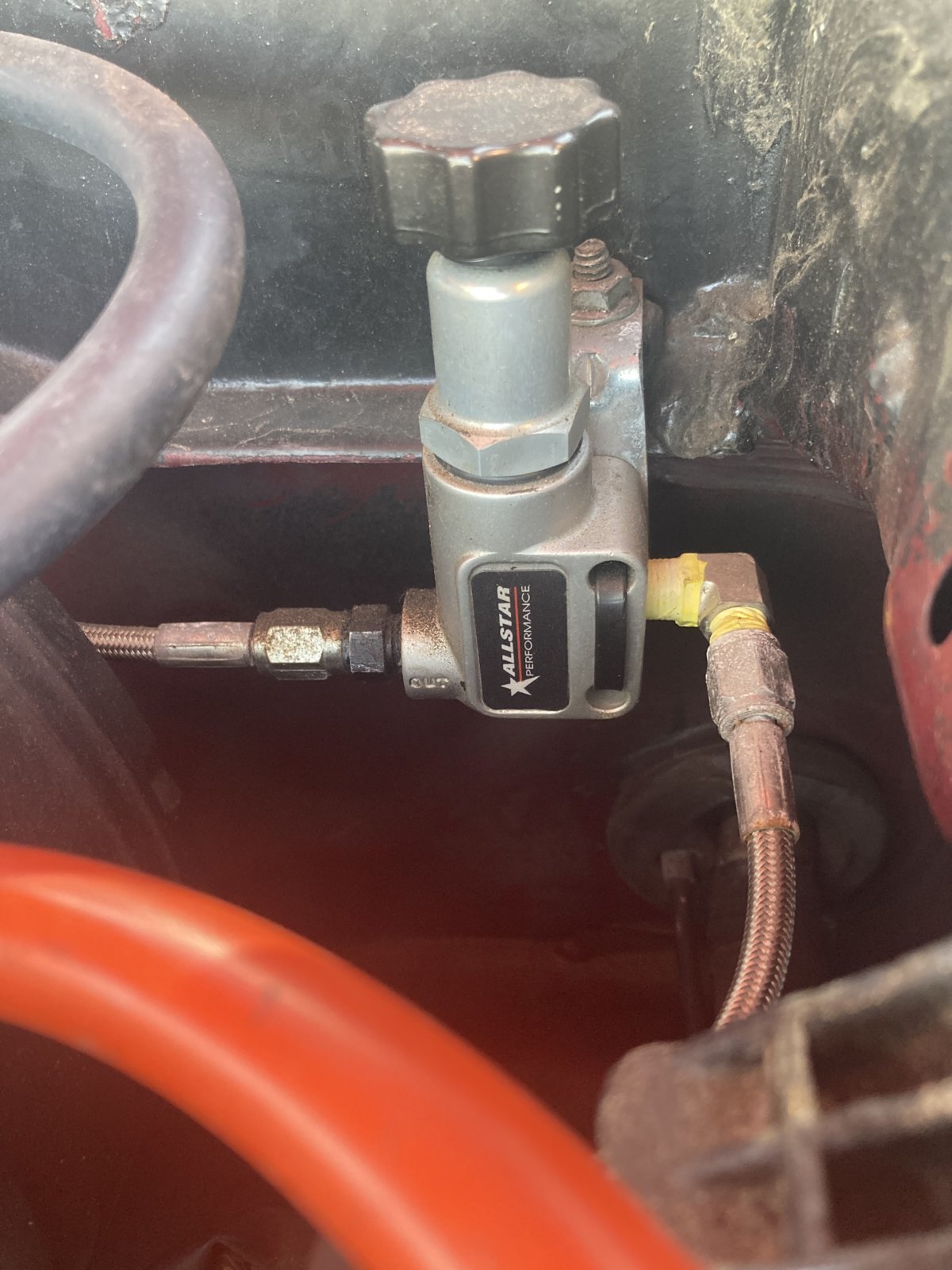

    If I get what you’re asking, no. There’s one braided that runs from the master cylinder to the valve. Then another from the valve to the bracket where the hard line originally went.
    You can see the return one on the left with the hole sealed off. Then the braided line to the send/outgoing bracket on the right. It was more expensive to do it this way, but I had proven myself to be very challenged when it came to dealing with bending my own lines. Installing the lines was the one job I seriously considered paying someone to do. Then I switched to the preformed lines. It still was rough getting that rear part squared away, but I gave myself an at’a girl when it was all said & done. Then when I did the rear brakes, I did the the two rear lines as well. & when I did the tundra brake swap up front, I did those lines. All Toyota ordered…. Wasn’t messin around….

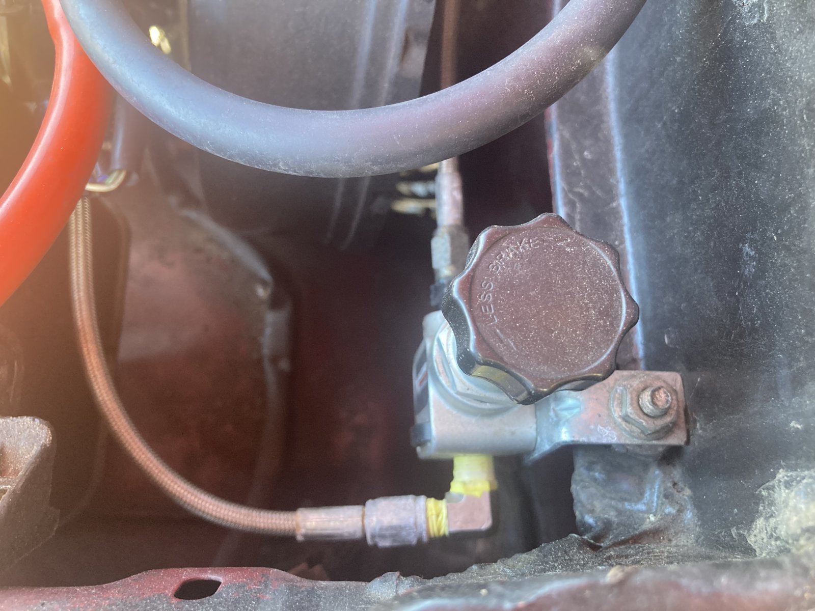

    I used an L bracket, drilled a hole through the lip on the firewall & attached the valve.

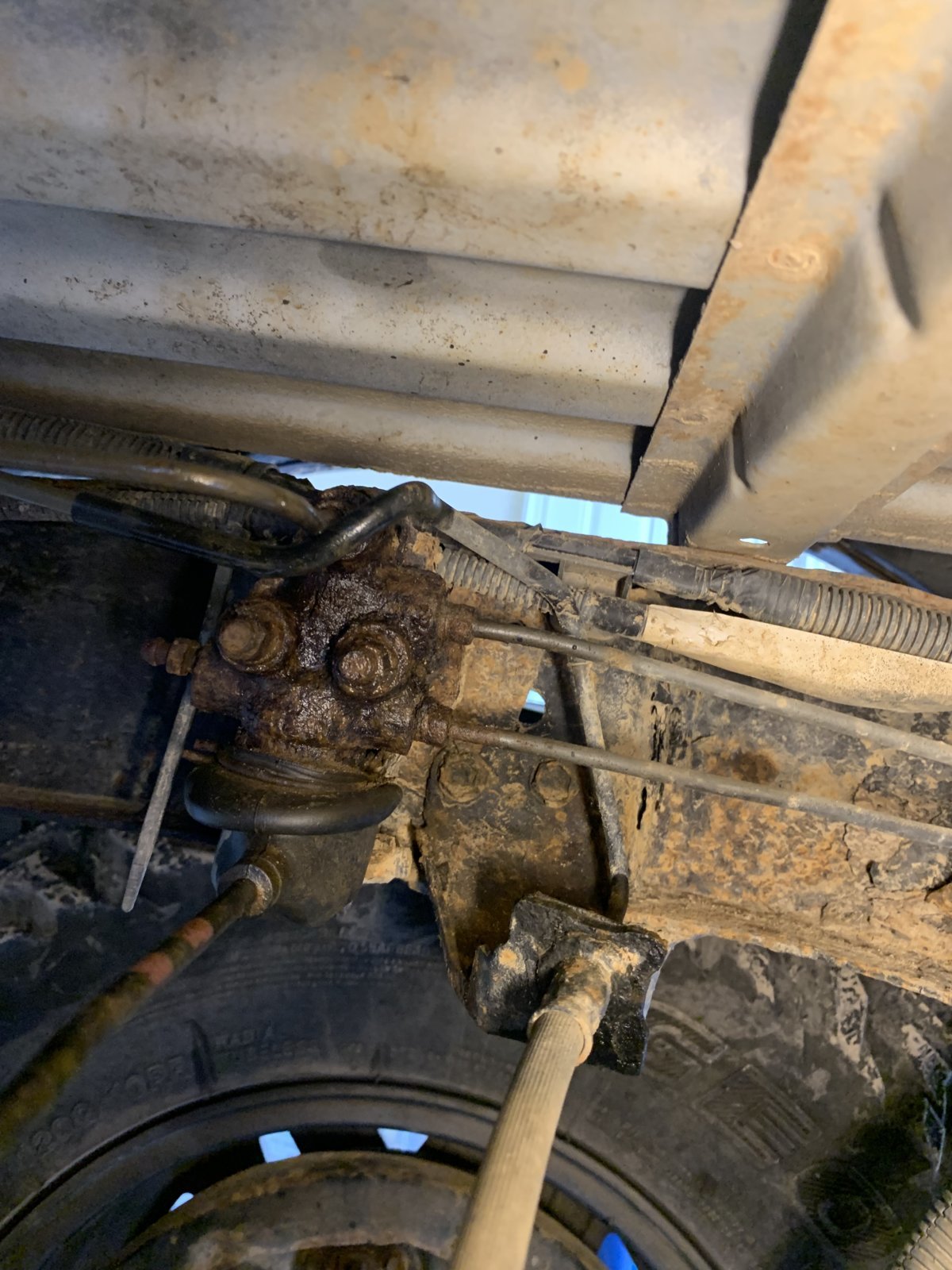

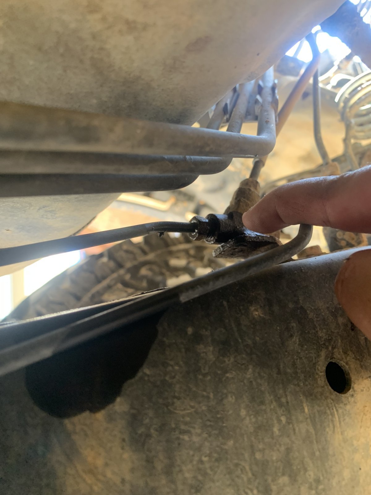

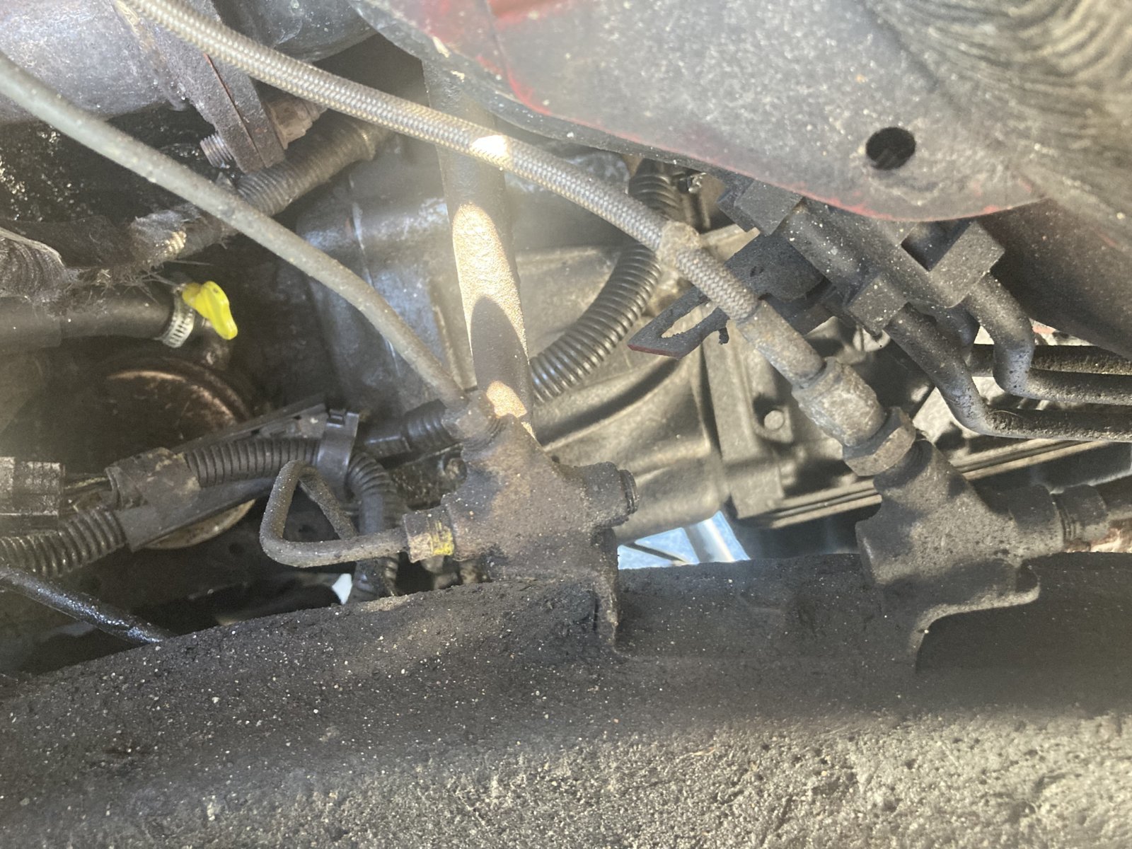

    This is my current situation. This truck spent a lot of time up north so the flare nuts around the LSPV are ridiculous.
    i was able to crack this one open (the one that goes from the LSPV into the rear flex tube)
    as well as this one-
    my current thinking - since I have ABS - would be to replace the line that goes from this connector on top of the frame all the way to the LSPV, put it in the new Prop valve somewhere back there in the rear, then a new small hard line from the new valve to the flex hose.
    It seems like everyone does this modification differently. Is that a logical thing to do?
