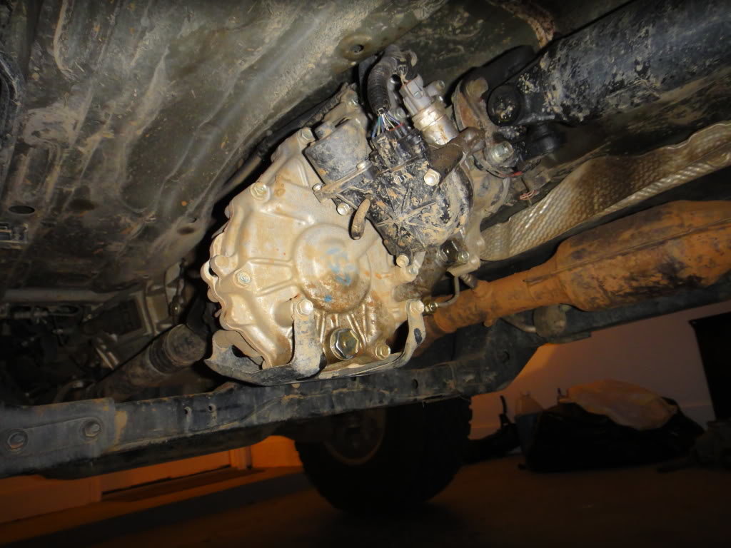

    Is this what you were looking at? If so, that's the transfer case, not the transmission. The transfer case would have the rear drive shaft out the back and a shaft out the front going to the front differential. The transmission would feed into the transfer case. I'm trying to find you a pic of the 6spd transmission.

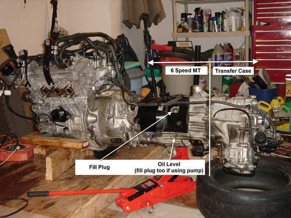

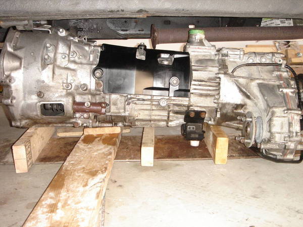

    This should make it obvious ...
    1GR-FE, 6 Speed MT and Transfer case. The drain plug is underneath in line with the other 2. If you have a hand pump, you can fill from the side where you check the oil level.

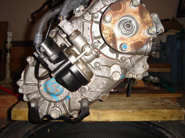

    Slightly different side view.
    Transfer case fill and drain plugs (the 2 big ones)
