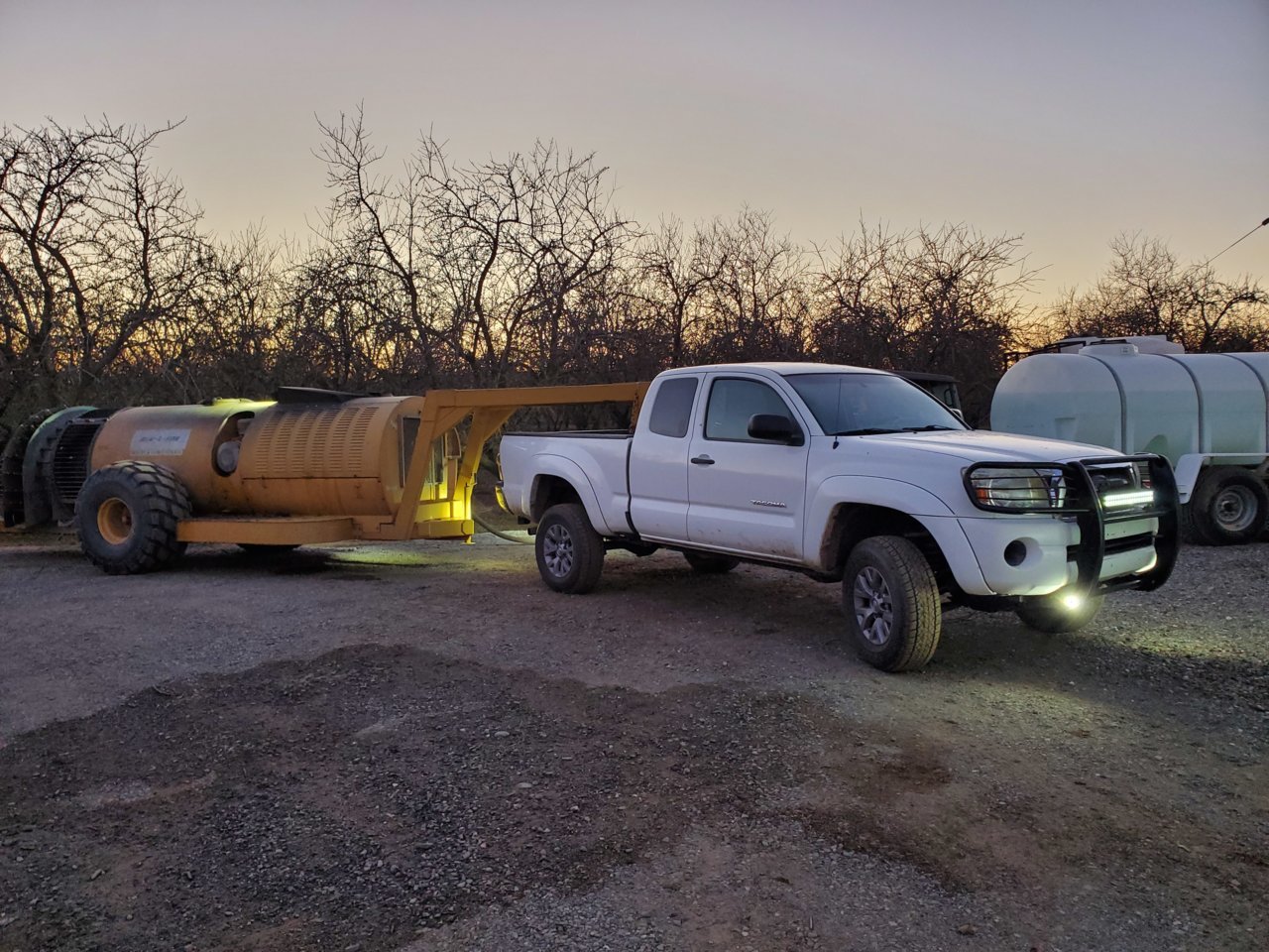

    I can't explain why, but will affirm the fact that its different. I spend days in 4 lo in my 2nd gen that has been converted into a orchard spray truck. I've done this for 2 seasons though with no ill effects so its been so far, just an annoying nuance.

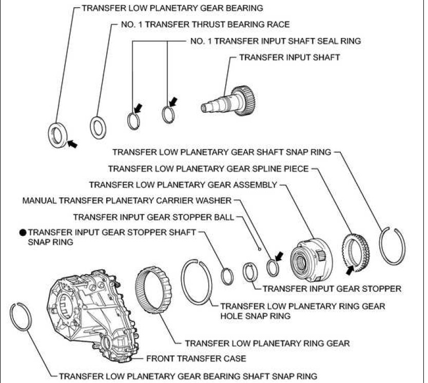

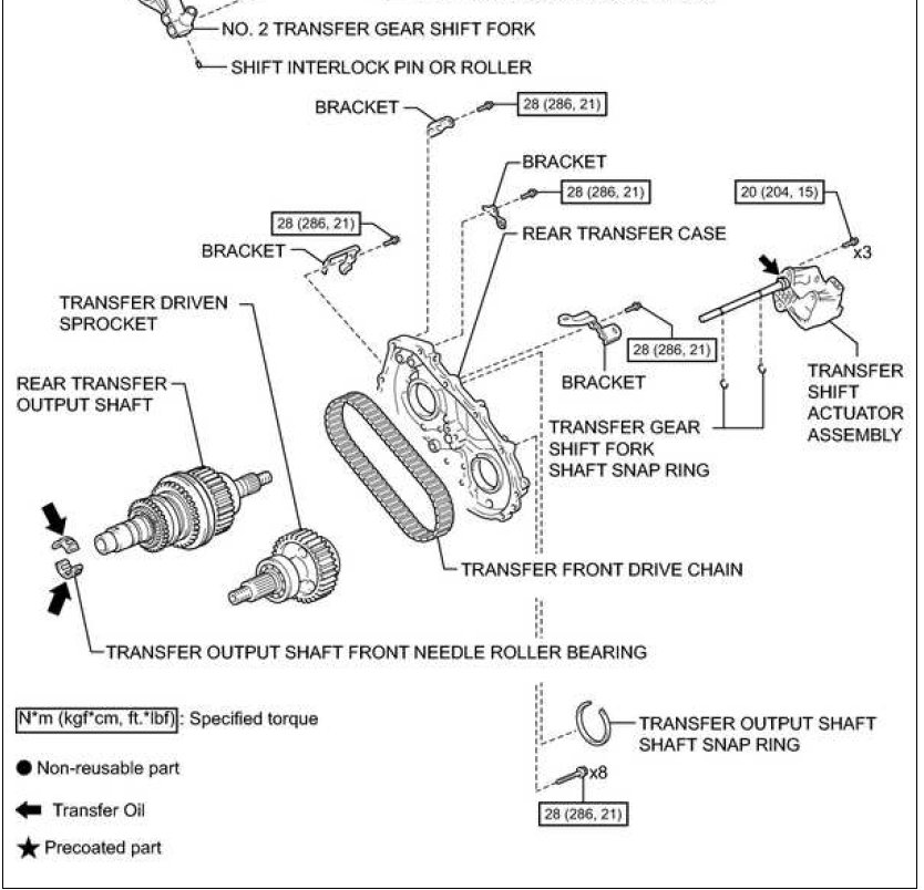

    I'm not sure what you mean by "straight cut low range gears". I assume you mean gears in the transfer case, but looking at the diagrams in the service manual I see that the transfer case is a chain drive type and I don't see any straight/cut spur gears. Could the whine be coming from the chain drive? The sprockets in the diagram look similar to spur gears.

    The chain drives the front shaft, whether 4Hi or 4Lo. Low range is reduction gear set.

    This is perhaps the diagram I should be looking at. Is this the reduction gear set?
