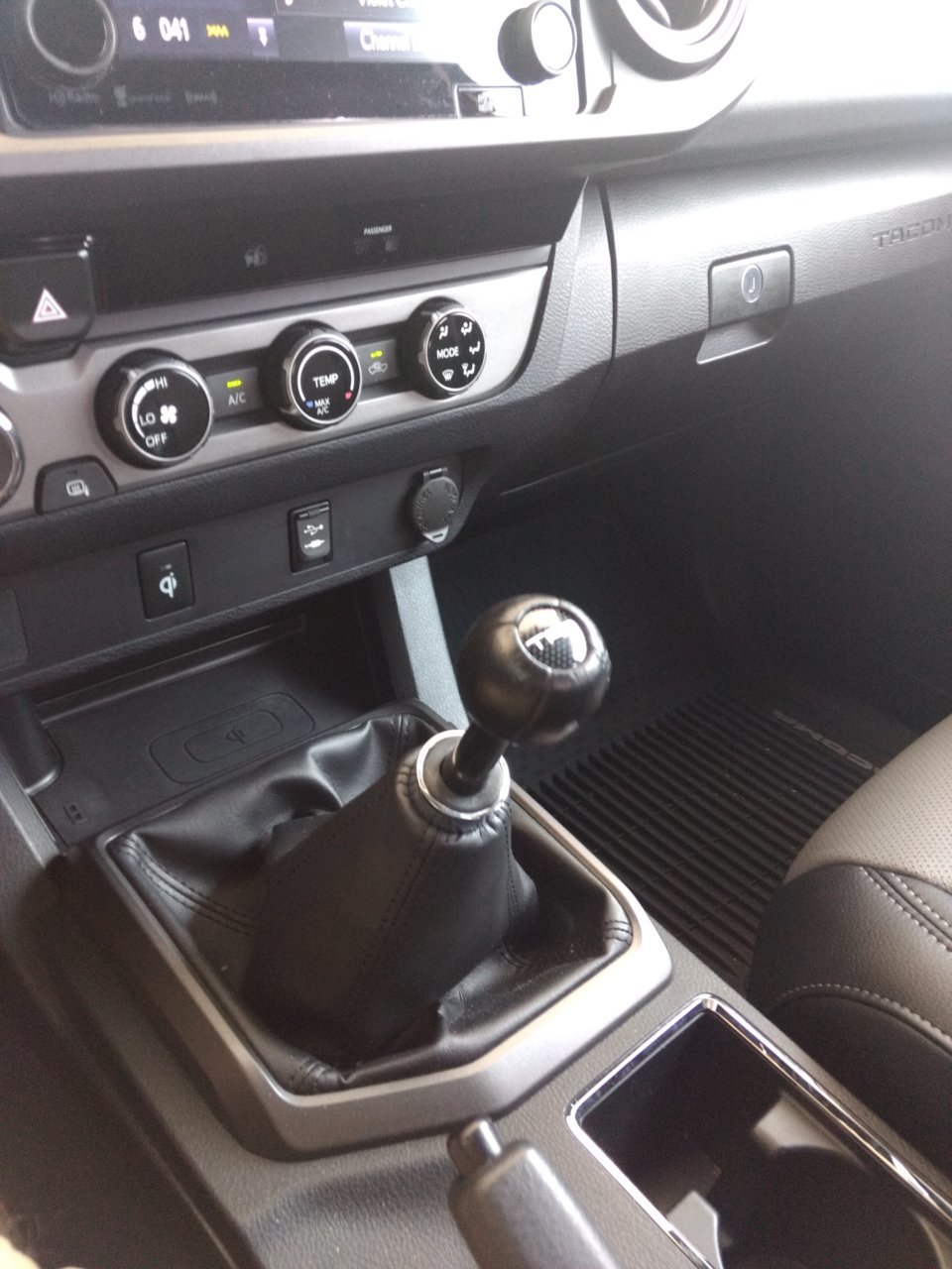

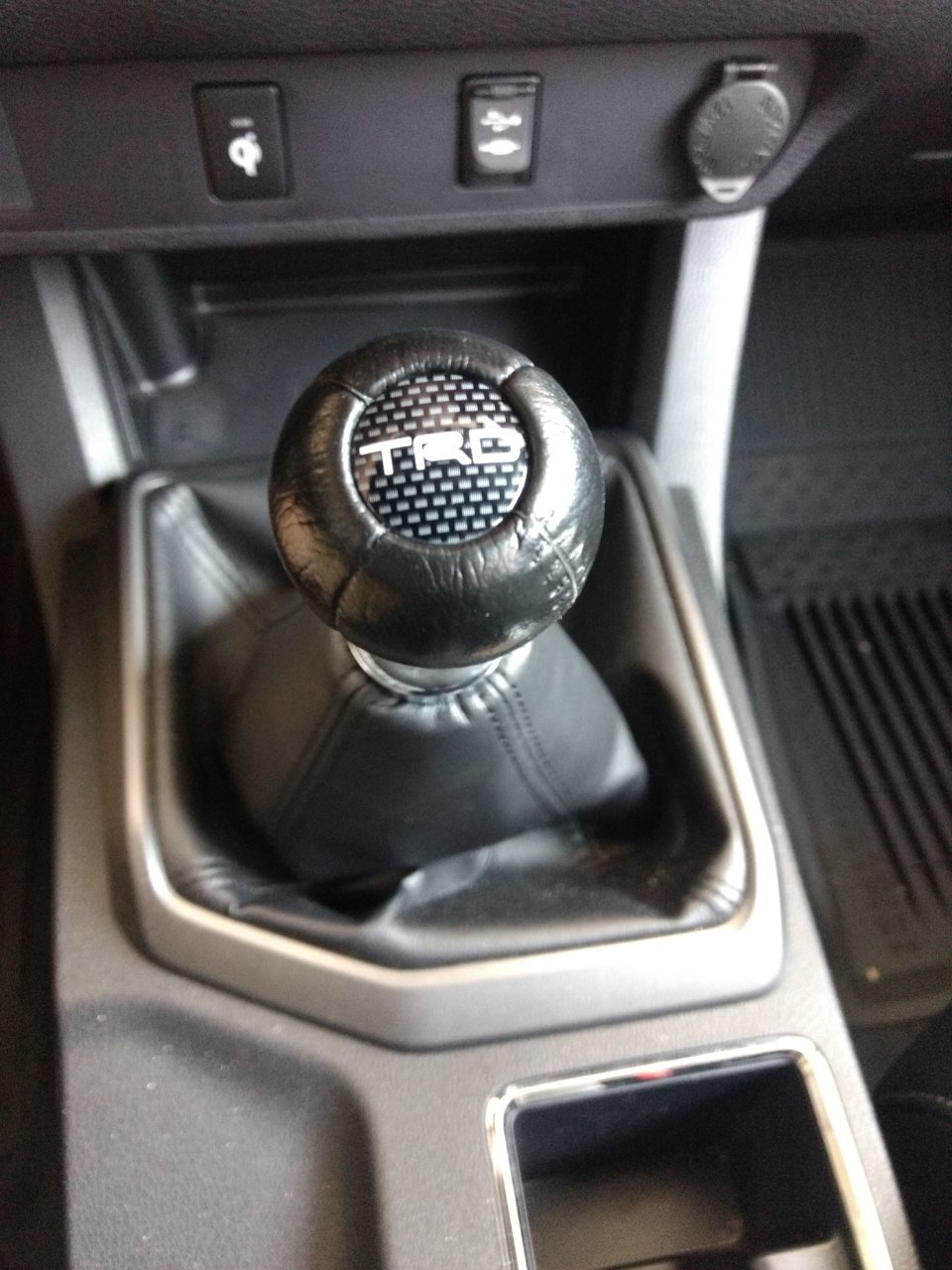

    Got this off Amazon for $25. It's a genuine Toyota product intended for a Lexus (I believe). It's a tad smaller than I'd like, but once I drove with it some, I really like it. Definitely like the looks better than stock knob!

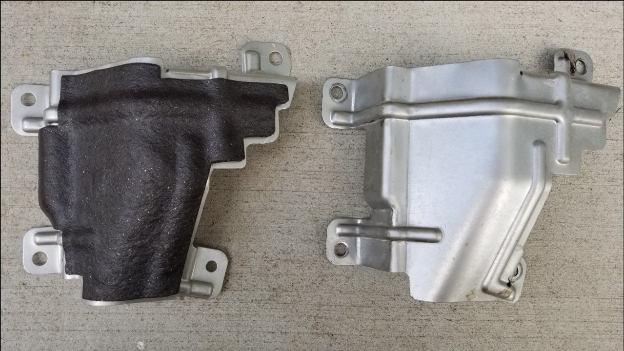

    New T-SB-0186-17 (tranny whine) part:
    Here is what your $100+ will get you. New part on the left. If you can find some heat proof sound deadening material, you can save yourself a lot of money by coating the original part.
    Replacing the part is a bit of of a pain in the ass. Unless you have flat index and middle fingers, you will never get the upper-rear bolt started to replace it. You can remove it with a wrench, but getting it back in is damn near impossible. I suggest pivoting the catalytic converter brace out of your way by removing the two upper bolts and loosening the lower bolt that goes into the converter flange. The bolt that goes into the converter flange will likely require a breaker bar to break loose.
    12mm socket / wrench for guard bolts.
    14mm socket for cat. brace bolts.
    Good luck.

    That looks like the heat shield that covers the damn accumulator. I agree that the top bolt is a PITA to get out and back in. A cold motor is a must.
    I don't understand the reason for the TSB though? Is there a heat issue?
    I mainly looking for more feel from an accumulator delete that I keep slacking on.

    I was surprised to see the accumulator under the shield when I removed it. It was an "oh, there it is!" moment.
    The TSB is for a high pitched whine from the manual tranny at certain speeds. The deadening material is supposed to alleviate that. We shall see.

    Thanks! I haven't heard of that issue.
    That is an easy fix though. Good stuff.
