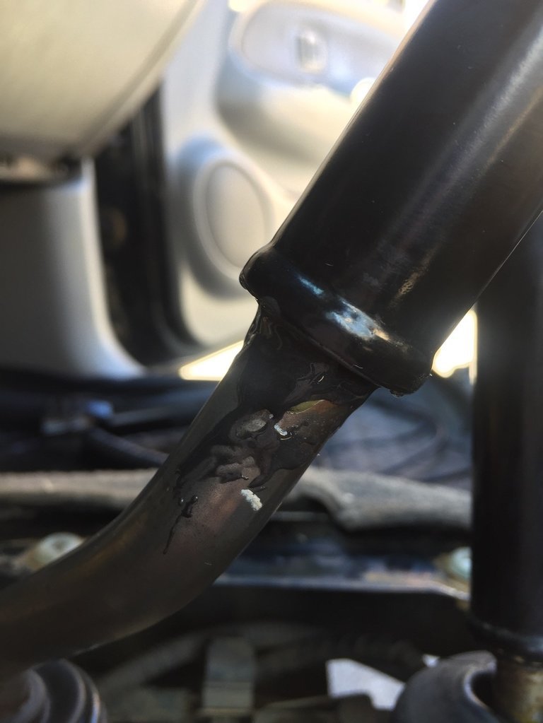

    I can't say from first hand experience with the shifter in these trucks, but it sounds like it's a two piece stalk. There is probably a set screw where the two connect that isn't fully tightened down. If you can pop off the shifter boot, it should be obvious what the issue is.
    This is a prime reason why you don't let other people work on your truck. You don't know what they missed.

    I've checked but didn't see a set screw :( I'll check again this weekend

    I think they broke one of the alignment/locking ring holding pins and didn't tell you. That is the only way your shifter could pivot and not just pop right out of the tranny. Unfortunately it isn't a replaceable part, you'd need a new top piece, lemme get you a picture.
    You can see them on the sides of the shifter turret the two pins/pawls keep the shifter from turning and keep the shifter locking ring in place. Excuse the dirty shift hole, I wiped it after this pic and gave it a nice new bushing. :p

    Actually just fixed it. It wasn't the whole part spinning, just the black part. Apparently there was glue on it from the factory. So I just put some JB weld on there after I cleaned the surface.

    Huh, weird. So the rubber isolator just wasn't grabbing the metal shaft. Well that's a nice fix, I'm glad it was a simple problem. :)
