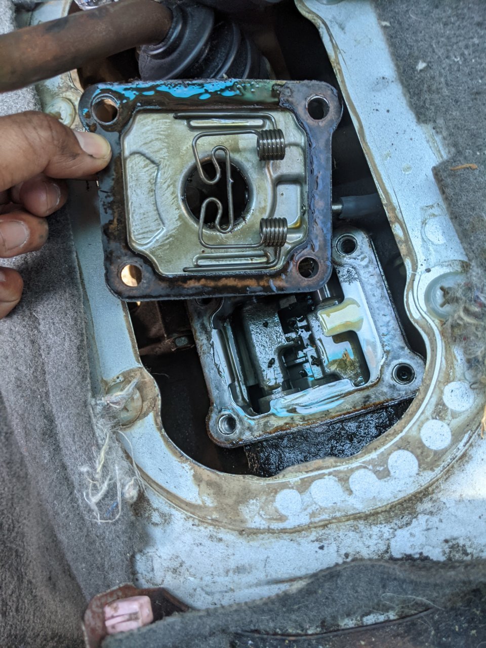

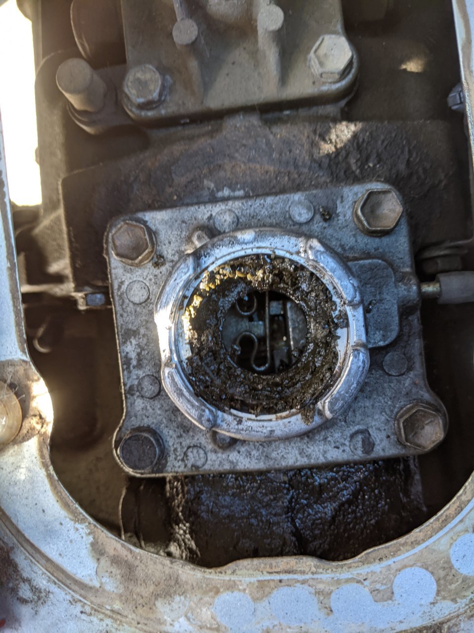

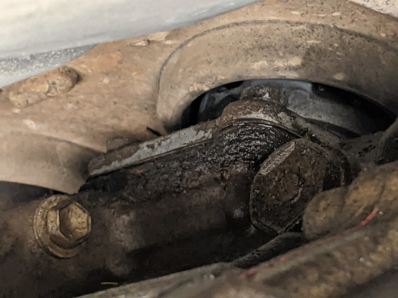

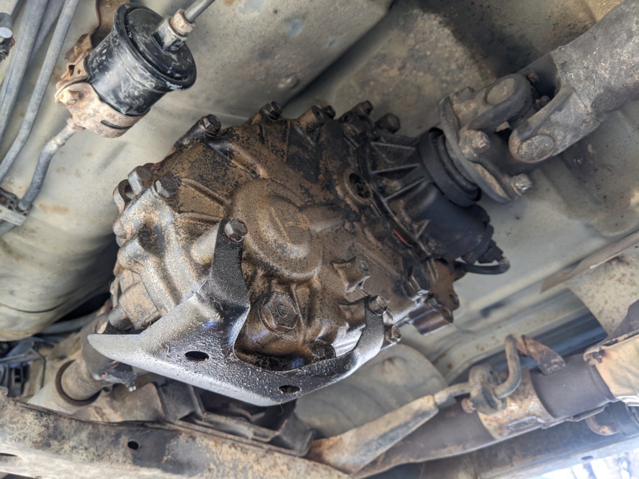

    Seems like I'm not gonna be able to get to this today.
    I have a leak and no idea where it's coming from.
    Although I have a feeling it's coming from up the base of the shifter. :facepalm:
    Gonna clean the area and drive around some.
    All theory's welcomed
    Educate me on gaskets in this area plz

    could be. Doesn't take much to pull the shifter and check the gasket under the shifter
    I remove the shifter and fill through the top instead of messing around with trying to fill it from under the truck

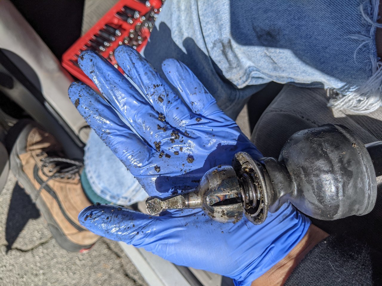

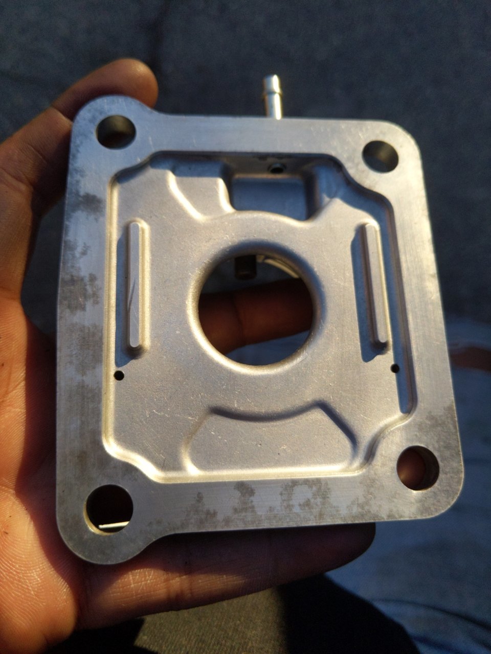

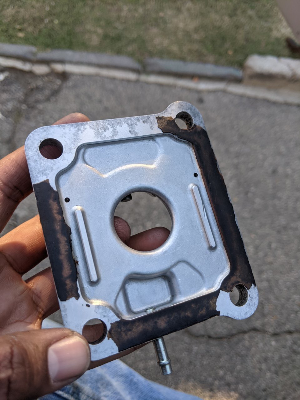

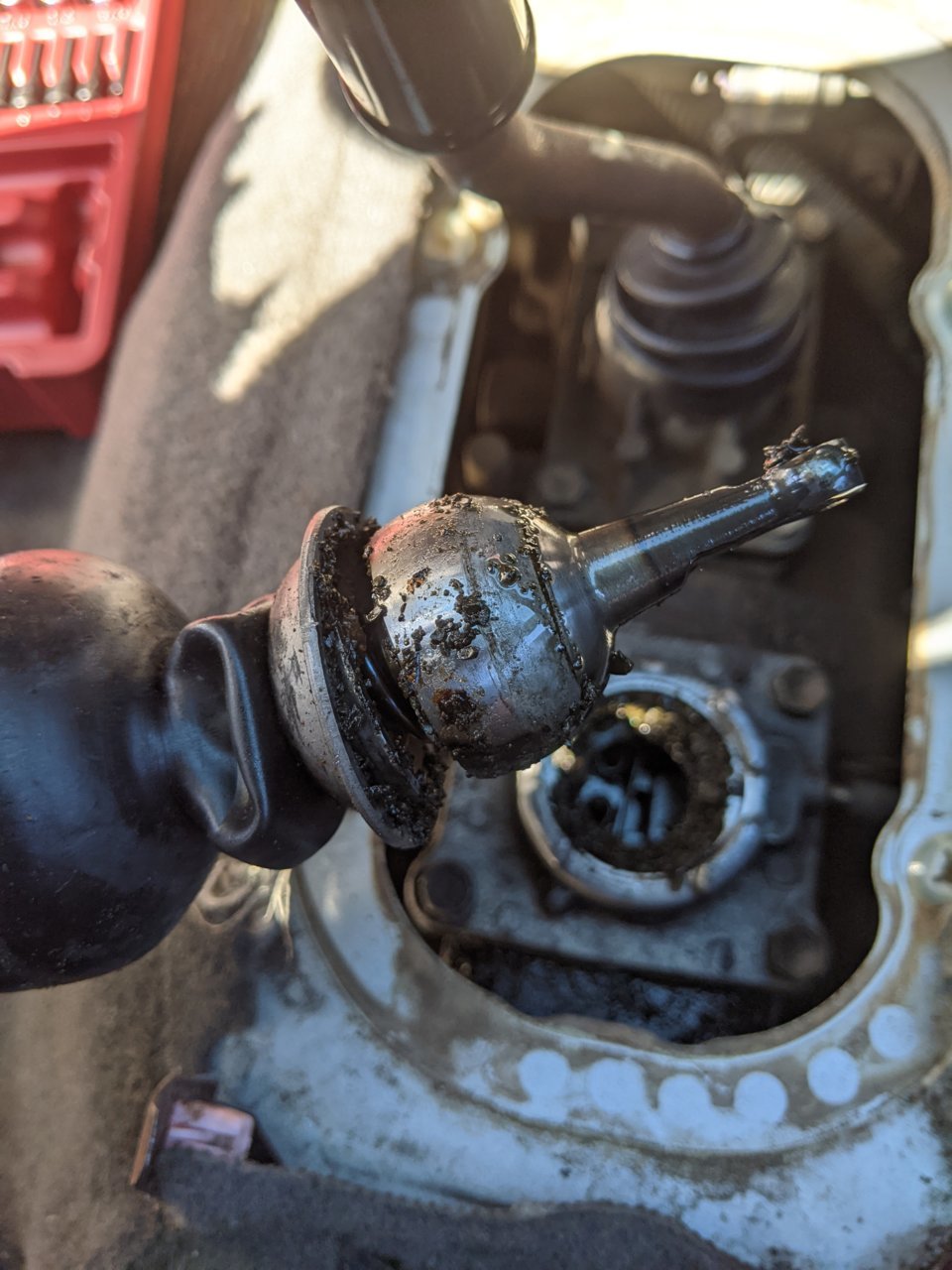

    Well fok that doesn't look goodPXL_20221115_192405725.jpg PXL_20221115_192411120.jpg

    Just needs a new shifter seat and cup. The boot looks dry, right?
    Probably also need to replace the gasket under the shifter base to fix your leak
    Hholiday15[QUOTED] likes this.

    Boot is dry

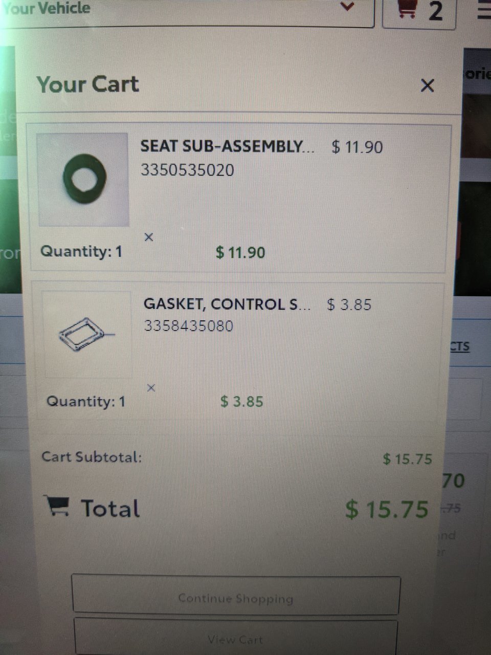

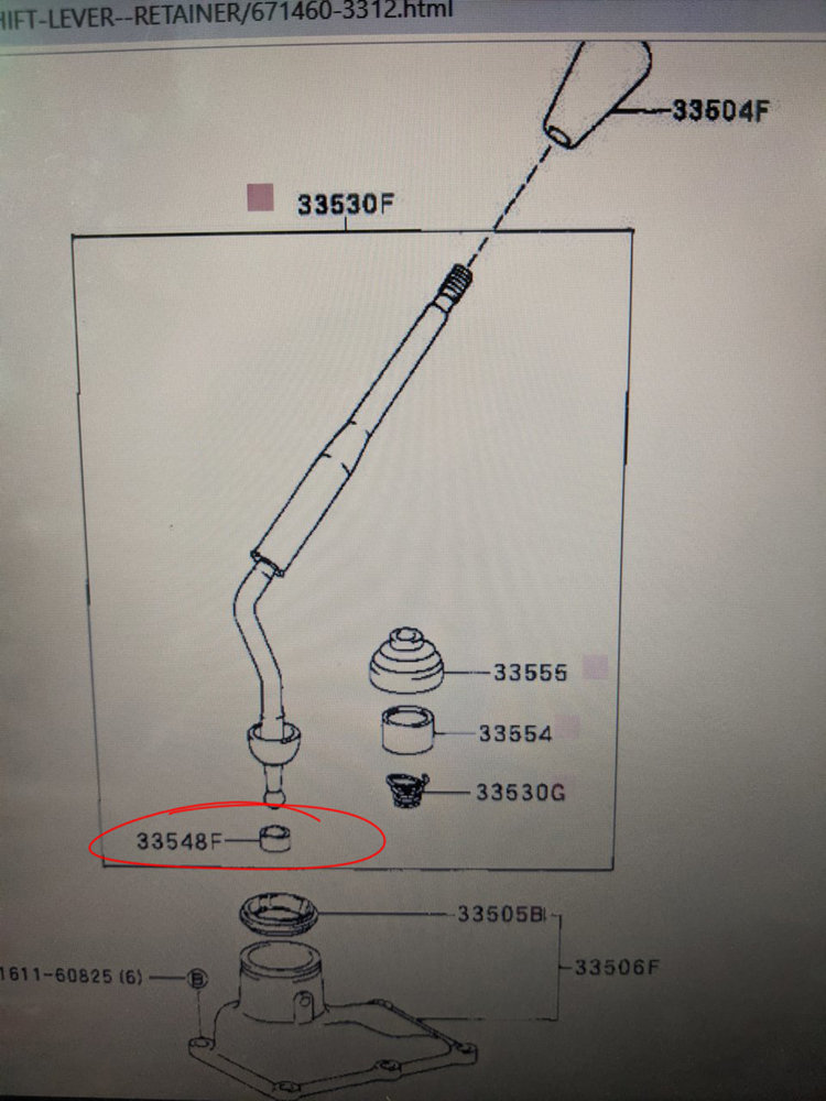

    Anything else I should get?

    some people find that this piece (shift lever bushing) breaks apart too and needs replacing
    Mine was still intact though when I replaced the shifter seat bushing a couple months ago

    Thanks Ryan, I did end up adding that to my cart.

    02 Tacoma 3.4L 5SPD Stepside

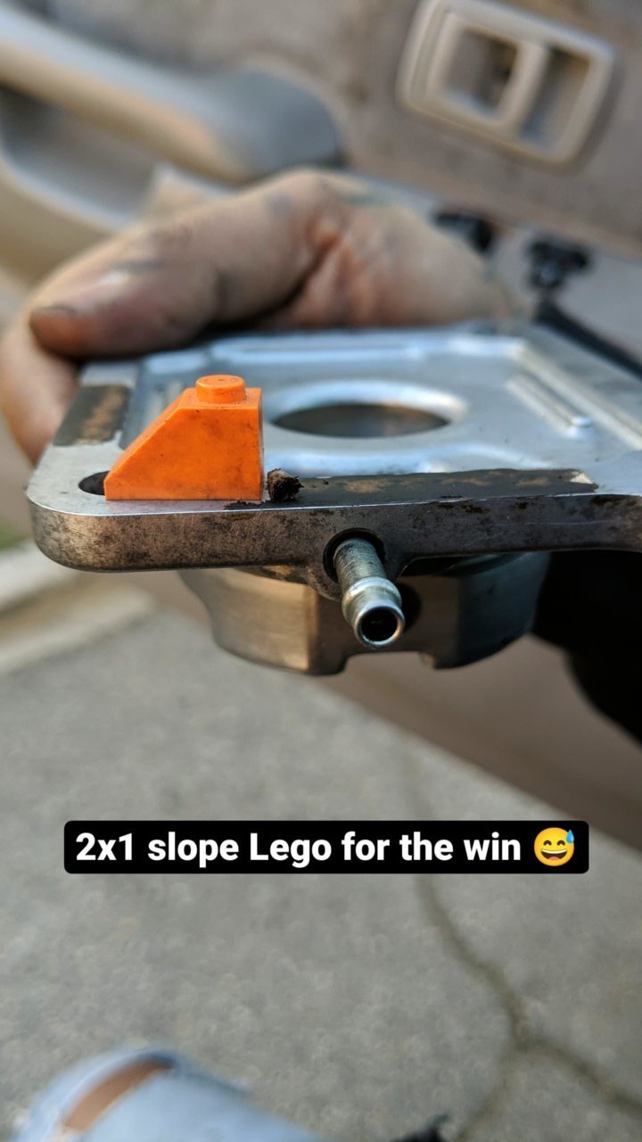

    Nice and clean, though I'm trynna take the paper remnants of the old gasket off.

    :rofl:IMG_20221115_154742_966.jpg 16685561707053102367313854977350.jpg
