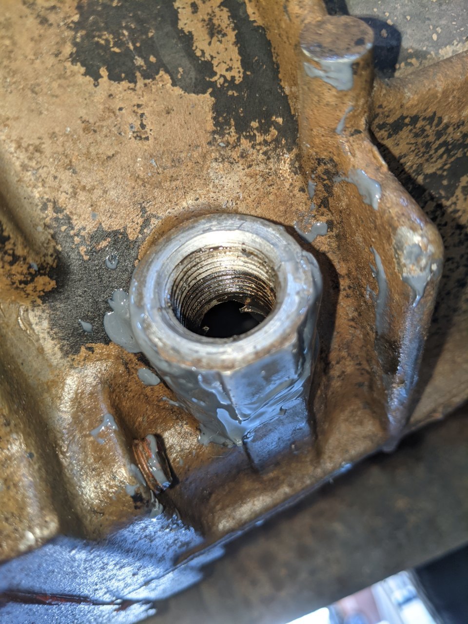

    Nice, I would be very careful though in my experience it takes very little twisting force to break the bonding of jbweld. I think the torque spec for the drain/fill plugs is around 29 ft lbs but I'd probably go lower than that to be safe. Then just keep an eye on it to make sure it's not leaking

    Thank you! I checked yesterday after I posted. It's been 3 days since it completely cured. I've driven it a total of 3.5 hours over those couple days. It's leaking.. I'mma clean it up and try and tighten it up a little more.
