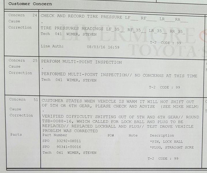

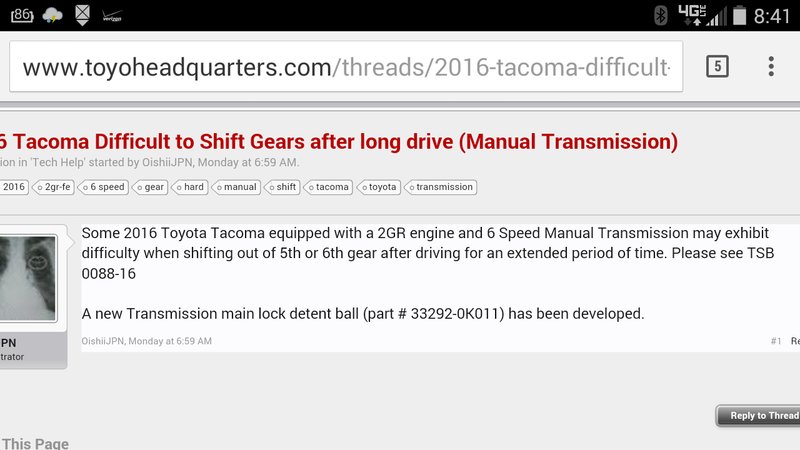

  7. Aug 3, 2016 at 4:10 PM
    #307
    clord74
    clord74 Well-Known Member
    Oct 12, 2015
    #166495
    125
    Nashville
    there is a TSB-0088-16 for 2016 Tacoma manual transmission

    After much persistence I finally got somewhere with the dealership. They carried out TSB-0088-16. We will see if they is a permanent fix to the issue I was having. I don't know how they diagnosed it in .6 miles though. Probably just got tired of me coming in about it.

    Mine's in the process of getting done as well, same TSB (I believe I was the first to post the actual #). I should have it back tomorrow evening. I am heading on vacation on Saturday, so I am probably not going to be able to get my truck out in the conditions that causes the problem until I get back.

    Thank you for posting that TSB. I really put the pressure on after having that as ammo.

    I sure would like to see the pdf of that TSB but can't find it anywhere.
    Anyone that posts a copy would immediately become my personal hero.
