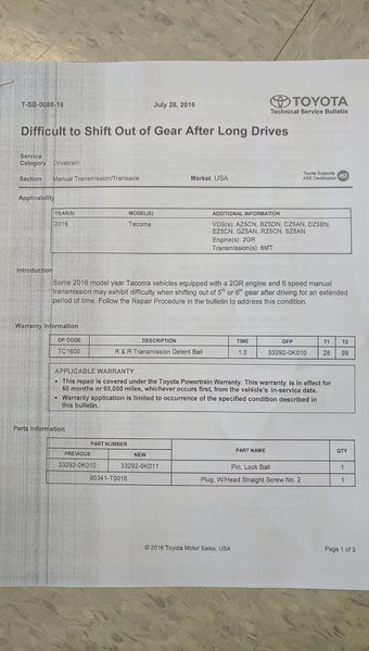

    Good news!
    My VIN doesn't pull up any active TSBs but I had the dealer do a search while I was there getting a new differential. He eventually found the TSB. It does exist and I do have a copy of it. I'll post it later tonight when I can run it through the scanner.
    I'm so excited.

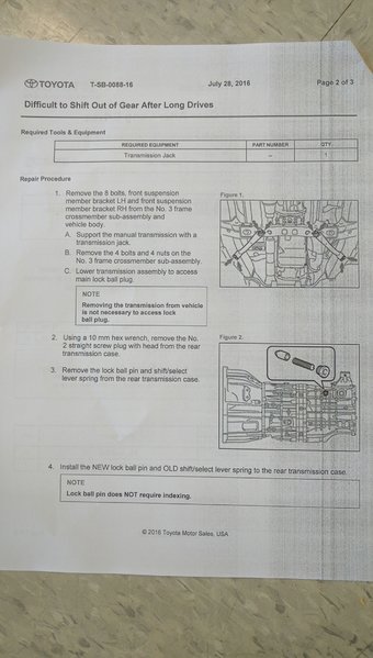

    Very interesting. Resolution makes it hard to read. I wonder what exactly is causing it.

    Admittedly, I'm not a transmission expert.
    I believe the detention pin holds the truck in the selected gear until enough force is applied to overcome a predetermined threshold when it releases and allows the stick to move.
    Apparently the original detention pin was dimensionally incorrect for the job. Maybe is had too tight of a tolerance and swelled with the heat.
    Just speculation.
