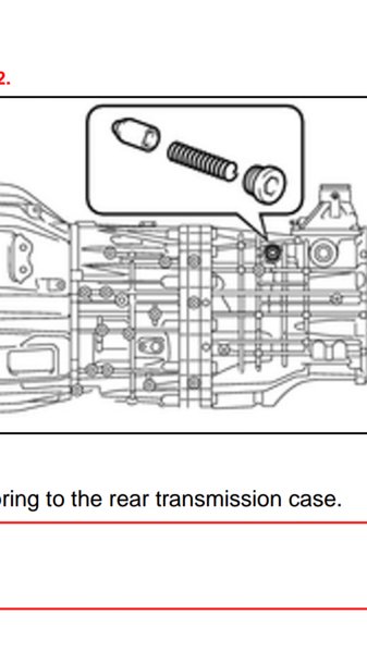

    Here is the tsb-0088-16 pdf

    The pfd I posted shows the new part # and install directions

    My problem solved with TSB Done. found out this weekend when I went on a trip ,the only thing is shifter is not tight anymore. You can move shifter around when in gear .I guess that's better than being stuck in gear. Seems like the detent ball needs to be in between two sizes.

    After getting it done and finding my shifter is loose I wish I had measurements of the balls to be able to replace myself if wanted to try different sizes. There is a plug on side of transmission they remove and swap out the detent balls

    It's more of a pin

    Okay they called it a detent ball so I assumed it was round. Thanks for clarifying that
