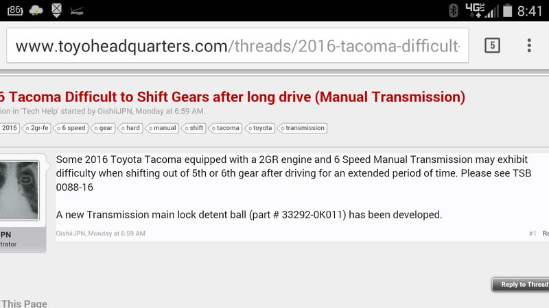

    I just recently bought a 2016 Tacoma TRD sport and I've been experiencing these exact issues. Gears sticking in 5th and 6th when trying to shift. I called Toyota and there is a Technical Service Bulletin for this issue. The TSB number is 0088-16 and it describes all of the issues that have been talked about here. Only some 2016 tacoma's are effected and it seems to be random.
    I'm taking my truck in for service this week and I will report back.
    *UPDATE* (9/12/16 1:00pm)
    I took my truck into my local dealer and they wanted to test drive it to verify my claim. I went out with a tech and replicated the issue. JUST TO CLARIFY this issue for me only happens if the truck has been on the road for over an hour and has been left in gear (5th or 6th) for an extended period of time. (15+ minutes) They are going to replace two parts related to the issue, however the parts necessary for the repair are on national backorder (for USA) and won't be available for some time. . . good and bad news I guess. I will update again when I know more.

    I took a video in, didn't help, but your results may very. What worked for me was bashing them in Google reviews for not fixing a known issue that could be deadly because it requires long drives and it didn't happen. Try the video, and print out the tsb of the issue and raise hell. It's an easy fix, if you give them enough problems they will fix it just to get rid of you

    Update: Issue solved!
    Took it in to the dealership and they couldn't replicate they also couldn't pull up the TSB because Canada... Called Toyota Canada and explained to them the issue and suggested they import the US TSB into Canada. Few days later dealership called saying the TSB is in now, they ordered the part and just had the work done this morning!

    Mine did the work without being able to replicate it themselves. If your dealership isn't willing to try asking another dealership. Print out the TSB and bring it to them, the fact that they have a service bulletin for the issue clearly means it exists and like you said there's times being stuck in gear could be dangerous. Keep pushing them!

    There is a TSB out on it .don't know what it would have to be duplicated. I brought my back 3 times they could not duplicate but when PSP came out they went ahead and Screenshot_2016-08-03-20-41-26.jpg formed TSB on it.
