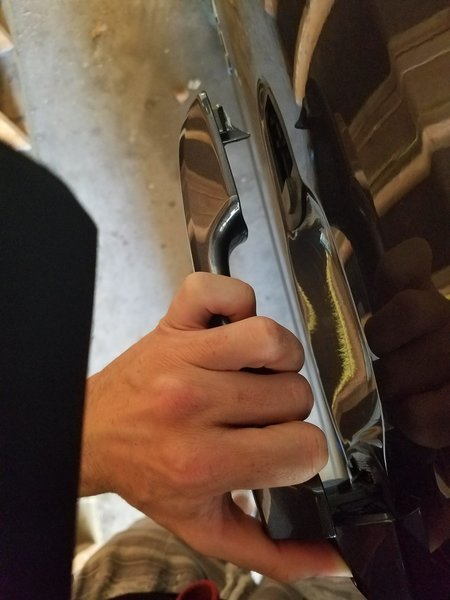

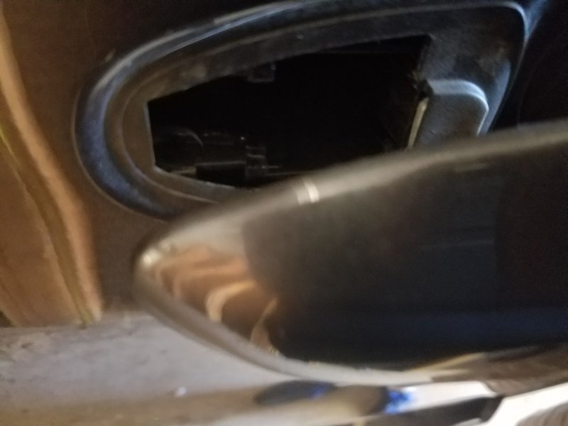

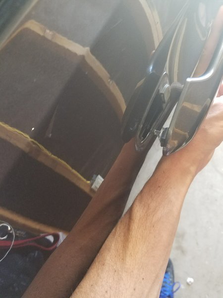

    UPDATE and FUNNY story!!!
    So I just got the new part installed for the transmission, but have yet to take her for a spin. Happy they finally got the part after about 5 weeks of battling the stick shift. Good news is, I got mad right arm muscle now. :muscleflexing: However and here is the kicker, as the technician went to just pull the truck in for repair; he broke the driver side handle. :tumbleweed: It still is functional, but it is jacked. Looks like it is ganna fall off at high speeds and especially if I am four wheeling (can't do that until it is fixed now). :crapstorm:
