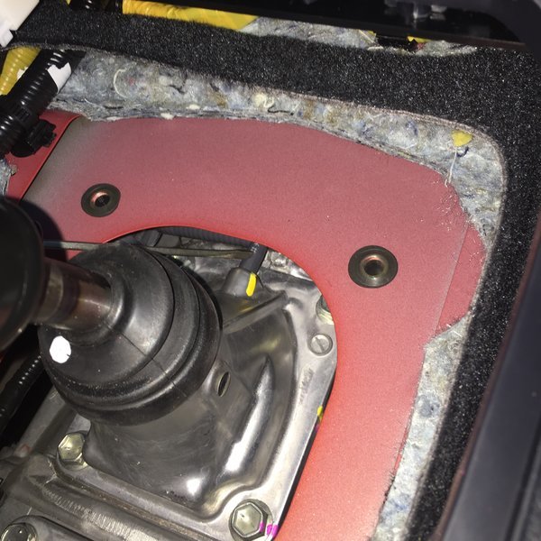

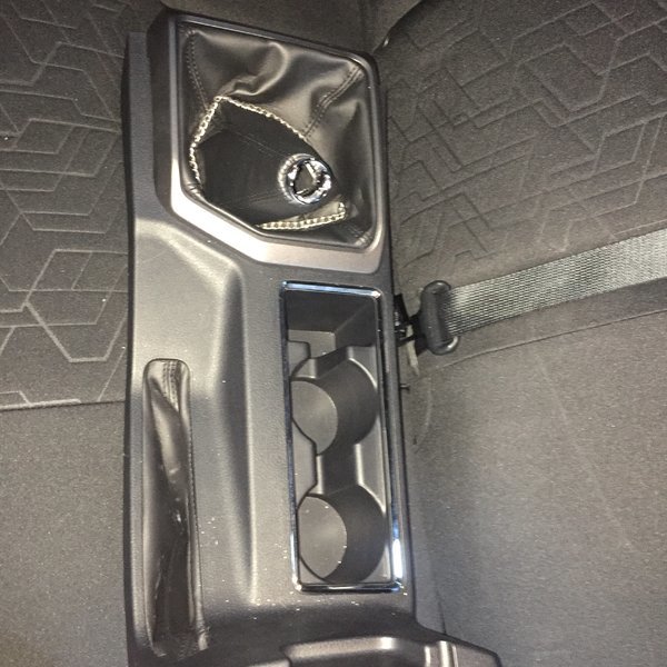

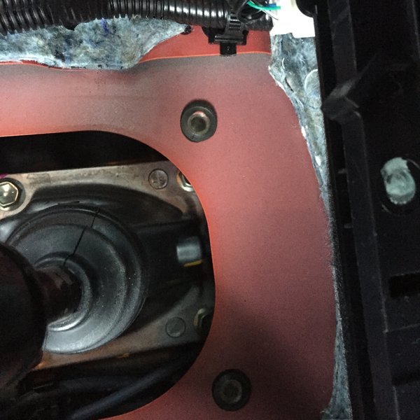

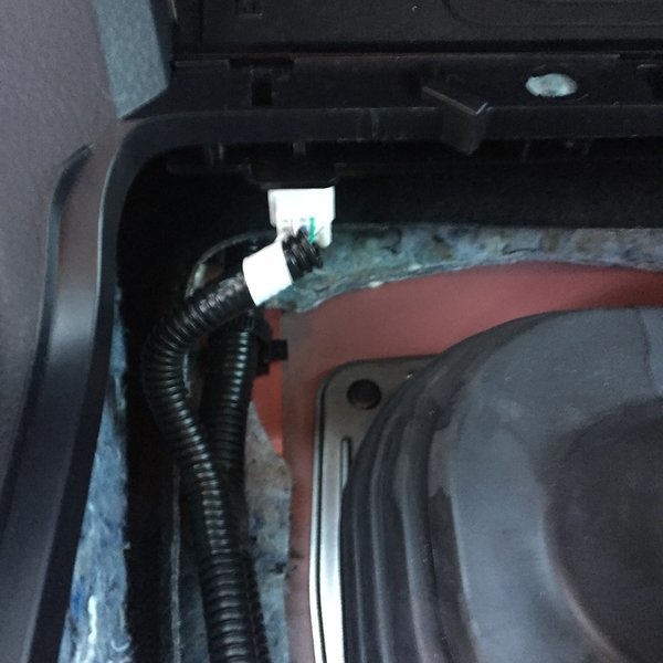

    So this kits directions are so not for the 2016/2017. After I finally got the "cup holder"out, I realized there is no need to remove the whole console which also has electrical hookups that I could not unplug for some reason. I removed the shifter boot which had a small gap under the front part where it's secured by plastic clips for some reason. I then proceeded to attempt removal of the shifter assembly- good luck there! The front two bolts are not accessible due to the frame of the truck which I'm guessing will need to be trimmed up to allow access. I tried a swivel attachment which did not have enough clearance and tried a wrench which I barely had room for and could not break it loose. After an hour and a half I gave up for now and put it back together.

    In that last picture there is a black hose coming out of the shifter that I'm assuming is somekind of vaccum? No mention of it in the directions. I'm also certain that by adding that spacer plate that come with the kit that metal will definitely need cut out to allow for the new bolts to go in.
