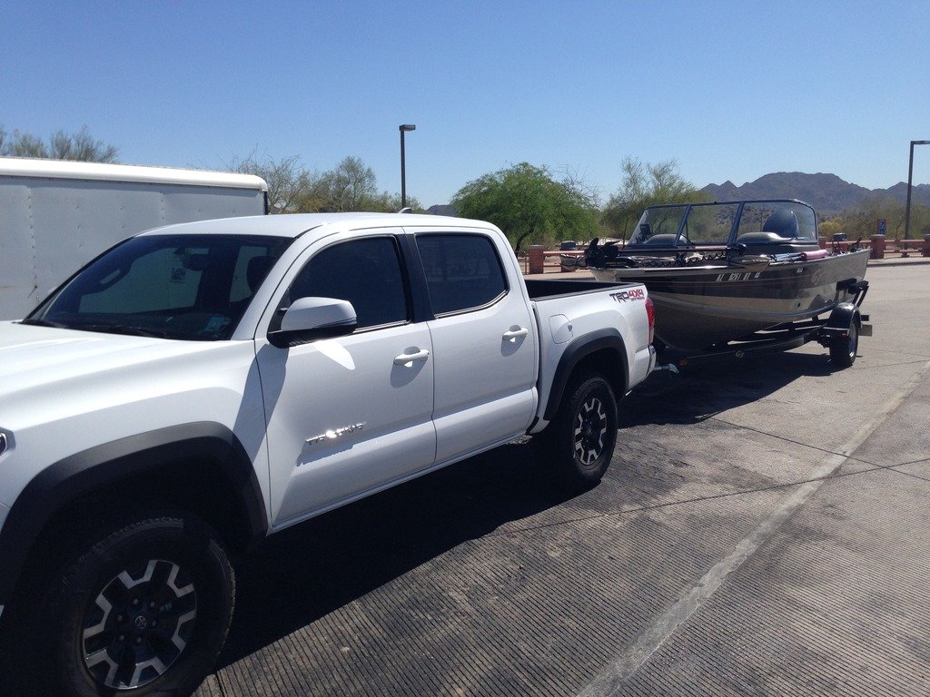

    Here's a data point..
    2016 DCSB OR M/T w/ 900 miles
    I towed my boat from Tucson to Phoenix; constant driving for 2 hours. No sticking issues! Checked every 30 minutes :bananadance:
    ED9895B1-8610-4660-9C0D-8227BB897824_zps_b8cdddb80223a1dd02d64298a12085dad3e1fd2a.jpg
