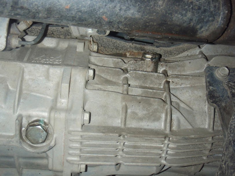

    on left is the drain bolt and the right is the fill plug. only trq down to 25 lb of pressure.

    that black figure is my drive shaft btw just to give you perspective.
